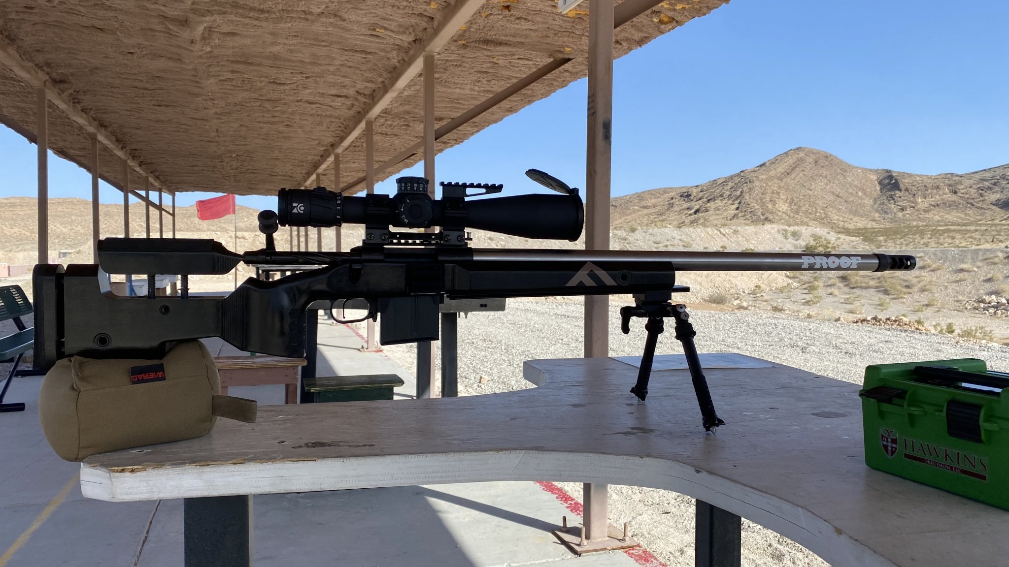

Have a zco 527 coming, need a mount. Going on a LPA fuzion with comp contour barrel, manners mcs chassis. Running everything in 1.25" mounts up to date. Pondering going to 1.50 for more vertical head alignment for positional shooting. Probably going to be an ARC M-brace, with an additional 10 or 20moa in the mount. Guys who are running 1.50 have you found advantage or disadvantages of them?
I run an ARC Mbrace at that height. I'm plenty happy with it. It allows all my ear pro to clear if I shoot without a can and seems to feel more comfortable.
Reactions: camocorvette
Thanks for the suggestions and input fellas, gonna run a 1.50 mount and see how it works. Due to my wide cheek bones, I've always used more of a low cheek height and a jaw weld to keep the rifle as center line on my clavicle. The TCS cheek hardware lets me adjust the left to right of the cheek, which works wonders, but really screws you if there is a weak side stage.

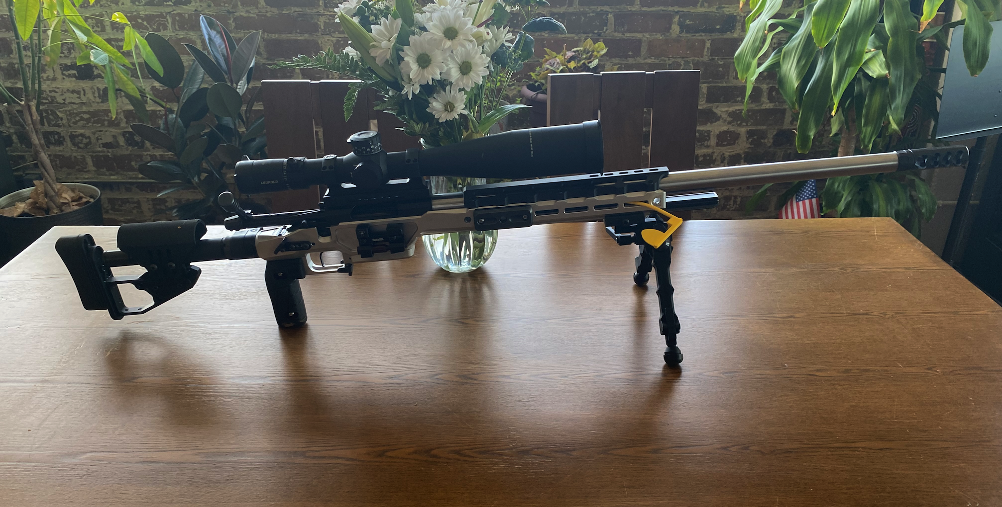

Thinking the same about a ZCO block mount. But I have concerns about my cheek adjustment not being enough on my foundation.
This was the other reason I went to the 1.5" 20moa mount on this Cadex chassis. When I had a 1.3" ish height mount on it I had to bottom out my cheek riser adjustment. Now I don't have to smoosh my face down on it 😂

This is a 1.5" (I'm pretty sure, anyway) mount (from Leupold) and I needed it really to clear the NV bridge thing although I can probably get away with a 1.25"... but I paid like half MSRP off ebay for the mount so, whatever. In practice, with the chassis adjustments I was more comfortable prone than I ever have been on much lower mounted scope rifles that I have. Evidently I have a tall head?
Reactions: akmike47
If looks matter the nv bridge definitely makes a difference. I wish there was a longer bridge/mirage shield for the ACC like that. More so if it could still be used with all the weights if you wanted, just use long screws for the mlok and sandwich it between them and the chassis or something.

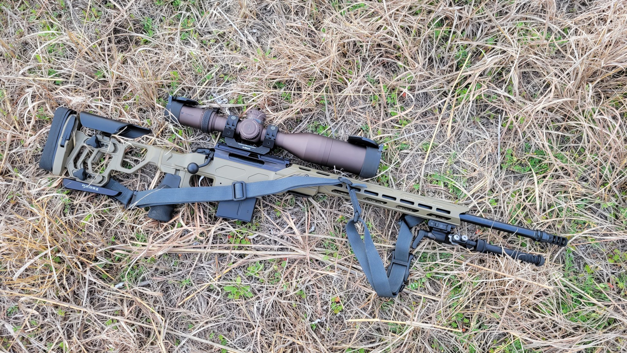

I’m also a convert to 1.5in rings on both me (6’3) and my wife’s (5’8). She has no issue with the height but I did put a anarchy outdoor pad on top of her cheek rest on her foundation stock.
I still have a set of MDT 1.25 that I will sell this spring for another ARC M-Brace.
I also went with the Burris XTR bushing rings on my RimX for my 30mm Athlon Midas 6-24 and it allows me to get all the elevation available (removed the zero stop and I set up the bushing so that when I’m zero, I can still have 1.0 mil below zero available and then the full 25 mils of elevation so that I can reach 450 in almost all weather conditions). They’re a huge PITA to set up but once it’s done I think they’re a great piece of kit especially at 99$
