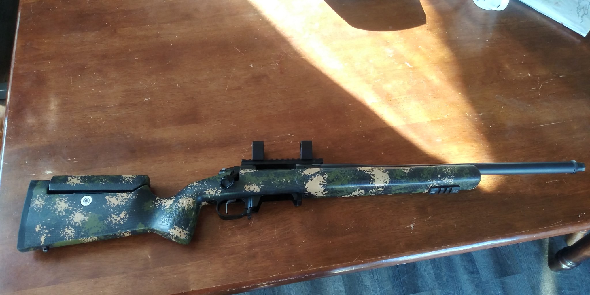

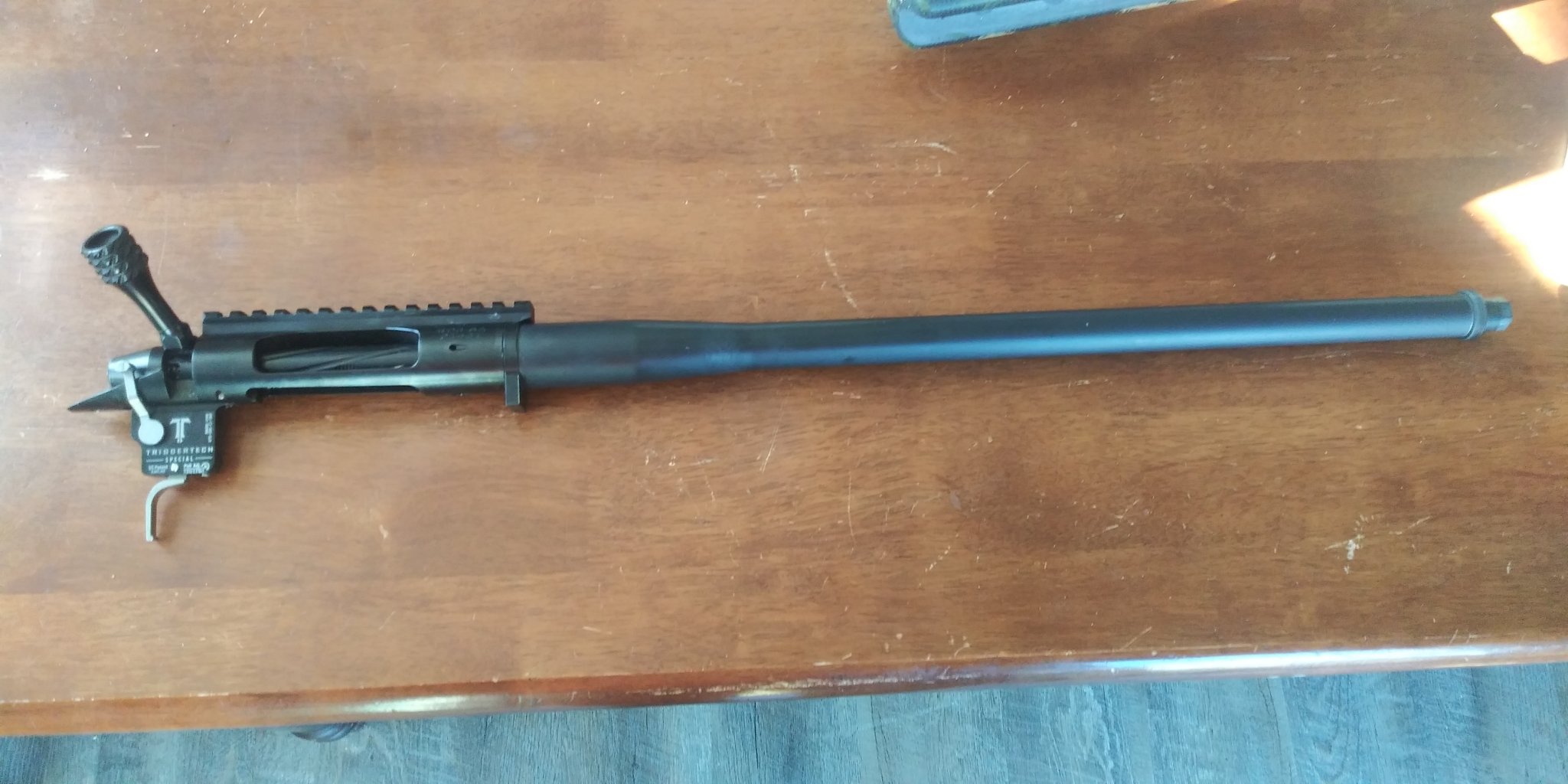

I just did a 6BR Med Palma. At first I thought it looked too skinny. But with a suppressor on it looks great. And I appreciate the weight savings. 12 round shot strings don't heat it up as bad as I thought it would. I think I'll keep using it going forward as the rifle is a bit handier than the M24 contour I use to have!
