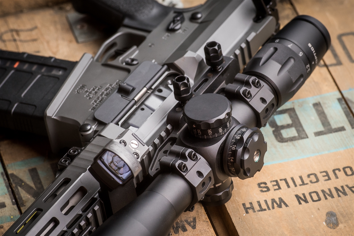

Here is my idea for an "all-purpose" ar setup. Could potentially be used on a 14.5" or 16" small frame ar with premium barrel. My main goals are:
(1) "red dot fast" up close
(2) not significantly heavier than the current 1-8 and 1-6 lpvo's on the market
(3) reliable and durable
(4) have extra magnification just because it's more interesting to me to have it
Want to be able to use it for anything without being overly burdensome/heavy or slower up close but am willing to take a little weight and speed penalty. Just wanting to get opinions about it really for a general use setup that could be used mostly for the range but anything I wanted like classes or comps or even home defense but I've got other stuff that is already setup for that so I'm trying to do something different to see how I like it
Anyway, here's my idea:
Leupold VX5 3-15 with impact reticle 19 ounces
Spuhr mount with red dot on top either rmr or aimpoint
Also, what height sphur mount would you guys use to get the aimpoint or rmr positioned at a comparable height to where it would be with a normal red dot mount in the 1.9" height range
Is there any reason to think I would be giving up any speed with a setup like this if the red dot is basically in the same position it would be with normal mounts and the only penalty would be the extra weight the 19 extra ounces of the leupold scope and whatever the differential is between the spuhr and a normal red dot mount?

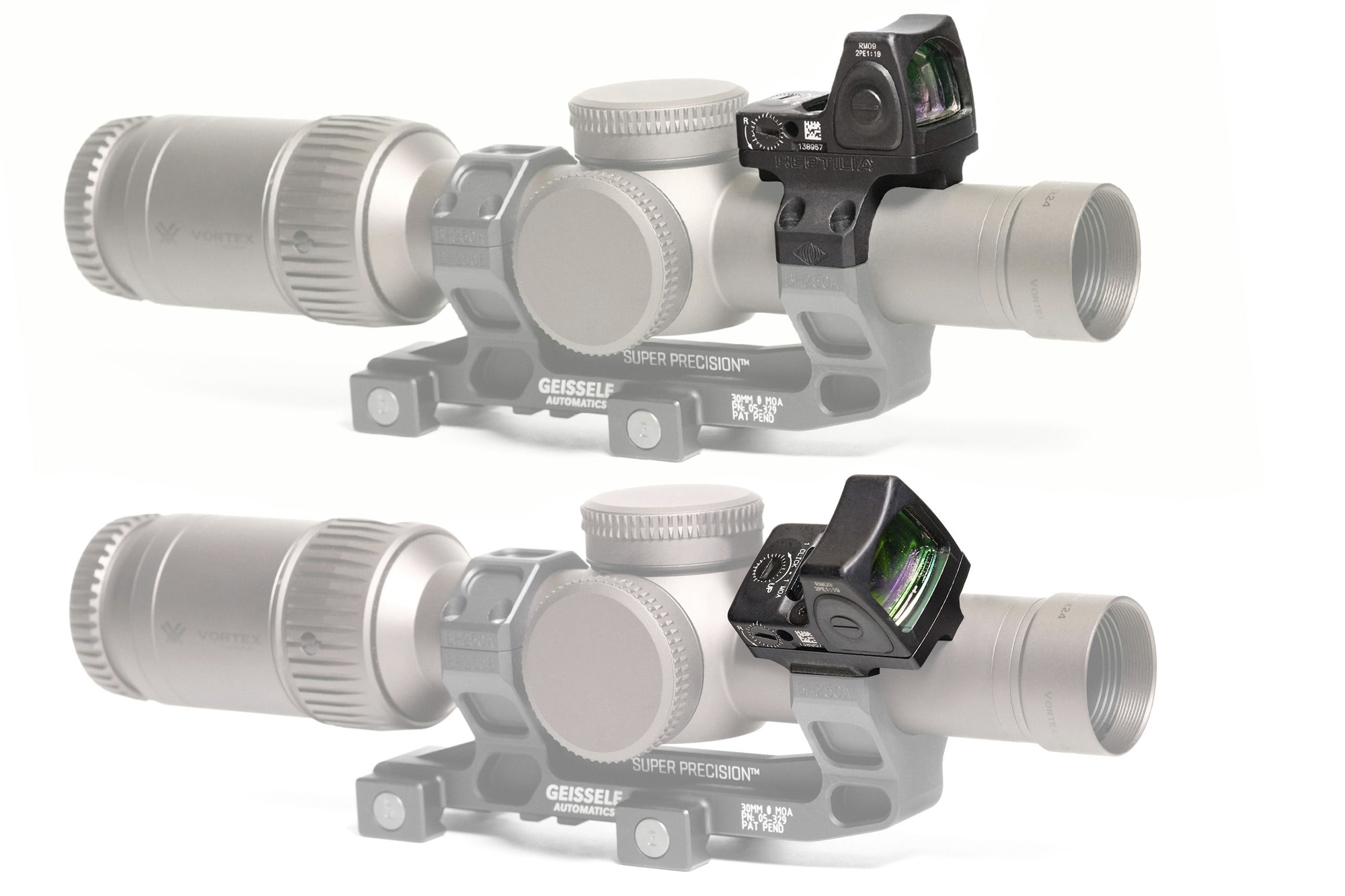

I think your best bet is a 45* red dot.

As others have suggested you could go 45 deg with a RDS or even irons for close in work.

When you all are saying 45* rmr do you mean off the scope mount or the rail ?
Reactions: lawofsavage
View attachment 7191950View attachment 7191951
Personal preference really, I don’t think it makes much of a difference. I’ve run both and I feel like on the rail is a little faster when you’re actually on it and shooting and you keep a better cheek weld, but when throwing the gun up or transitioning from magnified optic to the offset RDS and vise versa I find the dot/transition quicker with the ring mount sight.
