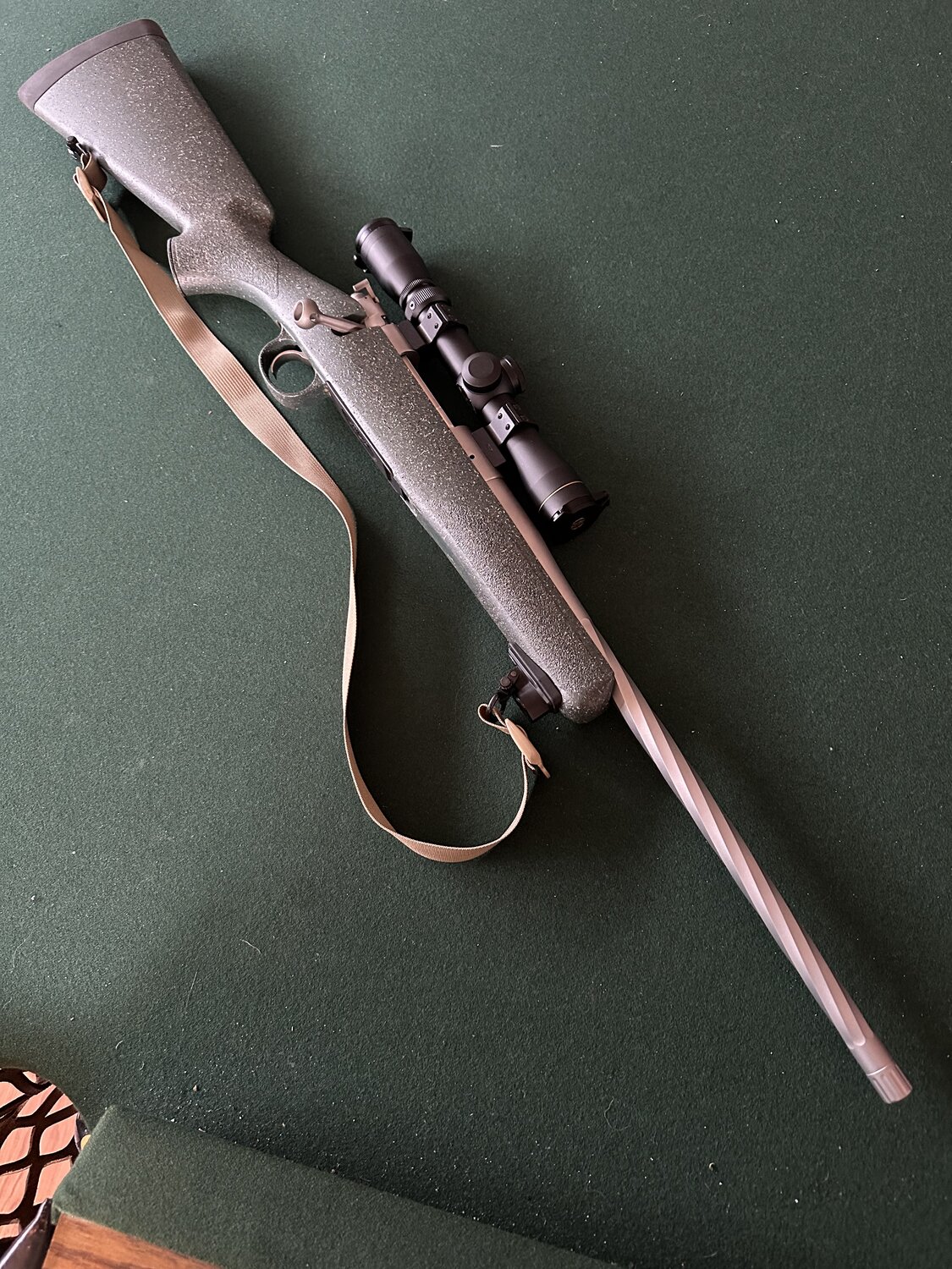

Can't let a 358W thread go without me showing mine off. Kimber Hunter 243 that has changed a bit. Weighs right around 5 lbs all-up. 16.5" barrel.
