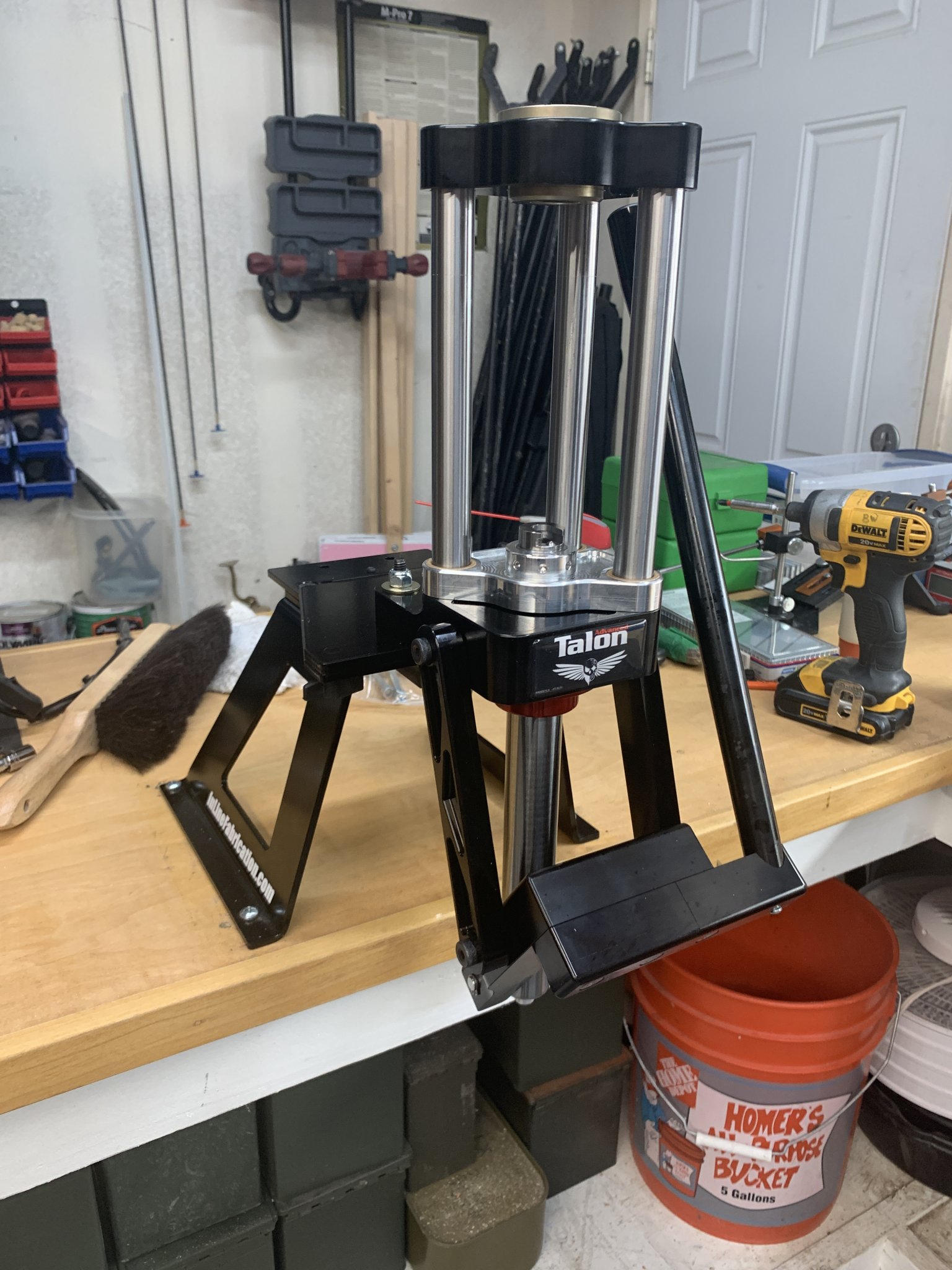

Initial impressions:
  • Very well machined. Quality is excellent.
  • Very sturdy but surprisingly lighter than my Rock Chucker because of the aluminum parts.
  • This press tracks very straight and there is zero deflection in the ram. Or any other part for that matter.
  • Very right tolerances, maybe a little too tight causing the press to not feel very smooth, yet. I imagine that as I use it and the bushings that travel up and down the verticals guide rods break-in, it will smooth out nicely
  • I don’t like the spent primer system but it works and it’s not that big of a deal. Better than the Rock Chucker that always has a few strays.
  • There is no stop to keep the ram from caming over. This is new to me but I’m thinking I might like it. With my Rock Chucker, I always feel like I have to use the same pressure or I’ll get variances. With this press, as long as I cam-over, I should get very consistent results. At least that’s my theory.Overall, I think I’m going to be very happy with my purchase. I’ll update after I get some time on it.

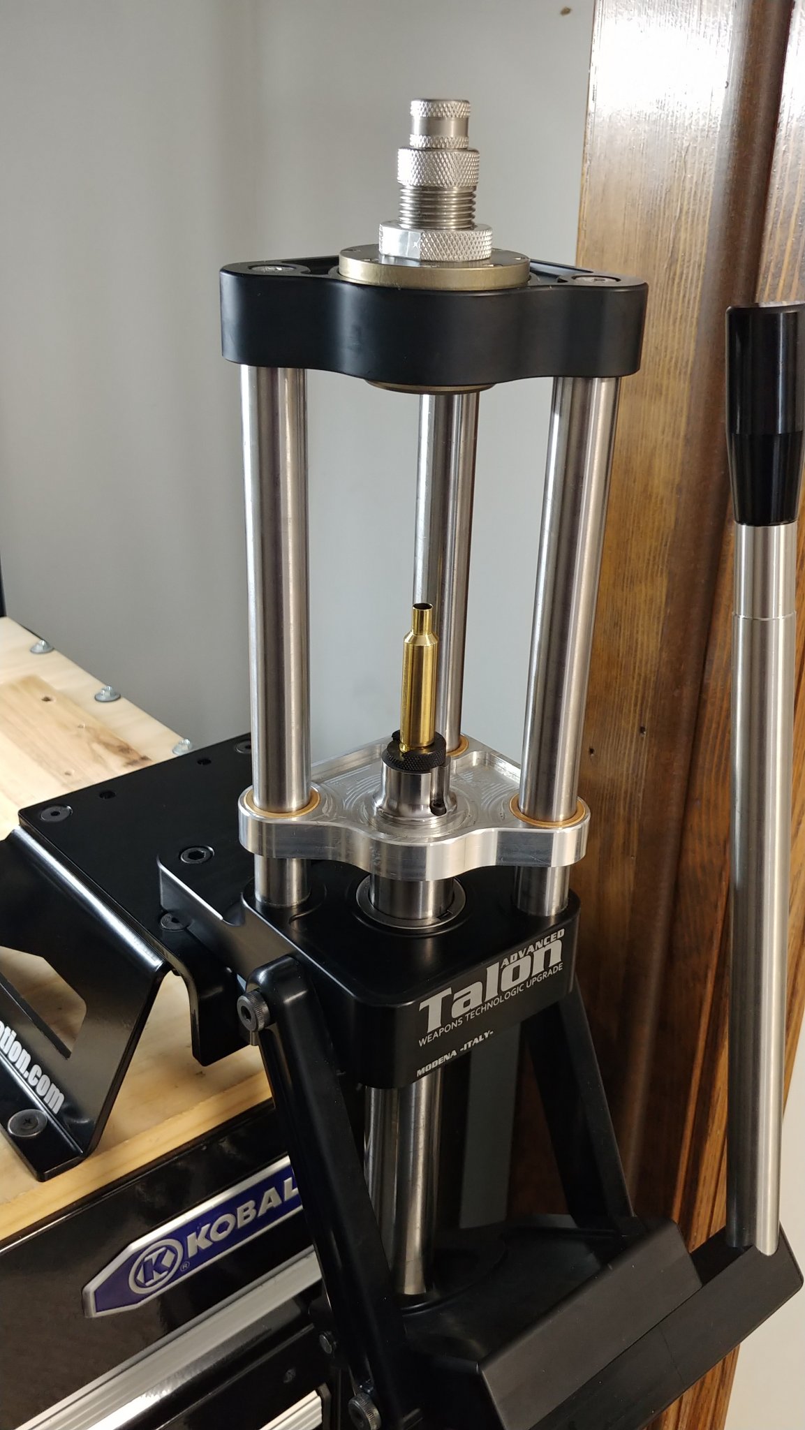

I have had one for just over a year. I think it was the first one in the states. The craftsmanship of this press is incredible and when compared to the cost of the high end German presses available it's a good value. I load everything from 6.5 Grendel to 4.300" long 338 Edge on it. They offer a 50 bmg shell holder now and different thread inserts for different size die bodies. For low volume extreme precision it's an excellent option. I don't deprime on the press so I have never used that feature.
~Justin

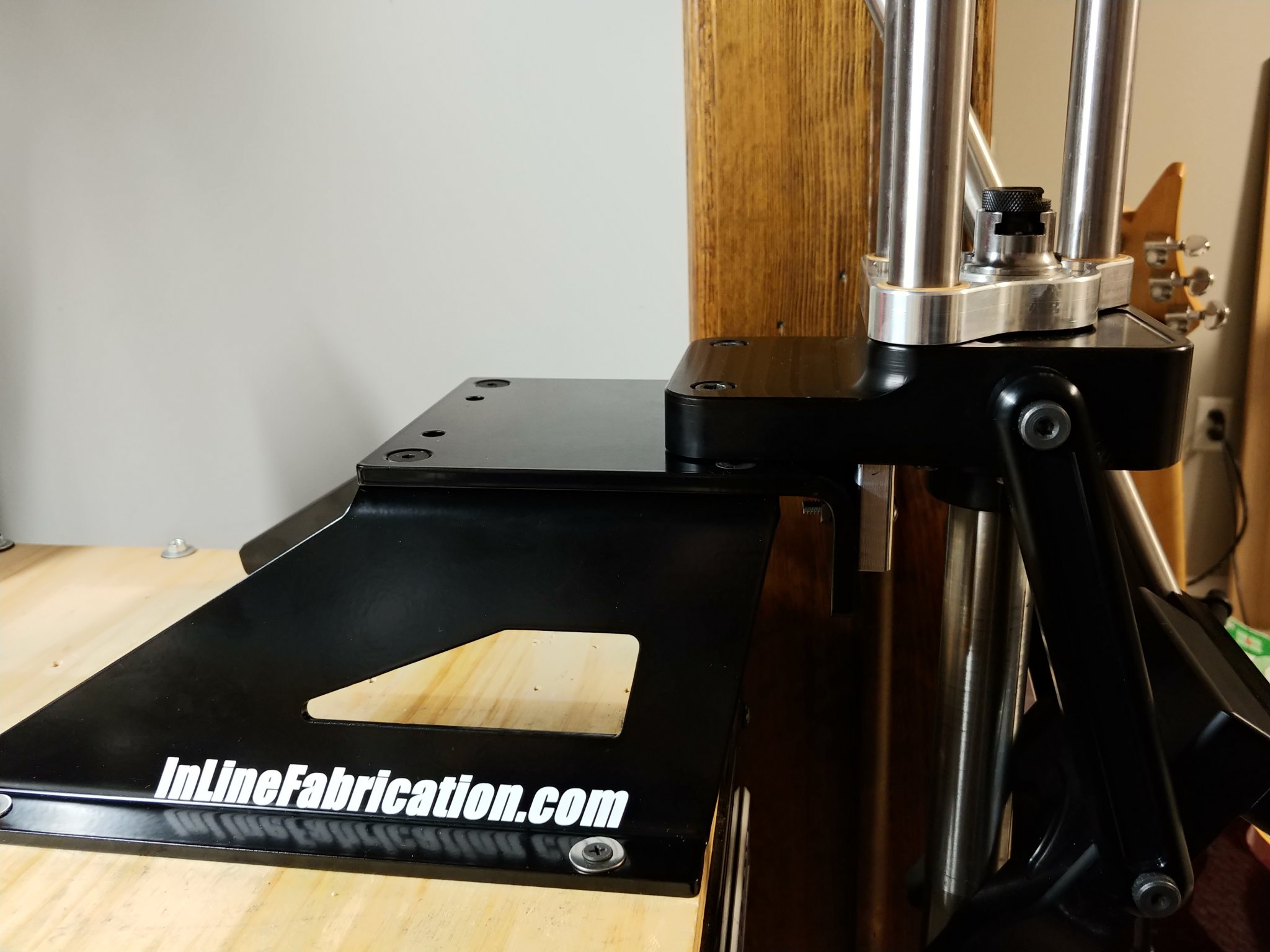

2 Questions-
which inline plate number is that? or did Dan do a custom for you?
and straight order via email off the website?
thanks
It's a custom plate from Dan- first one he had ever made for this press.
Are you talking about ordering the press or the mounting plate?
For the press I have ordered 2 of them from
upgradeyourrifle.com
Marco Brutti is my contact. Great to work with. PayPal invoice via email is how I purchased. Shipping was reasonable.
~Justin
actually both- the press and the custom plate from Dan. I like the idea of a single press to do 50BMG and smaller versus changing presses.
Gotcha, if you give Dan a call and tell him it's for the Extreme Press from Talon he should have that bolt pattern saved to make you one. I think I paid for that via PayPal as well.

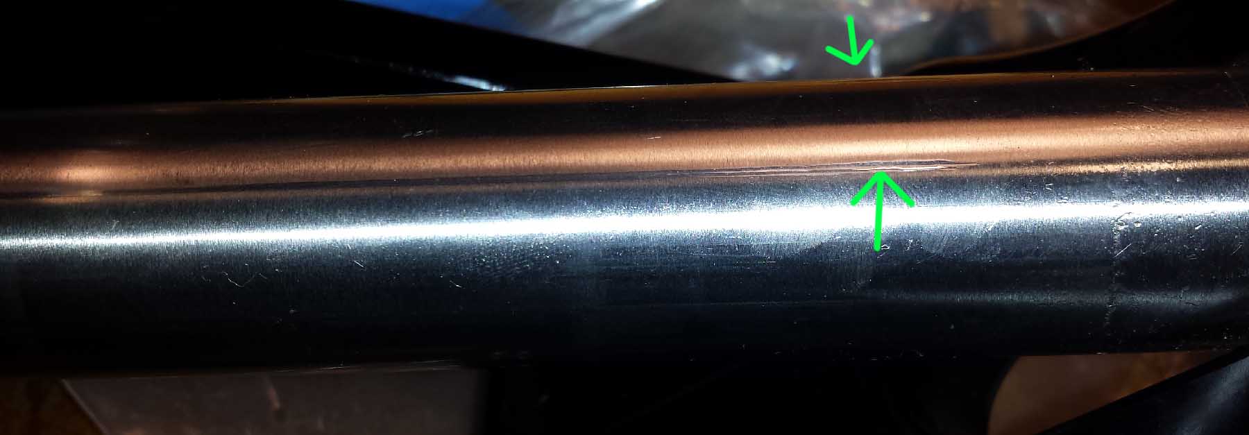

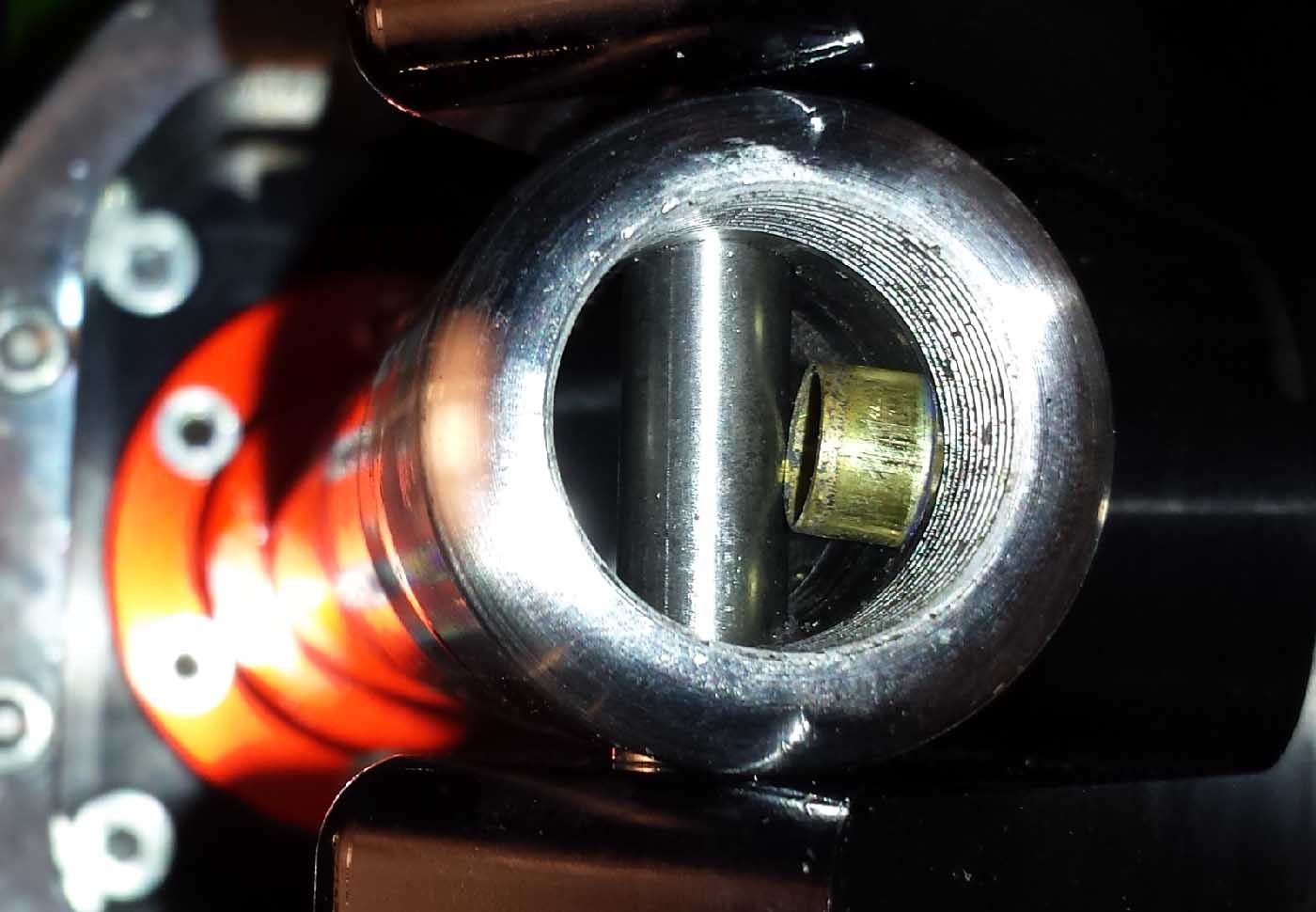

UPDATE: Talon says marks on main shaft won't cause problems. Primer issue is due to a mistake during manufacture. Incorrect pin size being used. Waiting on them to figure out a solution.
Bumping thread with some info for anyone thinking of doing larger calibers. Ran into some issues with 50 bmg. Contacted the retailer, I'll update with answers when I get them.
Main shaft is galling after resizing a dozen cases. I put a layer of oil on before use as well. There is some kind of bearing setup holding the main ram shaft, it does not like high pressure of large caliber cases. The contact surface area against the bearing seems concentrated to gall like that.
Okay this one made me laugh a bit. The pivot pin for the ram does not allow larger primers to exit out the bottom. Have to dissemble to empty it out each resizing session 😅
