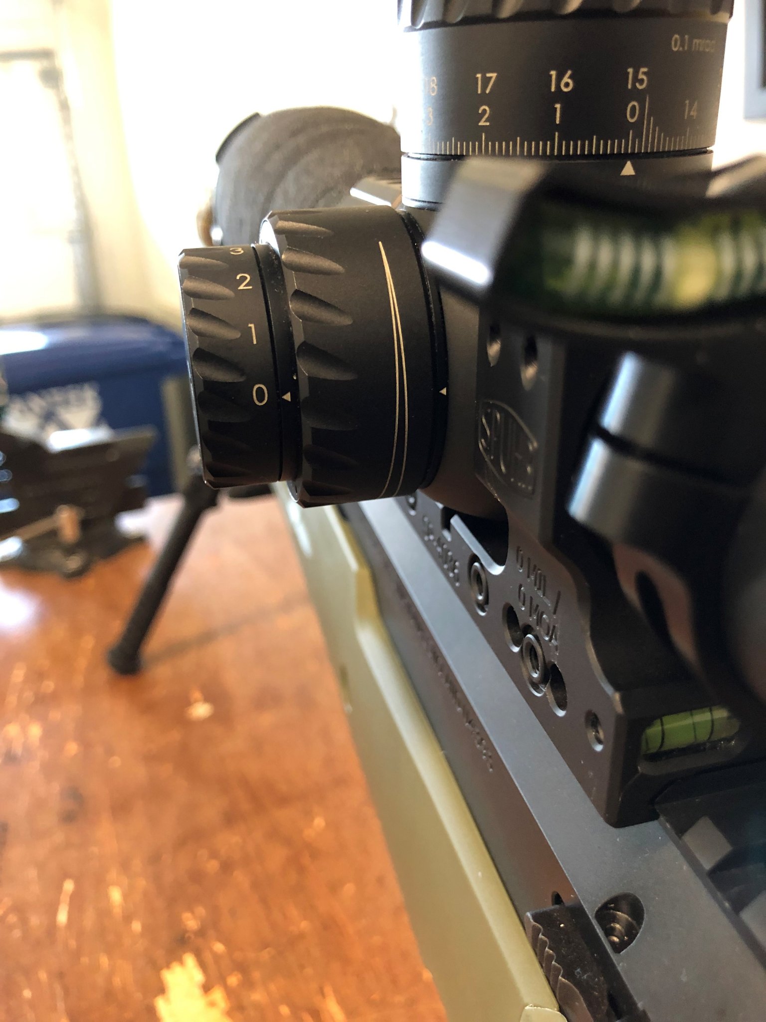

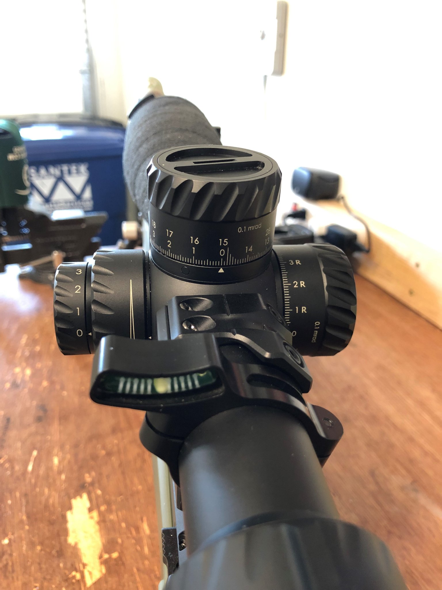

    Elevation - I zeroed on a 20moa base and I have in excess of 19mils of elevation up travel left. Elevation turret is 15mils per rev. Scope has 30mils of internal elevation and turrets are limited to 28mils.
    Turrets - Bar none the best turrets I have ever used. The tactile feel is perfect. The spacing is perfect. The turrets are audible with hearing protection. The toolless zero is a really nice feature that works well.
    My model came with the CCA “Click Count Assist”, same thing as S&B’s MTC turrets. Originally, I wasn’t crazy about them and wished I had got TT’s standard turrets. When it is mounted up and, on the rifle, the CCA is phenomenal. It is the only turrets I have confidence dialing elevation without looking at. No need to break cheek weld, just count the full mil heavy detents followed by whatever tenth you need. Because of the CCA these turrets are also exceptionally fast.
    The CCA on full mils has a slight wiggle, CW and CCW once on the full mil value, you do not notice this during use but is an observation to be noted. I suspect this has to do with the detent design.

    Second Revolution Indicator – metal piece that protrudes when past 15mils. There is no binding or increased resistance when entering the second rev indicator range. It is exceptionally smooth and starts at 14.8mils and is fully deployed at 15mils. I do wish the indicator was a different color. The exterior is black and the interior is unfinished. A different color would make it easier to pick out.
    Tangent Theta second rev indicator video
    Zero Stop and Zeroing – Zero stop is set at 0.6mils below zero. With the toolless zero you have the luxury of taking that out and having a hard stop on zero. The toolless zero is awesome, unscrew the cap 3 turns, adjust turret back to set point and tighten back down hand tight. No need for a coin or screw driver. They are plenty tight just using your fingers.
    Windage & Turret – Internal adjustment range is +/- 10mils. The turret is limited to +/- 6mils. The windage turret has a crisper feel and the CCA is tighter and more audible. I suspect this is to keep it from moving and I do not think I would like this feel on the elevation due to the resistance.
