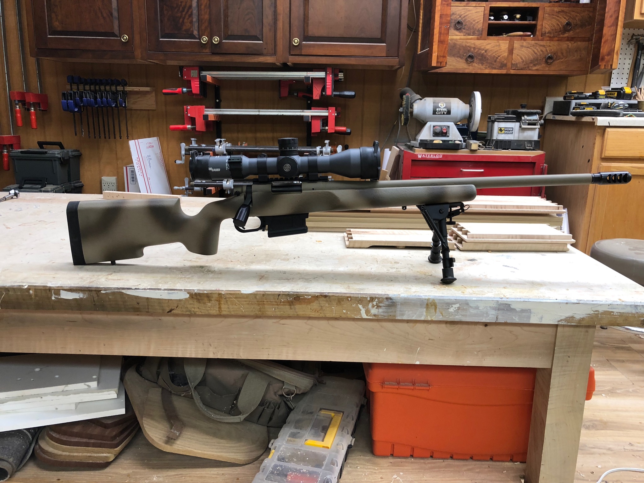

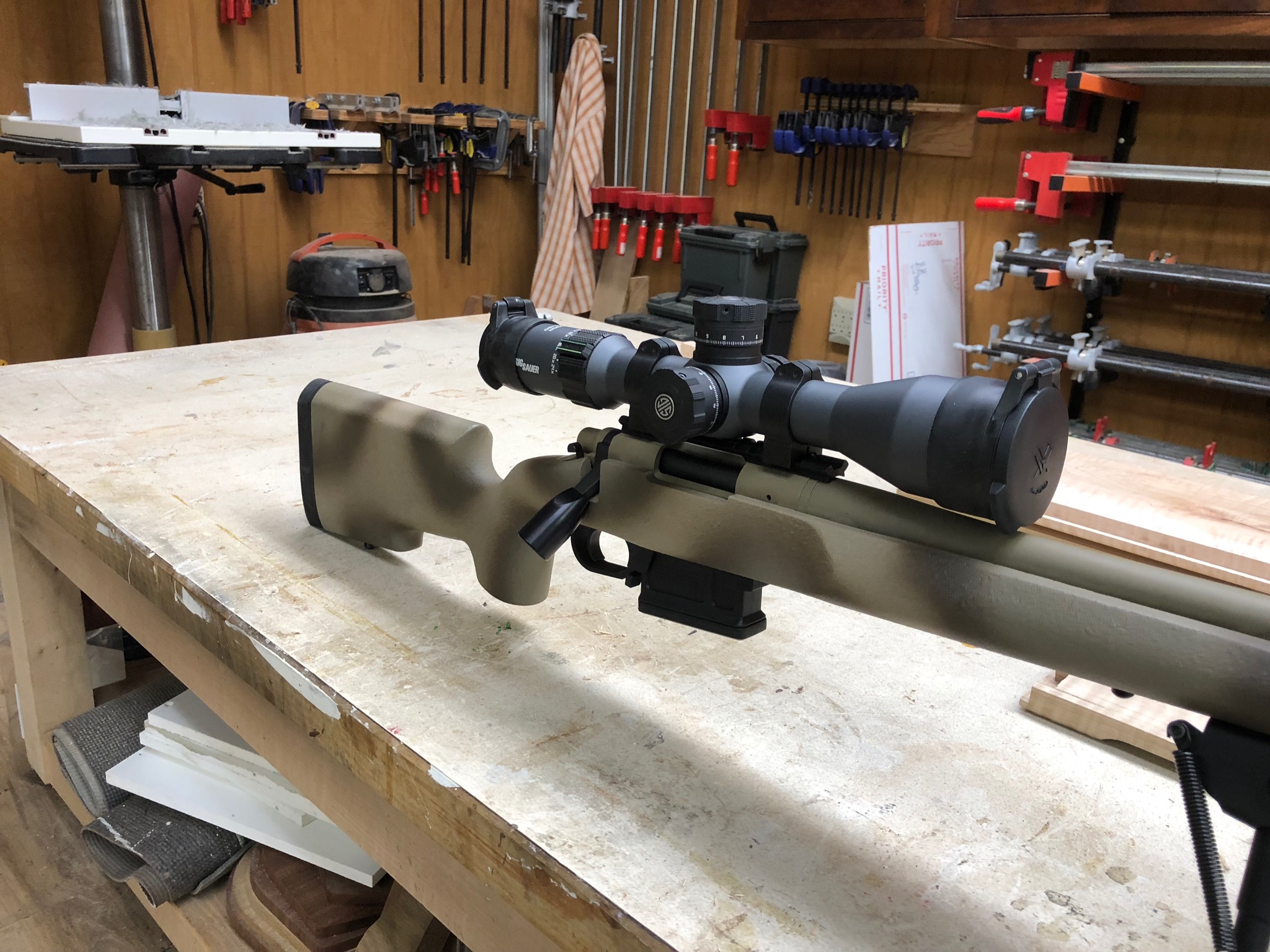

    I’m pretty sure these come in black and gray.

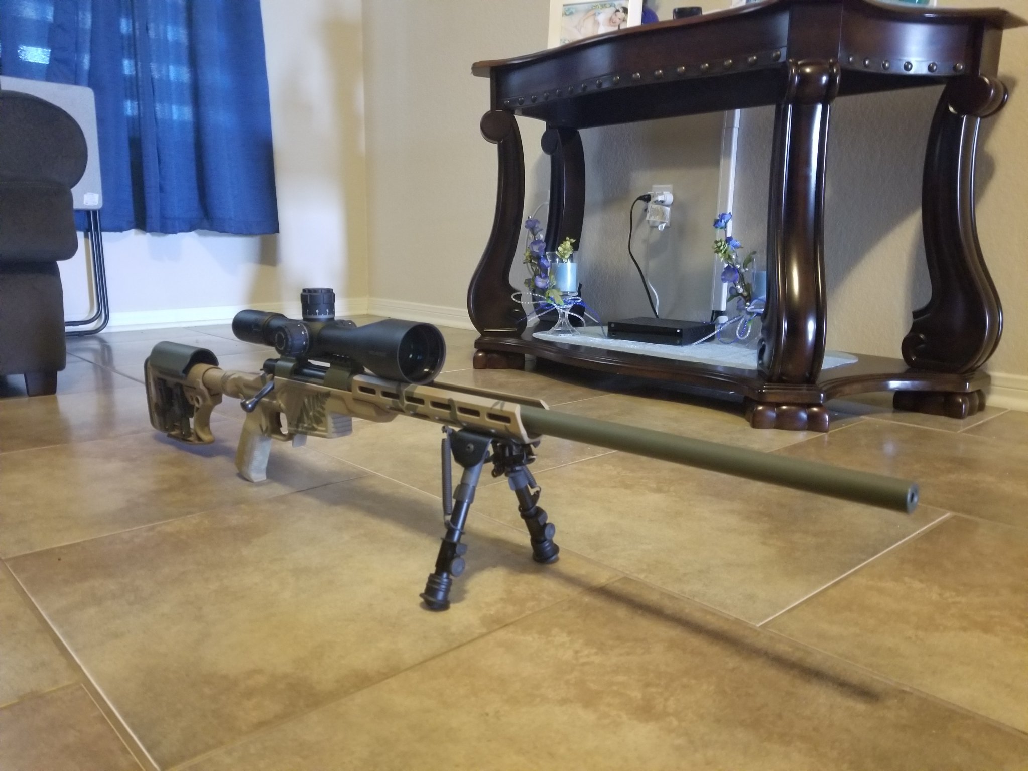

    Thank you for your input. Because I want to put this scope on a rifle I'll use for hunting, I really want a low power for the greater field of view. Nothing wrong with the lrhs but I love having a 3 power on my low end. I don't mind 4, and 4.5 is already a bit on the higher end of magnification power for me. I've taken deer at literally no more than 35 yards in the past and it's not uncommon for them to come up that close. While the ARC rings are absolutely great, I just wish lower options existed. Of course, .94 isn't too bad and if I had to, I would use them. Here is a pic with my rifle and a 6-30x56 weaver resting on the base and still has clearance. From the picture you can't tell, but I can slide a few dollar bills stacked together under with no problem
    ^^^ Nice little rig there. Regarding the rings, you have an adjustable cheek piece, you don't need super low rings??? I tend to think of anything over 35oz too heavy for anything I might take hunting, but that is my personal limit. I do love the Sig DEV-L reticle so if you don't mind the weight the Tango6 3-18 has the specs you are looking for. If you don't mind plan mil hash reticles and can give up a little FOV at the bottom the Tract Toric makes a great option, the other scopes I'd recommend are above your budget unless you're willing to do a 4-16 or 3-15 but I'm assuming you're looking for a little more on the top end. One other thought, the Vortex PST II 5-25x50 is a fantastic scope for the price and before you discount it saying it's 5x, check out the FOV numbers, the PST II actually has a wider FOV at 5x than the LRHSi at 4.5x and the Toric at 4x along with some other 4x scopes. When I look at scopes I pay close attention to the FOV numbers vs. the magnification because not all scopes are created equal :)
