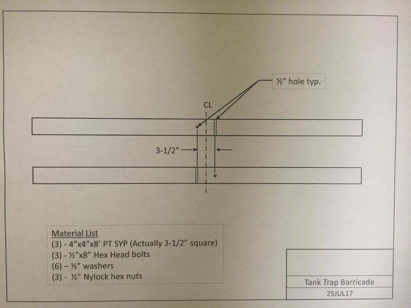

I want to make a tank trap out of wood to practice with in my backyard, therefore it doesn't need to be portable. Should be pretty simple to make, but I do not have measurements. Does anyone have dimensions or plans?
I used 6' 4x4's for mine, knocked the sharp edge off with the router. Used carriage bolts to hold it together, I didn't crank the bolts down leaving it slightly wobbly. I made a big X, then added the third piece.
That is essentially all there is to it unless you want it more perfect (not necessary really). If you want to lay it out first, measure to the center of the 4x4 lengthwise and draw a line edge-to-edge. Them mark for drilling 1-5/8" from one side of that line. Drill through. Turn 4x4 over so that you can mark and drill another hole 1-5/8" on the other side of that line, but on the adjacent side. You will now have two drilled through holes that are 3-1/2" apart, each 1-5/8" from the center of the board and perpendicular to each other.
Pre-drill all three 4x4s that way. I then used 8" long hex head bolts, two washers each and a nylock nut to assemble them together. I did tighten them up quite a bit, since mine was assembled at our club and gets quite a bit of use. Therefore it gets loose enough through use.
Oh, and I used 8'x4"x4"s.
Thanks for the info. So approximately how high is the point where the three 4x4's cross?
Excellent. I never even considered having it wobbly, I appreciate the thoughts.
If your question is what height is the crossing point after assembly, I would say it is about 3 to 3-1/2 feet where you can rest your weapon in the crease. I would measure it, but it is in the field at our club and I won't be there for a couple weeks.

Where is the 3D rendering? Not much of a tank trap with two horizontal parallel posts aren't to effective lol... Good thing you put actual dimension, some people would have been lost at the lumber yard without it!
Heh, heh...
I made the (perhaps misplaced) assumption that since we are posting in the DYI section that those building one might have the sense to know that I was supplying pre-fab info only.

8' x 4x4. See my post #12 above for a sketch with the material list and drill pattern.
I know I'm replying to a 4-year-old post, but I just built a tank trap following these directions and recommend you cut the 4x4s to 6 feet in length. 8 feet makes the trap ridiculously high, unless you're Lebron James on a stepladder. Using 8-foot pressure-treated lumber makes the trap heavy, and very unwieldy to assemble or to put away for transport. If you're not leaving the trap outside, consider non-treated.

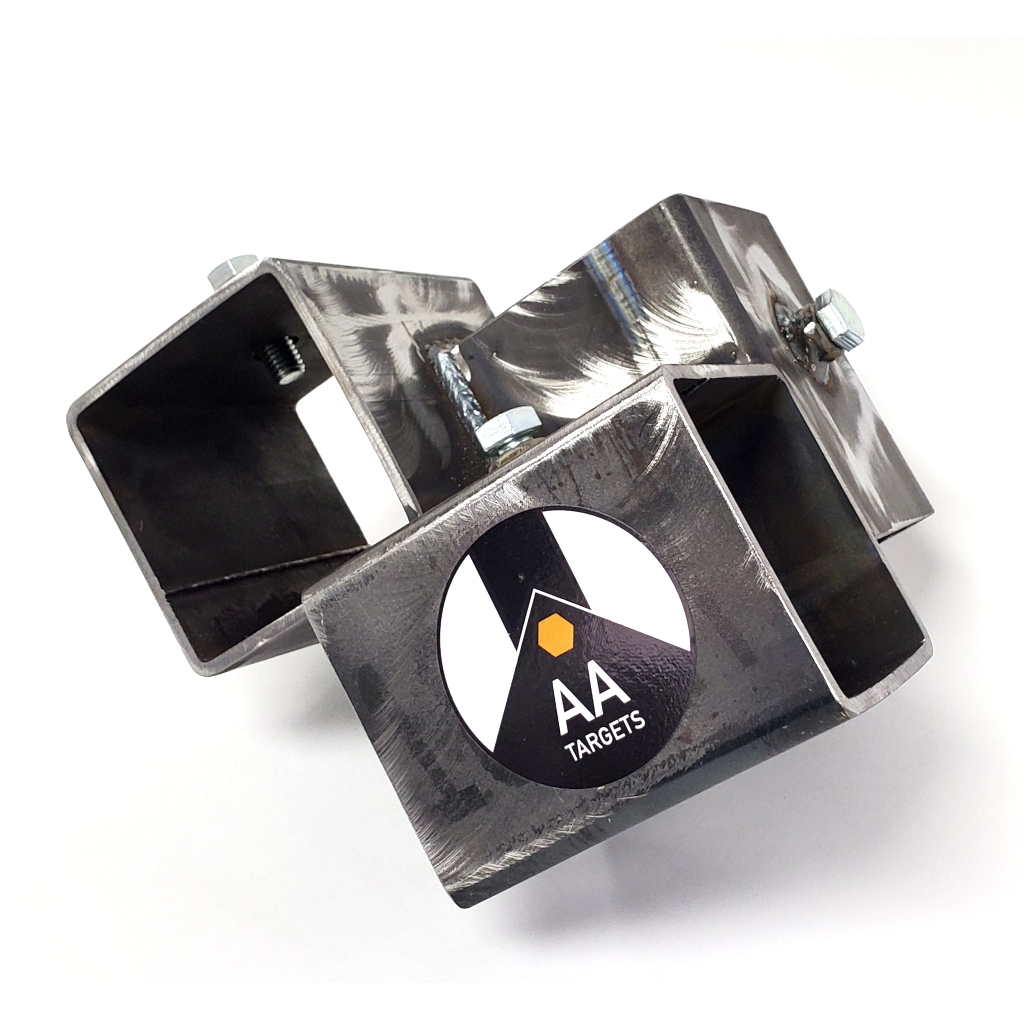

Your way is the manly way to do it. An easier way is to use the knuckle from Bison Tactical. The unmanly, cheaper way is how I did it, with 1/2” bolts.

Or you could buy the knuckle and trim at only one end, moving the knuckle around as you like. For a club, this is probably the best option.

To anyone using the plans that this diagram is a part of (https://nrl22.org/wp-content/uploads/2018/05/NRL22_Tank-Trap-Plans_Yuma-Masters.pdf) to build a tank trap:
The instructions say to drill two holes, each 1 5/8" on each side from the centerline, and states "You will now have two drilled through holes that are 3-1/2" apart". Just an FYI - 2 x 1 5/8" = 3 1/4", NOT 3 1/2", the width of a 4"x4". Use 1 3/4" for this measurement, not 1 5/8" if you want holes spaced at 3 1/2".
Also, I used the full 8' length to make my TT, but then cut two feet off the top of each 4x4. This gave me a wide and stable base, with a "spar height" of about 45", which is about what I see at the local NRL22 and MARS matches.

I had my son in law make me a knuckle for a tank trap for our club use.
The knuckle allows you to slide the wood in and out to adjust the length of the arms for uneven ground or just different height tops to shoot off.
