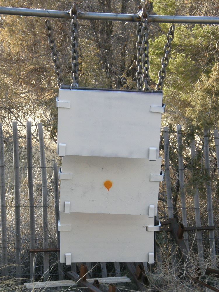

    We use 3/4 BigDogSteel IPSCs full size or 66% from 400-1600yds with both 308/300wm. The steel doesn’t break but occasionally the mounting breaks have issue. But that’s students shooting tens of thousands of 300wm/308. So I praise their durability at all ranges. At the ELR distances I would default to a hit indicator. Depending on wind mirage and whatnot determining an impact can be tough at and around a mile shot. Targets that are chained give more feedback but sometimes it’s a chain hit so these factors are worth considering shooting ELR.
    Reactions: Smittiac
    For one or two targets, consider getting a ShotMarker system rather that a steel target. You can make up multiple frame sizes, make the aiming point whatever size you like and instantly have precise impacts shown on a tablet out past two miles. The caveat is the bullet must be supersonic, so that's the range limiting factor. Past that distance basicly any piece of steel you can hang up and paint will work, since you are at pistol velocities. Many of our ELR targets are mild steel, cut in three pieces of 18"x 30" and hung in tiers so you can see from the plate movement where you are vertically. Adding a Magnetospeed T1000 is also helpful, a camera system is best for spotting the actual impacts at those ranges.

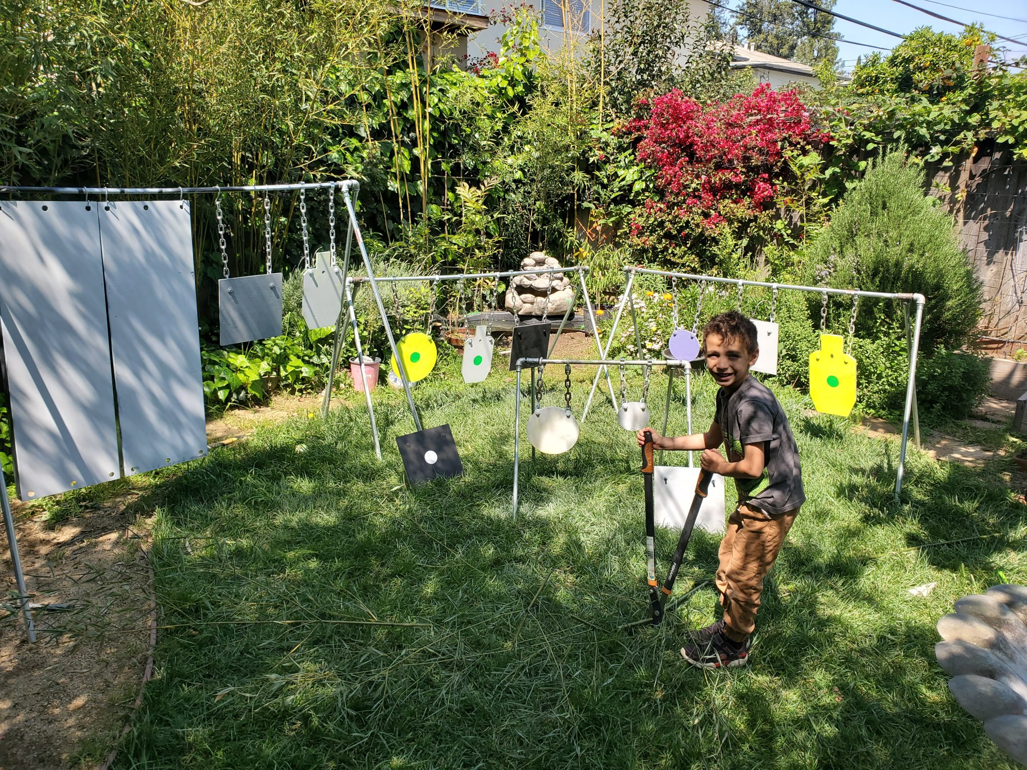

    For longer distance I was thinking of building a tiled hanger for 9- 12" square plates. 3 rows of 3. The top row covers the next rows hangers which are a few inches behind the top. Second row covers the 3rd rows hanger and which are a few inches behind that. From the front it would look like a 36" square or 3x3 tiles.
    At least thats how I picture it in my head. I make all my hangers from conduit and pipe parts from Home Depot so its very modular and custom.
