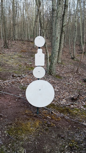

Here is my setup from HANG FAST TARGETS. 10% discount on every order to Snipers Hide members code: SNIPERSHIDE10
All targets hang easily on a T Post, very reactive and LOUD

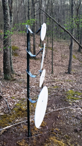

I went through this a while ago, I have a handful of smaller targets but it was tough to do my trueing on them at distance, so I got a package deal on Ebay for 2 66% ipsc silouhetts and I made a bracket to bolt them together when I need to but I did get good wind and elevation feed back and now I seperate them and smaller targets are easier to hit.

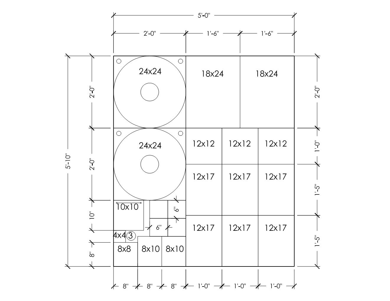

I got my tape measure out last night and the plate is a little bigger than I thought. 5'-10"x 5'-0".
Here is what I decided to make: - see attachment.
12"x12" or 12"x16" The will be the easy larger targets for learning and for friends. (These will also work for my pistol range training in the summer months when the crops are in the fields.)
Then I will a big plate for the 700 yard as an easy plate.
lastly I might try to make a KYL tree for 300 yards with plates from 10" down to 3"
I figure if I cut the plate large now I can always trim them smaller later.
With a 5x5 piece I wold cut it up something like this
We're thinking alike. I was just sketching the same idea.
Thanks all
Reactions: Snuby642
Well yours is a bit more crude than my rendering but I think it will do.

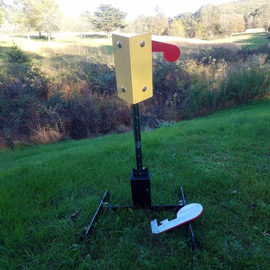

I had a guy that wanted a 1 moa target for his 300 yard rifle range so I designed this single plate reactive target that mounts on a T Post without tools.
Fully armored w/ 3/8" AR500. NO WELDS on the AR500
Plate sizes available 3, 4, 6 and 8 inch 3/8" AR500. Plates change in seconds without tools.
SINGLE PLATE SWINGER 10% OFF TO SNIPERSHIDE MEMBERS code: SNIPERSHIDE10
use with our T Post Base or just pound the post in the ground
