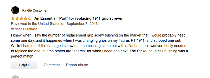

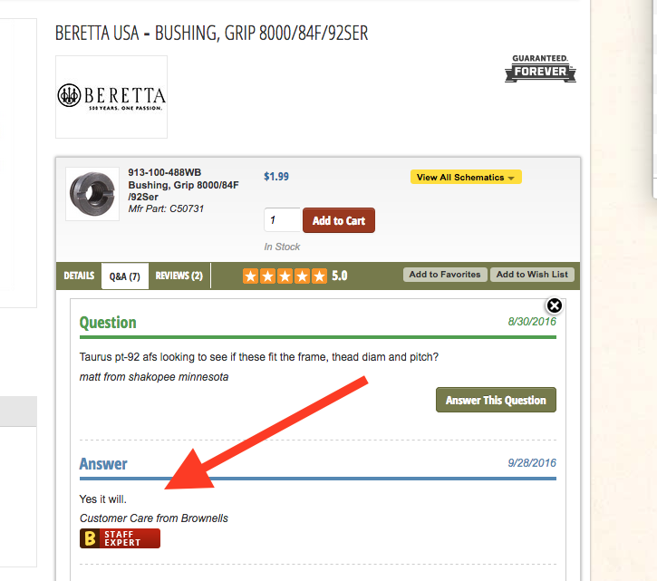

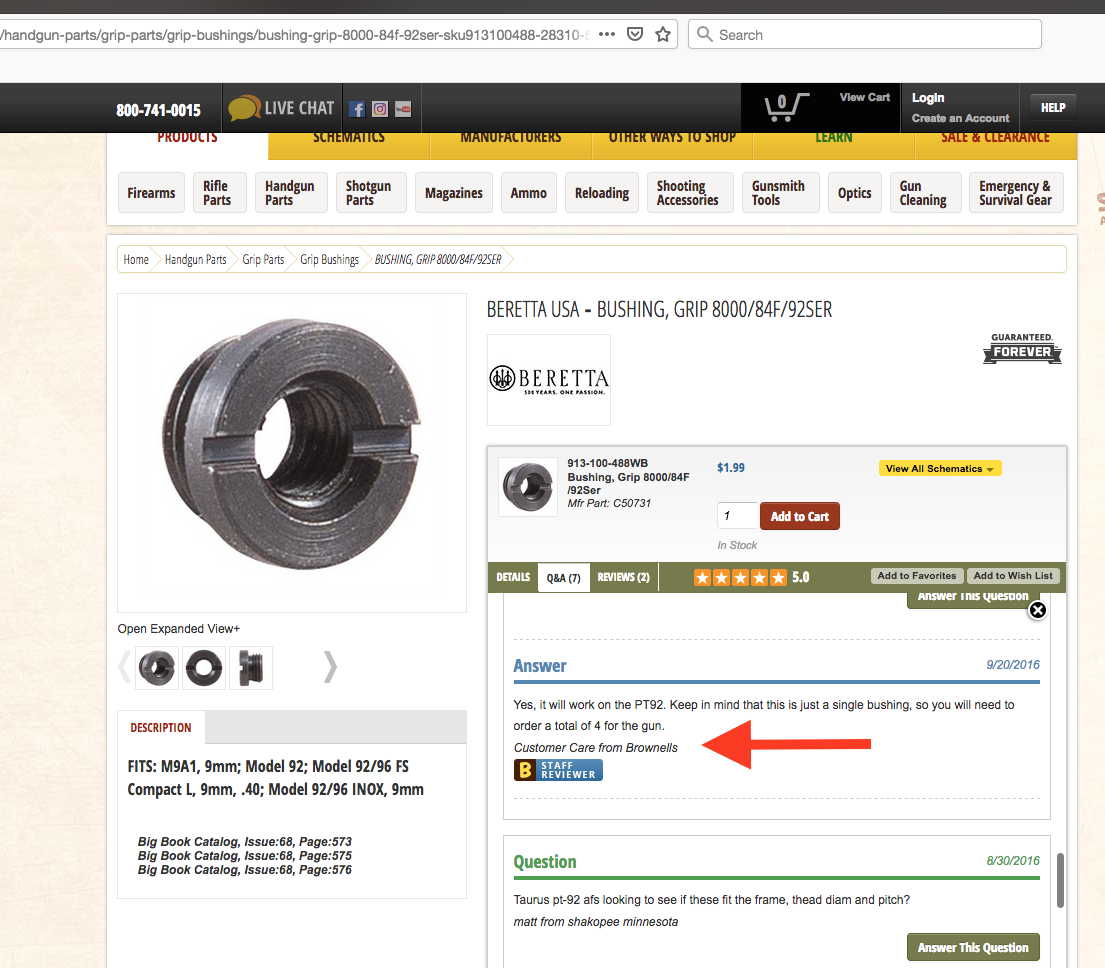

I am fairly sure that the Beretta 92 share the same frame bushings as the Taurus. Order a few from Brownells.

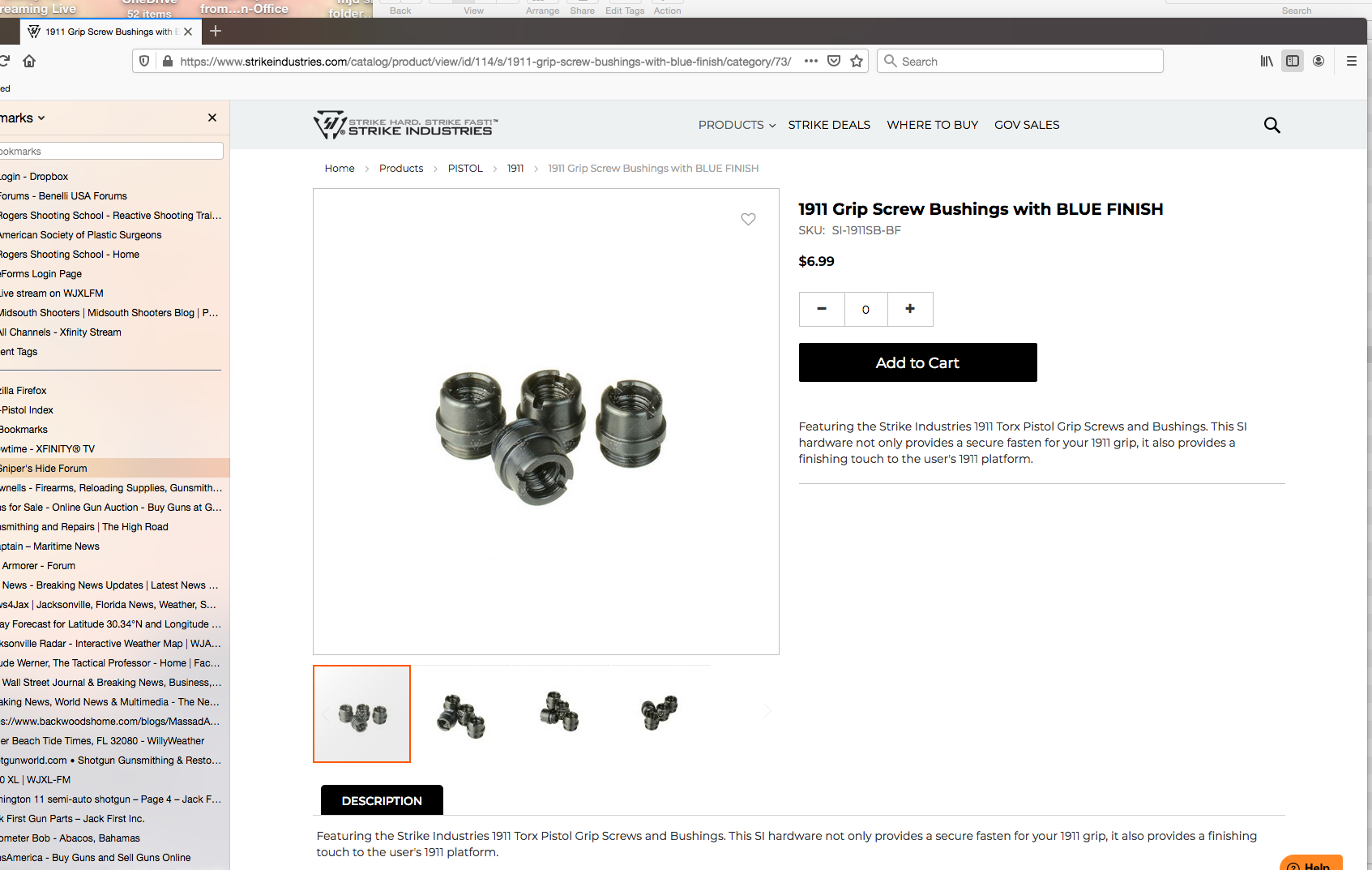

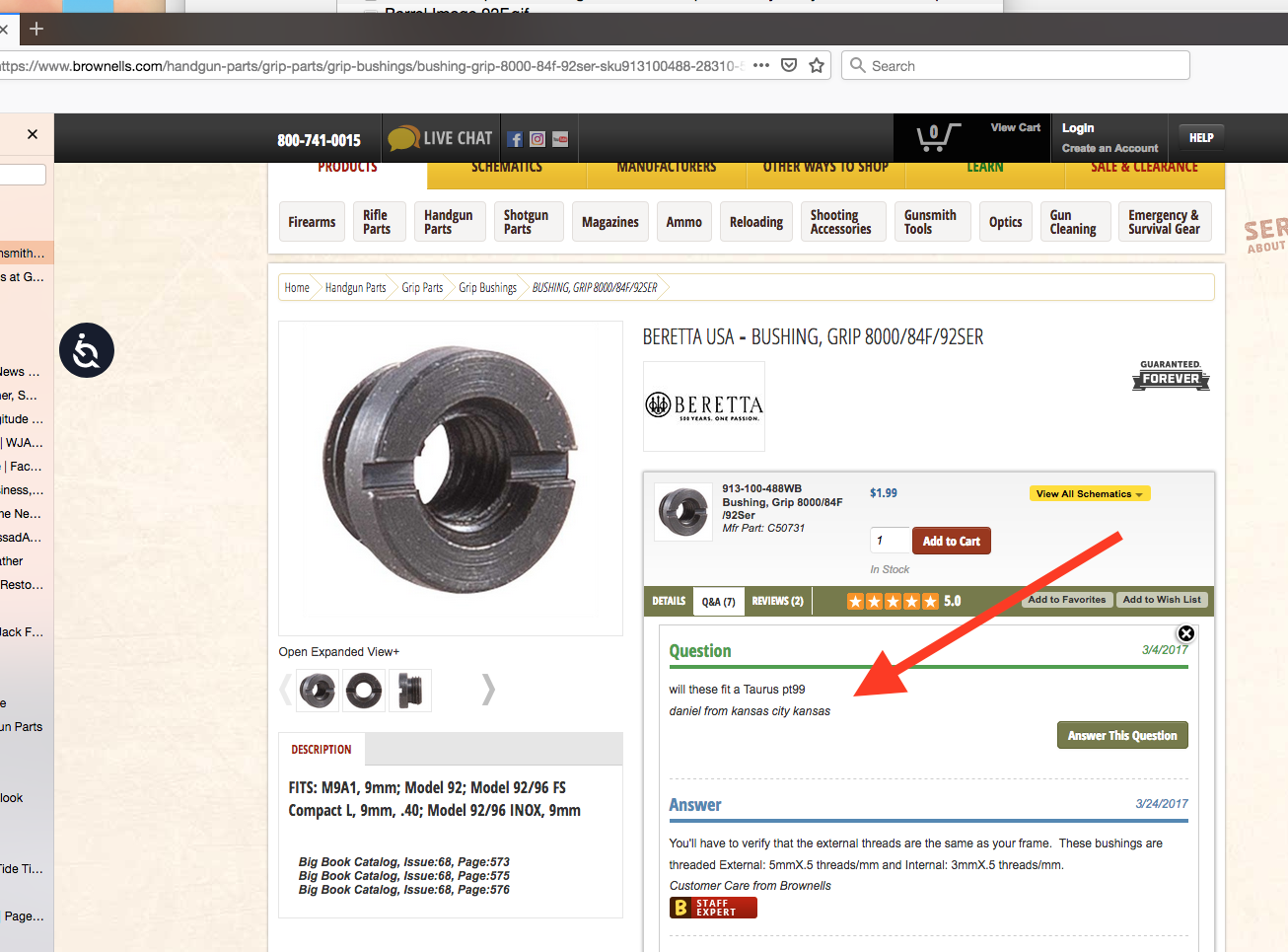

I think the bushings linked above are for the Taurus Beretta clone, not a 1911. What threads are stripped out, the bushing to frame or bushing to grip screw? What's too small with the bushings you've already bought, diameter or height?
I bought some oversized bushings from brownells measured ID of hole and it is .253 I’m not sure how they measure there threads from outside or inside of threads they are claiming .255
