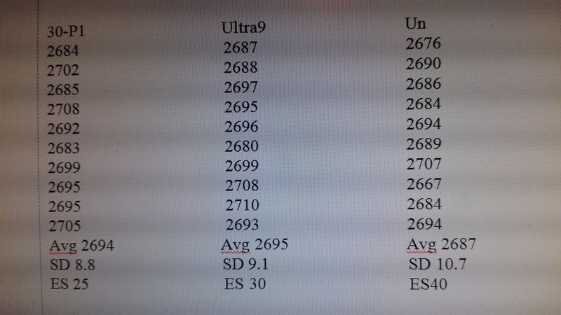

I am not sure 100% what all these numbers mean, but I think I have a good idea. The reason I did this was because people are always talking about how the cans affect FPS vs unsuppressed, "slow the bullet, speed it up, doesn't do anything", and with the different weight of the cans, I figured what the hell it wouldn't hurt to record a few numbers just so they are there and for the smart people here to try and help out.

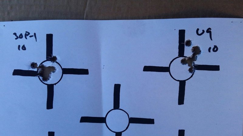

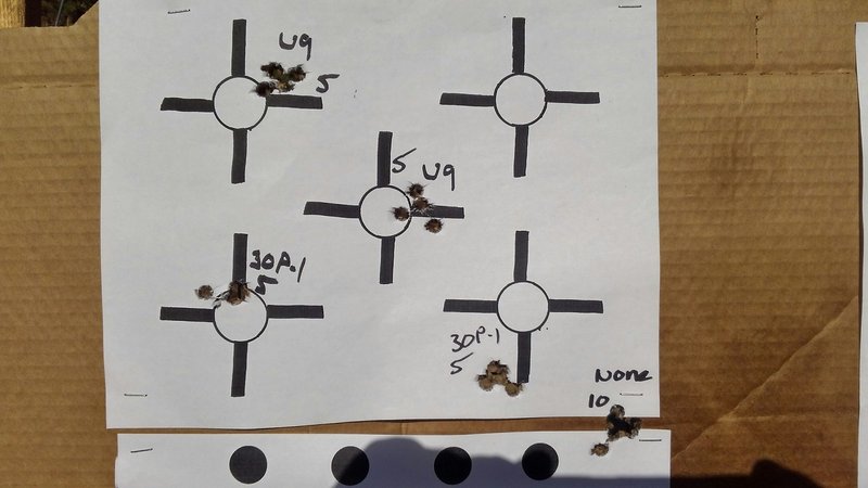

To my untrained eye, it looks like the numbers from the 2 cans are comparable but I don't understand why the difference in group size between the 2 cans. The pics below are a good average sample of group size for each respective can and round count and not cherry picked to say, "hey look at me with my 2 shot group with both holes touching!". I did shank a few shots as you will see in the pics.

for reference, the circles are 1"

I dont see anything too terrible with your groups. Make sure your can is tight. My other advice would be to start doing some cardio and stop smoking (nicotine is a stimulant and makes your hear rate go up) it doesn't help your shooting. Your second photo with only the 30-P vs U9, the U9 has vertical stringing to your shot group which would tell me its either your breathing or when your barrel gets warm it starts to string.
Also try shooting some ammo other than 168's, not sure what class you are planning on going to, but 168's were known to not transition well from supersonic to subsonic at distance usually stuff past 600 yds. .
From the pictured groups, I do not see a statistical difference between group sizes. On screen, the max extent of the uns group is larger or the exact same size as the top left 30P-1 group.
There is more vertical stringing in that one U9 group vs the 30P-1 group, but your uns group has a large vertical spread with the low left included also. If you want us to take a look at the can, we'd be happy to, of course.
It may well be you. I say that from looking at your groups on the 30P-1. Maybe it was something intentional, but your points of impact were dramatically different on the two groups. Both groups were small, but the bullets struck in very different locations relative to what I assume was your point of aim. This kind of thing (wandering zero) is almost always due to inconsistency in the shooters position.Try this as an experiment. Shoot a group of five without breaking position. Shoot another group of five where you come all the way off the gun between shots. Stand up and walk around. If the second group is much larger, you'll know you need to work on a consistent position.
If all of the above proves true, then I think the tiny difference you see in group sizes may well be shooter induced.
BTW, I have those same two cans and both are hammers. No detectible difference between them (except the Ultra is a little quitter.)

i have not noticed any difference with a warmer barrel compared to a cooler barrel. when the barrel heats up, the only thing that affects accuracy is barrel mirage affecting my sight picture. the can is tight. but now that you mention it, the 30p-1 needs a few minutes to cool off before i can remove it, the U9 comes off right away. i try not to smoke too much when i'm shooting. i noticed a few years ago what you mentioned. if i do have a smoke, it' when i know it will be awhile before im ready to get back it.
POI were sorta intentional. i get a different POI from the 2 different cans. it is zeroed for the U9. on one 30p-1 group, i didn't move my turrets, on the other 30-p1 i did move the turrets so i can do a dot drill. the UNS group was just aiming at a random dot on the target below just so i could shoot a quick group. the wondering zero isn't shooter error. i have done the build and break drill before, and due to my check weld, my "zero" will wonder high .2-.3mil. this is something i am trying to work on and why it was so frustrating when shooting the U9, it's just not as consistent as the 30-p1. a few time vertical stringing has been brought up. i will pay more attention to the can being tight.

that was one of my thoughts, which is why i did the unsuppressed group. i have another U9 that is brand new (bought 2 at the same time) so i am going to the range today to do some testing.
i'll be taking; 30P-1, 2 ultra9s and saker 762
It does not come across as bitch session about TBAC. You've simply experienced something you haven't encountered before. I'm really curious to see how the two U9's compare against each other and if there are any poi changes between the two. To finish you should shoot a 10 round(2x5) group alternating the two U9's after each shot. Keeping the same poa.
