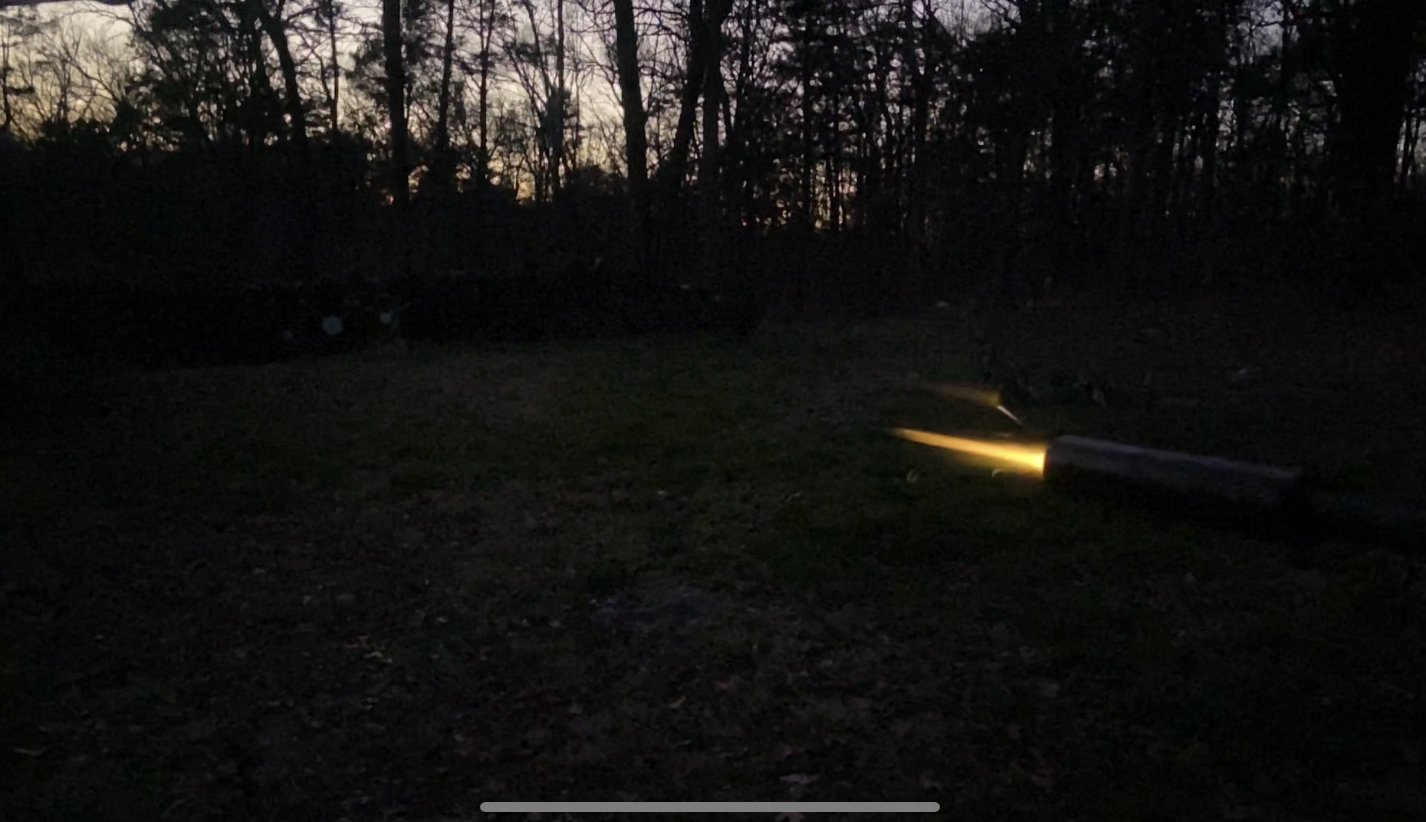

I’ve got their flash hider on a 300 BLK, but it’s on a 16” bolt gun. I’ll try to shoot it at night this weekend without the Ultra 7 on the end and get a video for you. My 10” 300 BLK AR has the CB brake and it throws fireballs, maybe I should swap those two around. But I almost never shoot them naked.
That would be awesome. If you could do a comparison to having the can on, that would be helpful as well :)
Ok here are two clips taken from videos of the TBAC flash hider and the Ultra 7, both shown firing a 110 Barnes TAC-TX at around 2400 from a 16” bolt rifle. I believe 20 grains of Win 296 was used for these rounds. It was darker outside than my phone camera made it look like. I have videos but it’s not letting me upload them. I was surprised to see that the can had more flash than the flash hider without the can attached had.
