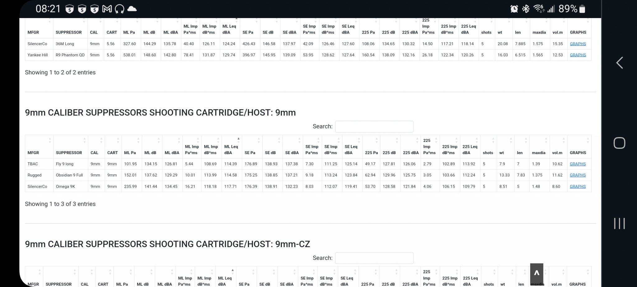

Check out the silencer summit 2023 results
Screenshotted this.
