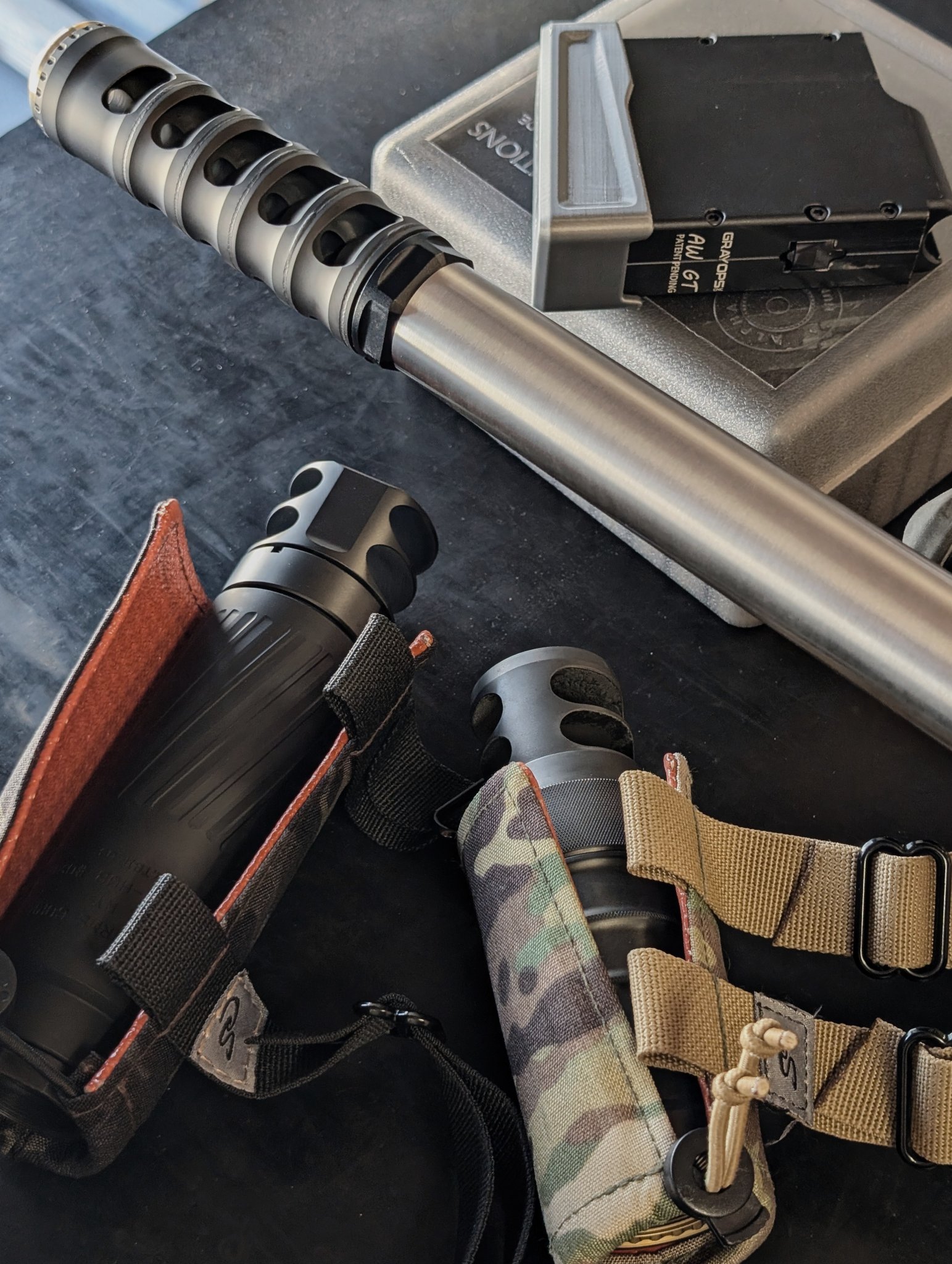

For background, I've owned by Maverick from nearly the point it was released. I've used it enough through several PRS seasons that I'm quite familiar with it. I've sent it back to Area419 for several cleanings and a separated baffle stack (that occured during a 2 day match). They have always taken care of it, no issues. It is an EXCELLENT performing suppressor for its intended use. I run it in the shortest configuration. It has certainly helped with the longevity of my shooting sessions when doing PRS specific repetitions.
I recently picked up the Magnus RR-K and Without Warning CHAD (to shoot in suppressor unfriendly states and countries).
After putting a few rounds through all 3, I'll share my initial thoughts:
The Magnus RR-K certainly has a more suppressor feel vs the Maverick. The Maverick, to me, feels more like a brake with the signature 'snap' when you shoot it. It rarely leaves the target by much and remains easy to drive. I've always appreciated that I don't have a headache after 2 days of constant shooting or with heavy training regiments. When comparing the two suppressors, you can notice the opening of the last aperture on the Magnus RR-K is the same as the bore diameter and the Maverick is a little larger. This was at quick glance. So, I think this may slightly drive how they perform differently.
The Magnus RR-K has a slight push with a small off-target drive. Now, this could simply be something that I need to train better for or that I simply haven't shot the suppressor enough to anticipate and understand the feel of it. It is something I will be working on. It is not loud when compared to the Maverick (outside the shooter's perspective). In that sense, it is definitely quieter IMHO. From the shooter's perspective, I liked the overall sound and tone of the Magnus RR-K vs the Maverick.
The CHAD is quite a brake. I've used the Sidewinder, Hellfire Match, APA, and ACE in the past. I have mostly removed myself from shooting brakes simply due to the fact that I get really bad headaches after long sessions of shooting. And quite honestly, it's one of the main reasons I've stopped shooting Open guns in USPSA. (Decades in the Army finally caught up). So the reason for this purchase was to simply use the CHAD when I travel to locations that don't allow me to use suppressors. The problems that I've had with other brakes is the concussion felt at the shooter. Previous brakes were HORRIBLE. The CHAD does not have that same concussion effect that I've experienced in the past. However, the sound signature from outside the shooter is certainly there. When shooting the CHAD, I noticed what can be described best as a gust of wind flying "around me" vs "at me." The CHAD performs as intended and advertised, and likely the best brake I've ever shot. It literally does not move off target. After shooting targets at 525 and 585 yards with build and break drills on a wobbly ladder and single bag, the performance of the CHAD is quite apparent and a positive one. The price tag, however, is hard to swallow. So, I get it...
So what will I use going forward?
At this point I will likely be trying my next 2 day match with the Magnus RR-K, with the Maverick sitting on my backup rifle that I usually bring. I was happy with the Magnus RR-K and it's initial performance. The CHAD will be put away and likely only be used when I'm forced to shoot a brake. It is a stellar performing brake, but brakes still remain a contentious issue for my brain, ears, and sinuses.

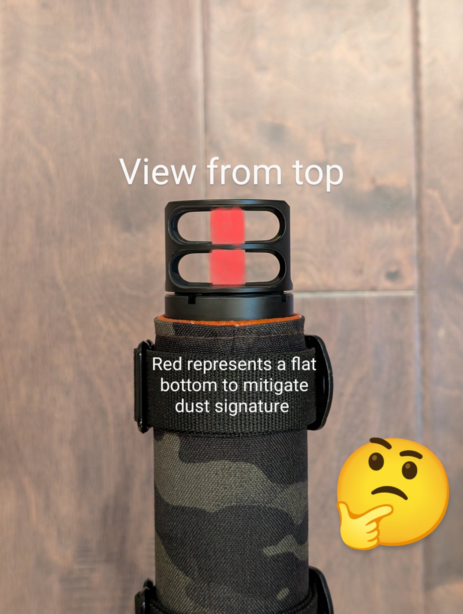

I'm looking into both of these suppressor options for PRS... is it possible to orient the Maverick ports vertically as well, and if so, have you tested that configuration?

Excuse my award winning art ability:

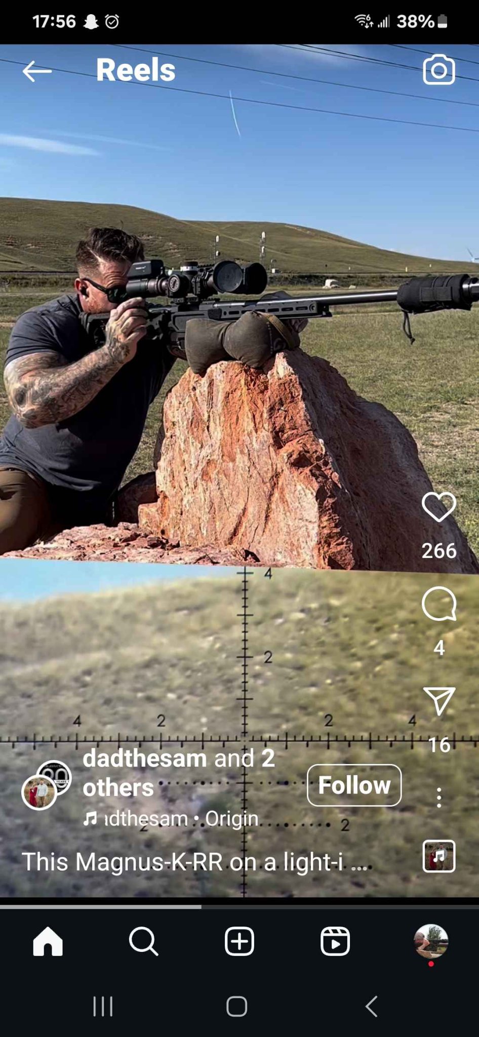

I shot the Magnus K RR at the Nut Crusher match in Price Utah this weekend and took #13, with a few bad trigger presses away from the top 10. The comments about it not performing are ridiculous; you just need to learn to shoot better. (And by the way, my ports were clocked in the standard configuration with zero issues).
The difference between a Maverick and Magnus (in the normal configuration) is significant. 😉
That's interesting my first thought is the physics at the muzzle end should be same regardless I would assume.... Is it possible it doesn't control the muzzle rise in the horizontal orientation then due to the recoil management style from your form?
That's interesting my first thought is the physics at the muzzle end should be same regardless I would assume.... Is it possible it doesn't control the muzzle rise in the horizontal orientation then do to the recoil management style from your form?
If you compare the TBAC RR vs the Maverick, the latter has a flat bottom. When you shoot the Maverick, the gases travel out and up, which lends itself to be more effective at muzzle rise. (Driving it down)
This does not exist on the RR because the ports are symmetrical top and bottom. With a recoil impulse that already heavy biases the muzzle in an upwards motion, the extra gas from the bottom makes it a little more apparent. The 12/6 orientation mitigates that, with the trade off being dust signature. I'm about to shoot a 2 day match with the RR, so either I'm gonna suck bad with my new equipment or be at/around my normal expectations (80+%). We shall see...
