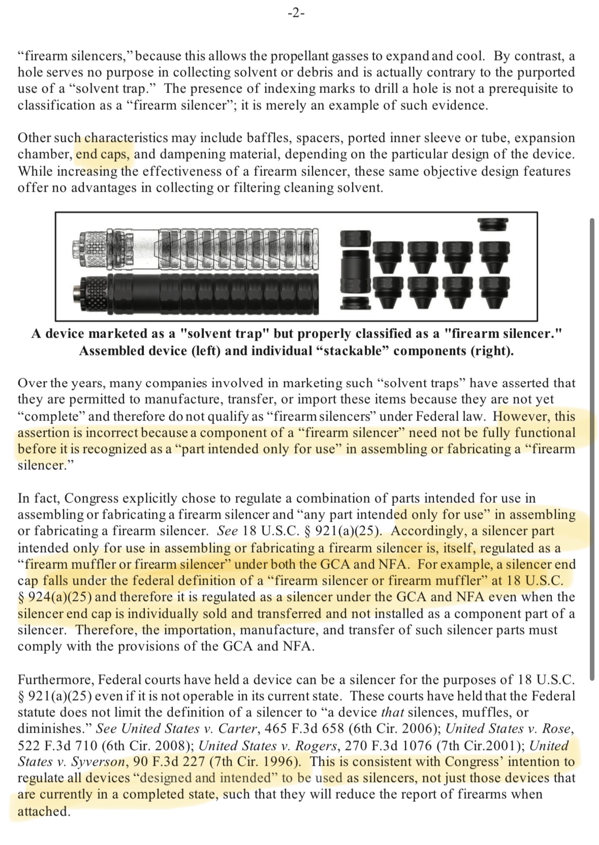

The sentence that starts with "For example," on the second to last paragraph on page 2 spells it out very specifically. It also says the exact same thing in 18 USC. This is not "our" interpretation, as I said in the other thread, we also got consultation from one of the leading NFA law firms in the country before any of these products was announced publicly.
I know other people sell endcaps separately. It is beyond frustrating from our perspective, believe me. We want to be making great cans and giving great service 10, 20, 30+ years from now and we can't do that if we're shut down due to violations. Let's hope this administration can make some concrete progress deregulating suppressors.
As for the warranty-- it wouldn't, why would it? We don't "automatically" void warranties for using third party mounts. Just don't use a product that is poorly designed and causes damage or causes problems, that's on them/you.
I can see where they are coming from with a separate end cap being constructed as solvent trap parts etc… but they are selling the “for” silencers and not traps so I can see the argument both ways.
That's an interesting standard to go off of... Based off this paper's logic all detachable mounting systems(HUB or similar systems) are considered a silencer itself. While it's using an end cap as an example it says "a silencer part intended only for use in assembling or fabricating a firearm silencer". I think it's obvious this is targeted towards solvent trap kit parts otherwise the ATF would have targeted almost every suppressor manufacturer making and selling detachable suppressor mounts and endcaps.
