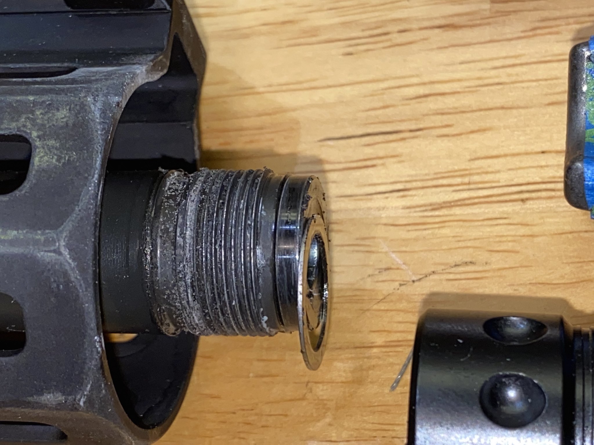

TBAC Suppressor Loctite
treillw
Mar 3, 2017
673
86
I've gotten away without locking the TBAC break onto my rifle for a few years, but now it is stuck in my can..... :LOL:
Anyway to remove the break without just thread locking it to the barrel and then unscrewing the can? I'd like to tighten the break independently and make sure it's timed properly.
TBAC suggests red loctite fo the break. Makes me a little nervous that it is "permanent". Is it still possible to remove the break if desired? Just shoot it a bunch to heat it up and then remove it??
Thanks!

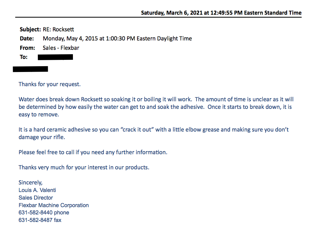

Red loctite anaerobic adhesive disintegrates @ 550 deg F. Most mfg. recommend a ceramic based adhesive e.g. Rocksett, which is included in SureFire brakes packaging. Rocksett is stable to ~2,000 deg F. Most brakes / suppressors will never get that hot, although rapid fire / full auto magazine dumps can get the muzzle temp ~900-1,000 deg range. The nice property of Rocksett is that it is easily removed by soaking the muzzle device in warm water first , then applying the brake wrench; no heat application required.
Again, it's not a adhesive strength issue, it's the heat that is the enemy of defeat when end-user desires a fail safe assembly for their muzzle device applications. Suggest you forward your interesting ideas to Flexbar and Surefire; please post their responses. YMMV.

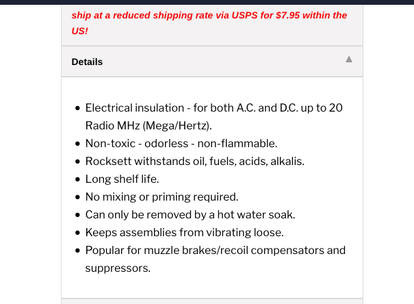

Don't use red, don't use blue.
Use this one, works wayyyyy better.
  • Wow
Reactions: DIBBS

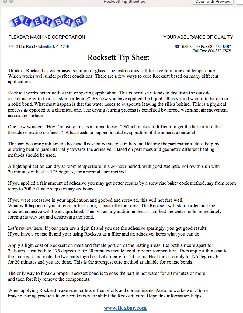

Everybody that's used Rocksett becomes an expert/champion of the product and always mentions soaking in water to release. And most lock on to the name and think it's strong as shit. It is a good product and I use but it's not very strong and you don't have to soak in water to get it off.
I've used rockset a few times and neither time did I do anything but break it loose. That's fine btw, but I have used red lock tight since and it's just easier and better imo. I can heat the brake up and remove it if I need to and I've never had any issues with a brake coming loose on a can with it. I don't shoot long strings and really high Temps so I don't know much about how either do in those situations

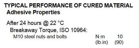

I believe my last post explains why high temp red (272) is more than sufficient for retention during extended high temp use (that video shows 2640 rounds fired) and the downside of a lower breakway torque with rocksett. That's a good summary of why we recommend high temp red.
I'm sure these guys have tested everything.
My choice is loctite 272 also.

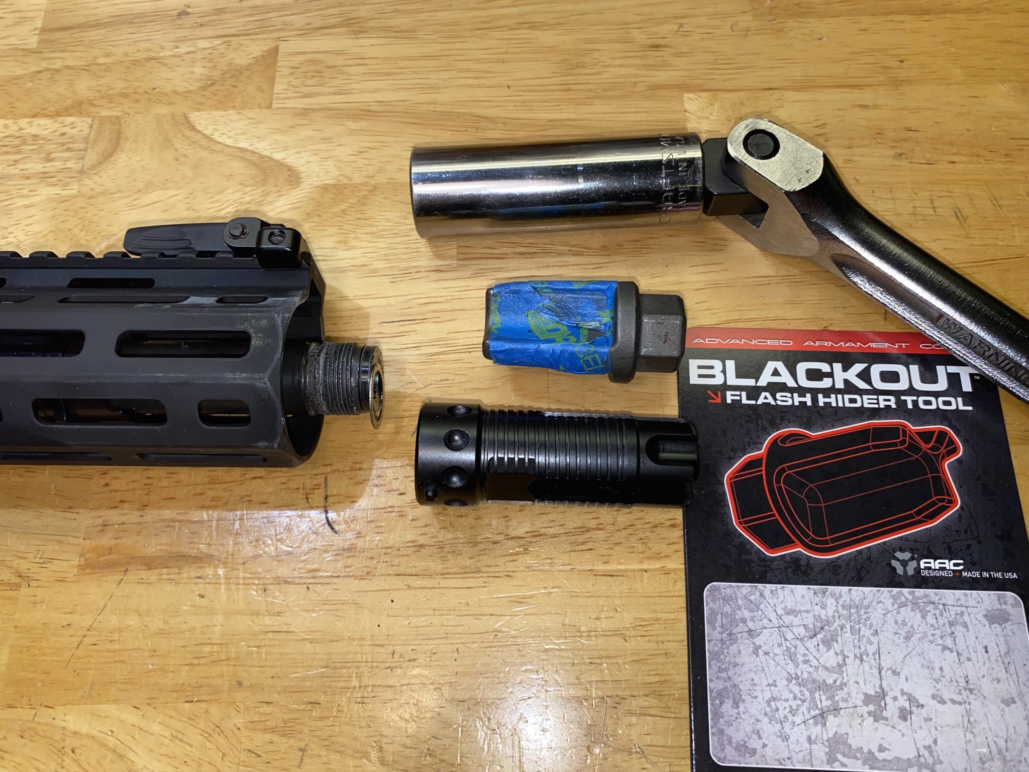

To get the brake out of the can, hand tighten the can/stuck brake on the barrel. Get a dead blow hammer and give a couple good raps down near the bottom of the can. I’m sure it’s slightly carbon locked on the brake.

I see both numbers in the referenced data sheets:
Regardless of which units we're using, I still don't understand why I'd use 290 during the installation of a muzzle device. If for some reason I needed to secure a muzzle device that had previously been installed, sure, if there was a good reason for me to not spend 5-10 minutes to spin it off, install 272, and re-torque.
No, don't always need to use water, like prior posting indicated, depends on how much was applied. As to the preferred "expert" method of releasing the adhesive, it's what Rocksett recommends, because unlike others, I actually invested the time to axe them.
Just removed the flash device on this KAC 14.5" ACC upper; Rocksett applied only for ~ 3 threads, which is released with just a proper
wrench / device adapter.

I love this stuff. Once I switched over, I've never had to go what this guy is going through. Note to self: Don't use too much or else the only way to get the damn brake off later is immersion in hot water for a while.
Reactions: Snuby642
That Sir is the Gospel. Go my people and spread the word.
