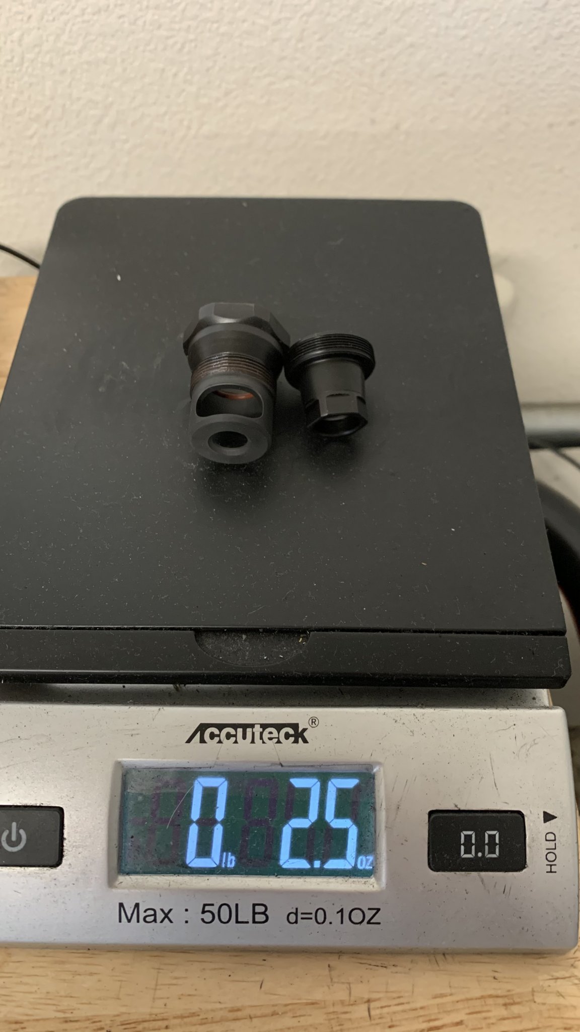

id have to look but isnt the CB 2.6oz? if so thats awesome that you arent adding anything other than 1/4 inch or so.
