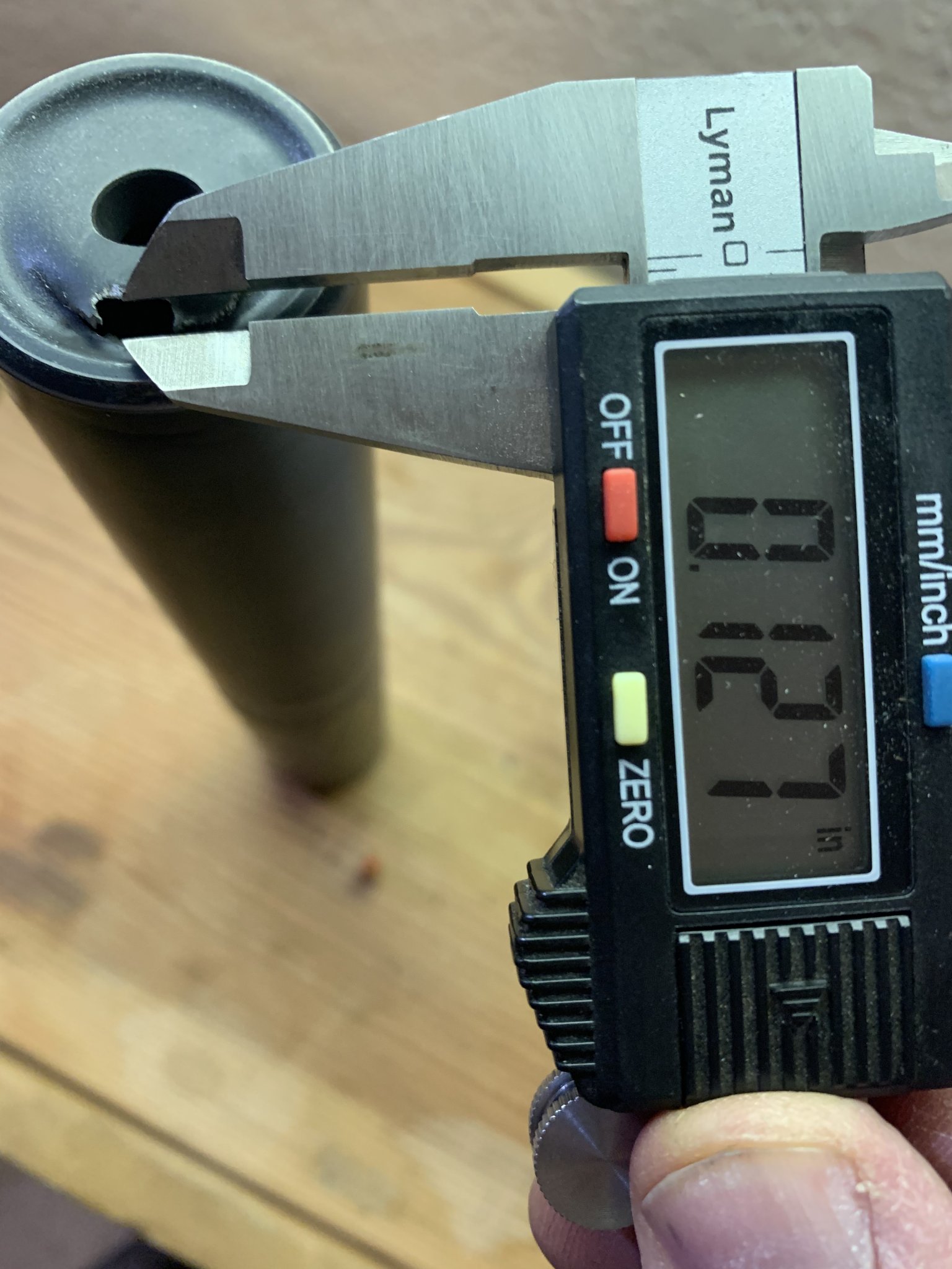

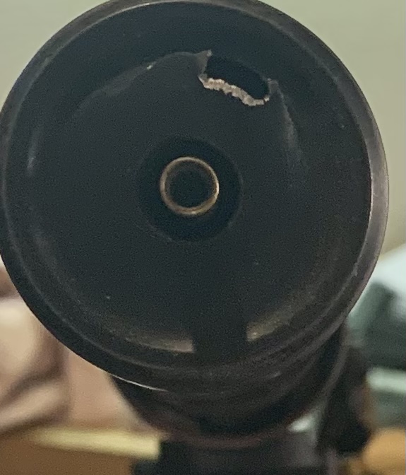

Suppressors TBAC Ultra 9 endcap strike
drglock
Old fat guy
  • Jan 13, 2012
    2,037
    2,525
    Morrison,Oklahoma
    Already contacted TBAC and will be sending it in this week. Only thing I can think happened was a weld failure. I’ve had it since 2016 on multiple guns, 6 Creedmoor, 6.5 Creedmoor, 308 and .223. Not sure on round count but should be in the neighborhood of 1000 rounds. Had it on my 16” AR today just to check zero and check dope at distance. This gun is used for coyote hunting only. Never shot more than 5-10 rounds in a row at any one time. Never more than 5 with the AR, no mag dumps and no fast strings through it. The load I was using today was 24.3grs IMR 4064, 60gr Vmax’s, CCI SRP and Winchester brass. Velocity is 2667fps. Shot 5 getting my zero. Then switched to my 22 to sight it in and get my DSF out to 400 to get it ready for this season’s matches. Before I left the range I had 4 rounds of my .223 left and shot targets at 200,250,300 and 350 yards. Not sure on which shot it failed. All shots hit the steel targets and it wasn’t till I was putting it in the gun rack at the range that I noticed it.
    This is a Ultra 9 30 cal.

    Interesting damage. My non-professional guess would also be a projectile coming apart. I suppose there isn't any rattle if you shook the can?
    I may not be 100% correct or grounded in science with this feeling but I'm always hesitant to use my TBAC cans on anything other than my precision bolt guns due to the welded front caps. I know TBAC has great support but seems front cap strikes are the most common strike if it happens and I use other cans for ARs as I can just screw on a new front cap.
    I’m going to guess it failed on previous shots. Not the last few. I don’t see a bullet coming apart and hitting a target at 200-350 yards
    I say it failed on previous shots or you sent a foreign object unknowingly down the bore with a round

    You had a pin or two in a flash hole. I had a similar endcap failure on my U7 and thought it was an issue with the metal or something. Once they cleaned it out and sent it back with a new end cap, there were several obvious strikes from cleaning pins in the baffles. I still wasn't convinced until I started processing another batch of 223 brass and found a case with 2 pins wedged in the flash hole, slightly recessed from the bottom of the primer pocket. They were almost impossible to see unless you looked dead on at the flash hole and realized there was no light coming through.
    The damage to my end cap looked VERY similar to yours, just on the actual aperture in the end cap instead of off to the side. TBAC was able to repair mine after a deep cleaning (which took quite a while due to the amount of carbon build up), and it still runs great. I've since stopped using steel pins entirely for my brass processing.

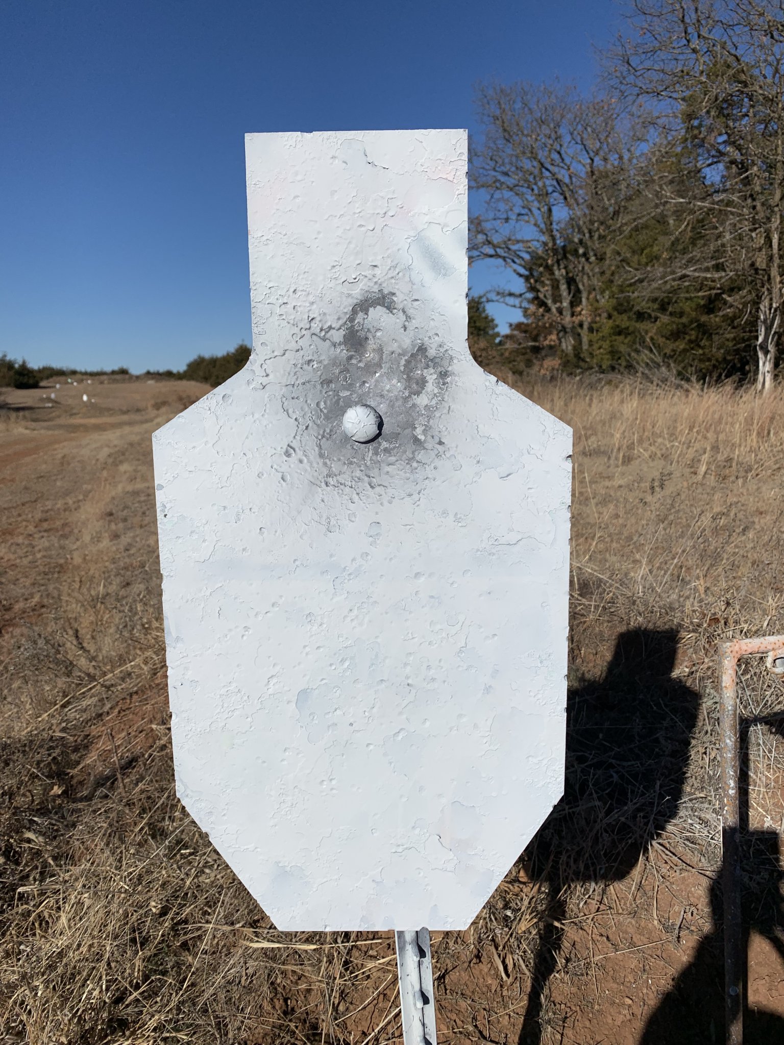

    OP also said that the bullets hit the target...
    Same thing happened when I had a pin blow mine out. I didn't realize anything was weird until I open the bolt and went muzzle up and had a bunch of carbon fall down the barrel and out of the ejection port. Then I looked at the muzzle and saw the hole. The baffle strikes I had from pins weren't visible at all until TBAC cleaned out all the carbon, either. Once they did, you could clearly see them.
    This makes more sense to me than anything else.

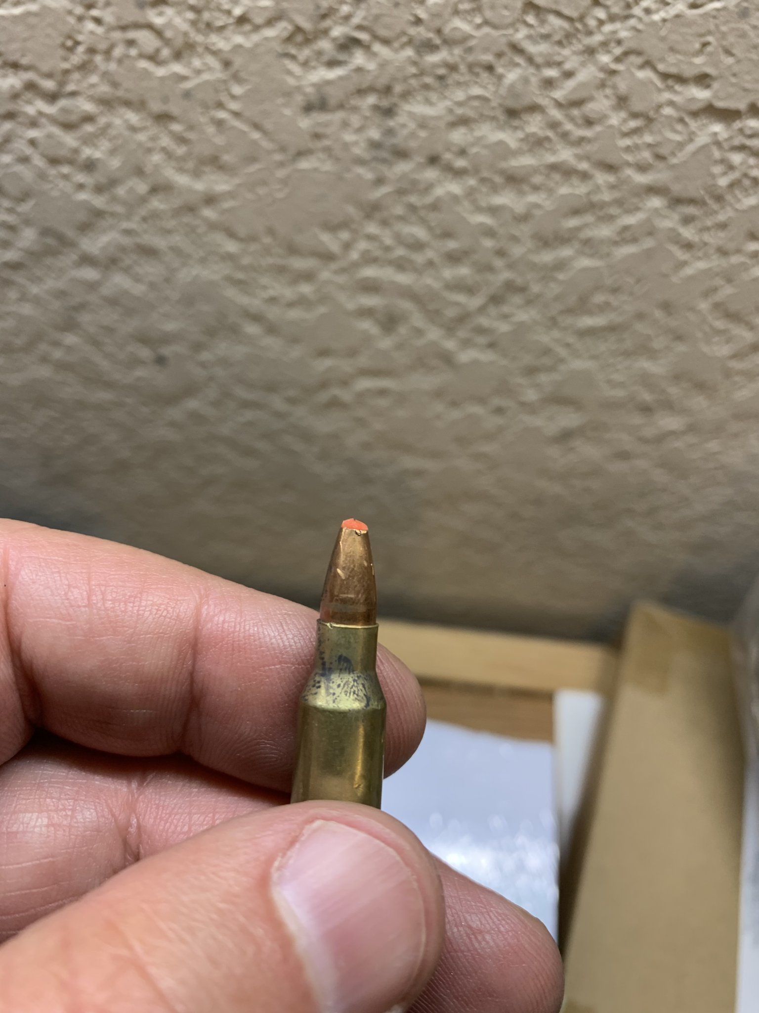

    Loaded 50 up this morning to see if it might be the new lot of Vmax’s I’ve got.
    Varget 25.6grs
    Vmax 60gr
    LC brass
    CCI SRP
    2.250 OAL
    2742 fps
    This load is actually faster than the load I was shooting when I had the strike on my can. Put my Razor 4.5-27 on just to make sure I could see all my hits. Sighted it in then shot six 5 shot groups on paper. Really wasn’t trying real hard to shoot groups just wanted to make sure all rounds were accounted for. Groups were .4-.7 at 100yds. Then I shot the last 15 on steel at 200yds. All rounds made it to there target. 200 total Vmax’s through it now. Sent the can off to TBAC today so hopefully they can tell if it was a bullet that came apart or maybe a stainless steel pin. Regardless it would be nice if they can at least say yes it was a bullet or no it wasn’t. I probably won’t get that lucky lol.

    If a bullet came apart it won’t contact the target. So if all your rounds were accounted for during the use of the can you can rule out the bullet
    Reactions: Hollywood 6mm
    I agree but as stated further up in the post I had sighted it in at 50yds and shot a few groups. It could of done it then and I would of thought it went in with the rest of the group.
    Had the same AR out that I was using when I had my can mishap shooting the same loaded 60gr Vmax’s but wasn’t using the can at the time. This is a round that I extracted from the chamber when I was done shooting. I never did find the tip but now seeing this I’m almost certain this is what happened when I had my endcap strike. Either the tip didn’t completely break off until it was fired or it broke off and stayed in the barrel until fired and that is what struck my end cap.
