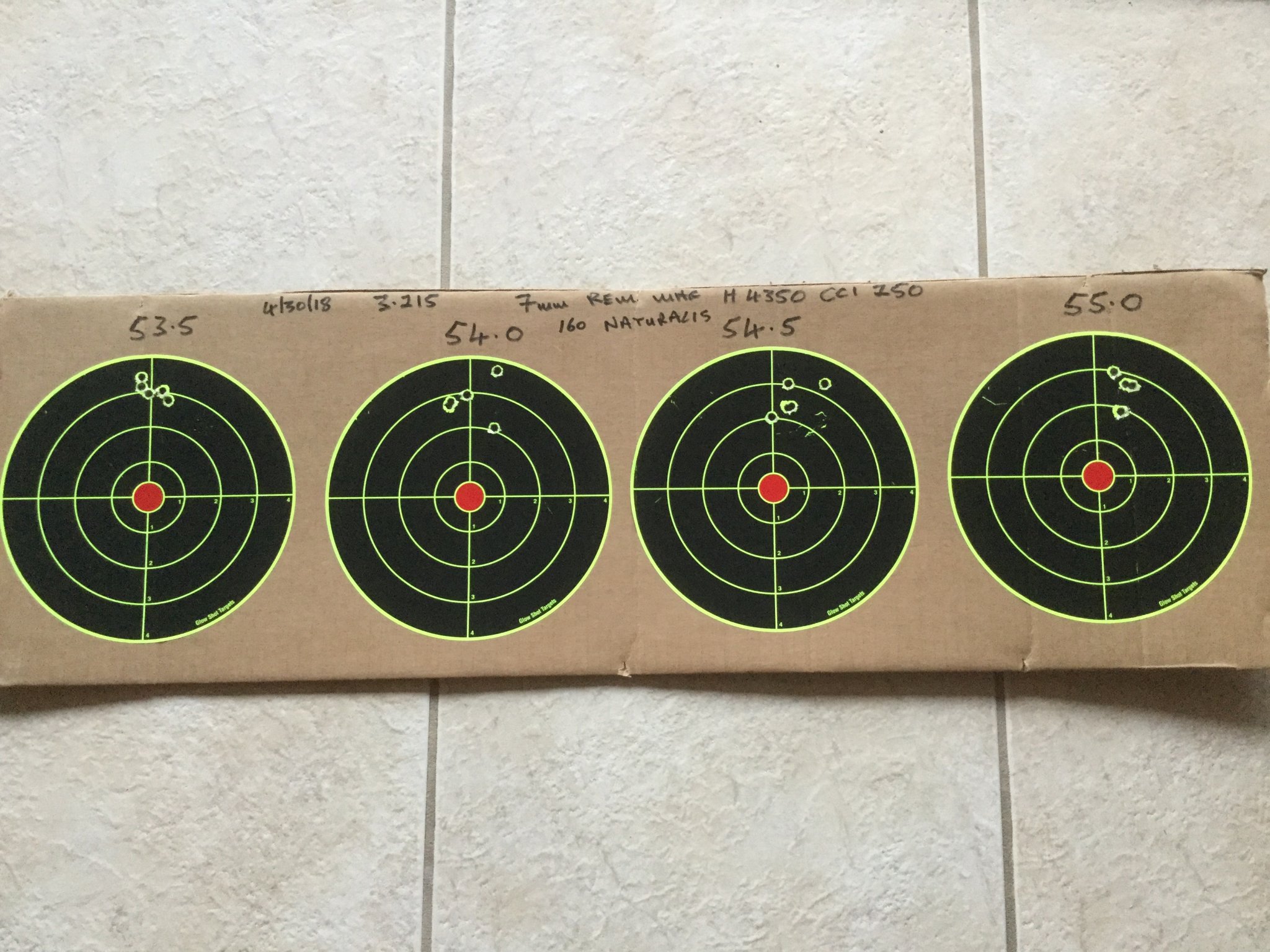

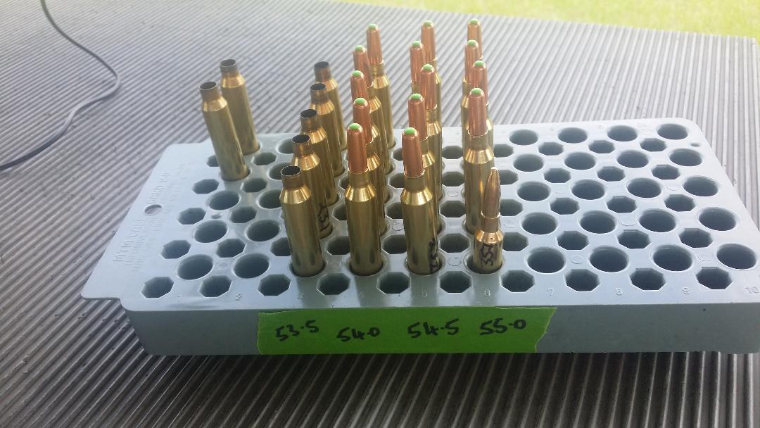

Went to the range today and tested the above over my Magnetospeed.
Was pretty pleased with the results considering the rifle and powder. No pressure signs at all. Velocities were pretty tame.
Will load slightly higher next time out.
Best group was 53.5 grs at exactly an inch.
