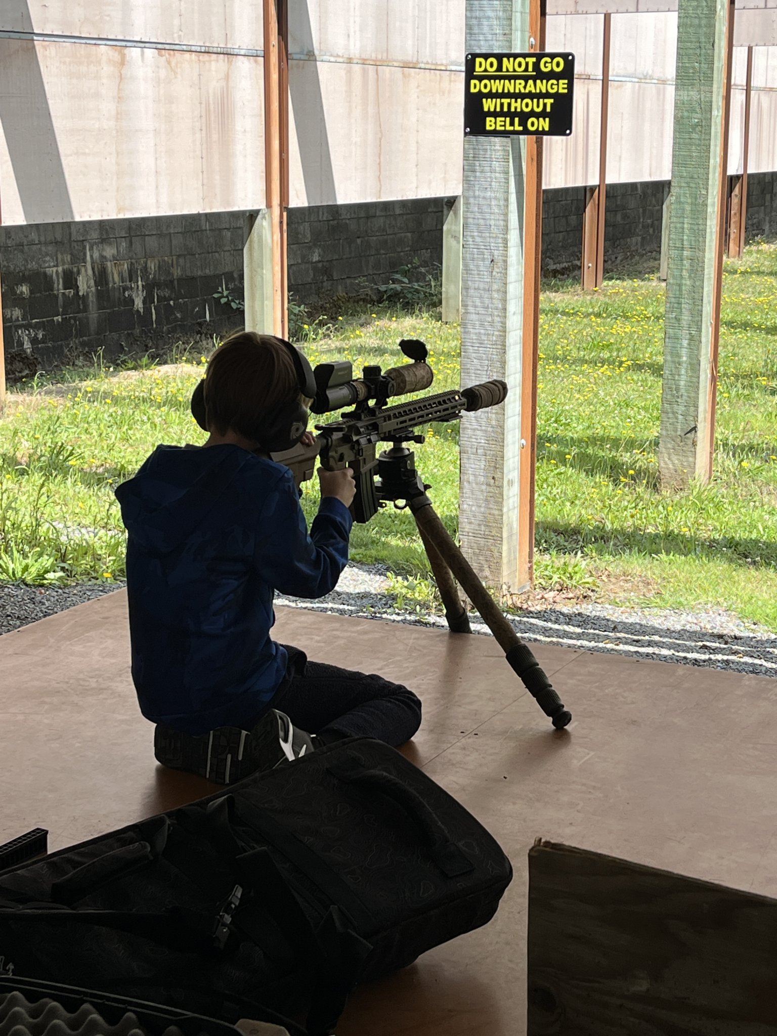

I recently introduced my son into a little more distance. We have really concentrated on 50 yards and in until this week. We have ready access to 300 yards within 15 min of home but have property that reaches to 1000 a few hours away.
Anybody have any tips or maybe reticle training information to help explain some more about ballistics to the kiddo?
Rifle he is shooting is a
Radian receiver set
Criterion .223 18” barrel
Lantac EBCG with headspaced bolt
Surefire RC2
Triggertech diamond trigger
Steiner T6 2.5-15 scr

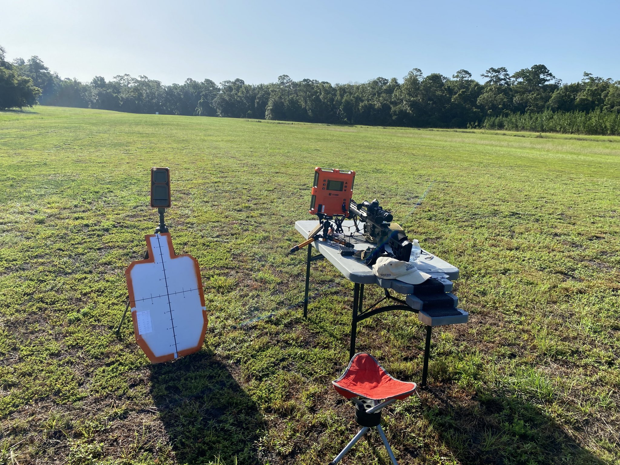

I like to use a mocked up target with reticle markings at the firing position to discuss POI v. where they were holding the sight picture when they broke the shot. Dry fire practicing 5-10X at the target prior to live fire to watch for trigger jerks etc. Start in close 25 yards then advance to 50 etc as they demonstrate proficiency.
