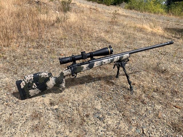

Ill try to attach a picture of the rifle that caused me to get all that crap..
7mm 175 -180 bullets 68-70 grains of retumbo will get u something. I run 175 Berger elite hunter with 69.9 grains of retumbo 10 thousandths off lands, 26" Remington sendero, 2990 fps.
69ish is the number I keep seeing with those types of powders. What brand case are you using? 69 of RL26 with Rem brass is what this rifle shot well during the gunsmiths work, but I think Im going to start with 60 in the ADG (the -10% they rec. minus 2.1 more which will give me some room to "work up").
