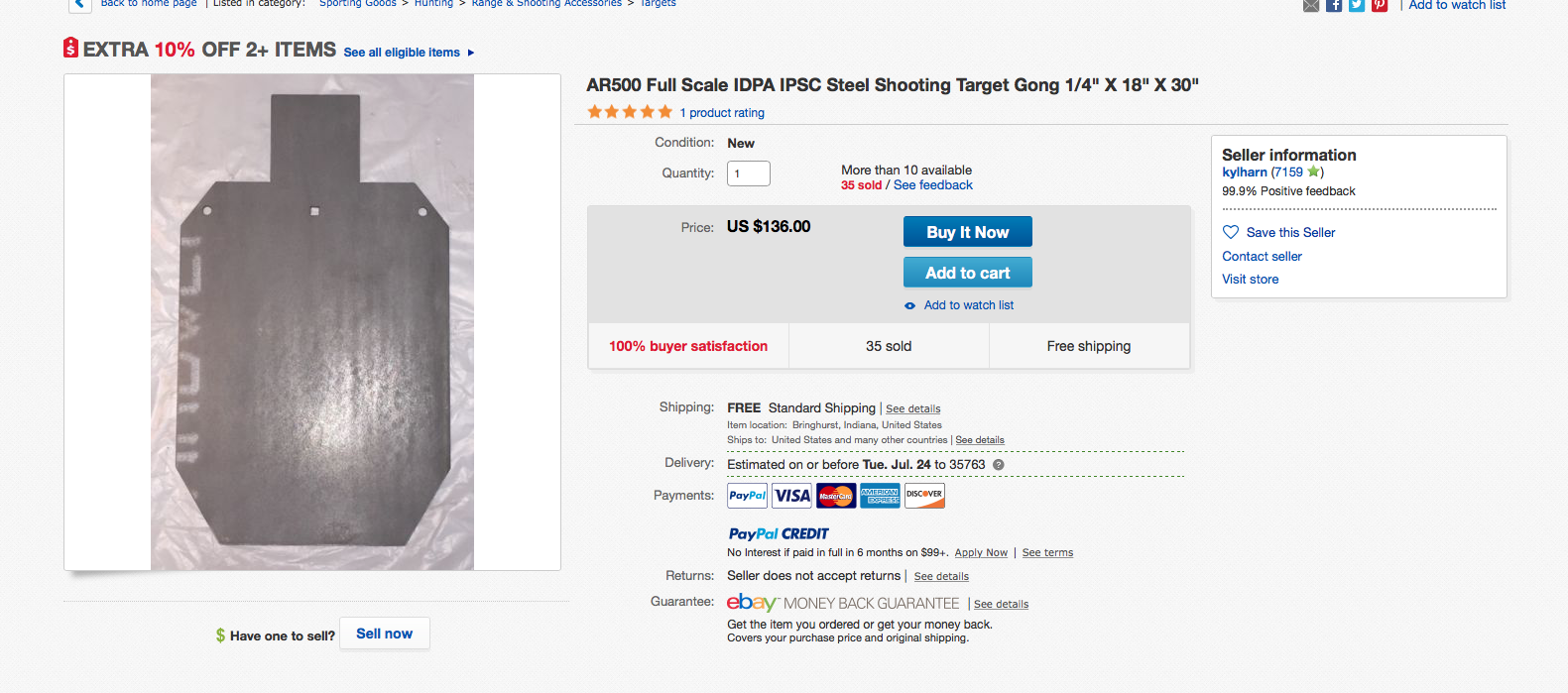

Thanks. I'm looking at new ones and they seem to be ~6mm thick. That sound about right? Might be worth getting AR500 if that thin, given trouble I'm going to go through to get them in place up on a hill...
Don't forget about eBay. There is a $25 off coupon going on right now too.
