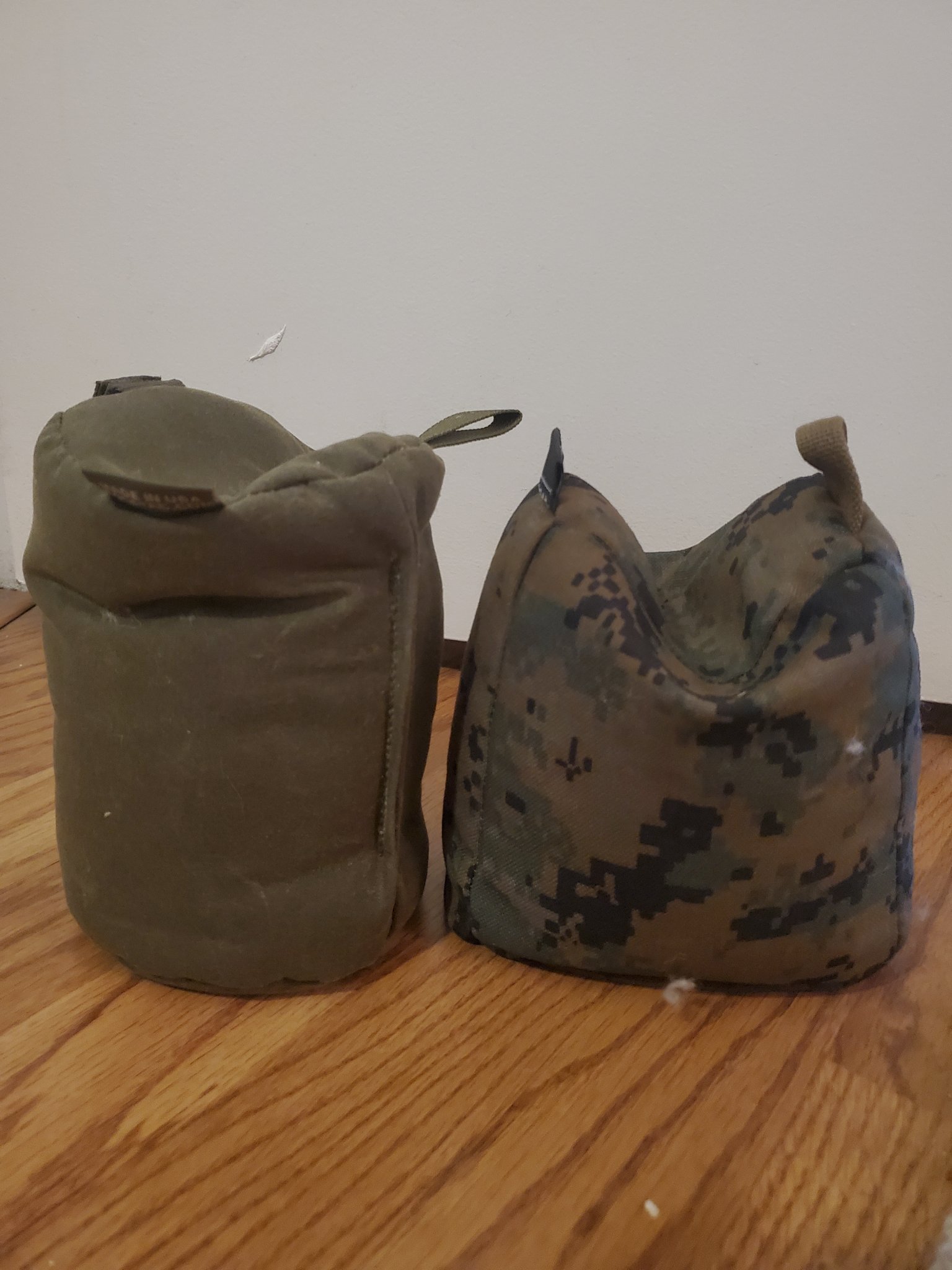

The bag I'm using is the Precision Underground 3D ELR. It's positioned on the tall end, the rear bag can't get any taller. I'm also shooting down hill, the legs of the bipod are only extended to their first notch. I've got a taller rear bag I can use, so maybe I'll try that before the TAB gear bag.

All that being the case, the biggest issue I see is really the dipped right shoulder. Definitely try a taller bag before anything else, and only change one thing at a time. If you’re already into your neck with the butt, then don’t worry about shifting the butt, you just need to get that right shoulder up even with the left. Or you could work on getting the other shoulder down. Whichever way you go, you just want to be even and square.
