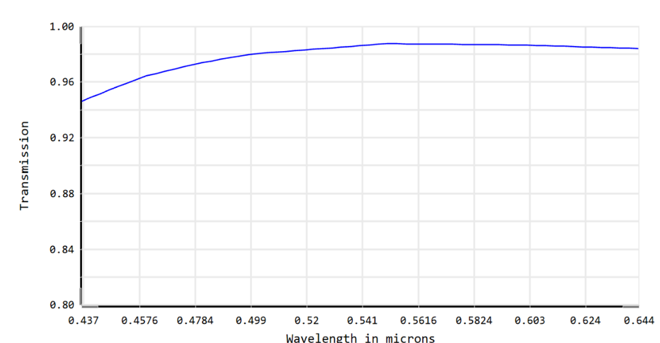

As far spectral aspect of it, here is a simulated transmission plot for a Japanese scope designed about a decade or so ago. This was a very nice scope (although its replacement is even better), but you can see the transmission different between blue and green.
