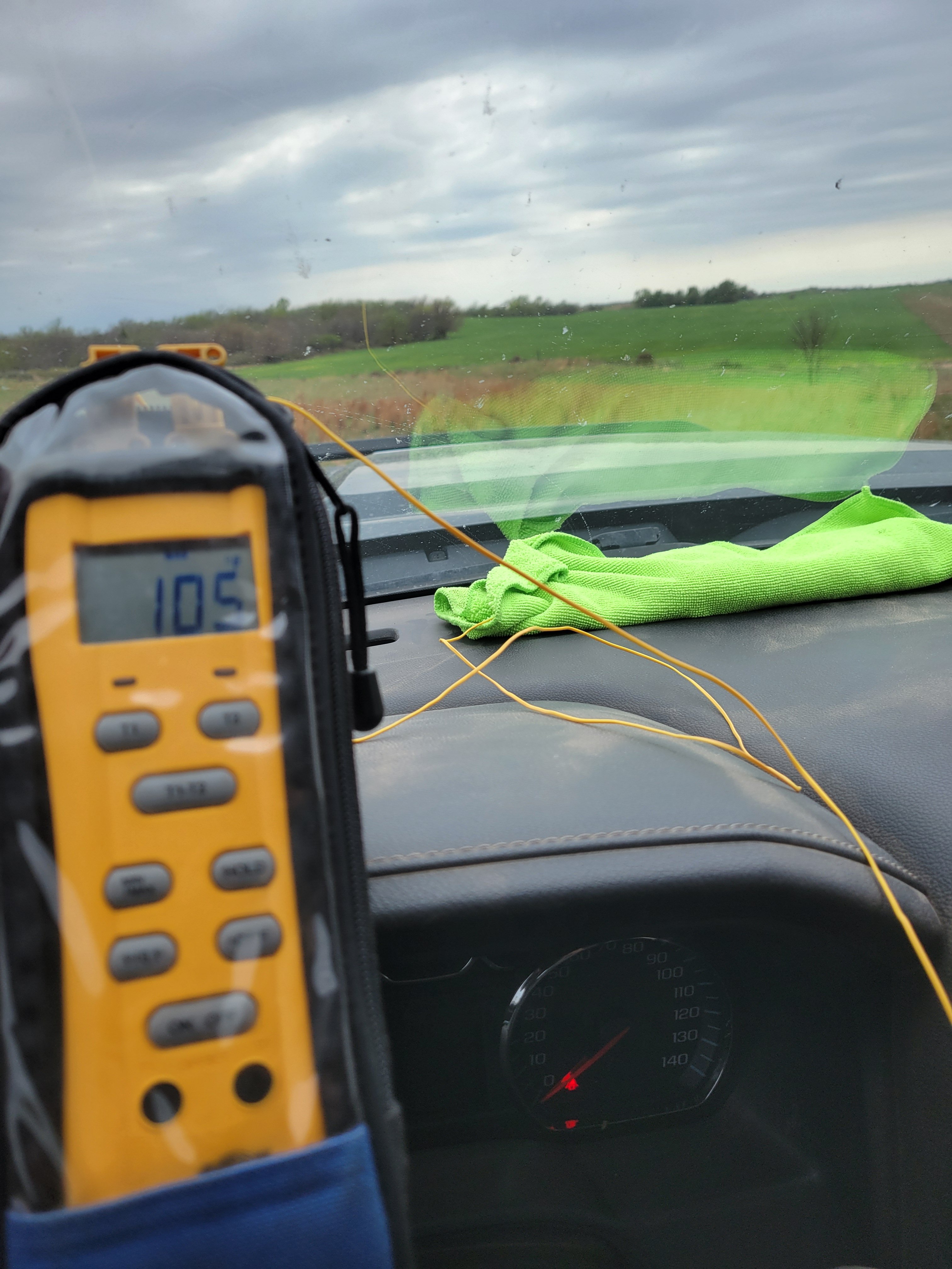

The heated rounds were put in the dehydrator for 4 hours with it set at 115°. I wrapped them in a towel on the dash and ran the defrost every few minutes to keep them warm on the trip out and while waiting to be fired. The temperature of each sample was measured at 105° right before being pulled out for firing. Each sample was fired within a minute of being removed just like the frozen test rounds.

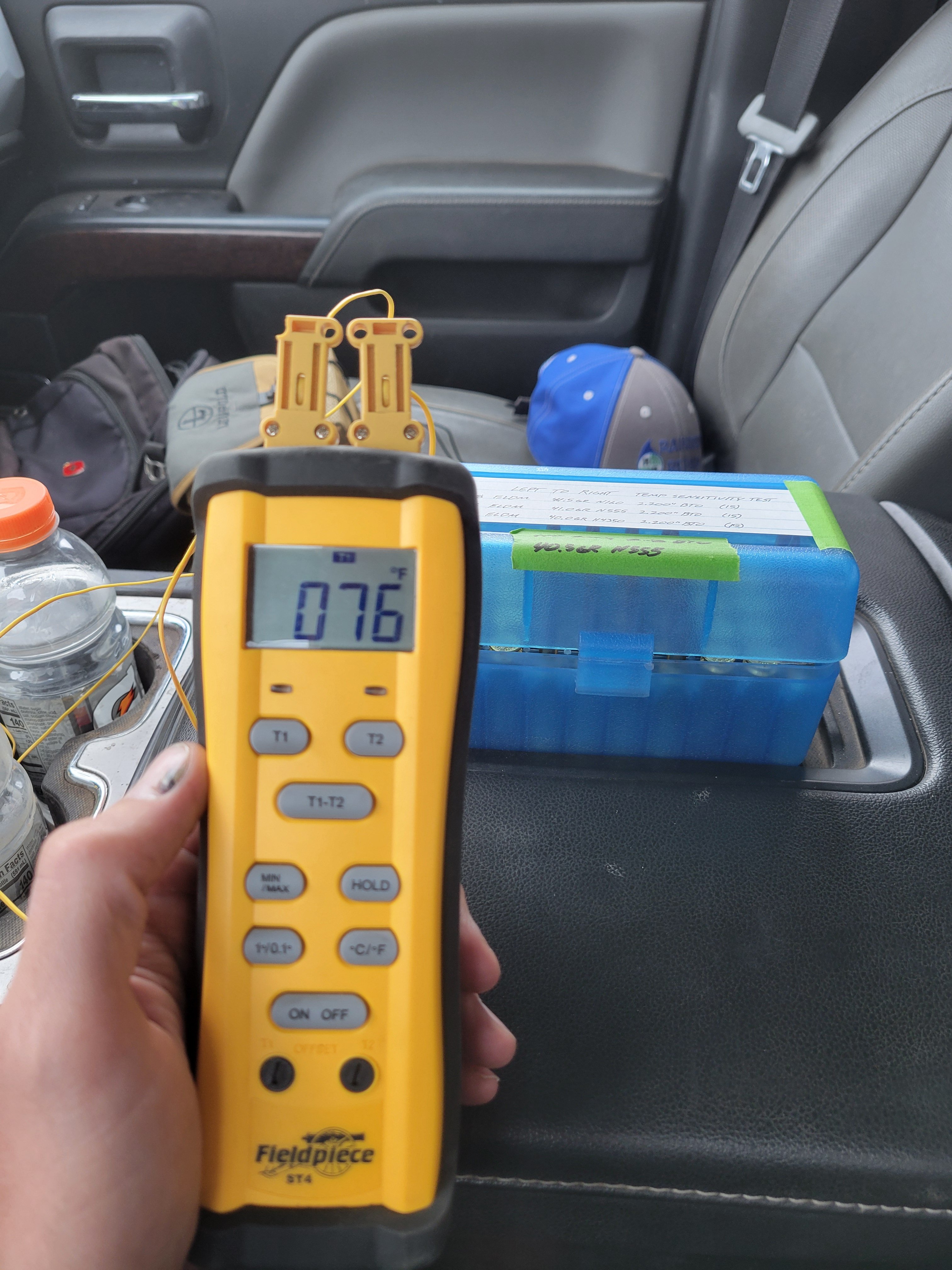

The room temperature rounds had been in a 68° house prior to the trip to the range and were kept in the pickup cab prior to being fired. The temp in the ammo box was measured at 76° probably due to the defrost being run. These were also fired immediately upon removal.

Middle 76° AVG 2867.0 SD 4.9 ES 13.6
Hot 105° AVG 2864.8 SD 6.7 ES 17.9
