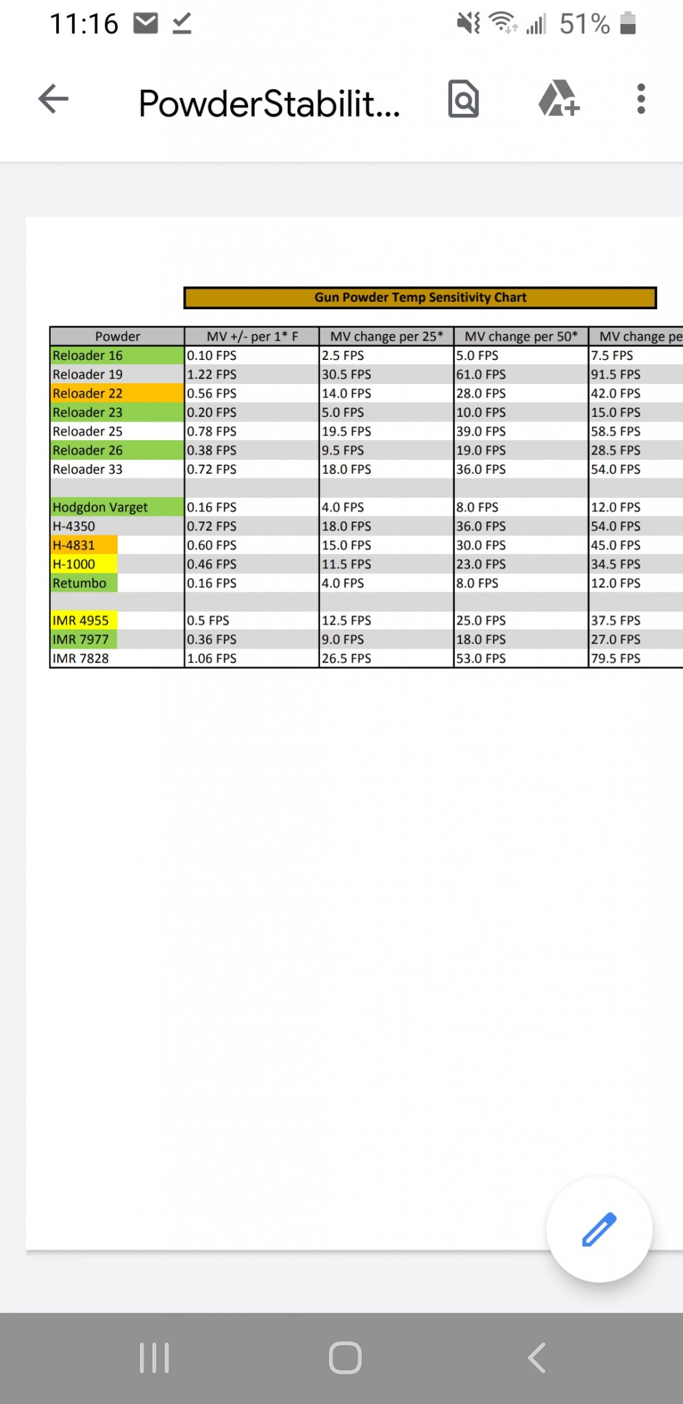

I heard that RL 16 is more stable at high temps. I'm going to try it on my next barrel.
It's above 90 where I live for close to 5 months out of the year.
Just saw a chart where R16 was the most stable with averaging 0.10° per degree, retumbo was next

Not dismissing what you say, but this seems to depend on individual tests. For yrs Varget was the king, Retumbo not even an honorable mention.
I agree, I saw a test done between H1000 and Rl26 showing H1000 was much better. This test shows RL26 is better.
