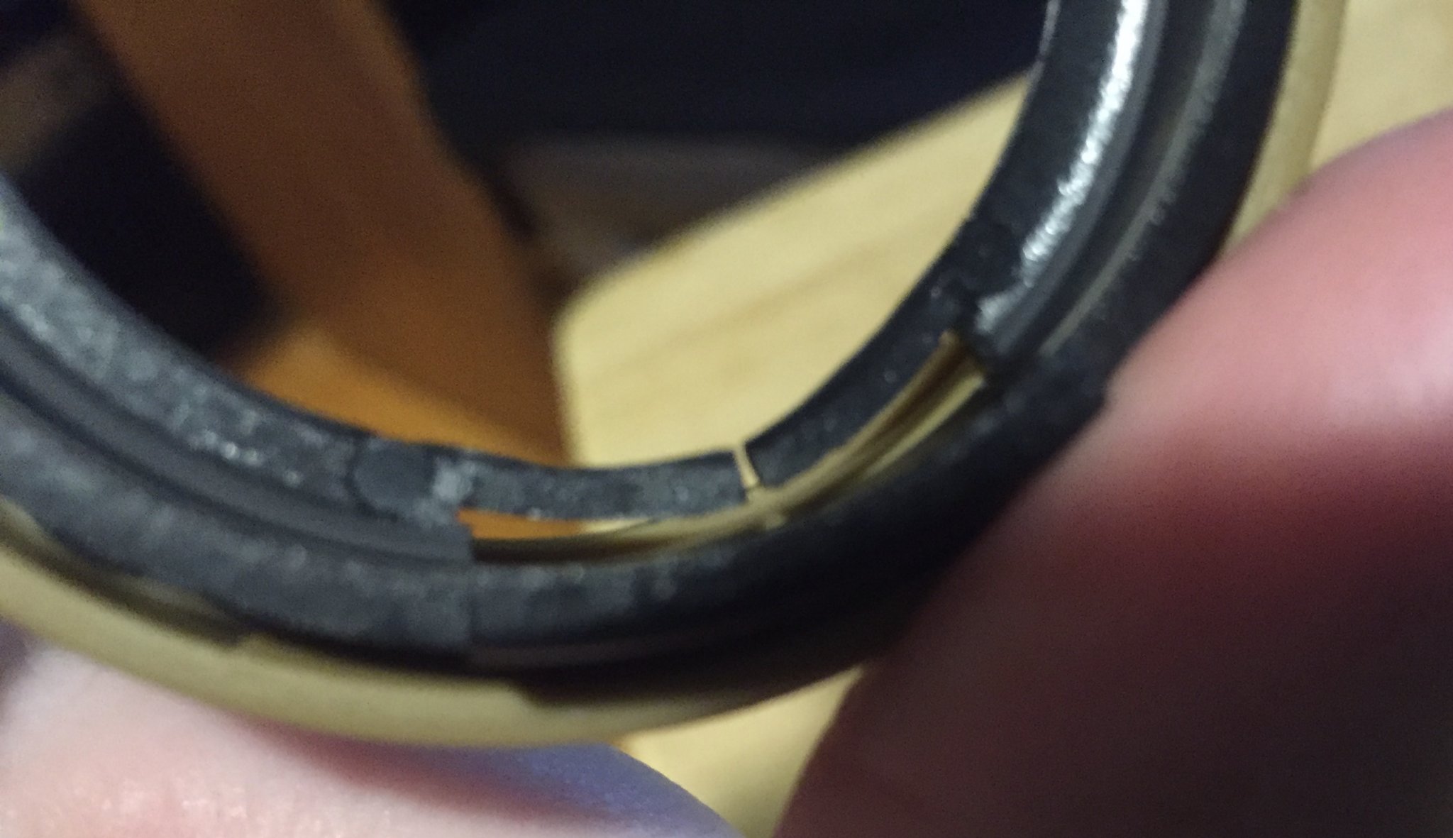

does the rear one have an adapter ring - i dont have mine in feont of me but i thought some of the rear ones require an adapter, and said adapter has a bolt you can use to tighten the adapter on. maybe post a pic for people to see

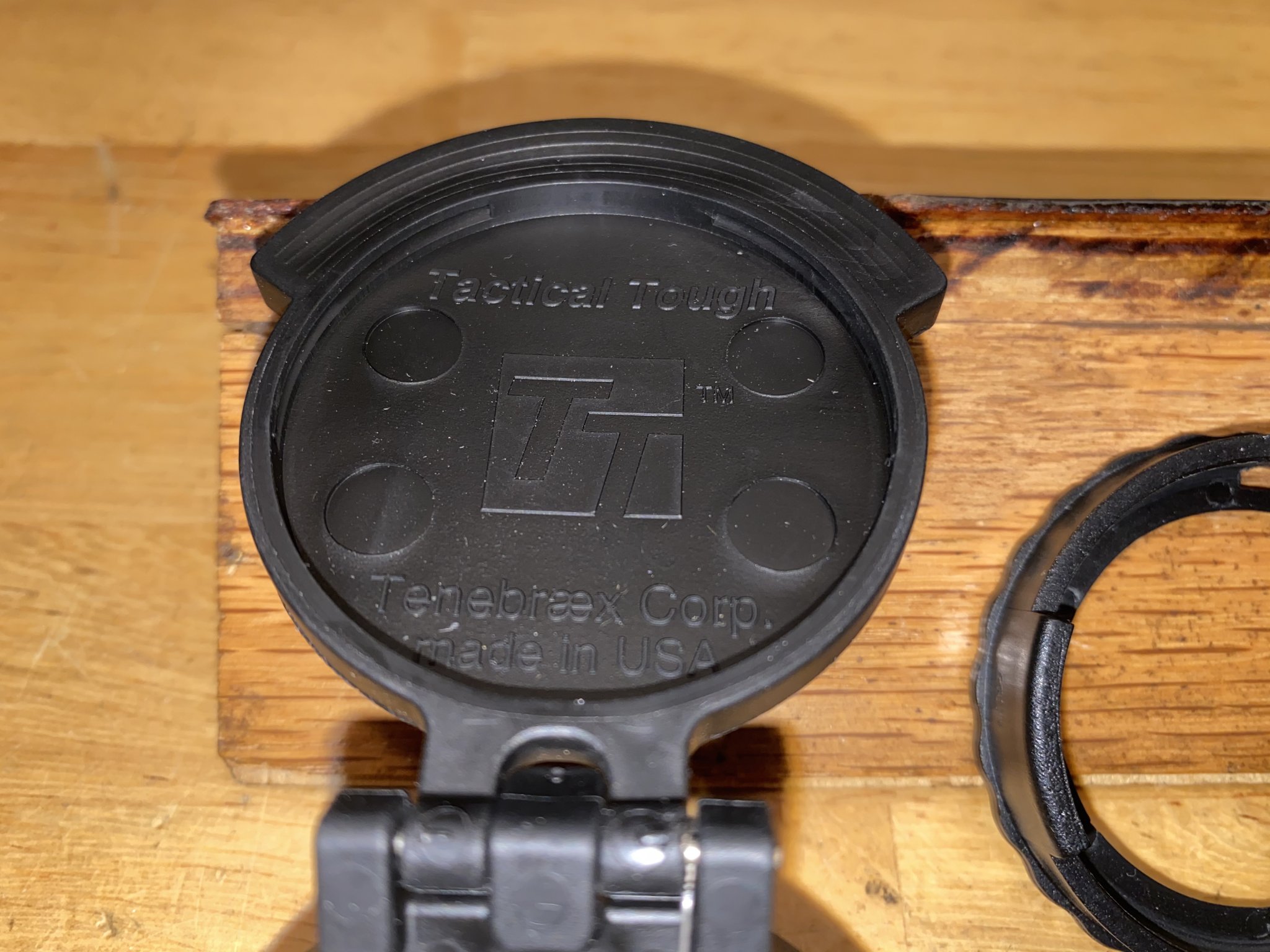

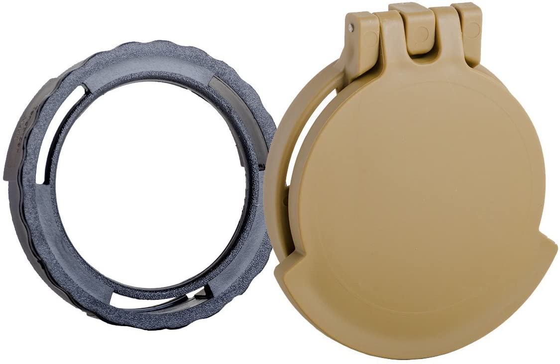

It did come with an adapter ring, both the front and the rear but there is no bolt. This a picture of the scope cap and adapter ring. This is the same part I received. The adapter ring slides over the rubber on the ocular end of the S&B. I added a piece of electrical tape and it tightened it up. The top picture is the adapter ring I received, I noticed the section in the picture is split down the middle. I'm not sure if it is supposed to be like that or not.
Not trying to be a smartass but does that look right to you?
Looks like you damaged it when mounting / unmounting it.
I didn't think so. I will be returning it and having a replacement sent. Hopefully the next one fits better. The package was also damaged, Amazon shipped it in a paper envelope instead of a box. If your cap fits tight there is definitely something wrong with mine.

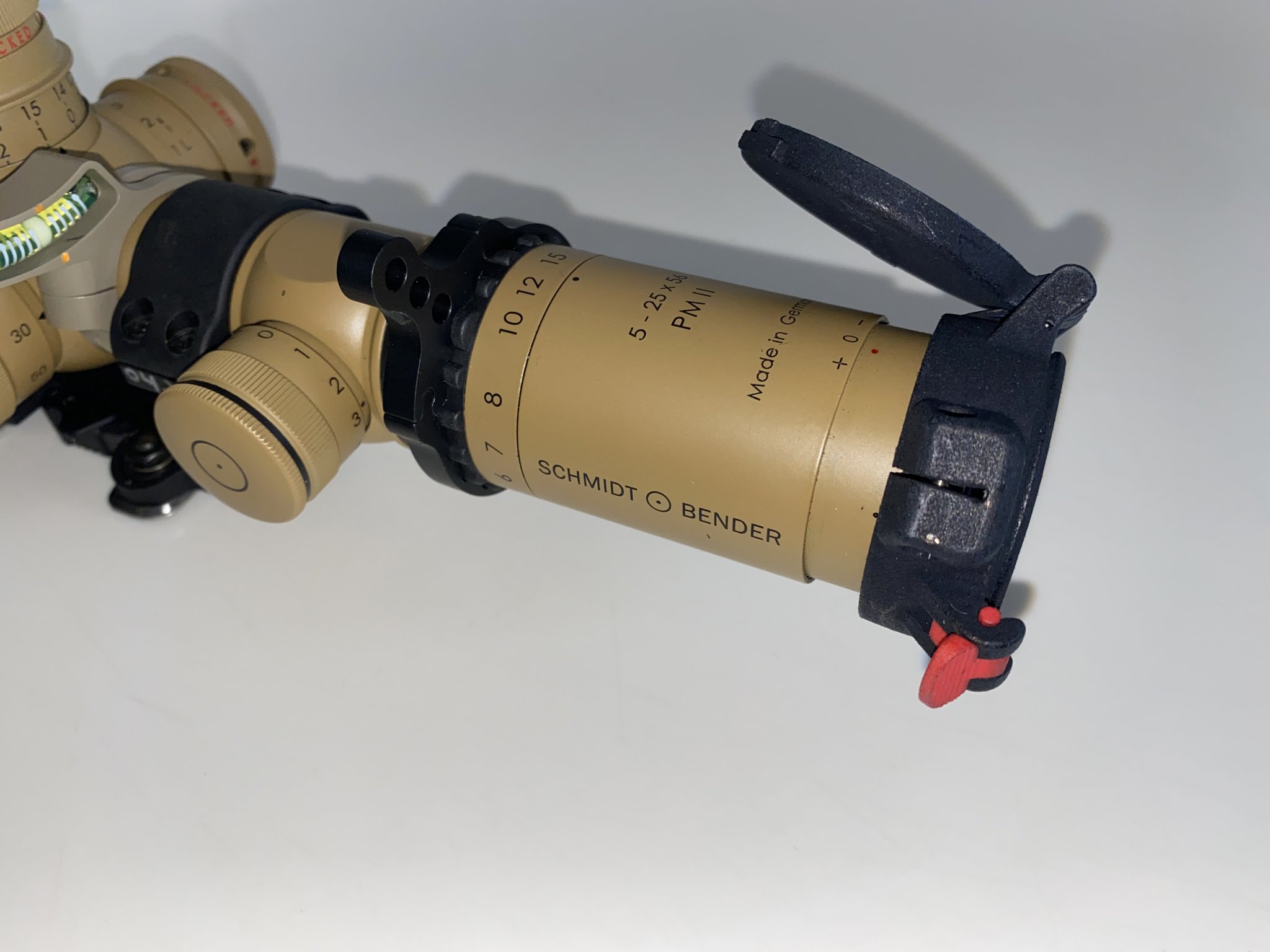

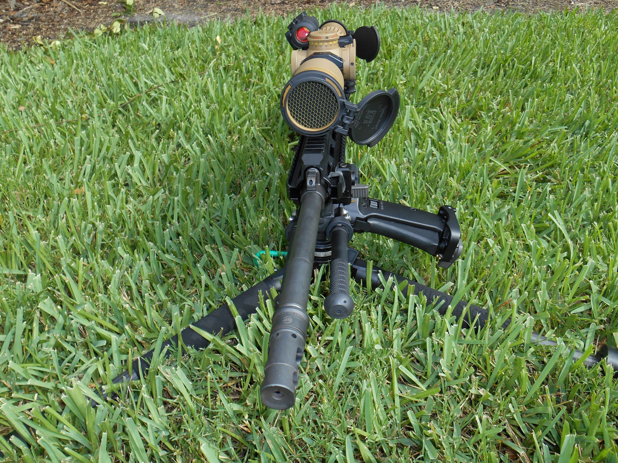

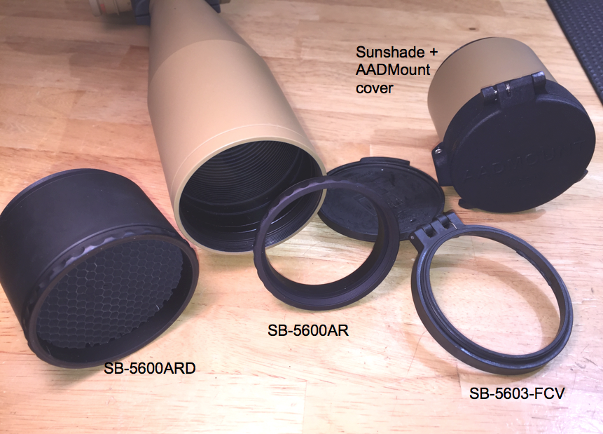

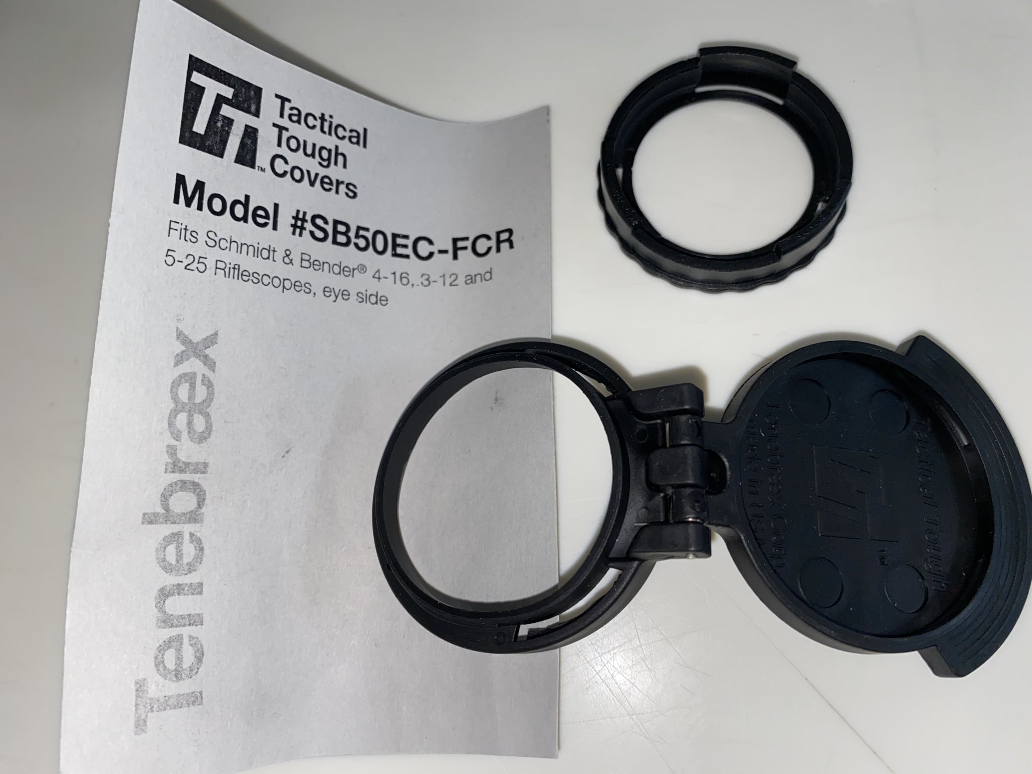

I use the Aadlands whenever they are available for various S&B scopes; I replaced my Tenebraex covers on my 5-25x56 (LP/LT/MTC) with adapter ring, these are what I installed; the Model # is different from your reference. There are no model #'s on the parts themselves.

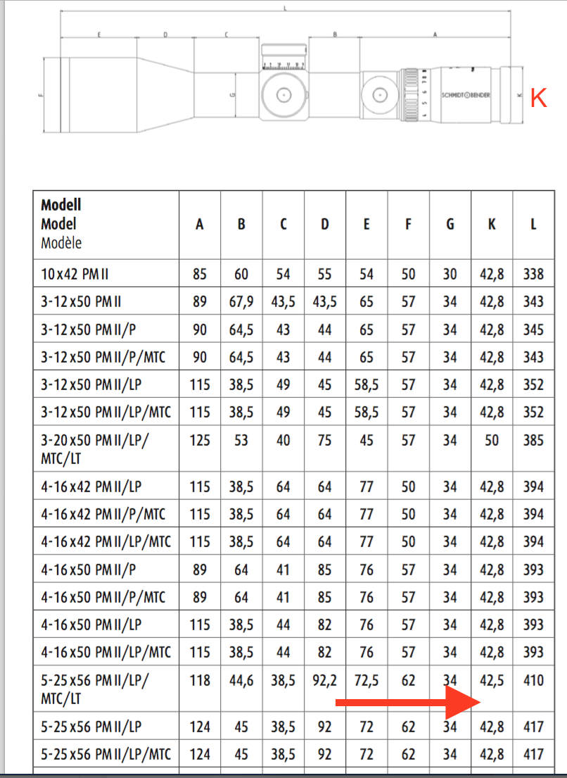

The chart indicates one of the 5-25's ocular diameter to be 0.3 mm different ? surprisingly.
The adapter ring in your photo is fractured.

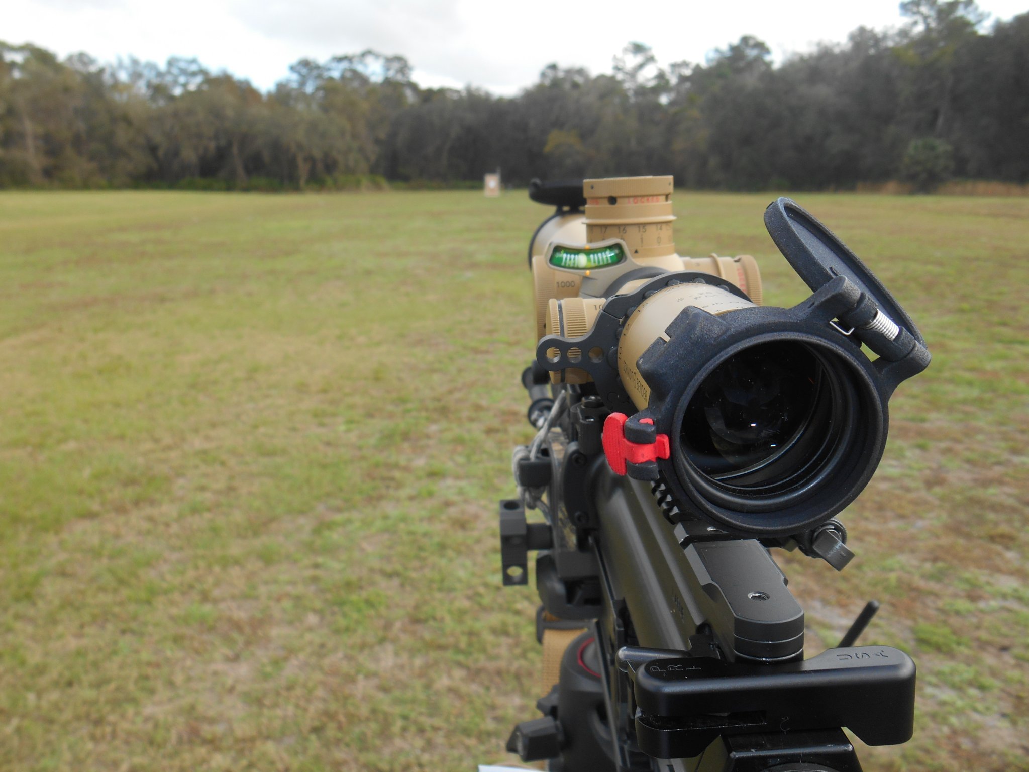

Thanks a lot for all the help guys. Lots of great info and exactly what I was looking for. I straightened everything out with Tenebraex so I'm good to go now. That is one pretty scope, I like that throw lever and bubble level.

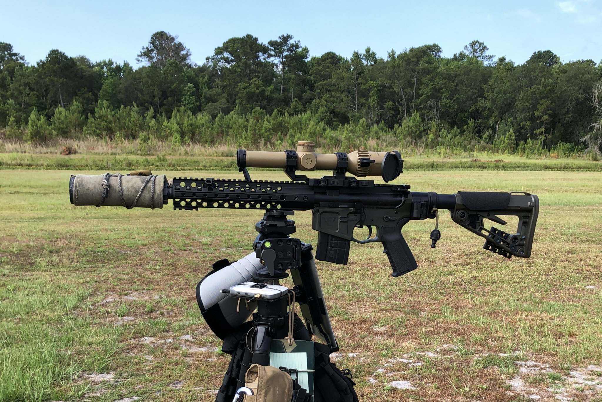

What throw lever are you using? Thanks

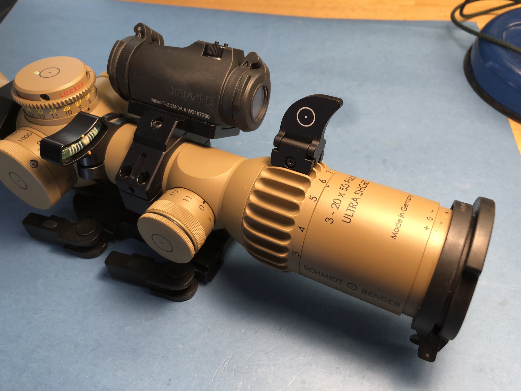

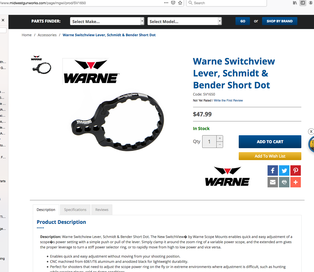

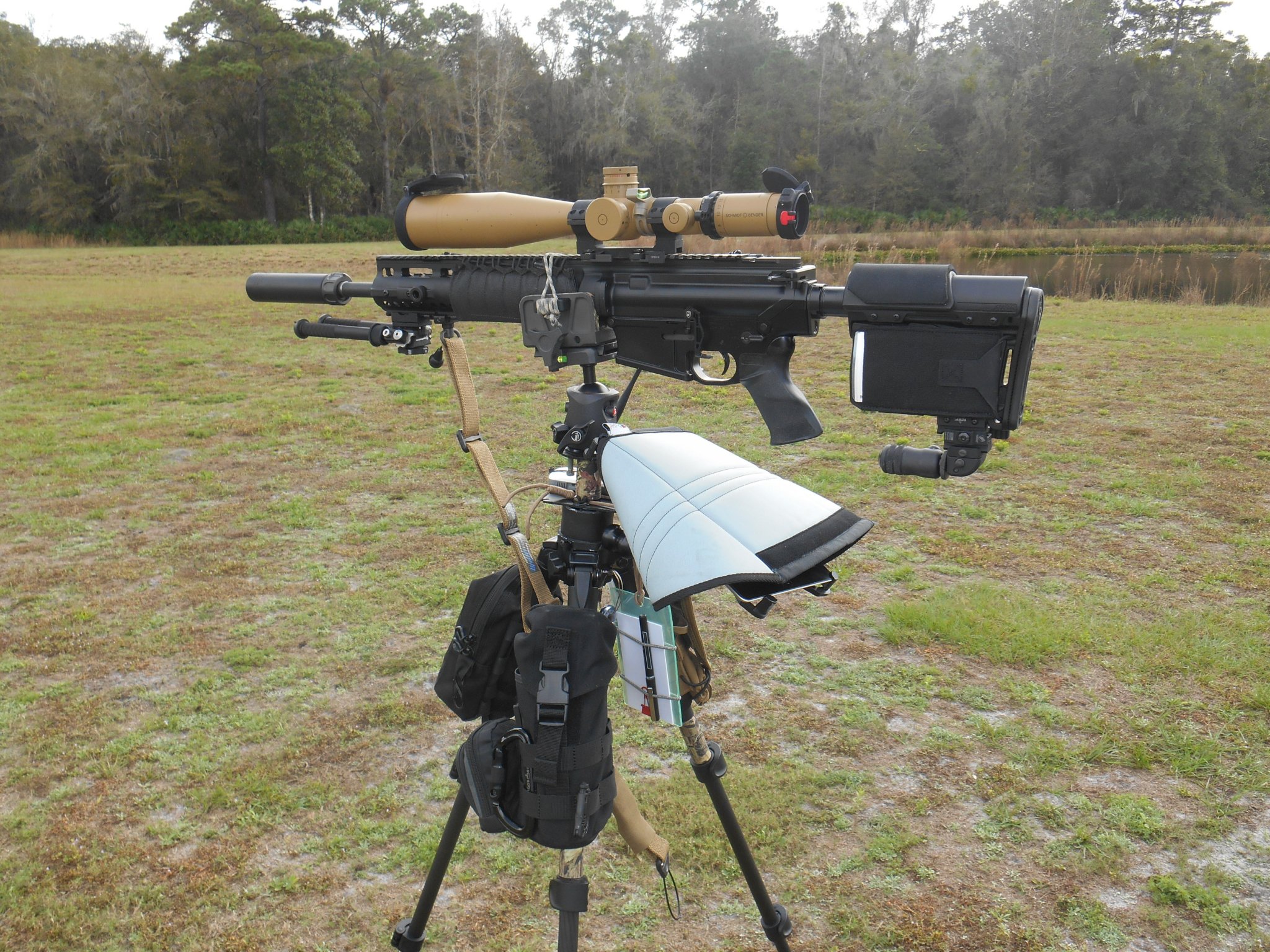

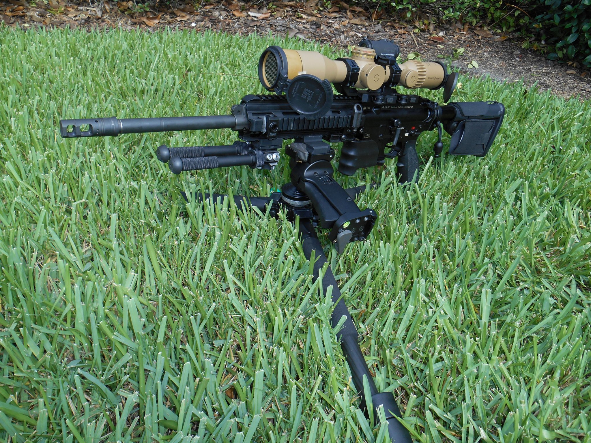

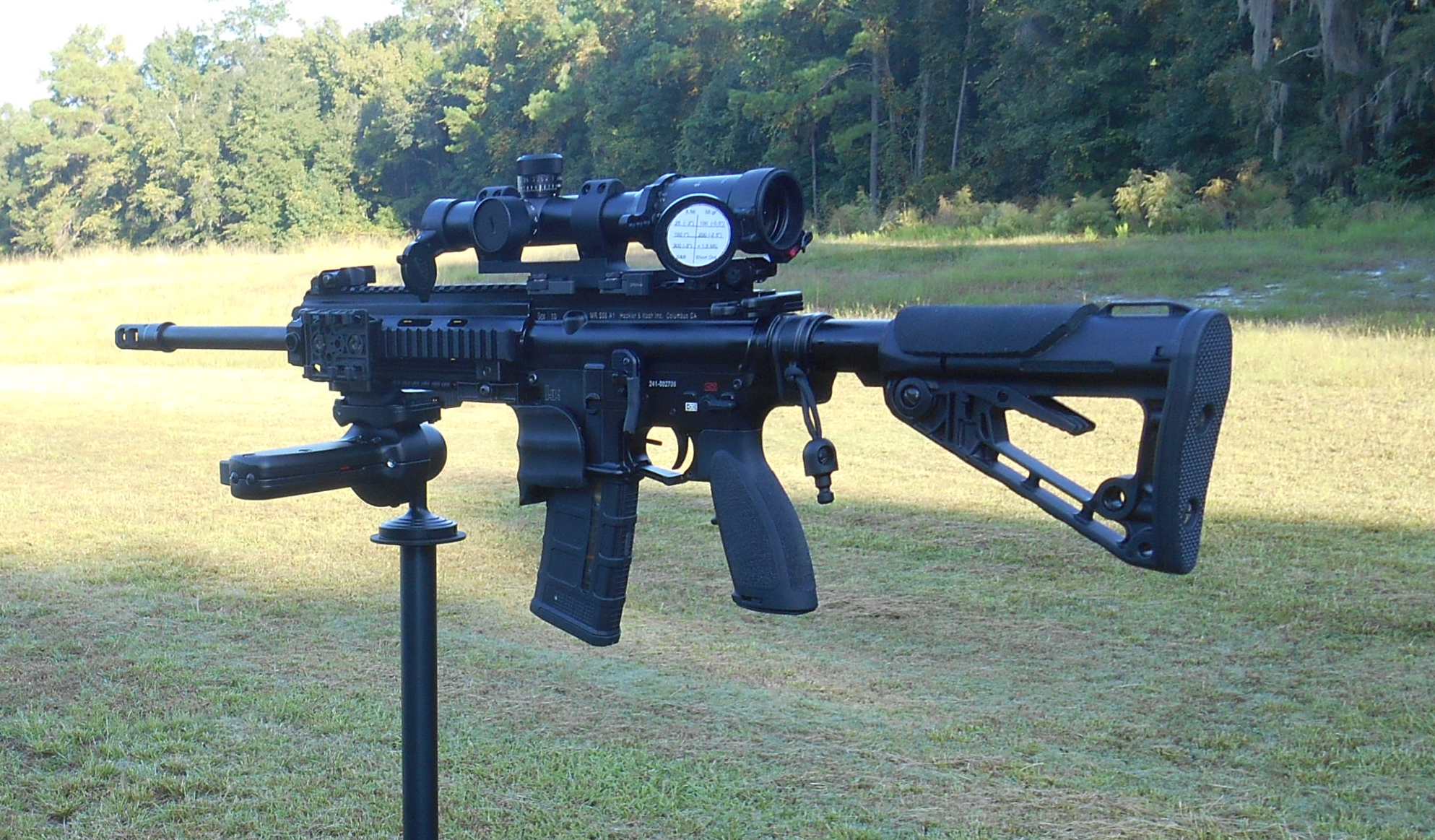

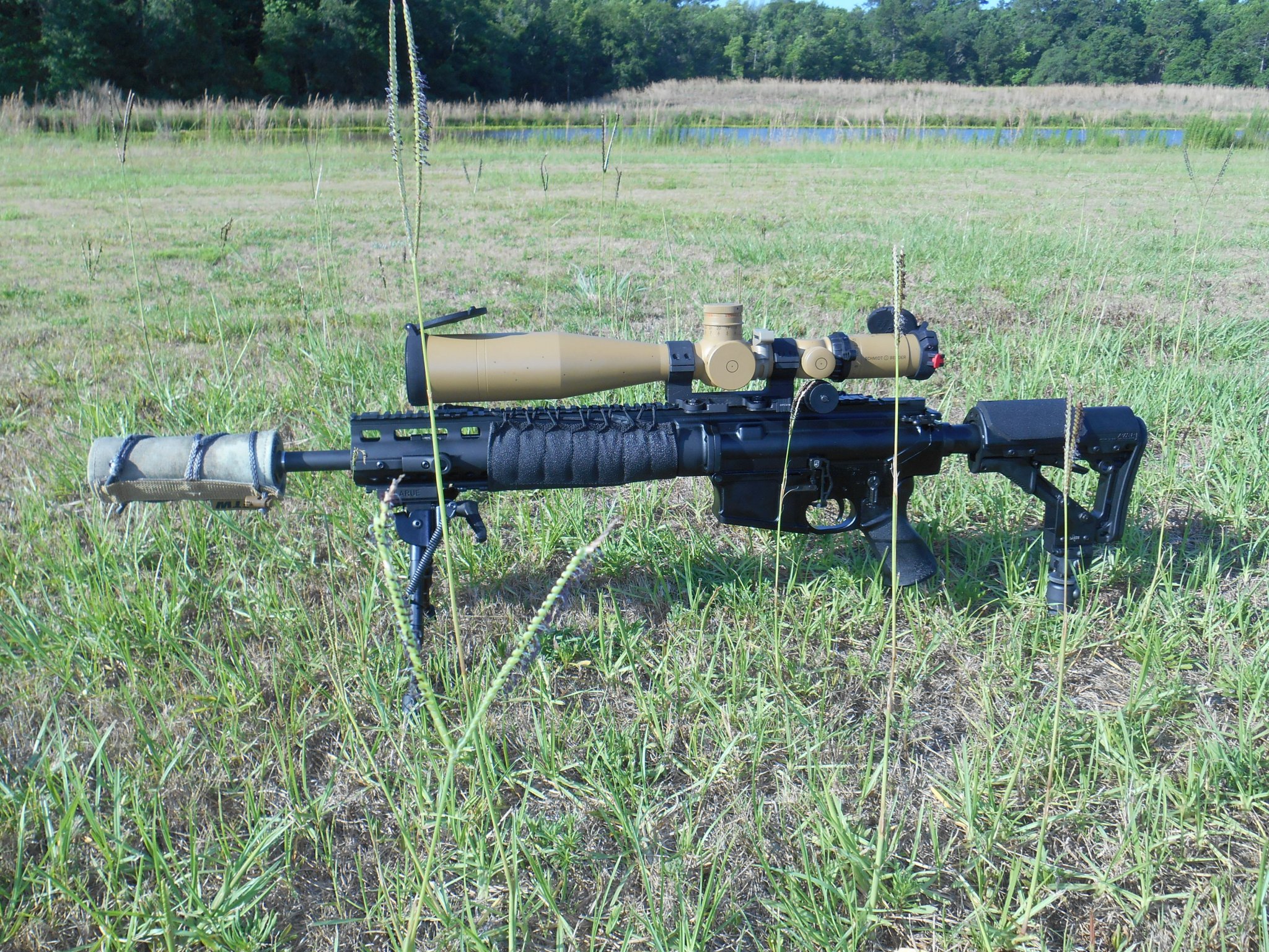

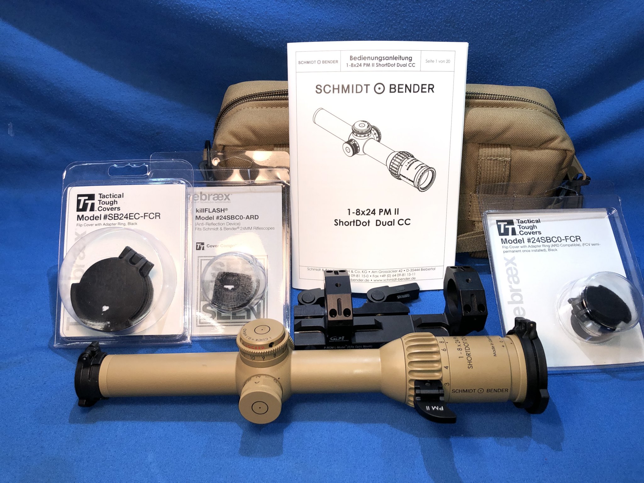

For my S&B's I use two different style throw levers depending on availability. The 5-25 X and 1.1-4X short dot I used the Midwest Gun Works "switchview" models (currently offered as "Warne" via MGW). The 3-20 ultra short (HK MR556A!) and 1-8x dual CC ( Wilson Combat SBR 6.8 SPC) I installed the S&B "shark fin" style. The MGW has a circumferential engagement with the scope ring lugs whereas the S&B locks up to adjacent logs; both secured with a set screw. I really can't say I prefer one over the other.

Thanks! I have a SwitchView on another scope and like it a lot. I dig that SB too though.
