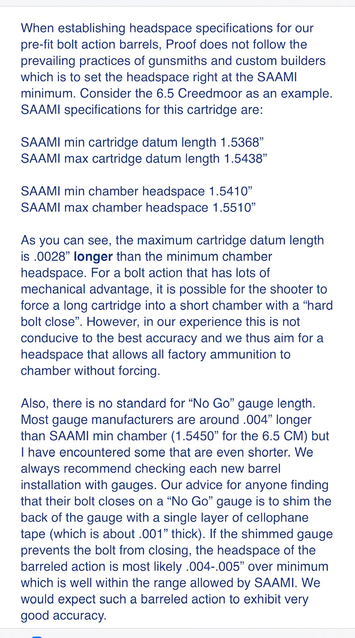

Update: Below is what I got from Terminus and confirmed by support at Proof Research.
Disassembled, cleaned everything thoroughly and reassembled, per specifications and followed the below procedure and could not get a no-go gauge to close with one layer of cellophane tape.

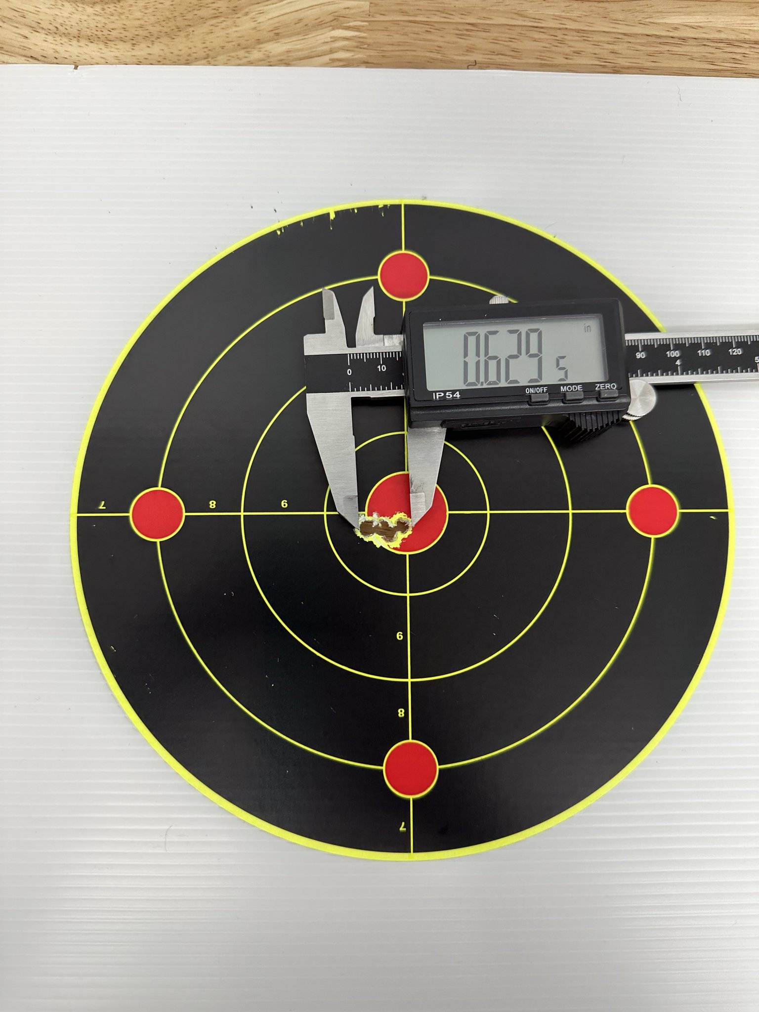

Test firing and will post an update after in case it helps anyone else.
