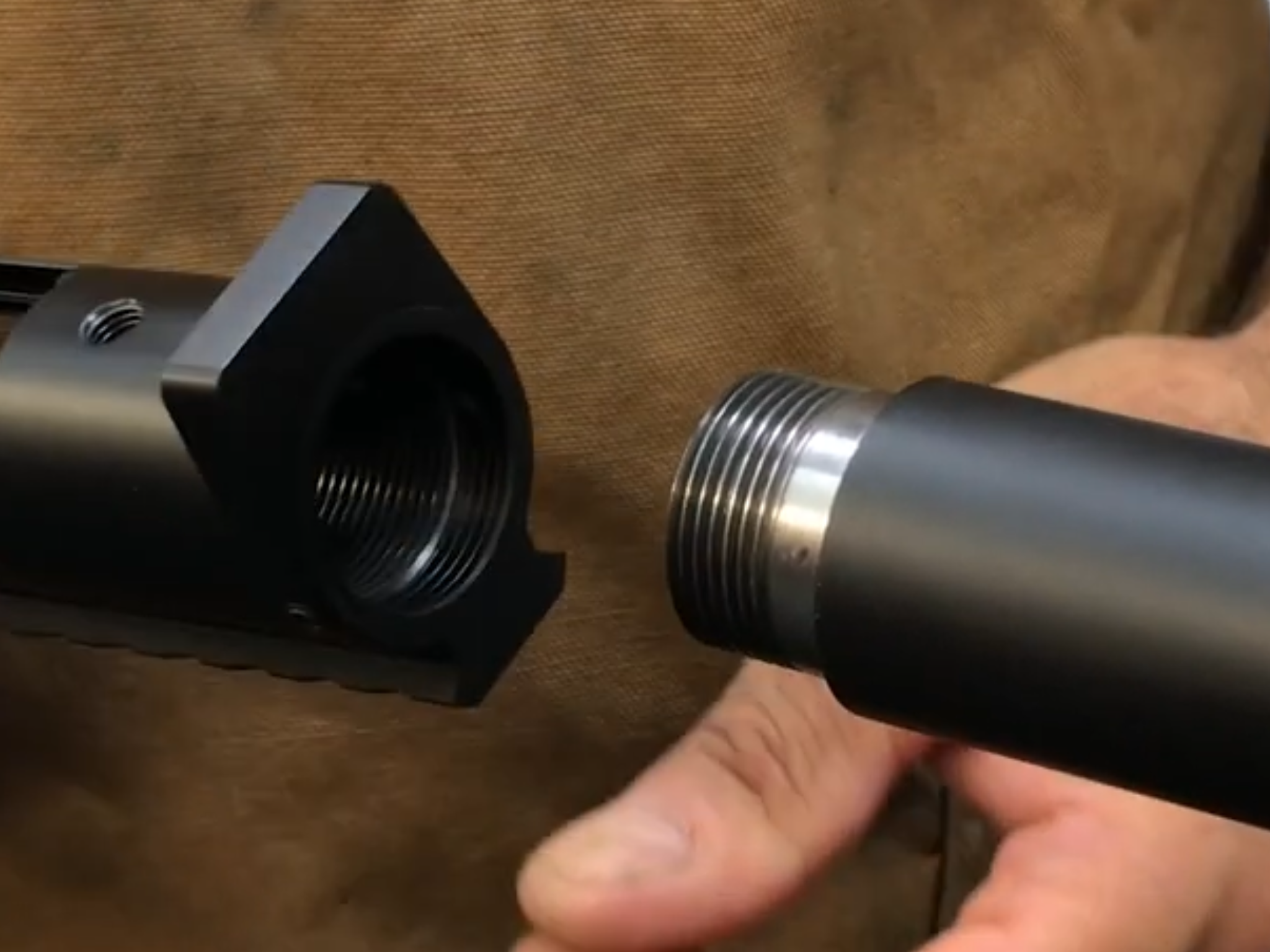

I will try to get Joel today. Just tried a couple times. He has increased call volume. I’m wondering if the QC actions are threaded full length but just have the screw holes through the threaded section allowing the screws to bear against the smooth section of the barrel tenon. If that’s the case, looks like no real compromise for non-QC barrels.
I just took a screenshot of a Utube Joel did, demonstrating the QC action. You can plainly see he threads the inside of the QC receiver with full threads. I will confirm with him but looks like the only difference between the QC vs non-QC receiver is the screw holes. If that’s the case, I don’t know why anyone would ever get the non-QC option. Both have the vent hole for gas relief in instance of blown primers or case head separation.
I just talked with Joel. Those outer threads have been counterbored on QC action and are not engaged. You can install a full thread barrel on a QC action, no problem. He recommends 65 ft lbs torque for full thread barrel. He said to not install the screws and torque them down on a full thread barrel as you would gall those barrel threads. I’ll probably go with non-QC action as I don’t need QC capability. You can still get a full thread pre-fit if you decide to change caliber or barrel (wear out barrel) later. Just need a barrel vise and action wrench.
