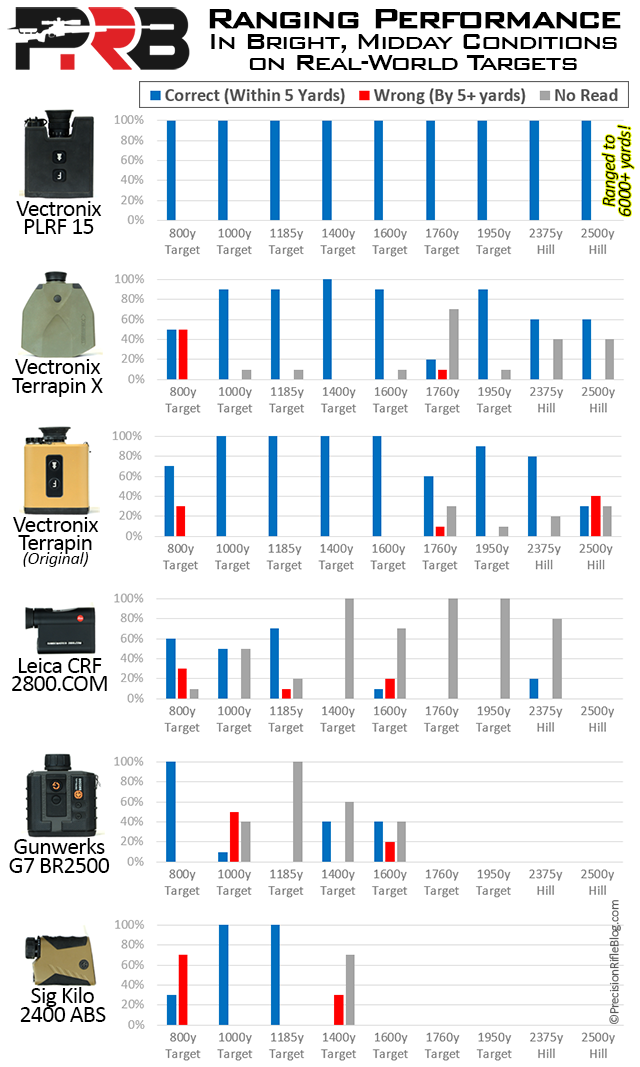

The issue is that the field moves so quickly - as soon as someone does a solid test, new version are released making the old test data pretty obsolete. (New Sig Kilo's and New Leica's for example)...
I know that Nick tried to give us a methodology to compare apples to apples Laser devices. However without someone doing continuous testing it makes it really difficult to compare laser devices.
Also, from what Nick said the Raptar is a 1550 nm device - as an aside.
I think most of those tested by PRB are 905nm with the exception of the PRLF 15's which means it should be putting out a lot more energy - thus getting a lot more range (just better signal / noise ratio).
Generally I would expect most of the recent 905nm laser devices to be pretty comparable in their capabilities, with the differences being more along the features like integration, and potentially better / worse software determining what target your actually pointing at.
I really liked the 3D feature on the old Terrapin which allowed you to see if there were multiple targets identified in the ranging path, rather than the software just picking the best single choice...

I've tested Terrapin X vs Original Terrapin (PLRF 05)
Original Terrapin outperform the new Terrapin X

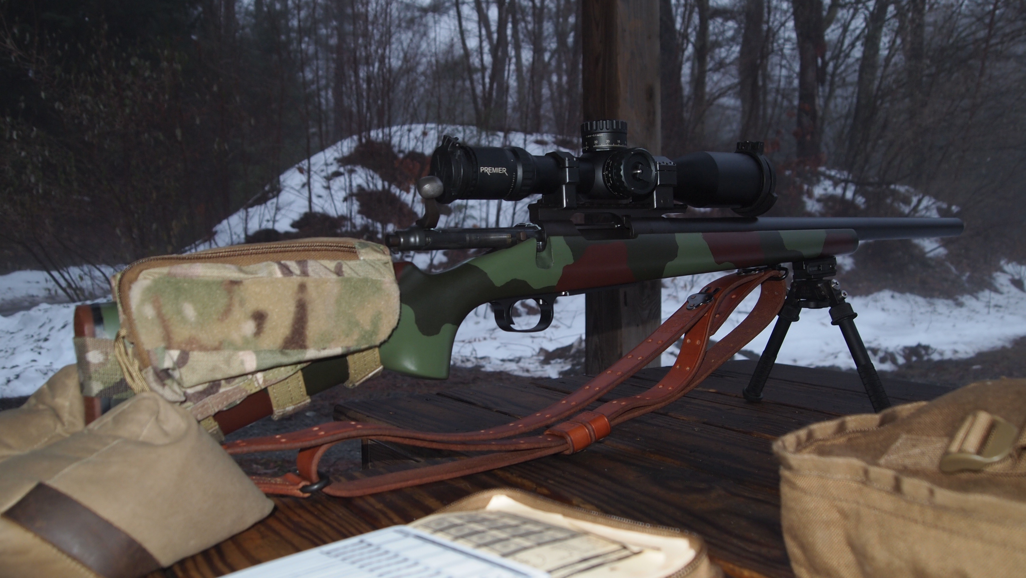

w/ a 20” barrel, TBAC Dominus SR Suppressor with Federal Gold Medal Match 168’s @ 2566 FPS (from a magnetospeed, 20 shots average, SD 15 FPS) and ~ 500 FT density altitude my kestrel was saying 675 was where I was going transonic. Tried truing at 650… meh. I can say that with MY setup and ME, I’m really lobbing them when I reach 1,000 yards.
With 175s and my M40A1ish
Im pretty solid out to 750. At Sig the next bump is 1000 and thats where hit percentages drop.....but......that steel plate is scared.
