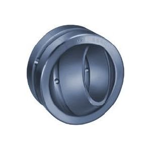

<span style="font-weight: bold">At school we've had this discussion a number of times. It doesn't allow the barrel to "gimbal", but of course neither does any support that has greater than 0 length.
Put even a 1/4" flat end of a bolt on a flat surface and hold it solidly against the surface and try to rock it. It won't easily.
Now imagine four of them holding a cylinder and trying to gimbal the barrel at that point.
This seems to show that a support collar with bolts, lathe chuck of any sort, etc. won't gimbal either without something giving.
We came to the conclusion that what could be used is something circular (or spherical) to provide a near zero length support that would allow the remainder of the barrel sticking through the head stock to be moved to align the bore.

What would work well, which I haven't experimented with yet, would be a pair of large self aligning flange bearings (ID close to the spindle ID) one mounted on a faceplate and the other at/on the spider. The bearings would be best if the seals had been popped out and the grease replaced with Acraglass. You'd have what is refereed to in the Ag world as "pig eyes" typically found on a 3 pt. tractor hitch. You would make bushings that allowed you to fit the barrel dia. in each end of the flange bearing bore. This would allow you move the barrel in any direction in the lathe spindle without imposing bending stress on the barrel. Once aligned, you would have to use something like a lathe dog to lock & prevent the bearings from moving in the flanges. Your Set-Tru chuck and spider/cat-head would work as normal when aligning the bore.
ETA: After a little more thought, a pair of spherical bearings would be ideal for this jig.
