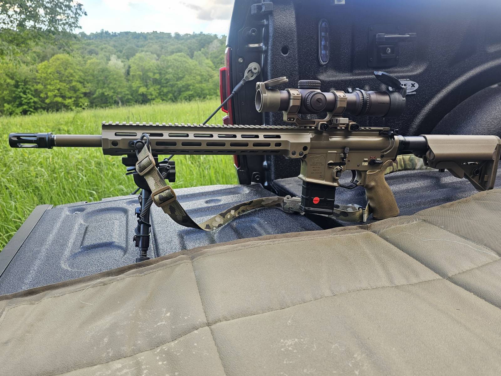

Several months ago, I bought a LMT MRP 5.56mm rifle during a Black Friday sale. I'm a bit of an accuracy enthusiast with AR rifles, but I also like a practical weight carbine suitable for general use.

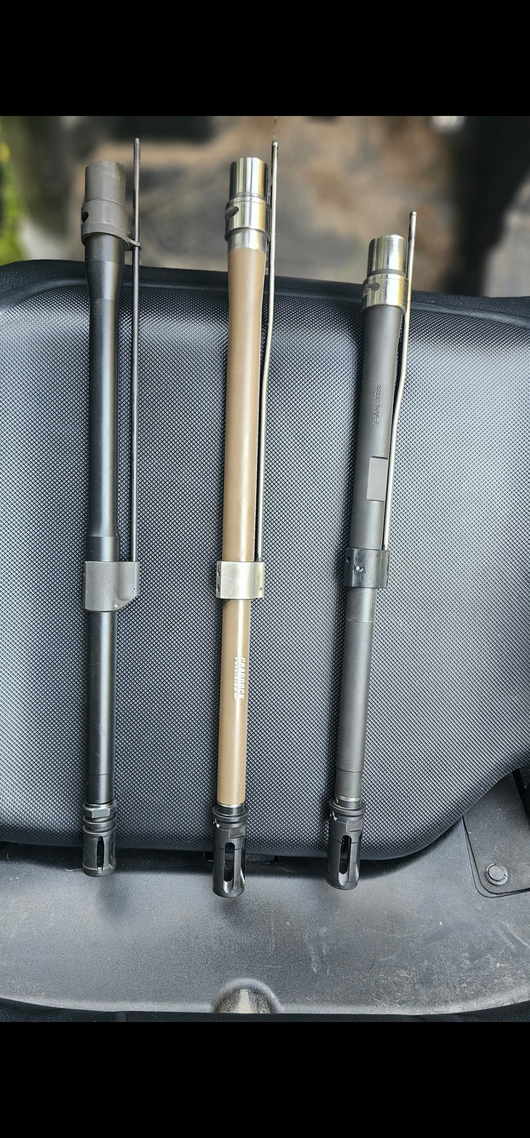

Over the past several months, I purchased 4 different barrels for this rifle, I figured I would share my results as it might be helpful to others. I spent considerable time with each barrel over the months, each one has at least 200 rounds downrange. Today's results were fairly representative of my more extensive testing with each barrel.

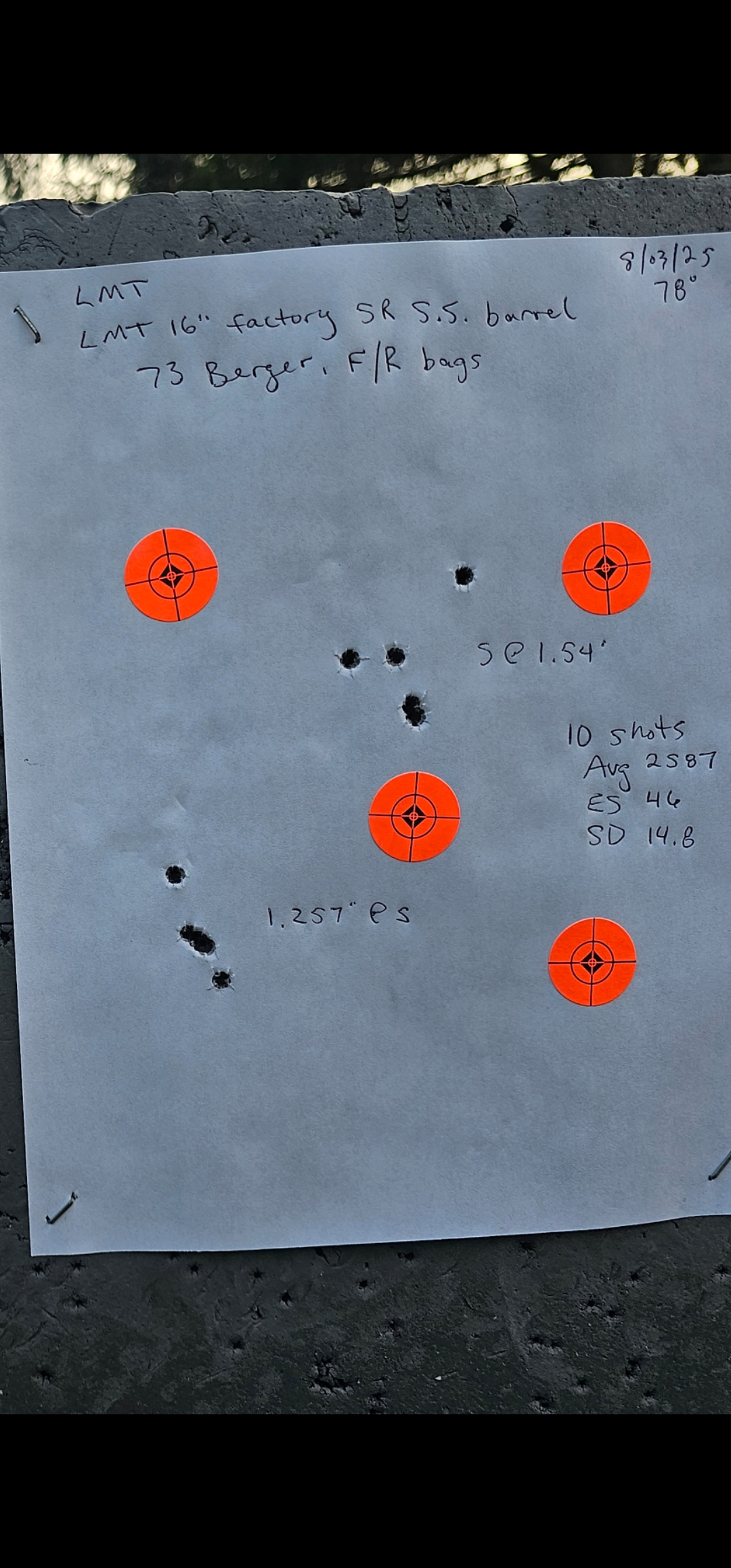

First up, the factory LMT 16 Chrome lined Barrel. This produced groups measuring 1.53 and 1.72, velocity was 2,573 with an extreme spread of 50 and SD of 15.9

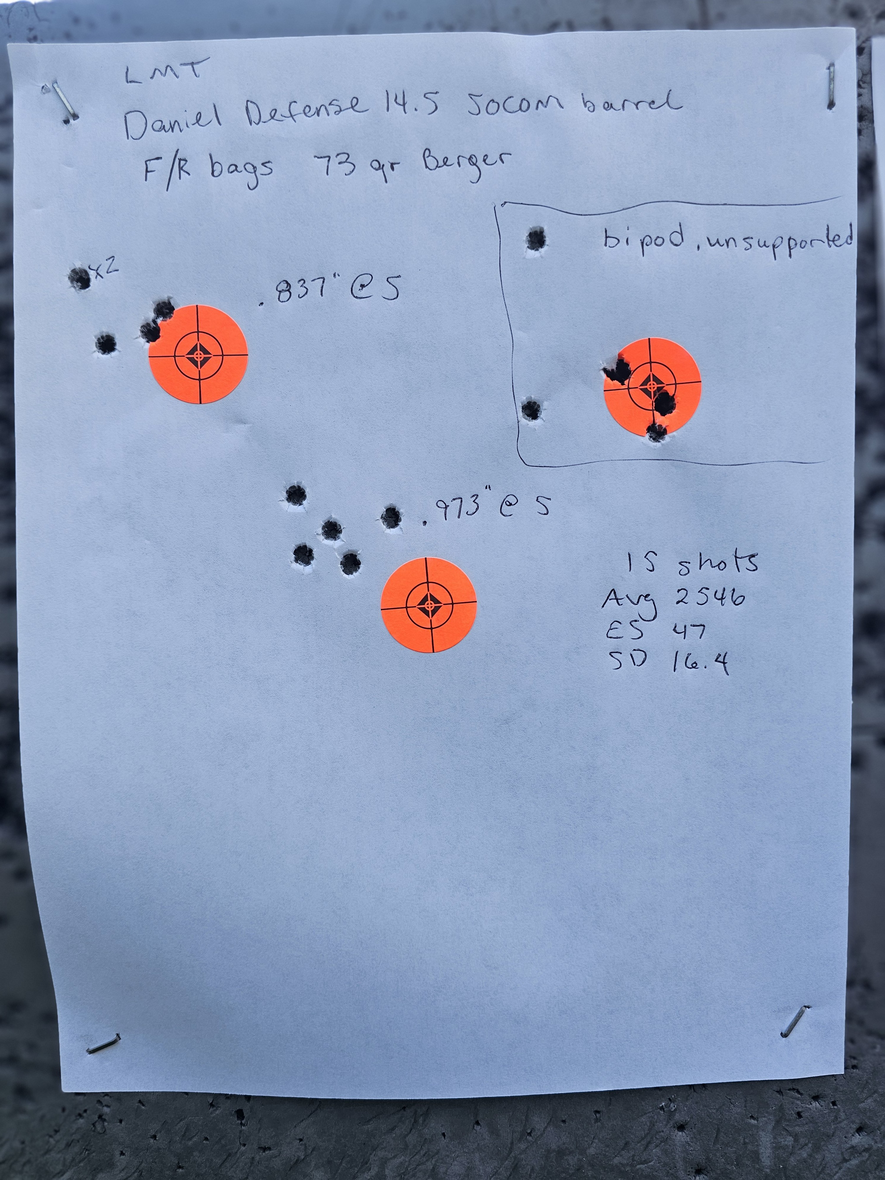

Next up are two barrels that I had D Wilson convert, I'm very pleased with both of them. The first is a Daniel Defense 14.5 heavy SOCOM profile carbine length CHF Chrome lined barrel. This thing consistently hovers at or just under 1 MOA. Ejection is at 3 o'clock, it's gassed really well for a fighting carbine. Groups were .837" and .973" ( ignore the upper right target, I shot this unsupported as I was just getting on paper)

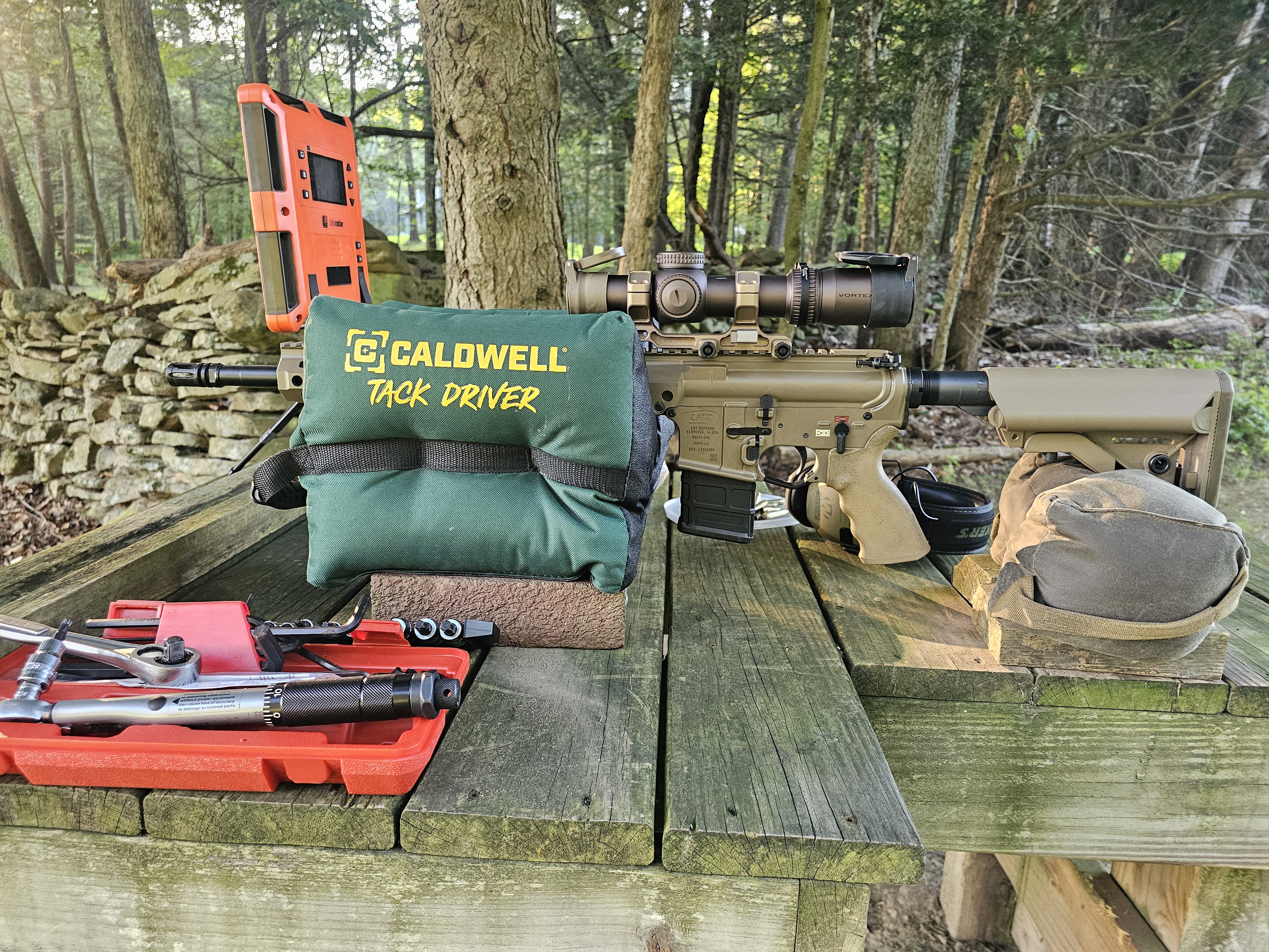

All groups were shot with a Vortex 1-10 razor, not the best optic for shooting groups, but it's very practical and it works great for the type of shooting I do. Here are some additional photos showing the barrels, rifle, stuff like that

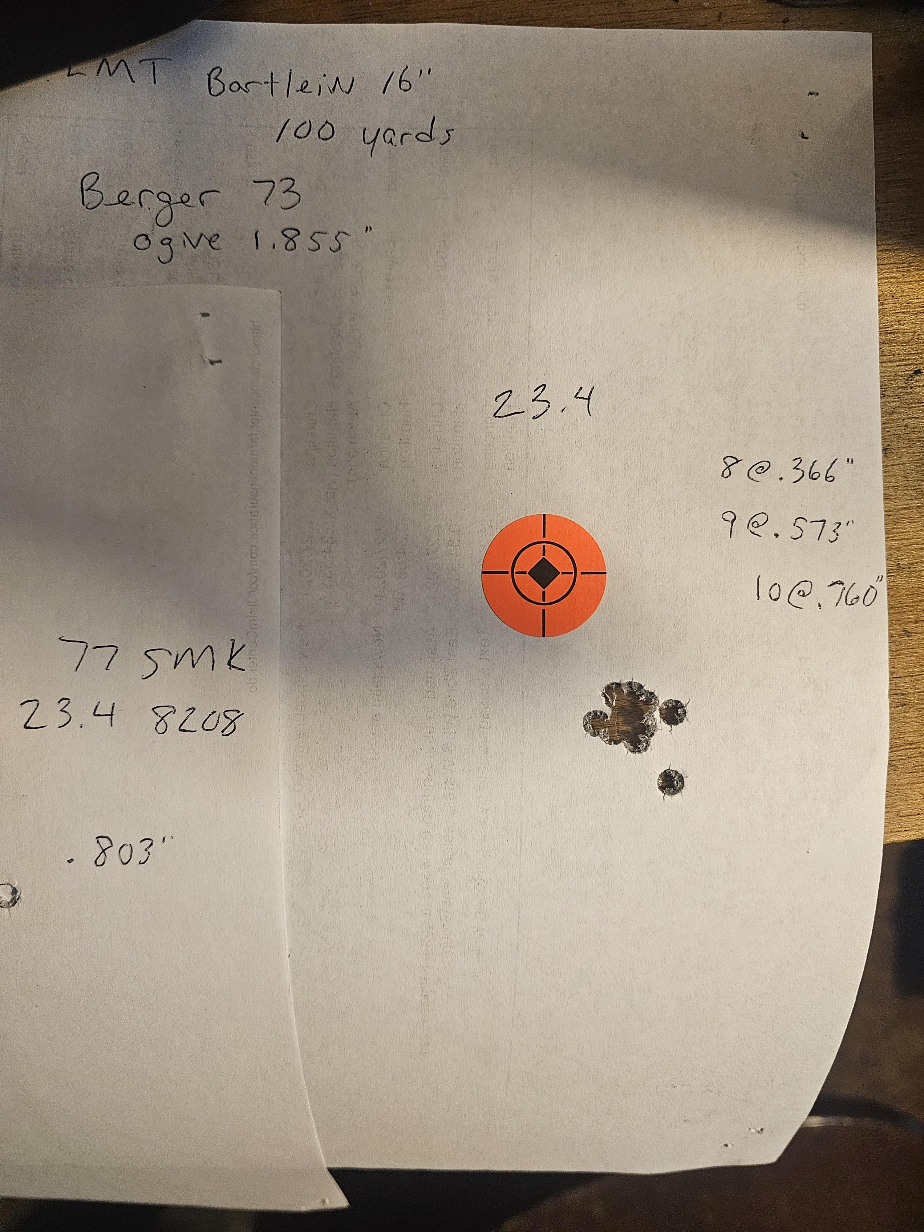

Here’s a 10 round group with the Bartlein:

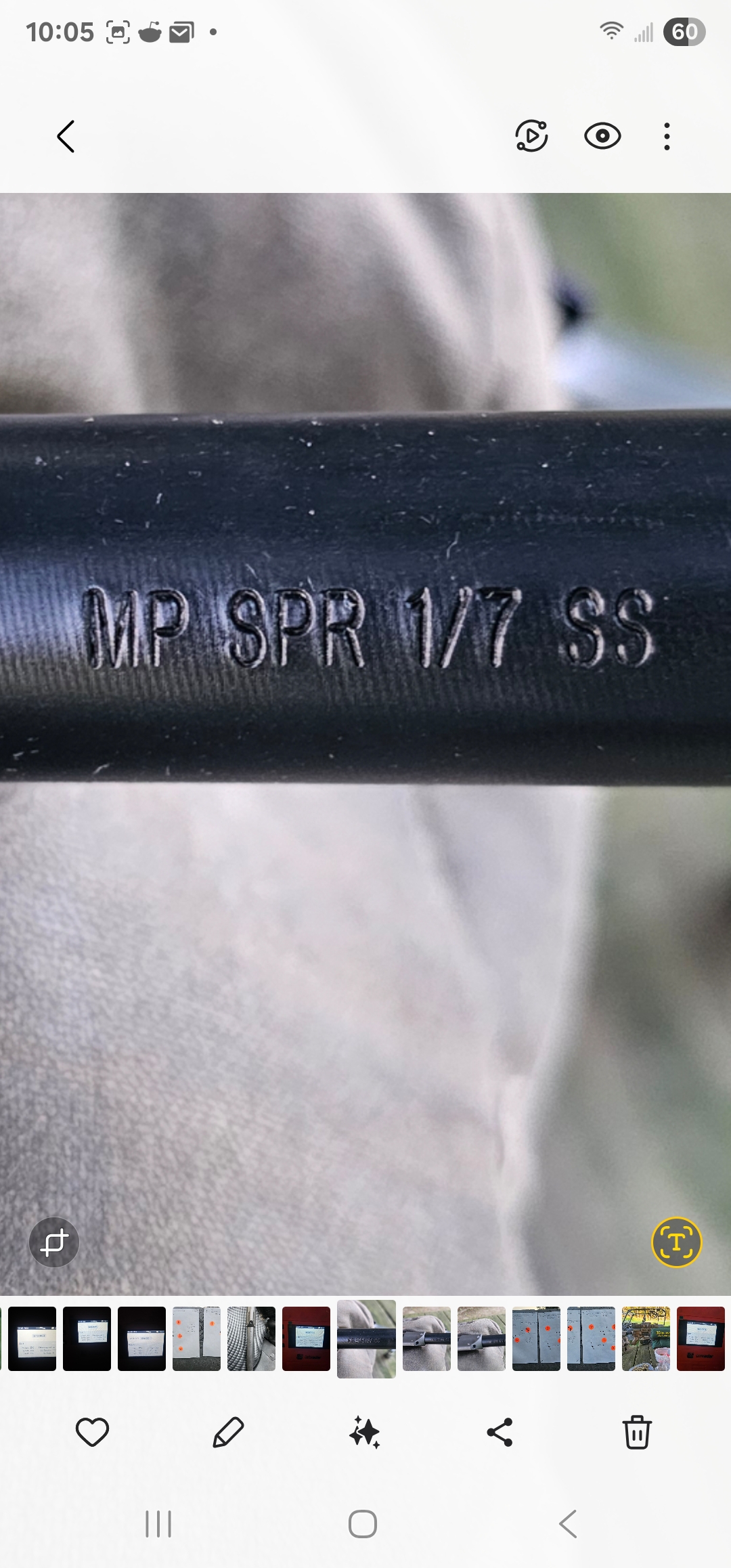

You show a picture a SS SPR 1/7 barrel, but mention a 16" 5R barrel.
I have several of the earlier (bright SS), and second generation (Black) that are LMT 18" SPR barrels, and they shoot exceptionally well, sub-moa. My first one with well over 3K rounds through it still shoots sub-moa, but as soon as it gets hot, the shots start to scatter beyond 500-yards. I primarily use various flavors of 77gr SMK factory ammo in either .223 or 5.56.

LMT AR-15 Barrel 16'' 5.56 Stainless Steel 5R Cut 1:7" Twist https://share.google/wKMU22MIpubK8tXs0
I attached a link for the exact barrel I bought. LMT describes it as stainless steel, 5r cut rifled. It is 16" and stamped as shown in the photo. It has continued to show a little bit of improvement, but even the test tag that came with the barrel lists it as 1.51 MOA during test firing by LMT

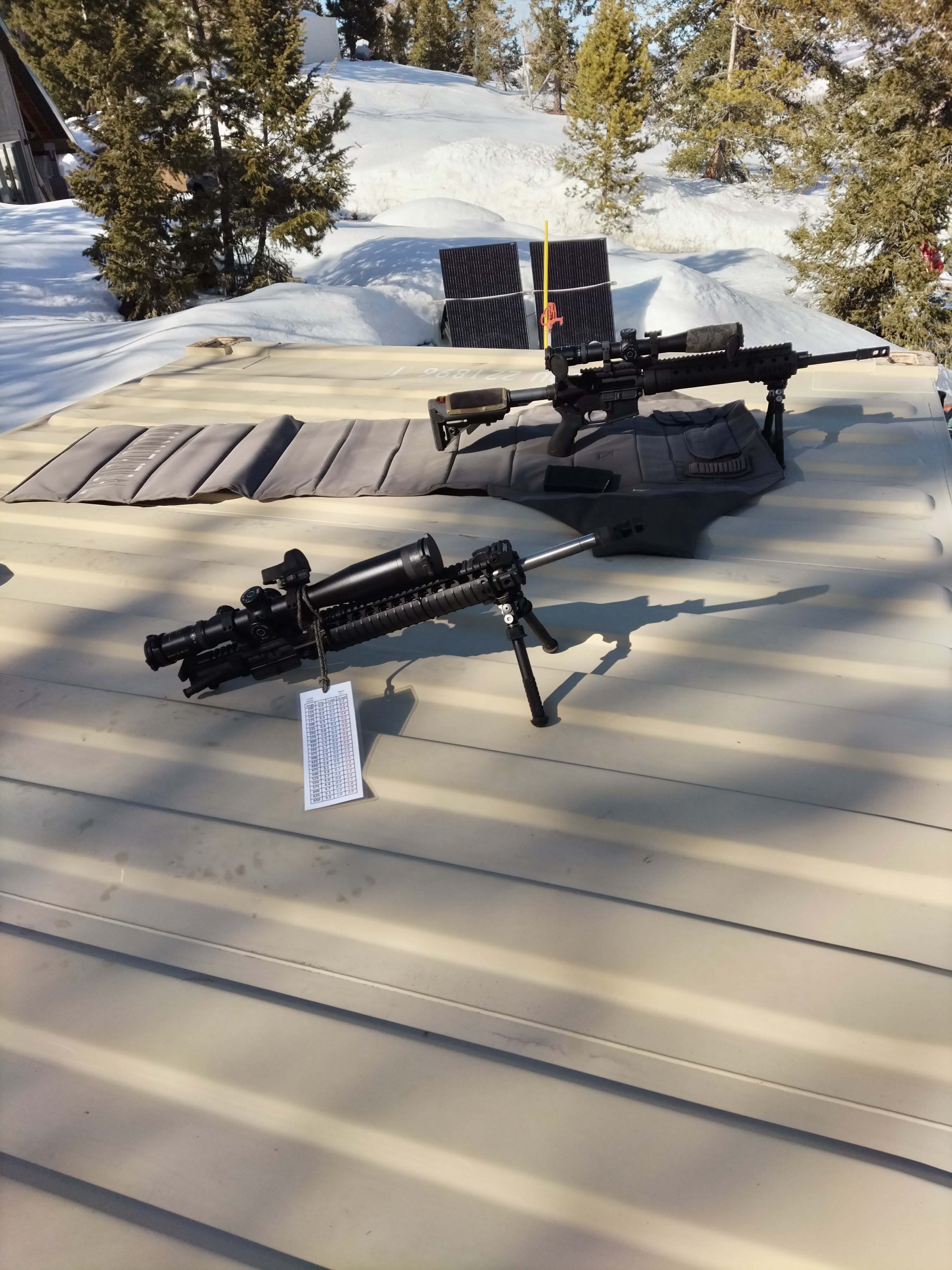

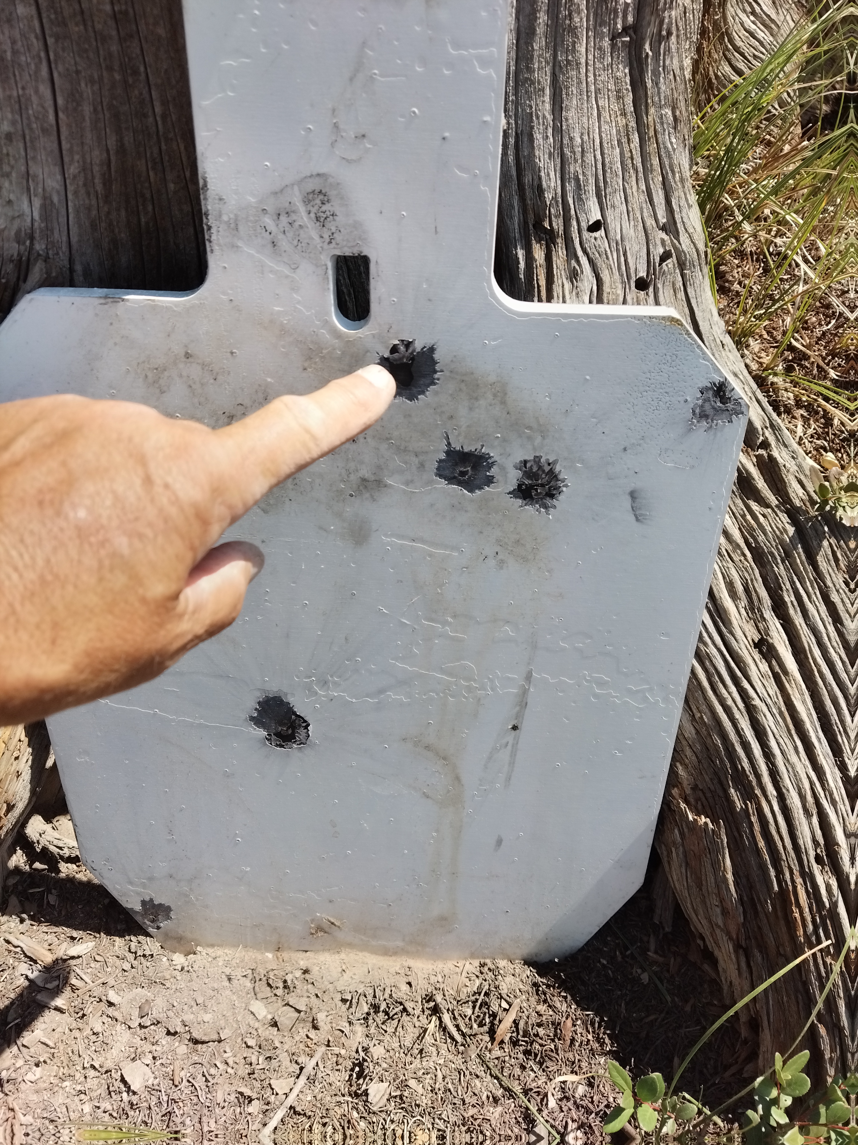

This is a 1/3 size IPSC target placed at 800 yards. 8 out of 10 shots on target with my first 18" LMT SS SPR barrel using factory Norma 223 with 77gr (I assume SMK?).
Four of the hits impacted in two spots on top of each other. My finger is on one in the top picture.

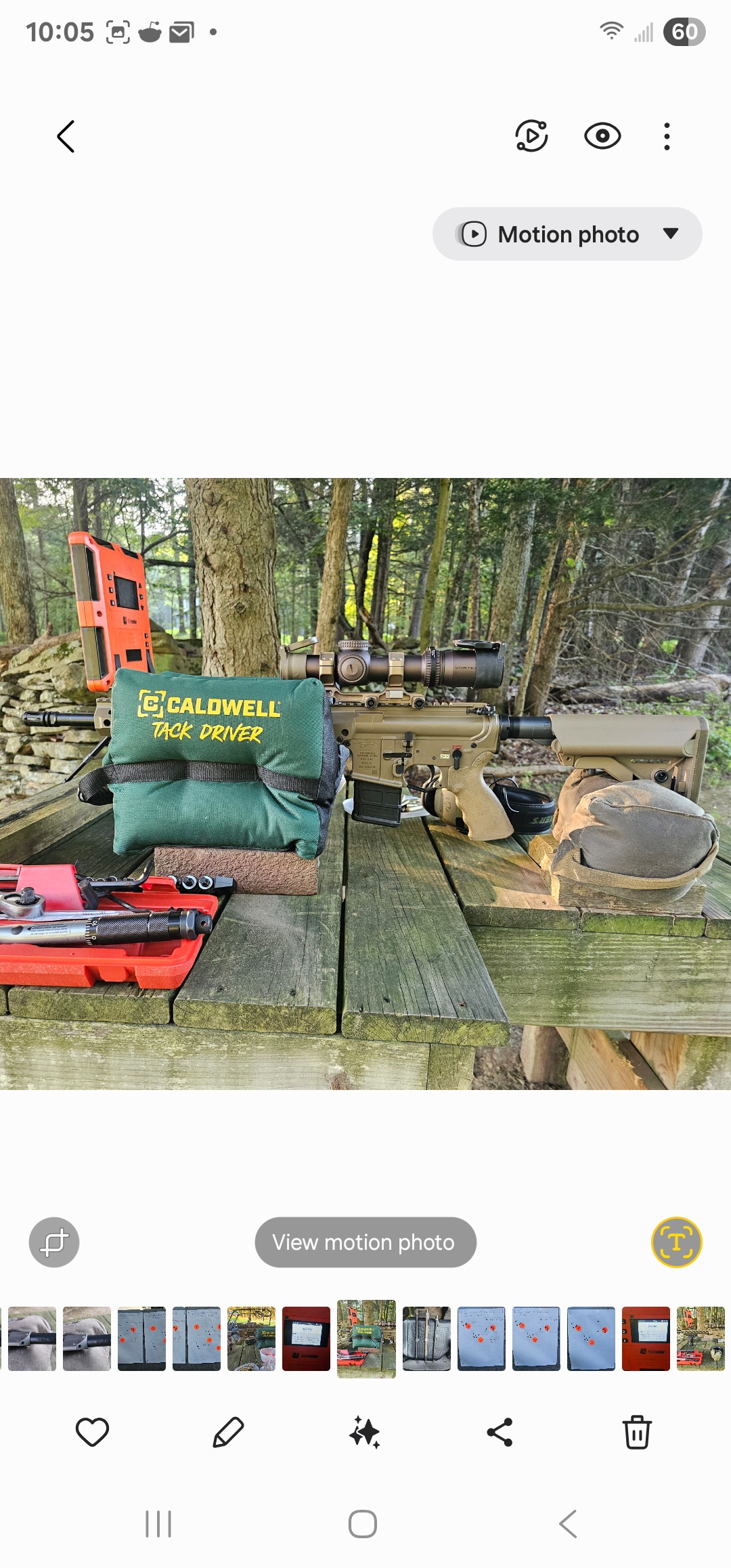

The rifle on top has a custom built Mk12 clone (not exact spec) upper put together by Ross Precision using a Bartlein SPR profile 4-groove SS barrel, with CLE chamber. Just going through the steps of breaking in the barrel, and zeroing the scope.
The upper receiver below that is the LMT MRP with 18" barrel that I used on the steel target above. I've used it at numerous team matches, including three Competition Dynamics Team Safari matches, where we placed second and forth the first two years shooting that match. I need to retire the barrel as I said previously it's starting to open up when it gets hot.
I prefer using a SB 4-16x42 with Gen 2 Mil Dot on my precision ARs. I feel it's the perfect scope fore that role. However, I do have a SB 3-20 on a CLE custom built upper that I have a Raptor LRF mounted above, which I typically use at another team event.
I shoot off a container in the Winter because I can get above the snow, and it's easy shoveling the snow off of that vs. clearing an area on the ground to shoot from.

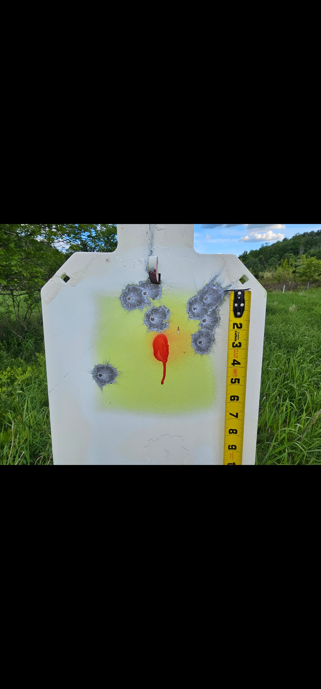

I shoot mine quite a bit at 636 yards, which is the longest shot I can easily get on my property. This is about a 6.5" square on a 2/3 silhouette, using 5.56mm LMT with 16" Bartlein barrel from Craddock Precision. That low left shot was an overcorrection on my part, shooting was done with a Vortex 1-10 razor, more magnification would be great for days like that, but much of my shooting is closer
