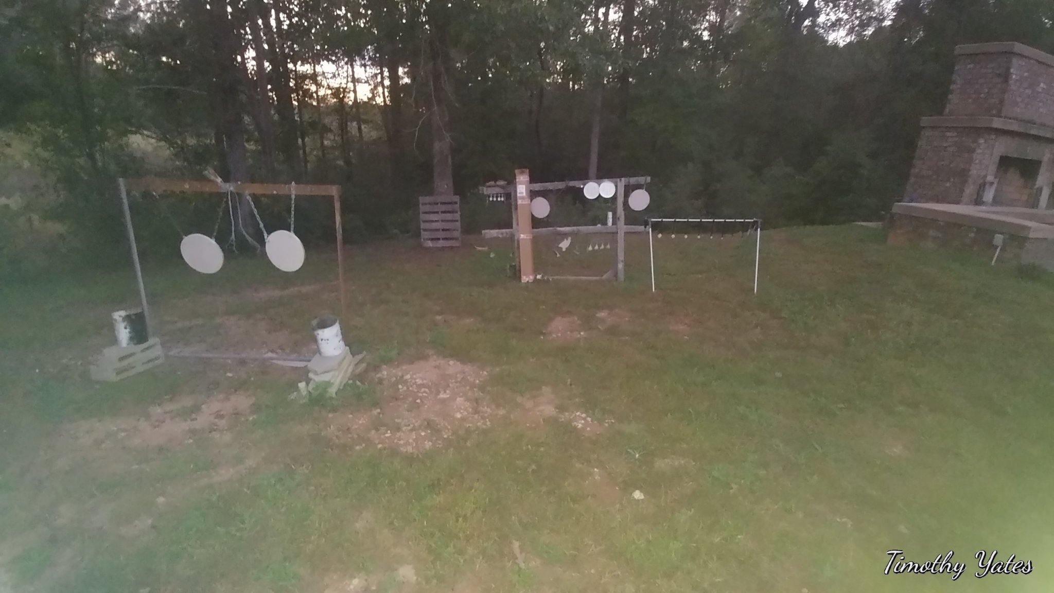

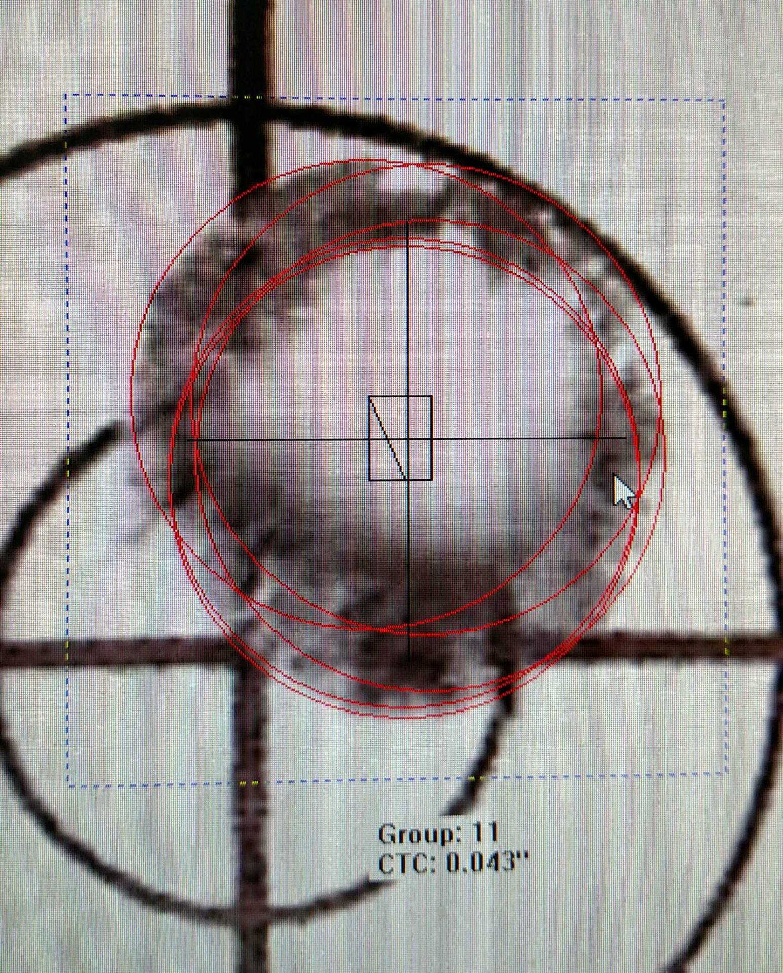

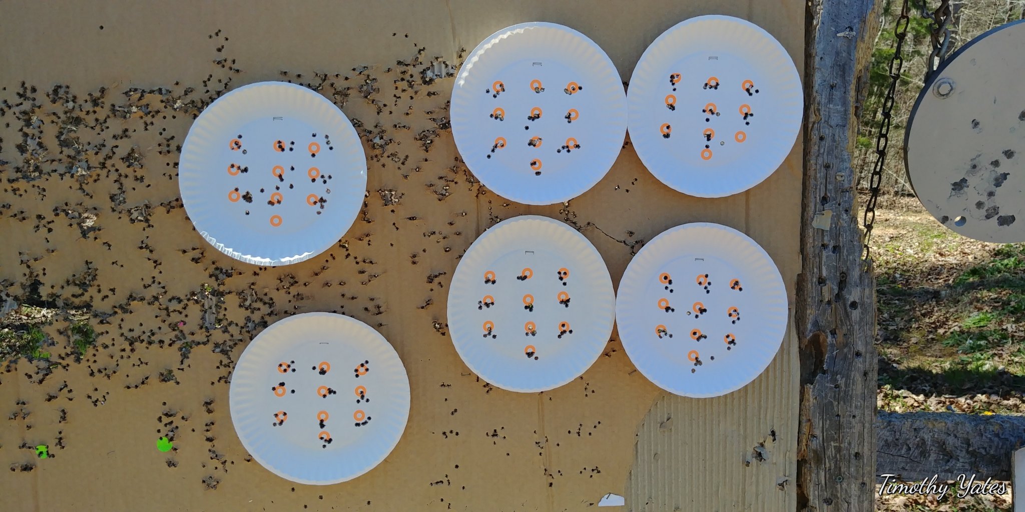

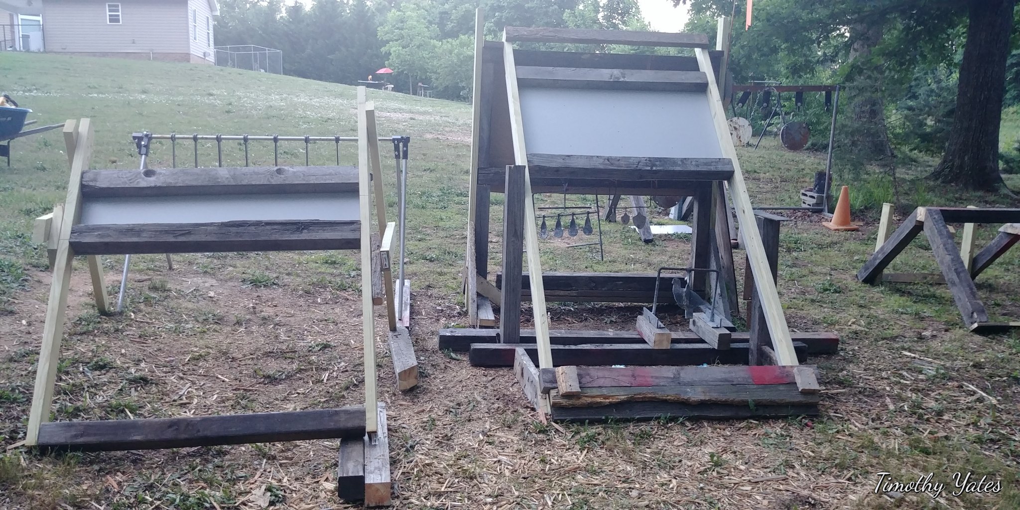

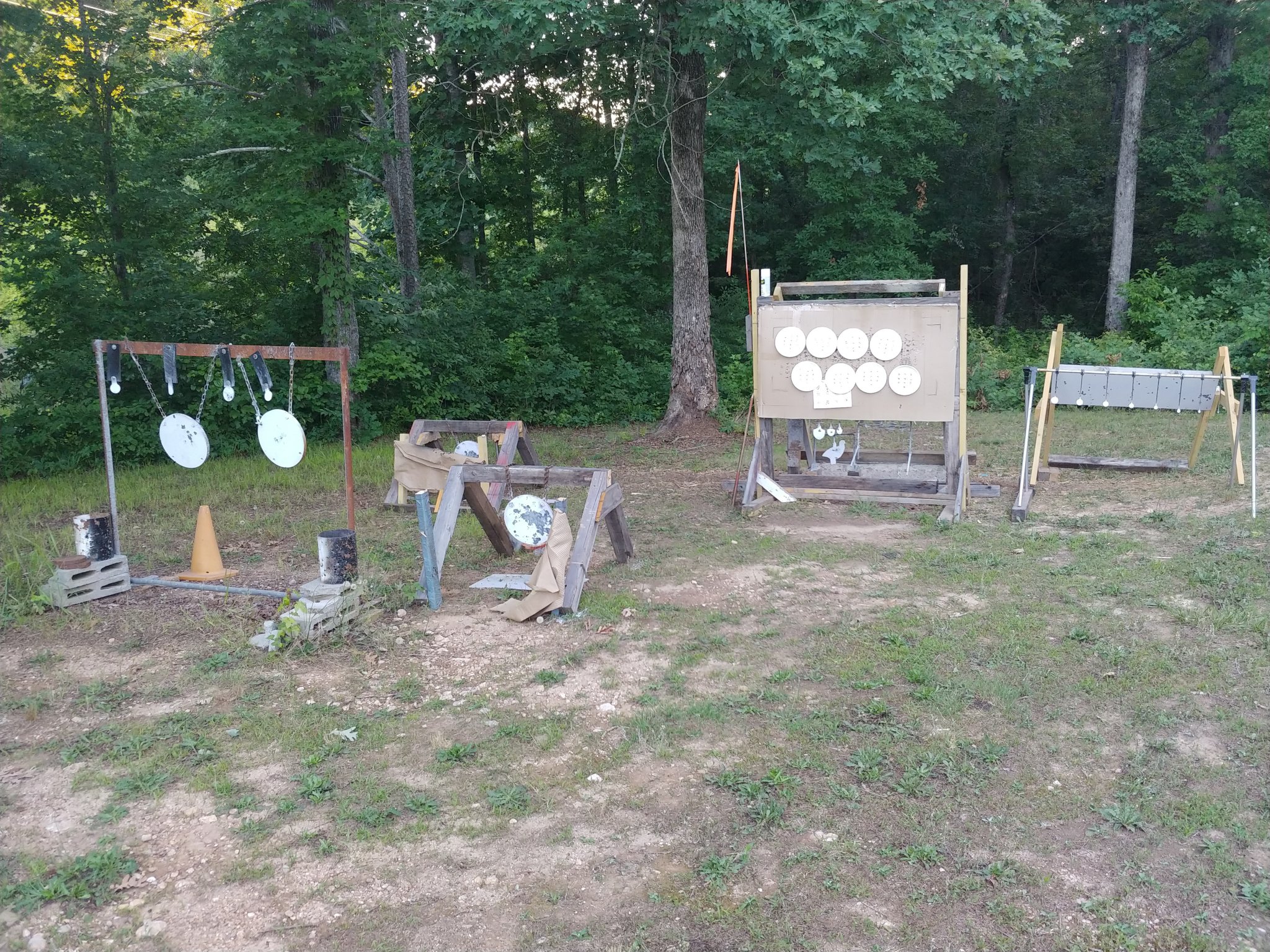

Well, here are my feelings toward testing ammo. I have a backyard range and sometimes shoot 1,000's of rounds in a week. I have shot 750 rounds this week so far. Way back when I shot IHMSA I used to weigh and check rim thickness. What I have come to find out from my experience is that was a waste of my time and would be today too. There are too many other variables that cause flyers or bad shot other than the rim thickness or weight like, wind, slight movement of the rifle, different trigger finger location, more shoulder pressure, changing grips styles, and the list goes on. Not saying it's a bad thing or a waste of someone else's time, just that I don't do it.
@ garandman, I don't shoot fouling shots unless I have just cleaned a barrel. Fouling shots are generally 5 or 10 rounds. Why, because that's what my mags hold, either 5 or 10. Other than that, I won't shoot fouling shots even when going from a CCI SV to a slicked up SK to a lubed up Eley. If anything happens, it's the first round to be a little off but that's generally it. Every now and then the first 5 round group will be larger than the rest. Here are my answers to your questions.
1. Just shoot groups of five and don't worry about it. YES
2. Clean between different ammo types, then fire 5 fouling shots before firing for record. NO
3. Don't clean, but fire 10-20 fouling shots to transition btwn powder types and lubes, before firing for record. NO
When I test, I shoot the entire box of 50. Ten 5-shot groups on one target. My goal is all ten groups at or under 1/2". If I have a known issue I will note it such as wind, movement, AD's and others.
As far as accuracy and ammo types go, it's really a numbers game IMO. For example, if you shot Center-X in 10 different rifles, 6-7 of 10 would probably shoot good. If you used CCI SV in those same 10 rifles, maybe 3-4 would shoot good On the other end if you took an Anschutz 54 action and shot 10 different types of ammo the Anschutz would probably shoot good 6-7 out of 10 ammo types where a CZ, Savage, Ruger, ect would shoot good probably 3-4 out of the 10 ammo types. This is an overall generalization of rifles and ammo based on what I have seen, there will always be exceptions. My definition of good is 8 of 10 1/2" groups no matter what gun/ammo is shot.
Bottom line, is you have to do what you have confidence in. You can gather people's opinion which is what I just said above along with others but in the end you will have to do what you feel is right for you. This is just like cleaning a rimfire, only wrong way is to clean a rimfire is from the muzzle end and/or use a steel bristle brush. Just because one person's cleaning method is not like others doesn't make it incorrect, it's just different. Same applies to what you are doing now.
Attached are a few photos.
Old Range Setup.jpg20190613_201615.jpg0519191952.jpg1710 XLR Clean Target 4-5-19.jpg0323191457a.jpg
Reactions: littlepod
