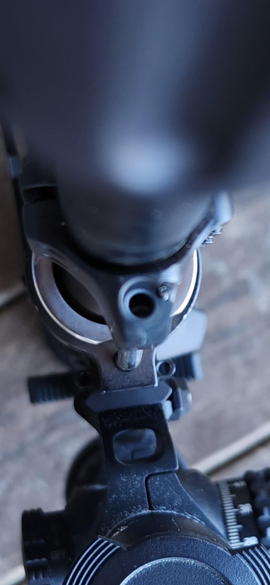

I was shooting some factory 300 blackout today. Winchester 125 grain jhps to be specific. I felt something smack me in the shooting glasses and could not figure out what it was. I gave up when I could not find anything. The casing looked fine and everhthijg functioned correctly. I fired another round and the rifle did not cycle....weird so I pulled the charging handle and ejected the casing. All looked fine, so I pulled the rifle apart and found that the damn adjustment screw from my JP D2 gas block had blown off!! No clue where it went but it left a heckuva scratch in my lense.

This is a pistol length gas system but a 16" barrel (300blk), the only thing I can figure is deflected off the inside of the handguard (I found a small scuff). I put a different gas block on it and ran another 30rds through it with no issues. I reached out to JP to see if I can get replacement parts
