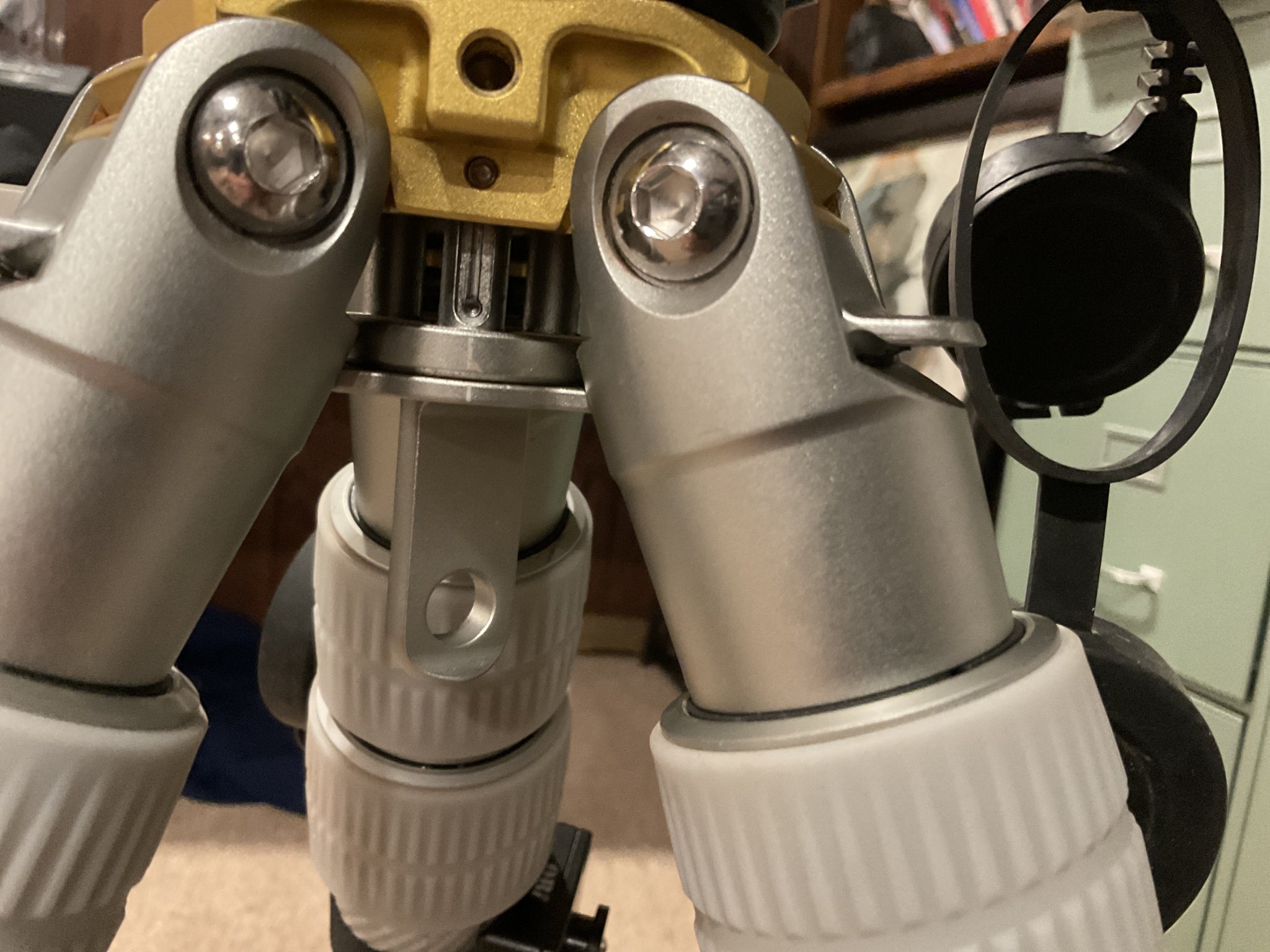

I’m not a competitor, so forgive the question if it’s stupid.
You mean that the tripod legs can be locked spread open? If so, how?
Yes they will lock in the open position. If you look at the first picture at the top, you’ll see a pull tab under the apex. That’s the lock. In that picture it’s in the locked position. You literally just pull down or push up on that tab.
Reactions: carbonbased
This nifty little “pull and twist” deal. Locked in the first photo, unlocked in the second.
Ah, I see. Thanks guys! That could be handy for my use as well, which is moving a tripod around when glassing.
