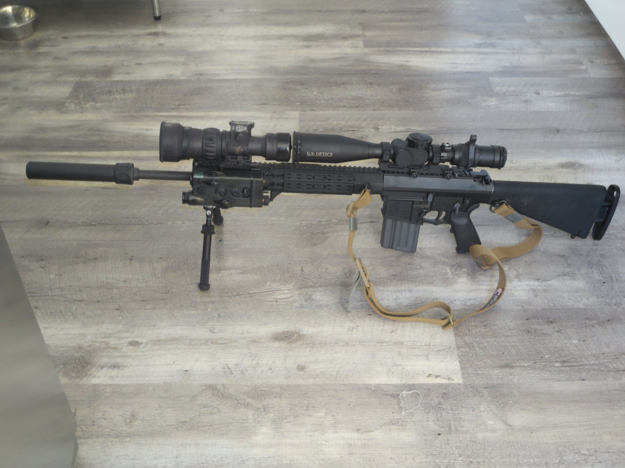

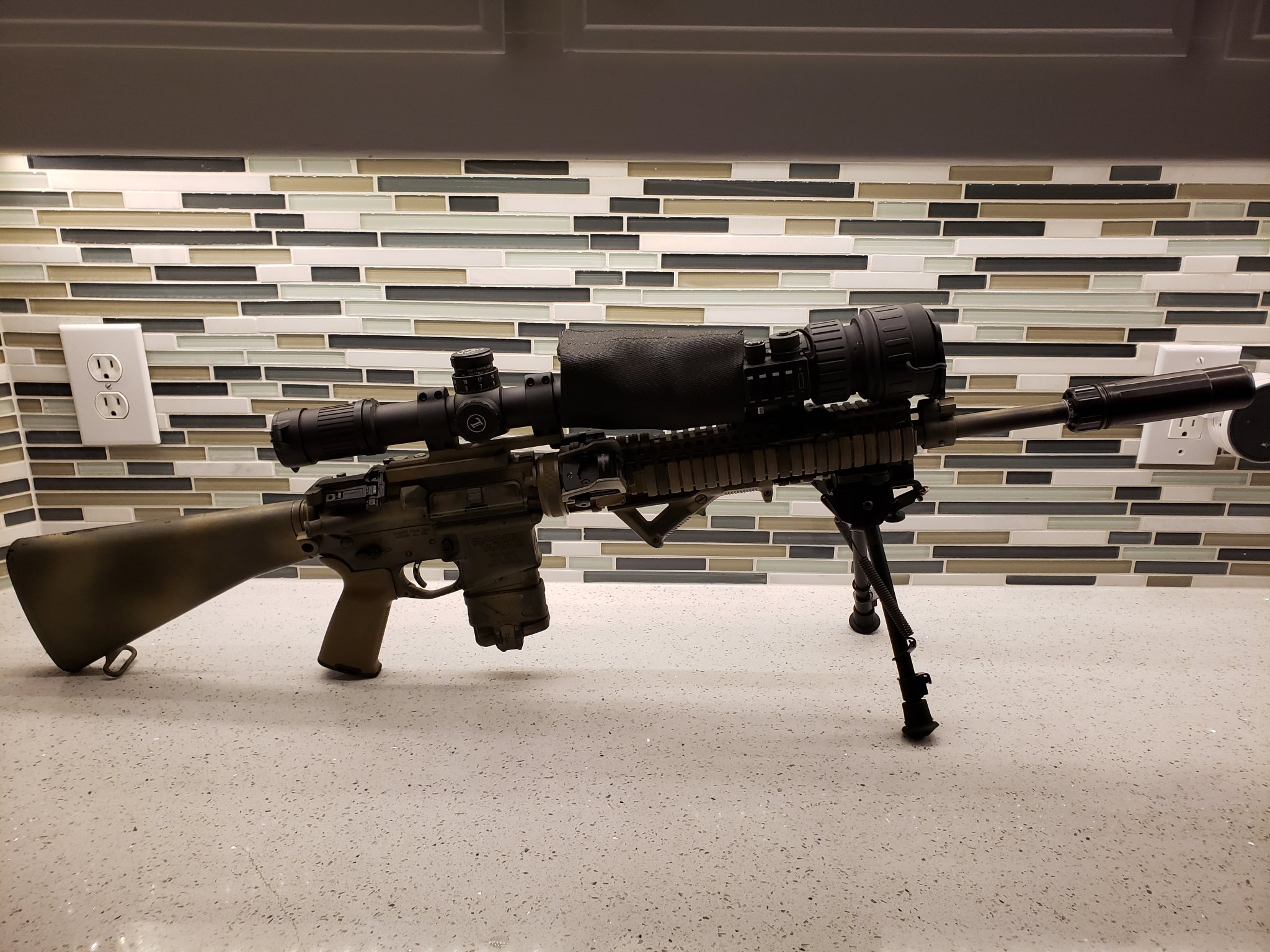

Suppressor...understandable
USO Tpal, not ideal but ok.
NV, maybe he likes to shoot shit at night??
But why the IR laser??
