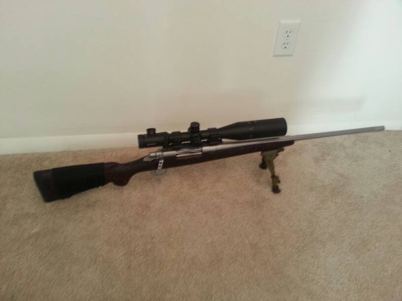

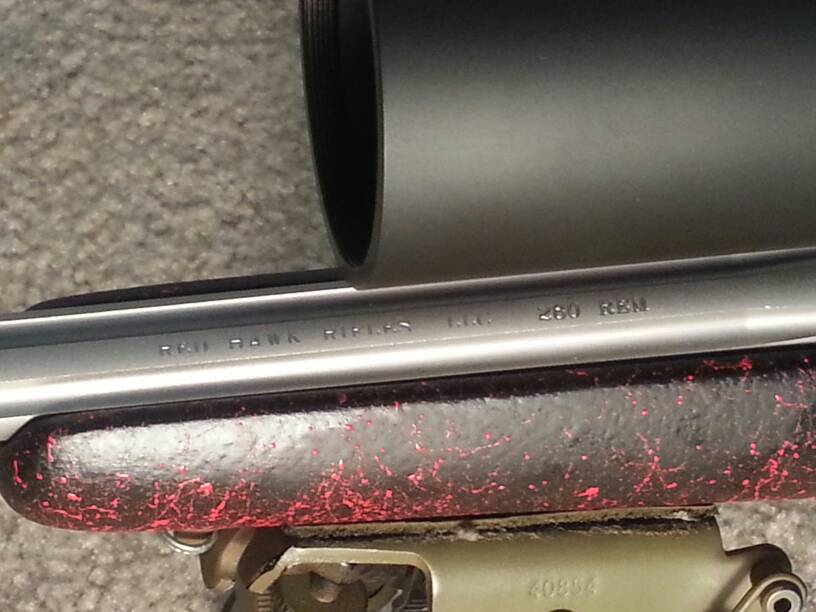

I love my 280REM. Just look at ballistic charts and you may be surprised.
Note: my gun is primarily for hunting.
Sent from my SCH-I605 using Tapatalk 2
