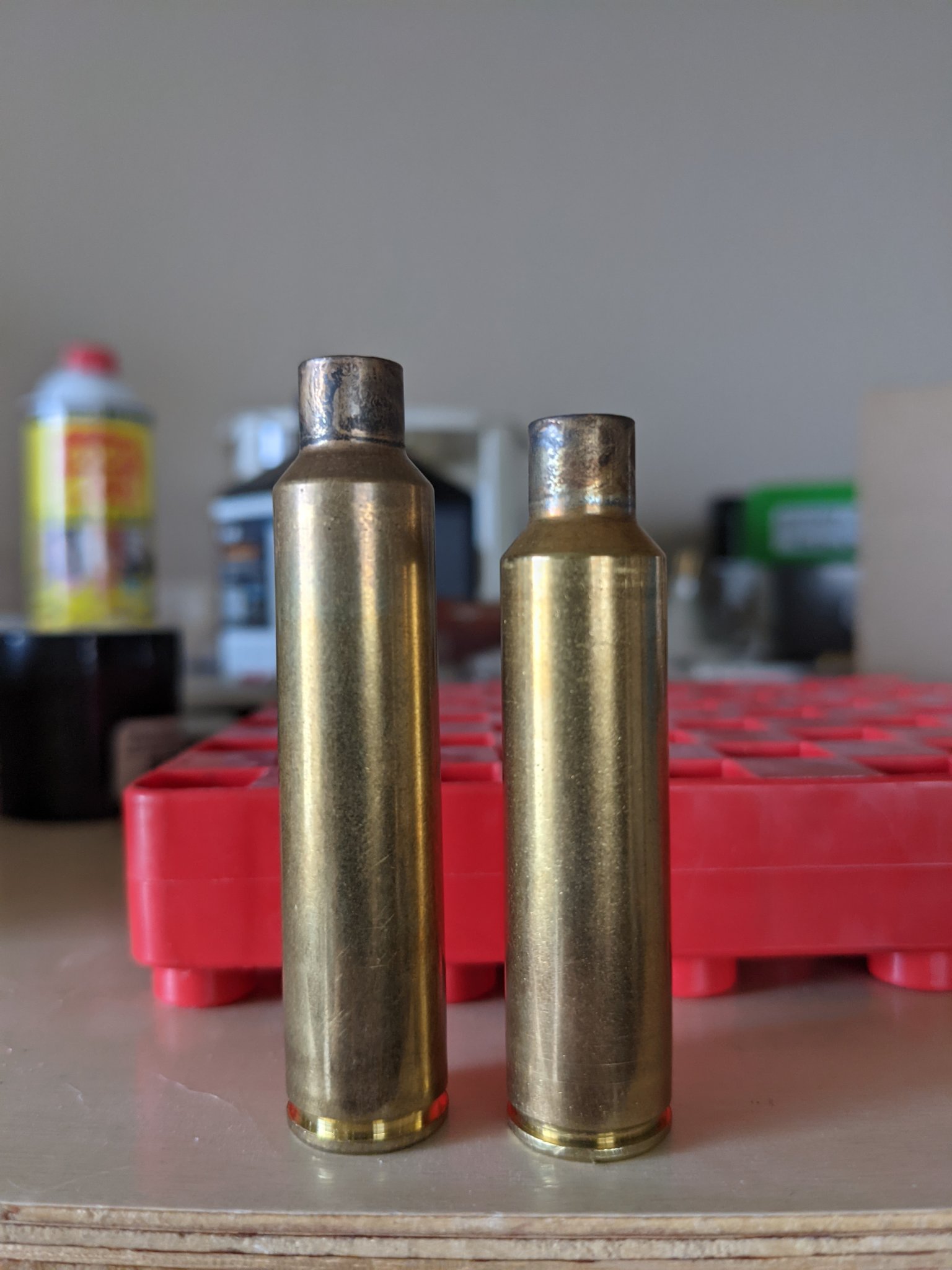

This is exactly the reason why I went with the 338 Norma (improved). I run the Lapua (improved) at 3.925 in a single shot action.
