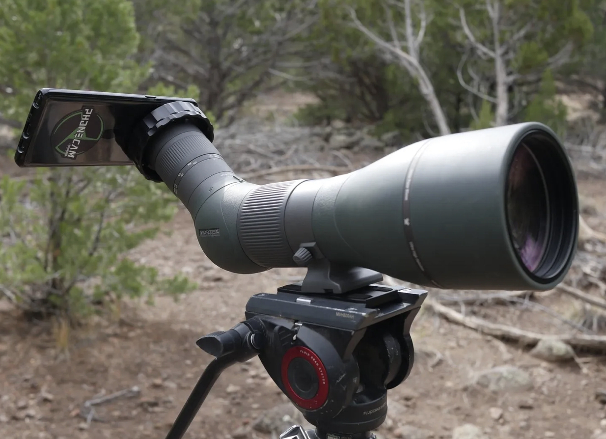

I have a iPhone 13 pro max and a Vortex Razor 27x-60x85mm spotting scope. I want to leave an adapter on the scope to be able to quickly snap my phone in. I also want to have it set up so the horizon is level each time I snap the phone in (no readjusting after the initial setup). It is a given that I would level the tripod beforehand.

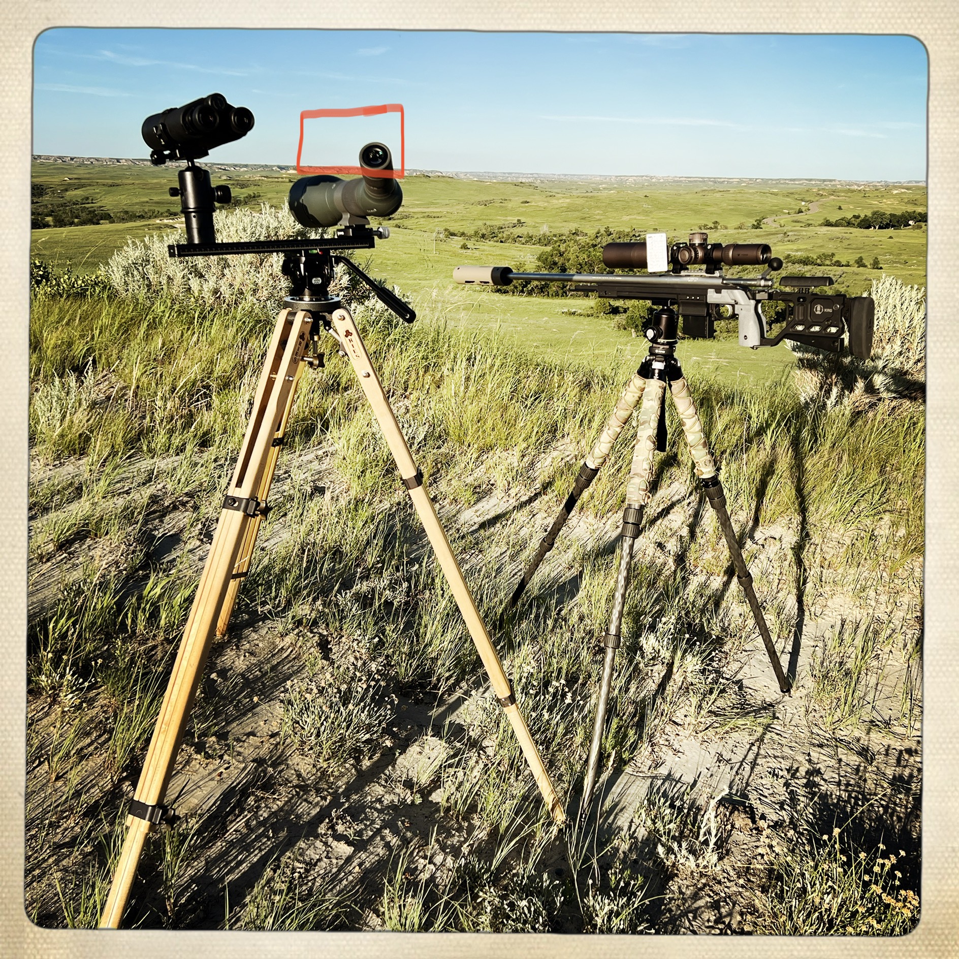

I have Leica 15x LRF binos co-witnessed (if that’s the correct word) with the spotter so once I find a prairie dog in the binos, the little bugger magically appears upon the phone screen. Saves a ton of time!
Notice the spotter is rotated left 45°. That’s so one can use the binos to scan for targets and range, make one turn of their head, and quickly and easily see the phone screen. I don’t have my Phone Cam adapter on the scope because I’m using my phone to take this pic.

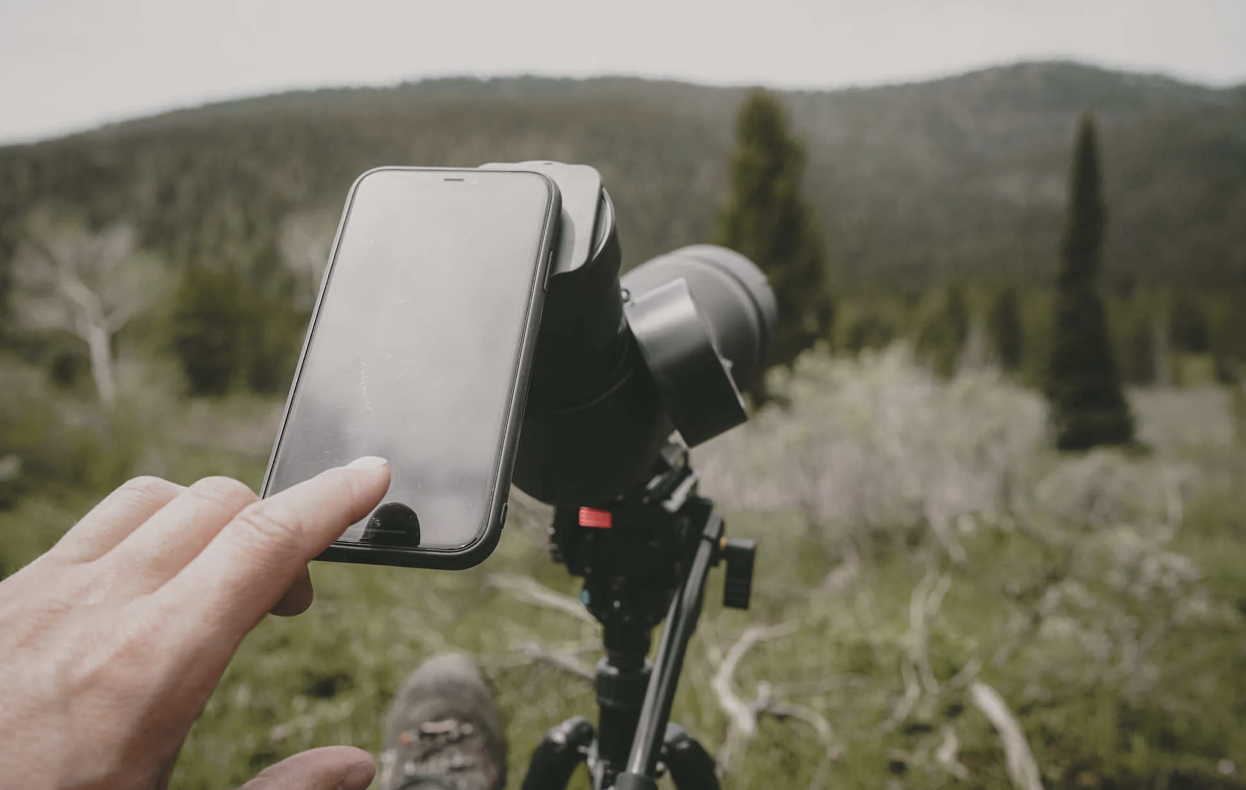

How the phone attaches in landscape mode in my setup

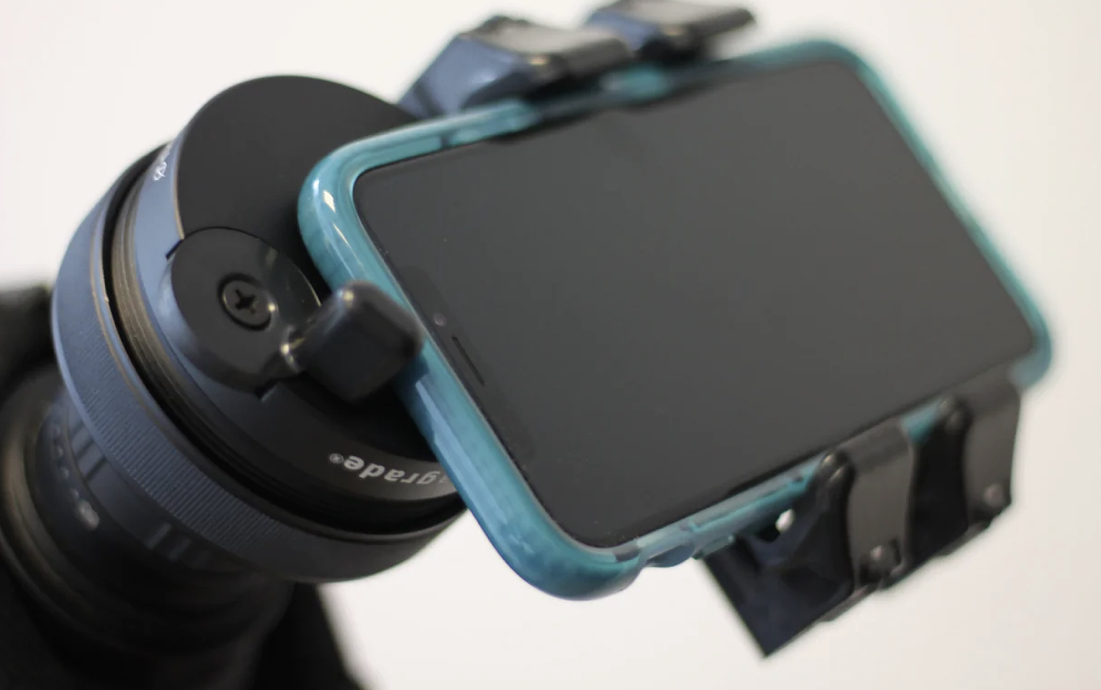

So, I’ve used the Novagrade (not great, thought it was going to be, but ultimately not for me) and the Phone Cam. The Phone Cam, while much better (remember, for me) had some issues in my little, tiny world.
The problem was making sure that the gripping portion (a 3-jaw chuck, basically) of the adapter grips at the angle at which you want it to (a two-hand job).
It’s at the last little throw at the end of the tightening where it’s very easy to misalign the phone + adapter to the horizon. It’s due to the adjustable eyecup of the spotter, which rotates a little as you tighten the adapter. Grrrrr.

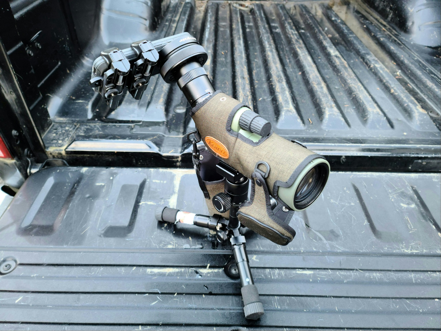

Examples of using an angled spotter rotated left/right at 45°:
  1. in a truck with spotter attached to window—spotter must be rotated left at 45° (too tall to use at 0°)
  2. spotting down/up on a steep slope without drastically changing tripod height
  3. my weirdo use detailed above, etc.
A bit of detail: assuming the spotter is straight up at 0°, if you want to shoot vids in landscape mode and rotate the spotter:

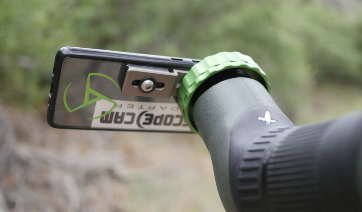

Phone Cam / PhoneCam by Scope Cam (technically called the Otterbox PhoneCam Kit with Universal Adapter). I own this. They make a bunch of other models, see my commentary at the end):
  • Pros:
    • Robust and precise aluminum construction
    • Really good grip on eyepiece, nonslip
    • Very good alignment, no fuss once tightened
    • Otterbox case with adapter is pretty low profile and not obnoxiously large with huge protrusions
    • Flashlight is largely usable, but blocked a tiny bit
  • Pro-ish/Con-ish
    • It’s indexable, but not in a quick way. I didn’t think it was possible but I discovered a workaround today by goofing around (leave adapter on scope, spin phone on, use built-in eyecup adjustment to start the threads)
  • Cons:
    • especially at a 45° rotation, a bit fiddly to get horizon level
    • Slowish to attach
    • Blocks other lenses (uses the regular iPhone 13 Pro Max lens)
    • If left on spotter (like I want to do to preserve indexabity), a bit bulky and hard to use spotter “normally”
      • Also if used this way, no great way to cover eyepiece in the bag
    • If taken off spotter each use, would get cold in winter due to metal construction
  • Neutral
    • Phone specific fit; spotter fit is universal fit
Commentary on new product so the following contains more conjecture than the rest of this piece. Didn’t talk to owner about this one. Scope cam has a few new products, but the following is of the most interest to me: https://scopecamadapter.com/product/new-mag-plate-universal-digiscoping-kit/

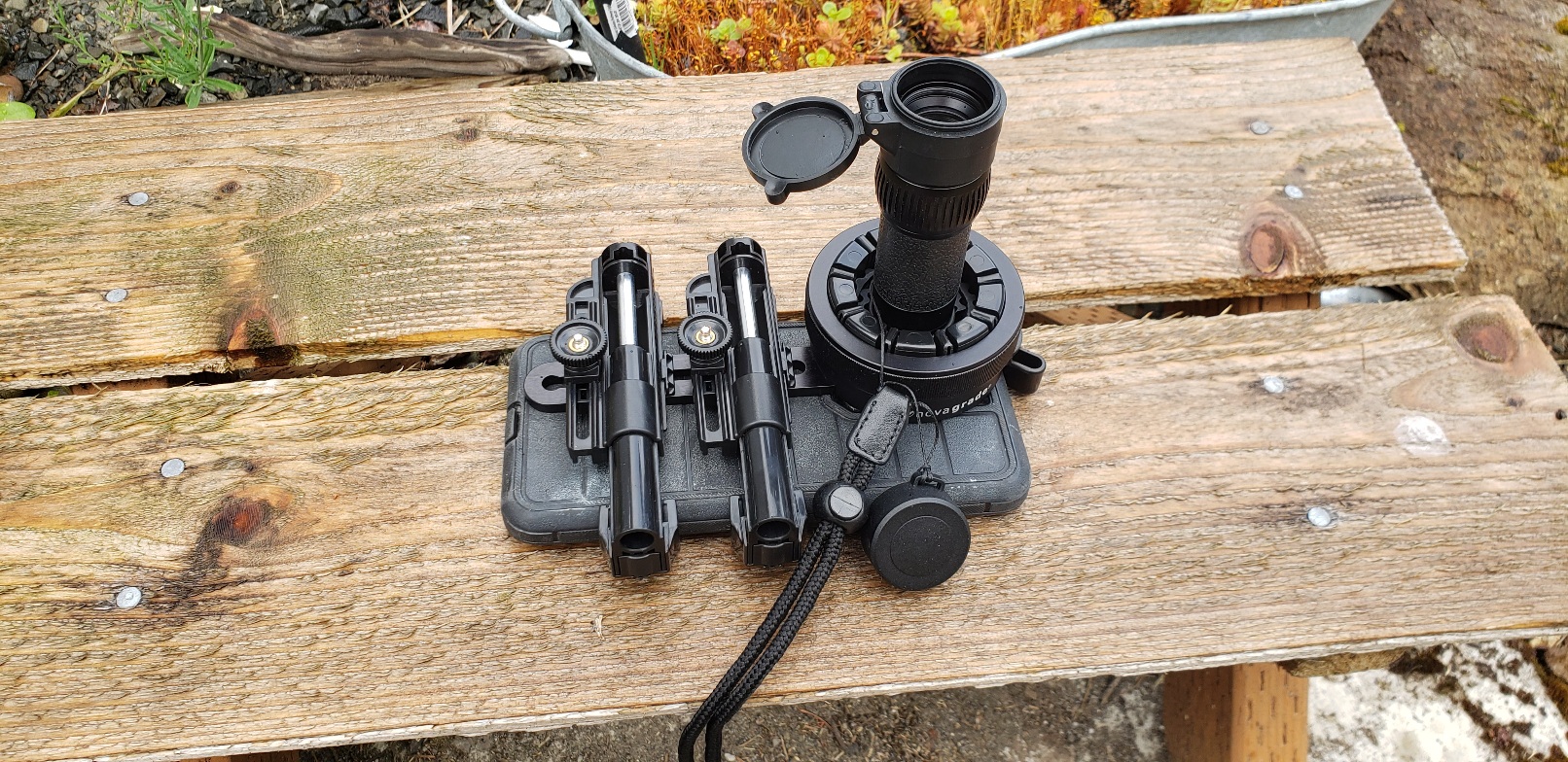

Ollin (talked to owner, watched manufacturer’s vids and interviews, but analysis contains some conjuncture):
  • Pros:
    • Looks like it is super quick to attach correctly
    • Indexes/aligns instantly and correctly in landscape OR portrait needing no readjustment
    • Eyepiece adapter seems to allow “normal” use of spotter (but doublecheck)
    • no effect on GPS (according to company owner)
  • Pro-ish/Con-ish
    • Eyepiece is push-on (quickly adjustable). But there’s always a chance of it slipping, especially with a straight spotter.
  • Cons:
    • Uses only regular lens (i.e. blocks other lenses)
    • Blocks flashlight
    • Phone case flange sticks out a bit far
  • Neutral/Unknowns
    • Phone & spotter specific fit
    • Not sure if eyepiece adapter would scratch glasses
    • Might get knocked off a tad bit easier than mechanical attachment methods?
    • Comes with a magnetic eyepiece cover with a lanyard (I don’t use lanyards because the caps blow around too much in the Dakota wind which causes vibration in the image)
Phone Skope / PhoneSkope - watched a bunch of manufacturer’s vids and had a short email with them about the indexability so contains a bit more conjecture. Including a couple vids because it’s pretty hard to explain with words:
  • Pros:
    • Indexable
    • Large adapter comes off the case (at least with my model phone) leaving just the case with no protrusions
    • Because of the above, doesn’t block flashlight
    • Case allows switching between tele and regular lenses
    • Looks very quick to attach, some tenths of seconds slower than Ollin. Uses camera-like bayonet mount.
    • Has app that stops auto lens switching
  • Pro-ish/Con-ish:
    • Spotter-specific custom eyepiece is push-on (can quickly adjust the index points if rotated from, say, 0° to 45°). But, press fit means there’s always a chance of it slipping, especially with a straight spotter.
    • They do also offer a universal attachment similar to the Phone Cam. Did no research on that option.
  • Cons:
    • Case seems to expose too much of the sides of the phone to damage if dropped
    • Weird case cutouts might interfere with car mount
    • If you want the unit to be ready to go in a moments notice you have to leave the HUGE circular attachment on the case
    • Personally I think the logo design on the case is a bit much
  • Neutral/Unknowns:
    • If you do switch between tele and the regular lenses, videos show it takes some effort to do this. Probably need to take phone off spotter. Probably not a practical issue?
    • Durability of case? Lots going on there.
    • Don’t think there’s a way to cover eyepiece with the custom adapter attached, but at least it is not bulky and you might be able to fashion or find something that works. I could be wrong and the adapter sits low enough so your factory cover fits
Novagrade Double Gripper (bought this for my brother and used it too)
  • I’m not going to go into this one too much because frankly, if you use my criteria, it comes out quite poorly.
  • Unless I’m totally using it wrong, it was pretty slow to attach, really really fussy to get the phone adjusted/aligned correctly, and in no way could one keep it on the phone and slide it in your pocket, etc or conversely, to leave it attached to the spotter. It would be ok for a very purposeful digiscope setup where you dedicate the phone to video/photo and don’t expect to use the phone for much anything else. Sorry Novagrade!

Yeah, even the ScopeCam is waaaay better for my use than the Novagrade.
The Ollin and Phone Skope offer easy indexability, where you set the angle you want once. For example, say I want landscape orientation with the spotter straight up (0°).
Assuming the tripod is level, then each time you lock in you get that same exact angle. And with the Ollin, you get both landscape AND portrait orientation locked in at that angle.

Quick disconnect from spotter FYI: the MagView, Phone Skope, and Ollin all provide that. The Ollin’s case has a permanent bumpout while the gigantic circle on the Skope is (easily?) removable. The guy doing it in the vids makes it looks relatively easy, but he’s probably done it a thousand times.
The thing that makes me a little leery on the MagView is that it doesn’t align or index instantly. It seems to get real close but requires practice. But it’s soooo low profile and seems to work well on binos too.
I have only messed with Phone Skope. Started out with the universal objective adapter, which you mentioned you haven’t tried yet. I will save you some time, don’t mess with it. I found it to be a royal pain in the ass.
However, if you get the dedicated piece that matches the OD of your optic objective, I think it’s a pretty good system and I’ve been very happy with it on a spotter. The big circle on the phone case is a non-issue for me because I only put the case on when I’m out in the field, which means my phone is being carried somewhere other than my pocket to begin with.

So a lack of reviews about digiscoping with a phone and spotter (or binos) that uses both a critical eye AND are thorough led me to collect, organize, and write up this info.
I have no biz or personal relationship with any of these fine upstanding manufacturers.
I have hands-on experience with two of the units discussed below, and have done fairly exhaustive research (including phone calls with biz owners and reps, reading reviews, and of course pouring over videos). But I expect I am wrong somewhere (let me know!) and I’m treating this as a living document.
My purpose & use
What’s the problem, man?
The problem was not ascertaining if the horizon was level via the phone image, it was making sure that the gripping portion (a 3-jaw chuck, basically) of the adapter grips at the angle at which you want it to (a two-hand job).
It’s at the last little throw at the end of the tightening where it’s very easy to misalign the camera and adapter unit due to the adjustable eyecup of the spotter. Additionally, doing this with the spotter rotated to 45° messes with one’s internal “level”. The result is a horizon that is distractingly off. (And I’m not looking for perfection!)
“Ah!” you might say. “Just attach it when the spotter is rotated to 0°!” Well if the spotter is at 0° one has to attach the phone at a 135° angle to ultimately get a level horizon in landscape mode after you rotate the spotter left-45°.
Totally natural! (nope) You getting what I’m laying down, bruh?
Recap: I have four things going on that makes it harder to quickly achieve a level horizon: 1) the before-mentioned 45° spotter rotation that throws off one’s natural “level,” 2) landscape mode which accentuates the effect of gravity when attaching the phone (droop), 3) using the Phone Cam is a two-hand job, and 4) the spotter's eyecup, by its very design, twists and screws you up.

You mean this one? https://scopecamadapter.com/product/new-mag-plate-universal-digiscoping-kit/
Or maybe this one?
The former I covered above in the lower half of the ScopeCam review.
The latter is new to me and must’ve recently been released. It appeals even less to me as it would take even more time to adjust each and every time I’d attach it to the spotter. Unless I’m mistaken, it’s a lot like the Novagrade attachment model. It trades quick attachment for universality.
If you’re constantly attaching, taking off, and reattaching during a hunt, you really want a lightening fast attachment method. And I’d bet dollars to donuts most people would love an indexable mount to further reduce futzing.
If you’re filming the moon or birds during a static shoot, then yeah, any of these will work fine.

I ended up purchasing this as my phone was not on the list either, and I wanted something more universal. .
As far as using it... very simplified instructions of what works for me...
Attach phone skope device to spotter. If used before it shouldn't be too bad getting image on phone camera.
-Lowest power on spotting scope-camera zoom
-center image /area in middle of spotter scope and camera. Tighten phone clamp...(May take a little or a lot of fiddling around initially.)
-zoom in with camera to full image through spotter. focus spotting scope.
Pan and take pictures. Zoom in and out as desired. my camera has auto focus when you tap screen that sometimes works, but best to focus both camera and spotter for clearest images.
It takes a bunch of practice... particularly if you are trying to photo wildlife before it exits stage right. Once in a while I get lucky and get a really nice photo. Good luck.

I got to see the Ollin in use a few weeks ago and was very impressed with the ease of attaching/indexing and quality of the resulting video. I ordered one for my Swaro spotter and tried it out yesterday...I was VERY happy with the videos. It really makes spotting when shooting alone practical.
I would definitely recommend it

I have the phoneskope on an iPhone with Swaro ATX
It’s better than the old original phoneskope but drives me bonkers to have to use the phoneskope App

OK I just received the Ollin and I have the following observations. First, I started out with the original Swarovski early (first) iPhone aluminum case, have gone through two first generation phoneSkope cases, and now the current generation one
The Olin is 100% hands-down, the best fitted and easiest to use that I have yet handled. It fits perfectly and aligns perfectly, and goes on and off with the magnet rapidly and with ease.
It will now be a piece of cake to hand my phone to someone and tell them to just put it on there and use the camera or the video. It does block two of the three lenses but as long as you don’t screw around with the digital zoom too much, the iPhone doesn’t seem to be bothered by it. I can now dispense with the total pain in the ass PhoneSkope application on my phone, which I and everyone else hated.
Also, on my Swarovski scope, if I dial in the eye relief, all the way, like for use with glasses, and put the Olen adapter on which is what I think you were supposed to do, it gives about the right amount of relief for regular use. If you wore glasses, you might have to take it off. Personally, I like a little space between the outer rim of my eyepiece and the glass, because I feel like that protects the eyepiece from scratching somewhat. So I will just leave this thing on there and utilize the provided cap which is yet another nice touch of this device. I can store away my Swarovski eyepiece cap.
I have only two negative things to say. The first is every bit of the device appears to be made of plastic. I am gobsmacked that I paid $200 for three pieces of (flimsy) plastic. This is frankly a rip off and they should be selling it for significantly less and if they can’t, they need to go back and find a better manufacturer because this is all just Chinaware. It is ingenious and all but they could make a handsome profit selling it for 100 or $120.
The only other negative thing which isn’t really a negative for me, but it might be for the OP. The case fits my iPhone perfectly, but it is quite flimsy and appears to offer slim protection, literally. I do not think this case is the least bit suitable for every day use, and that little square, hanging off the back of it would be the other deal killer for every day use.
Well, a third negative - the somewhat flimsy/thin phone case fits tight/snug (good!), but is a pain in the ass to remove. I'm sure with repeated removal prying on the outer plastic rim, it will separate and you can bet your ass I'll be sending it back to them and expecting a new one when it does, for $200. I guess that’s what the LIFETIME warranty is for, and it (somewhat) justifies the exorbitant cost.
I’m definitely going to keep it because in the end I am of the very attitude that they predicted when they priced it double what it’s worth: "what’s an extra hundred dollars (on top of a $5000 scope) for a piece of kit that works exactly how it should and will prevent me from being frustrated twisting on the phoneskope device and trying to get it aligned and missing a shot from that and dicking around with that stupid app of theirs?"

I used it in the field today shooting to 3000 yards for the first time. I was with a buddy.
For the first time ever, my buddy can just take my phone and snap it on there and start recording. He can also pop my phone off and check my ballistic calculator and pop it back on, and keep spotting for me or recording.
So yes, it is a game changer, and it finally makes digital scoping as easy as pi.
It’s money well spent even if they are taking us for a ride with the profit margin
