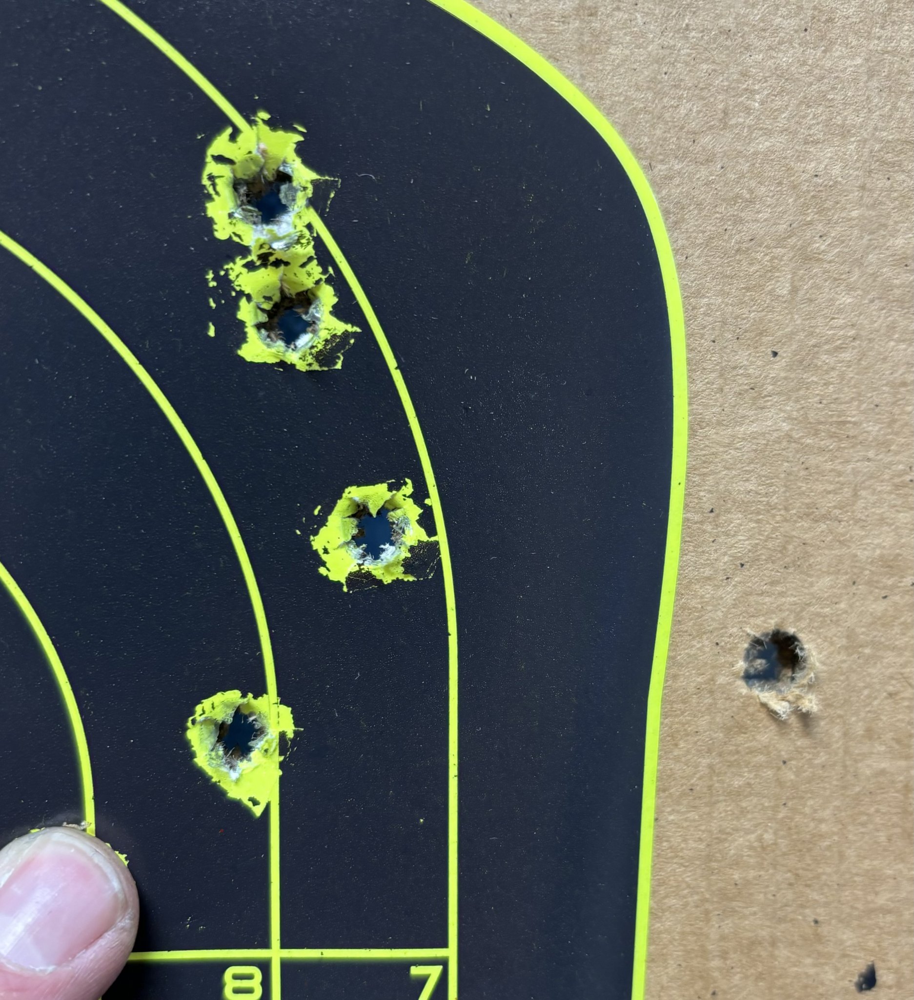

Update 4/23: put another 20rds through it. Got lockback on empty with a 20rd Hexmag. Threw my MG7K on there along with a Magpul SLS; way overgassed with the can obviously, but much more comfortable to shoot with the Magpul stock. Added the Bootleg BCG set to suppressed, and that tamed it even more. The final step (for now) will be the Kyntec buffer, which just came in. This group was 5rds of WWB M80. It measured a few hundredths shy of 3”, with avg velocity of 2684fps per my Xero. Much more reasonable.
Shot some more today with the Kyntec buffer and Diligent Defense Enticer S TI (the can in the Short is my MG7K). Definitely a high backpressure can, but quiet as hell on a bolt gun. S&B M80 averaged 2693fps and 4” at 100 for 5rds.

Also, 4 inch groups is quite poor accuracy. I cant imagine being satisfied with that even shooting bulk ball ammo. That is FAL type accuracy.
