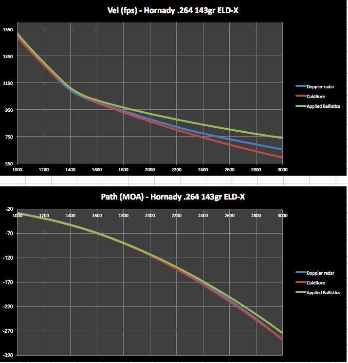

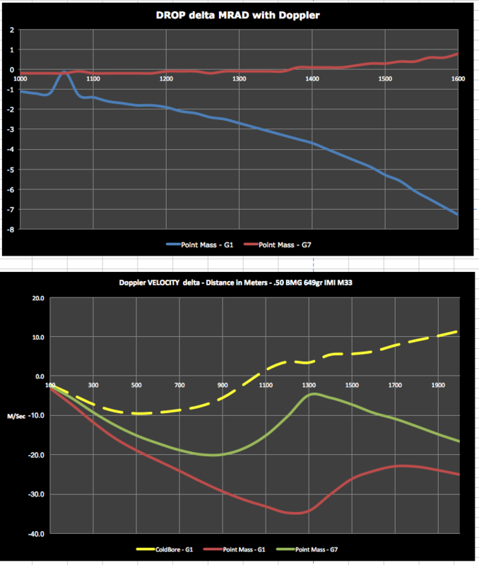

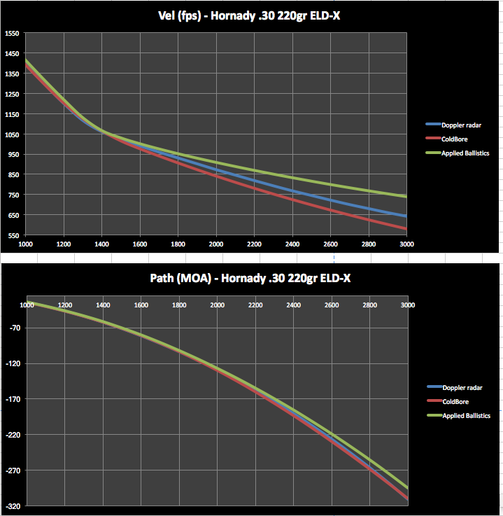

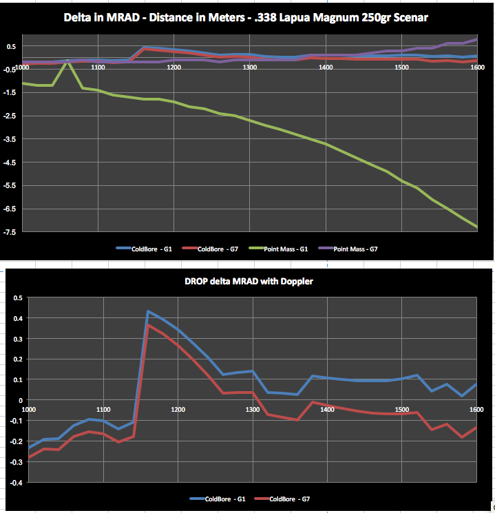

    Lots of discussion on what software is better, how they handle the differences between G1 & G7 models, and finally how it all compares to Doppler Radar.
    Having shot over Doppler and seeing how it operates, how far they can track a bullet, I thought this might help.
    ColdBore (previously Loadbase) has been around a very long time. Like Field Firing Solutions, these guys were early on the scene with a non-Point Mass approach. Now it's Point Mass to a certain degree, but it does deviate significantly in how they handle the predictions.

    Part of the early discussions revolved around ColdBore being very complex. More than 9x the amount of code is involved in getting a ColdBore Prediction vs the competition.
    Feel free to discuss,
    What's interesting to me is that the differences in results appear to be largely due to poor data on subsonic drag. At the speed of sound, the trajectories diverge dramatically. It's tough to tell without more information, but it looks to me like the curves would match up pretty well if perhaps we spent more time looking at drag at low velocities and tweaked the models, given how much time the bullets spend at low velocity in ELR.
    We spend a lot of time looking at supersonic drag curves, a little more time at transonic, but then tend to just ignore subsonic. If you look at a real bullet's drag function, you tend to find very good agreement with both G1 and G7 in the low to moderate supersonic region (which is why both work perfectly well for most shooters out to 1000 yards or so). Both fall apart pretty badly in the transonic region just above Mach 1.0, and G1 tends to be terrible at very high mach numbers. What tends to get neglected is that the subsonic drag predicted by G1 and G7 can be pretty far off of reality. Usually, that doesn't matter because sane people try to stay supersonic.
    Unfortunately, supersonic and subsonic aerodynamics are dramatically different. It makes me wonder what an optimal bullet would look like if you knew ahead of time that it would spend most of its fight at subsonic speed. At 3000m or whatever, subsonic performance can't be an afterthought.

    This may be an anomaly but with my program on a particular bullet using G1 single bc, my come ups match inside of 2/10 moa once tweeked over time to 1760 yds,and then moved out to longer ranges in the 2500 yd 2600 yd area and still matched up to the click so far. I need more shots fired for the longer distances though and am not ready to make a decision on the 3000 to 4000 area to say for sure.but I am amazed that on this particular set up a single bc seems to work well into subsonic.I know physically it should not but it seems to be so far. I used sierras with multiple BC derived from dod style doppler and they matched up within 1 moa right out of the gate which left very little tweeking needed to get it dead on out to 3000yds at 1100 feet ASL which put the initial transonic barrier around 2000 yds and it still held to the calculated trajectories. It seems one minute this bullet does this best with 1 BC and the next bullet does best with multiple BC but the G1 seems to match thorough out the trajectory most accurately to me. The G7 matches up perfectly to 1200 yds but then starts to deviate and at 2400 yds or so the calculations start to come back to the actual dopes and is difficult to make match up perfectly to the inch through out the whole trajectory with multiple or single BC.
    I like Ballistic AE a lot, great library, solid interface, I don't think there is an Android version which is the only downside to recommending it. (unless they added one and I missed it)
    The fact your G1 profiles works is two fold, one JBM does not punish you for using G1 like other 3DOF programs do, and two, you got lucky, it is what it is. That is a good thing.
    This comes back to the fact, or I should say the discussion earlier, that if all these programs are using basically the same Point Mass calculations, why do they not all act the same. Well because guys want to inject their own bias into the equation and force you to follow their lead. ( ex. You must use G7, to promote that argument they intentionally bias the G1 performance)

    The overall point here that really matters is software like CB or FFS are much more accurate right out of the box and will do that with either a single G1 or G7 number, provided those are well defined and behaved.
    That makes perfect sense to me Frank and seems to explain some of the differences between the different programs I have read about. I still have a lot to learn about the different programs but each thread is helping me to understand better so please forgive my ignorance on these matters. Unfortunately Ballistic said they were not planning to go to any other version for apps at the time I inquired . I will start testing again soon in the 3000yd + area and then reconfirming my come ups .if it is luck I am good with that too,god knows I have had my share of bad luck. lol
    Frank said it, you got lucky and don't overlook the fact that you have to tweak the data and use multiple BCs, which is what Diver160151 detailed before, basically what you did is to create two "different profiles". Indeed the use of multiple BCs is akin to the idea of a "custom drag", basically the same thing, since one comes out the other.

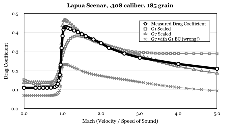

    "G7 Is better than G1" has been blown way out of proportion and context, especially in the moderate super sonic range. The divergences are in transonic and below (where they both fall apart), and above what we consider normal velocities, where it isn't that important to us. In the range of Mach 1.5 - Mach 2.5, they are both very good approximations for most bullets. This chart illustrates it pretty well - it shows G1, G7 and Doppler drag functions for a Lapua Scenar 175gr .308. In the supersonic range, under a sane muzzle velocity, there just isn't much to worry about. That covers a whole lot of shooting scenarios for a whole lot of people. Yes, the better overall fit is G7 (for this bullet), but it's not the major problem people have come to believe.
    I have been saying that for a very long time but everyone wants to argue that you HAVE to use G7
    yes with some software it's better because they purposely make it work better, but with most shooting, it's irrelevant which you use
    The part that escapes people is, these numbers are very velocity dependent, G1 more so, but both are velocity dependent
    Just human nature I guess. "G7 is likely a little better, the further you depart from short flat based hunting bullets" somehow becomes "OMGOUCANTHITANYTHINGWITHG1!!!" when you add Internet. Where I do have a gripe with G1's are with Sierra. They have some bullets that they report with banded G1's that vary so much that you can't really compare them to other manufacturers, which is to me the primary benefit of BC's. Exact DOPE I can get by shooting - I want to know which bullets to even try, and consistently measured BC's are a great comparison tool for consumers. When they're the only one reporting wildly varying G1's when a G7 would be fairly constant, that's just being difficult for no reason. Their 90 grain .224 Matchking, for example - it's impossible for a consumer to easily compare it to Berger's 90 VLD based on the info that Sierra provides - you have to run them through a ballistics calculator (and one that handles banded BC's, at that) to find out which is better. They makes some very good bullets, not sure why they're sticking to old methods when competitors like Hornady and Berger are stepping it up big time.
