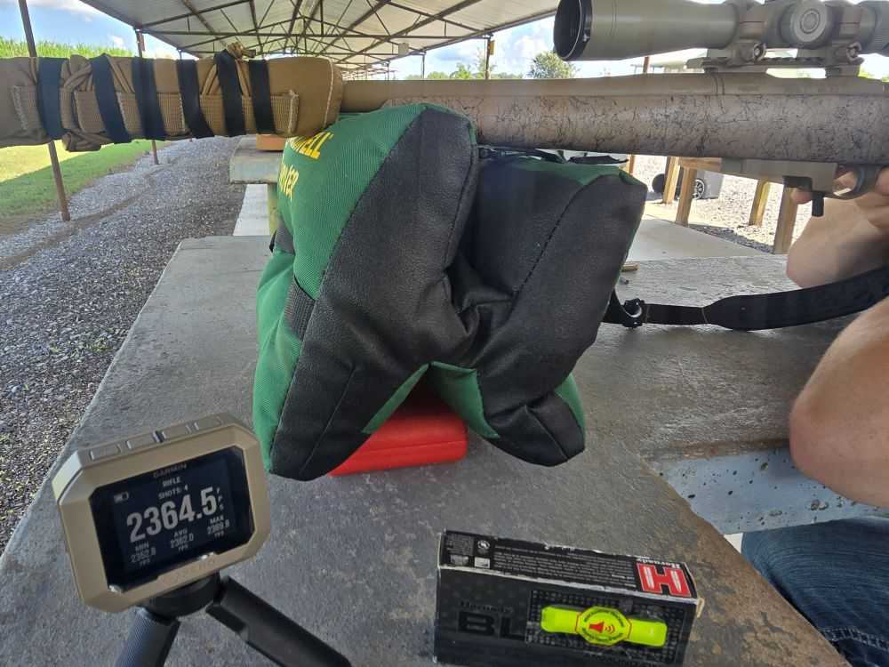

    When AAC announced the 300 Blackout, I was an early adopter - I immediately bought a 9" AR and 16" Model 7. When the twist rate sped up, I sold the 9" and bought a 12.5" AAC MPW and began the stupidly expensive process of SBR'ing and stripping down and re-imagining the Model 7. It now has a 12.5" Krieger barrel with a 1:7.5" twist, sits in a Bell & Carlson Youth Medalist, has mag fed bottom metal and a Jewell trigger with a Leupold VX-R 3-9x40 on top. It was not a straight line to that end result - but, I've ended up with a laser beam of a kids rifle, and my sons love it.
    The 12.5" MPW was my go-to pig killer for years. I used Barnes 110 gr Tac XT copper black tip to decent effect, but Clint Smith told me on the front end - hits like the kitchen sink up close, has a rainbow trajectory and is lacking at the pot of gold end. Once I transitioned to the 6.5 Grendel, I never seriously picked up the 300 Blackout again.

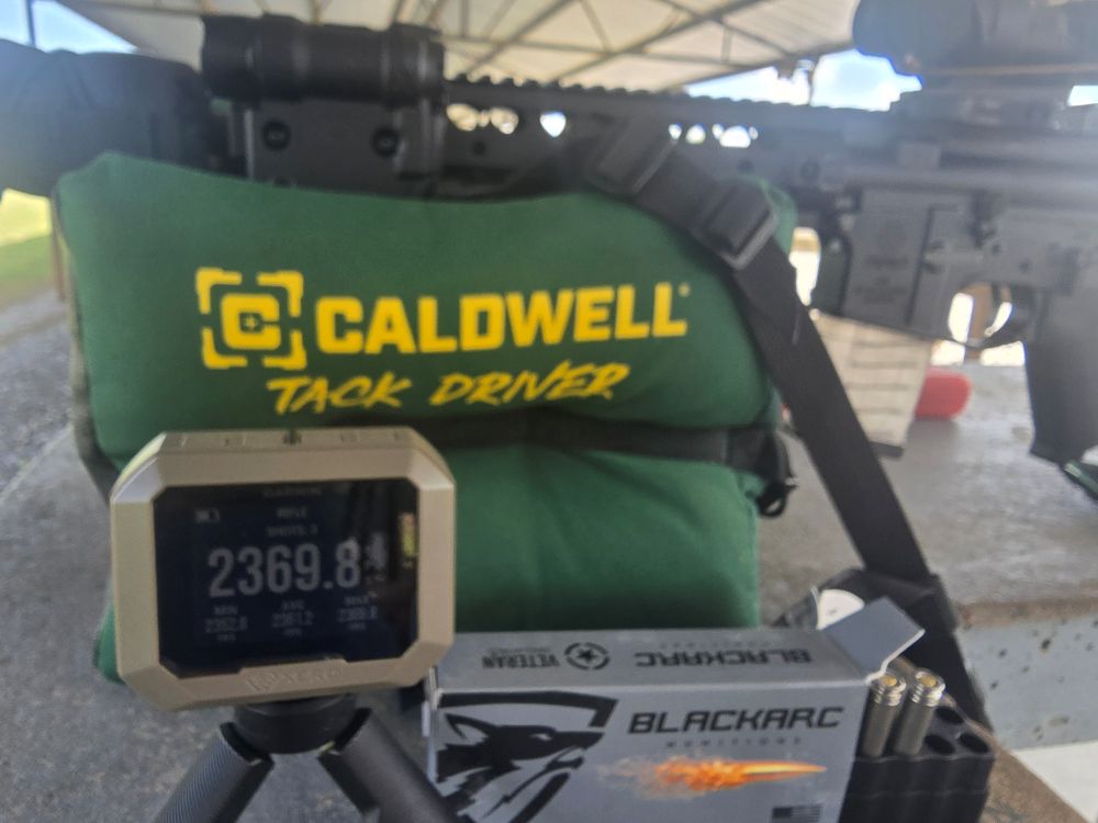

    And den... recently I heard someone speaking of newer, hotter 300 BO ammo, specifically the Blackarc Munitions 110 Gr Tac XT. It was said to make 2300 out of a 10.x" barrel, which got my attention as that led me to think it would likely be 100-150 fps faster than my previous ammo, and I'm thrilled to say I was correct. Some research led me to also pick up the Hornady 110 gr V-Max. Today, I got them out to the range and I feel like my 300's have a new lease on life.
    Barrels are weird. My AAC has a 12.5", my Model 7 has a 12.5" - The AAC shot the Blackarc as fast as 2,370 FPS, but the Hornady wouldn't crack 2,340. The Model 7 wouldn't get past 2,320 with the Blackarc, but got as hot as 2,380 with the Hornady.
    Lil Wayne told us it would all work out, and it did, because the Blackarc shot exceptionally well out of the MPW and the Hornady was a laser beam out of the Model 7. Using an ACOG with 4x and no eye box isn't exactly a precision circumstance - but - the attached photos were both shot at 100 yards, and it makes me think it would be a sub MOA situation with a 20X scope as opposed to an ACOG where I was just trying to hold steady on an geometric shape and keep the cross evenly distributed. The Model 7, with the benefit of a Krieger and 9X magnification was same holing at 100.
    TLDR - Blackarc and Hornady are making 300 Blackout 110 gr ammo that are knocking on 2,400 fps out of 12.5" barrels and shooting very straight in the process. I am going to leave the Grendel at the house next we chase pigs in the brush, and look forward to my youngest getting a white tail with the Model 7 this fall. This ammo is appreciably faster than what I've tried before by 100-150 FPS.

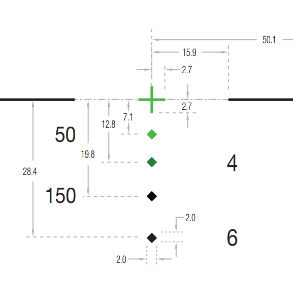

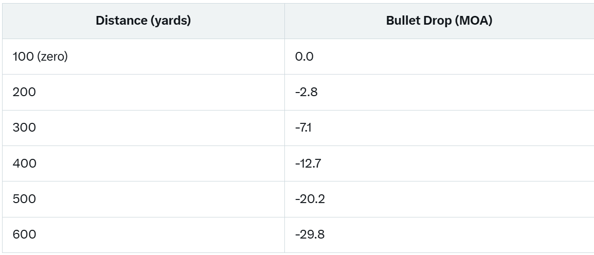

    In other wonderfully serendipitous news, the velocity Blackarc delivers means it is as good as real world gets when it comes to matching up with a 300 BO ACOG. I shot the MPW back to 400 yards today - velocity is about 1,370 fps at 400 yards, expansion threshold is 1,350 - elevation was dead on at 200, 300, and 400 and group sizes range from excellent to sufficient.

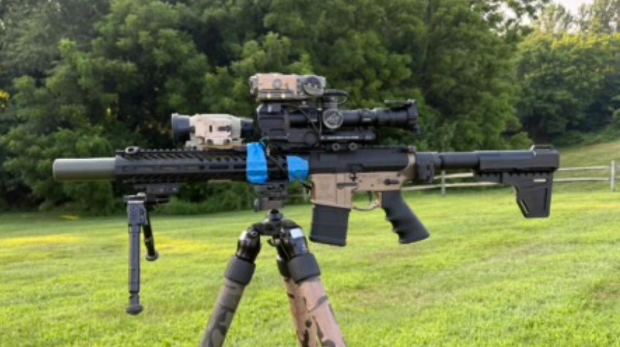

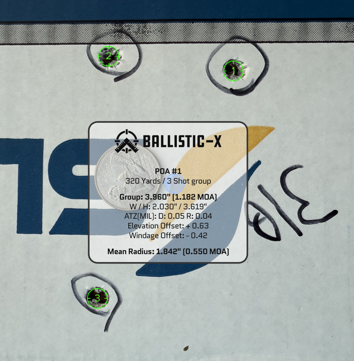

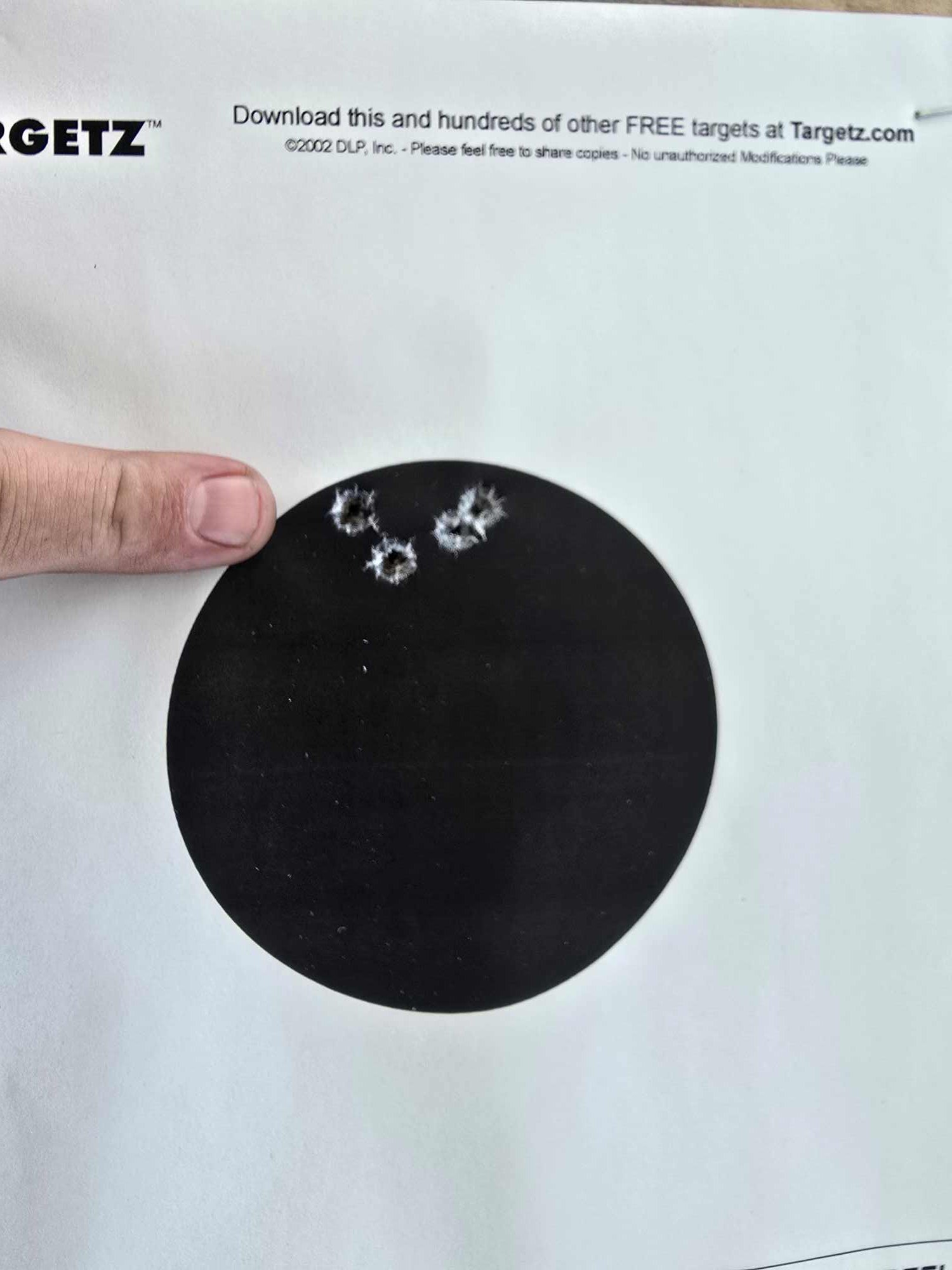

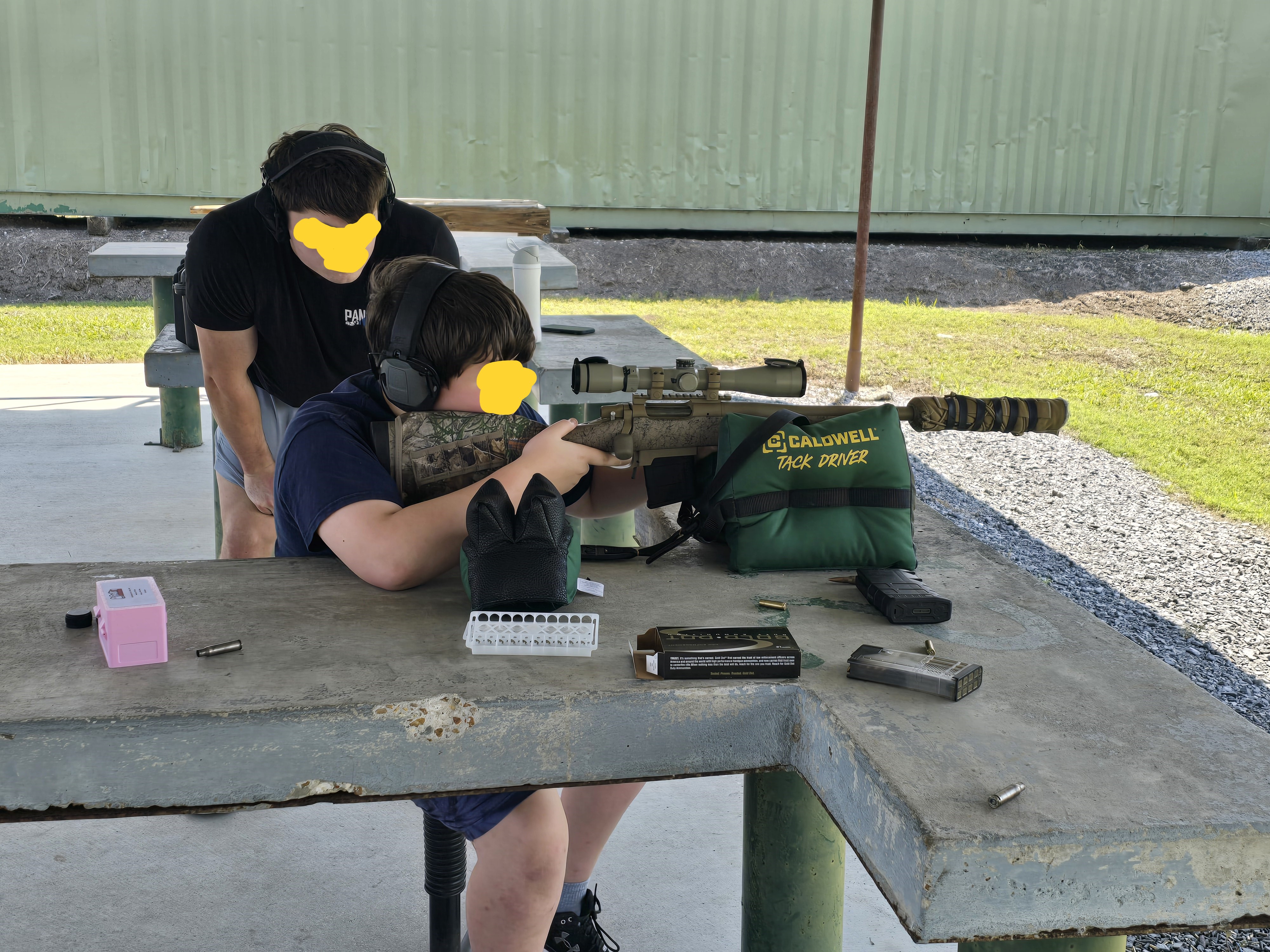

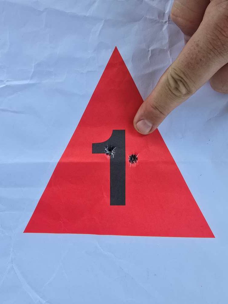

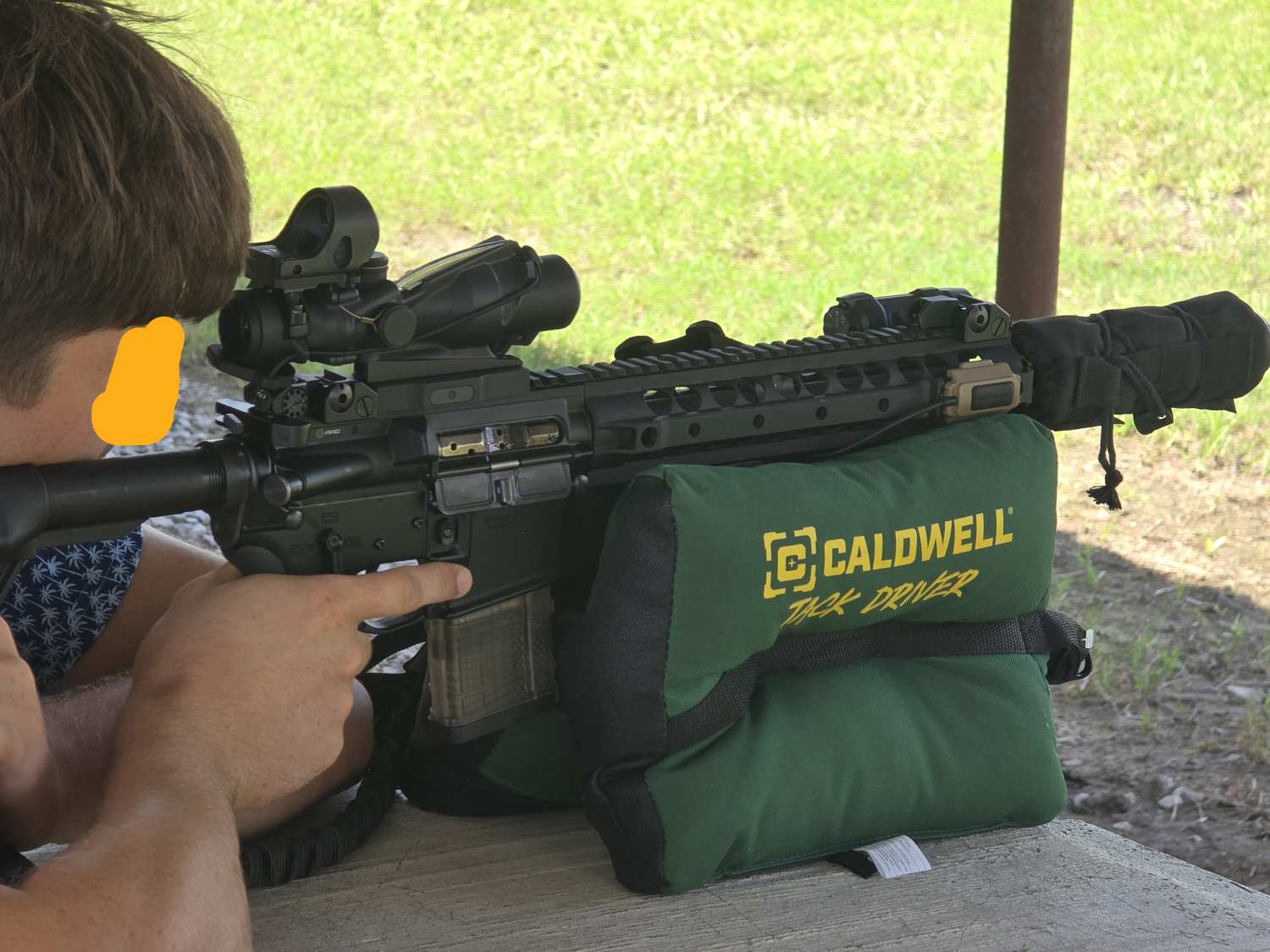

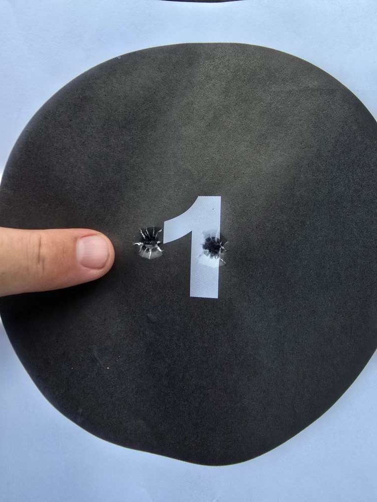

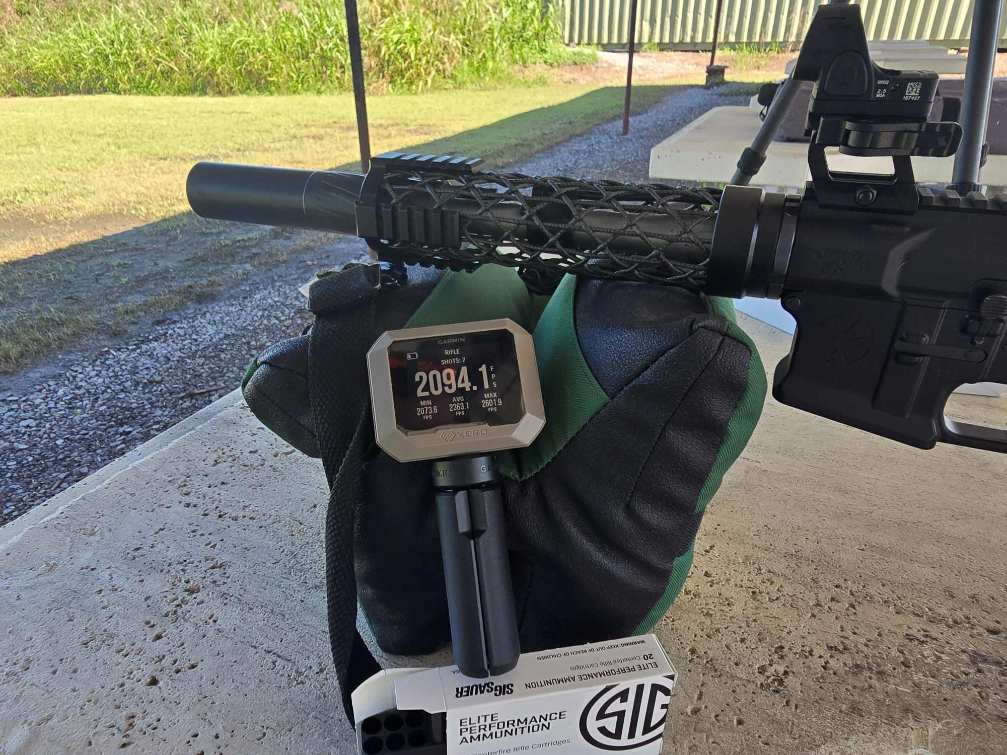

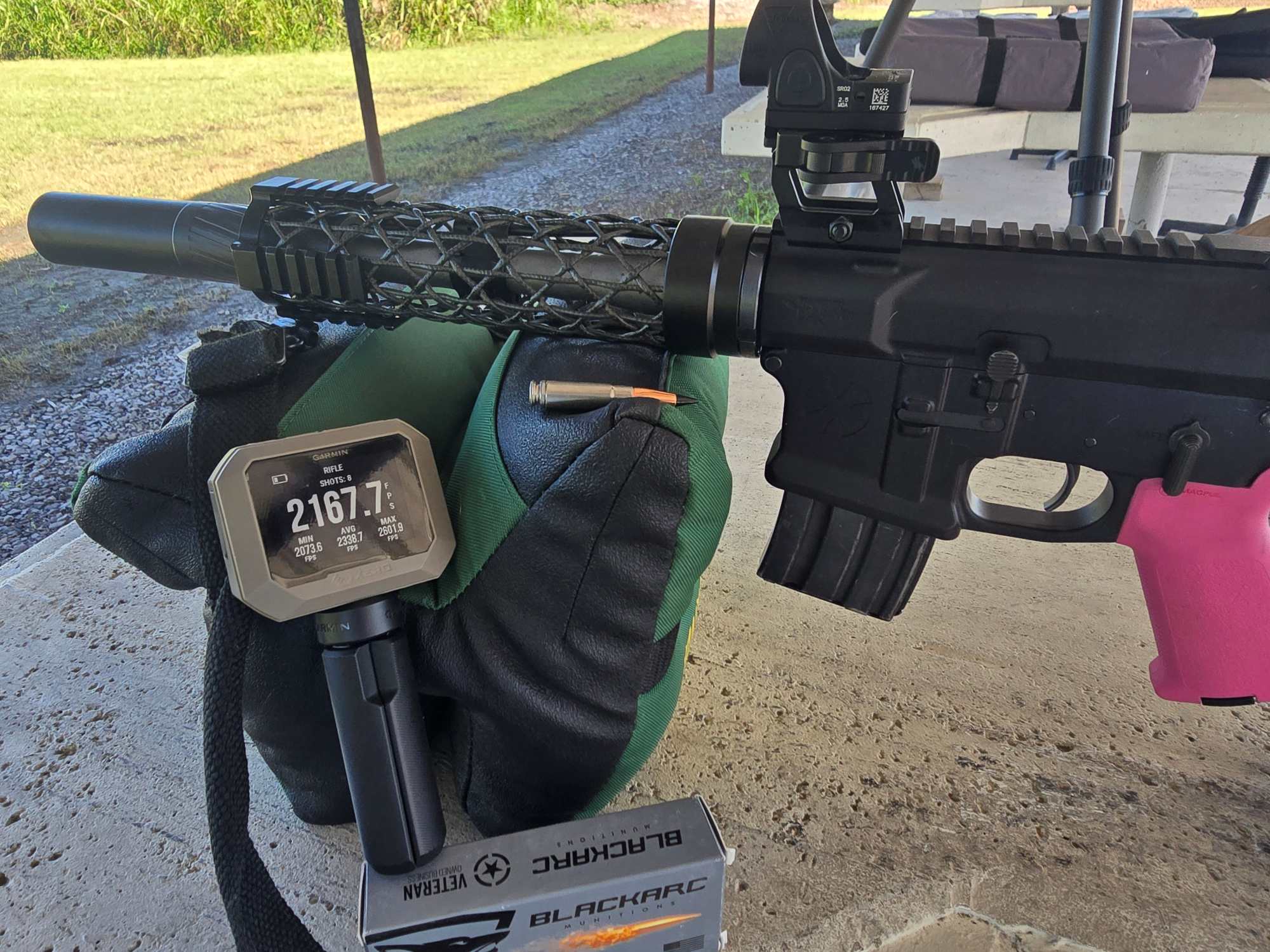

    I was so happy with my results earlier this week, I went back to do a little more shooting.
    The Blackarc Munitions 110 Gr Barnes black tip makes about 2,170 FPS out of an 8" Craddock Precision stainless barrel. The same gun pushes a SIG 120 gr copper round that is a specific short barrel load, so this is picking up about 75 FPS. I've found the SIG load to be mediocre in accuracy, but good terminal performance on pigs. As a practical matter, the 8" is a 100 yard gun at the most as set up anyway. With that said, I have some of the Phantom 85 gr headed this way to see how fast the 8" pushes that - but I think the 12.5" and Blackarc are destined to go kill a bunch of pigs.
    The AAC / ACOG + SRO / Blackarc continues to to make me very, very happy regarding accuracy and reticle calibration. The large circle with the "2" is with the SRO, the "4" is with the ACOG, both at 100 off a tripod - then I went to 300 as the other day I hit 200 and 400 with great results - also dead on at 300 as the drops would indicate. At that distance, the diamond is about covering the torso, but it makes clear the reason the ACOG revolutionized combat effectiveness.

    I got some of the Phantom Defense 85gr (Maker bullet) loads and made it to the range today. I also revisited the Phantom Defense and BlackArc 110gr Barnes Blacktip loads.
    9” Barrel
    85gr Phantom Defense- 2399fps
    110gr Phantom Defense- 2245fps
    110gr Barnes factory- 2105fps (from previous range session)
    16” Barrel
    85gr Phantom Defense- 2738fps
    110gr Phantom Defense- 2506fps
    110gr BlackArc- 2432fps
    110gr Barnes factory- 2379fps (from previous range session)
    I didn’t shoot the 9” for groups, just had a red dot on it. The 16” gun has a Trijicon Credo 1-10x, Magpul bipod, and is handicapped with me as the trigger puller!
    The 16” Wilson barrel liked the 110gr Barnes bullets best. Five shot groups at 100yds were 1.1” to 1.25” with both Phantom Defense and BlackArc. The 85gr Maker bullet load did 1.55”-1.85”.
    I’ll likely stick with the tried and proven 110 blacktip for my deer and pig hunting. I have killed several pigs and lots of deer with it, and my rifle likes the bullet. But the 85gr Maker bullet should be a real winner also for both hunting and defense use.

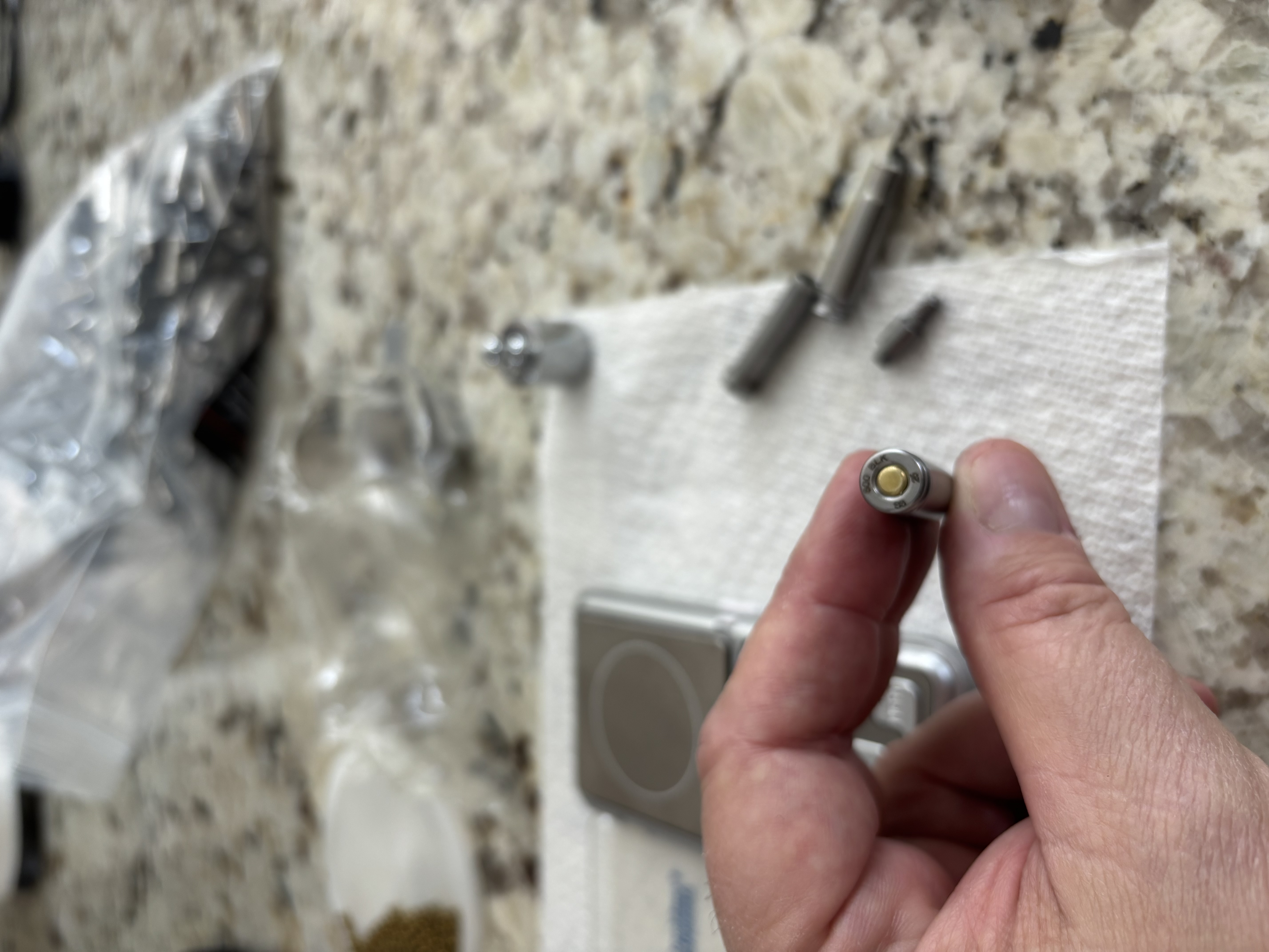

    Have you pulled bullets from any of the cartridges with the 85gr projectiles by any chance? Would be interesting to see what type and how much (weight in grains) powder they use.
    I’ve not pulled any. I’m strictly a factory ammo guy so I don’t have a scale and wouldn’t know what I was looking at as far as types of powder.

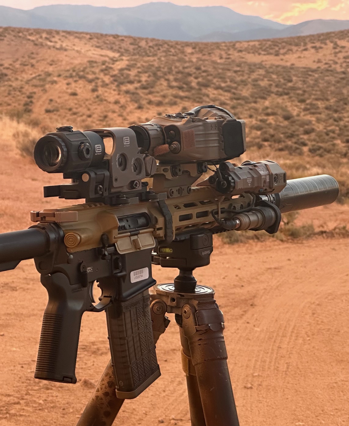

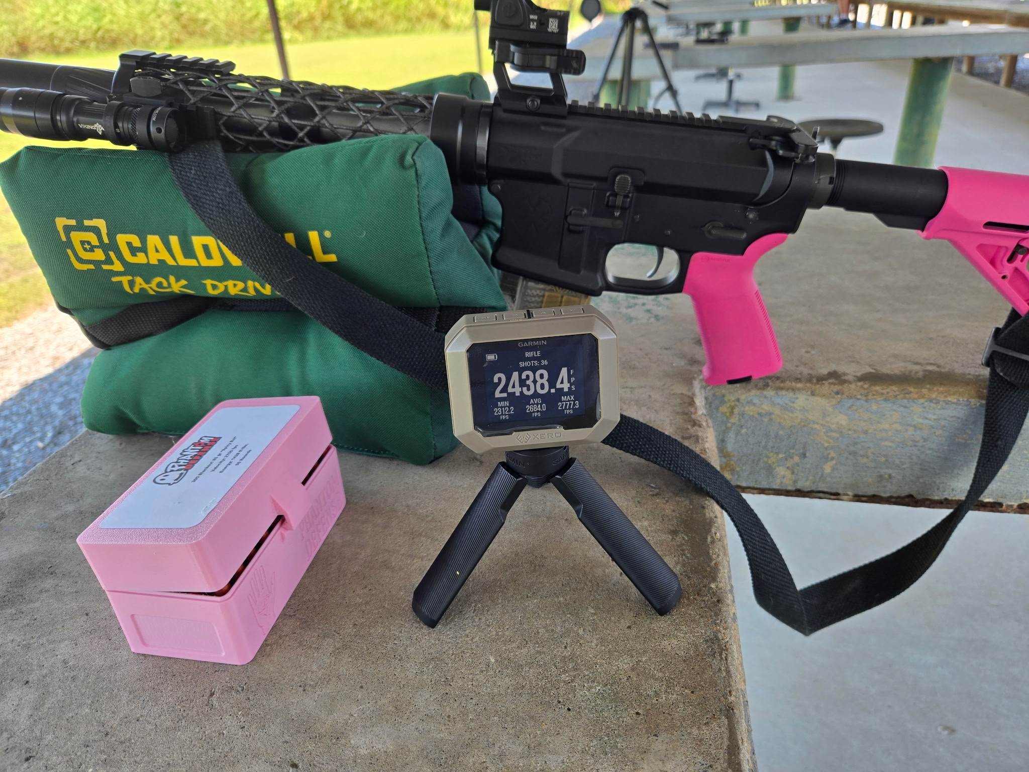

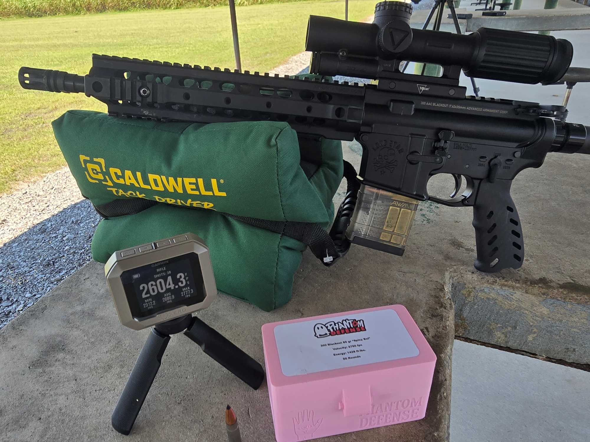

    The hits keep coming - the Phantom Defense "Spicy Boi" delivers the goods. 2,438 out of an 8" bbl, 2,600+ out of 12.5" bbls.
    I plan to put both the Blackarc 110 Gr Barnes and the Phantom 85 to work on pigs in a couple weeks. Accuracy from both were impressive.
    The ol' AAC 12.5" upper continue to impress in general - the Krieger bbl'd Model 7 is and should be the most accurate 300 we have, or have shot - but - sooner than later I'm going to test the AAC's with a 20X scope, I think they are MOA guns.

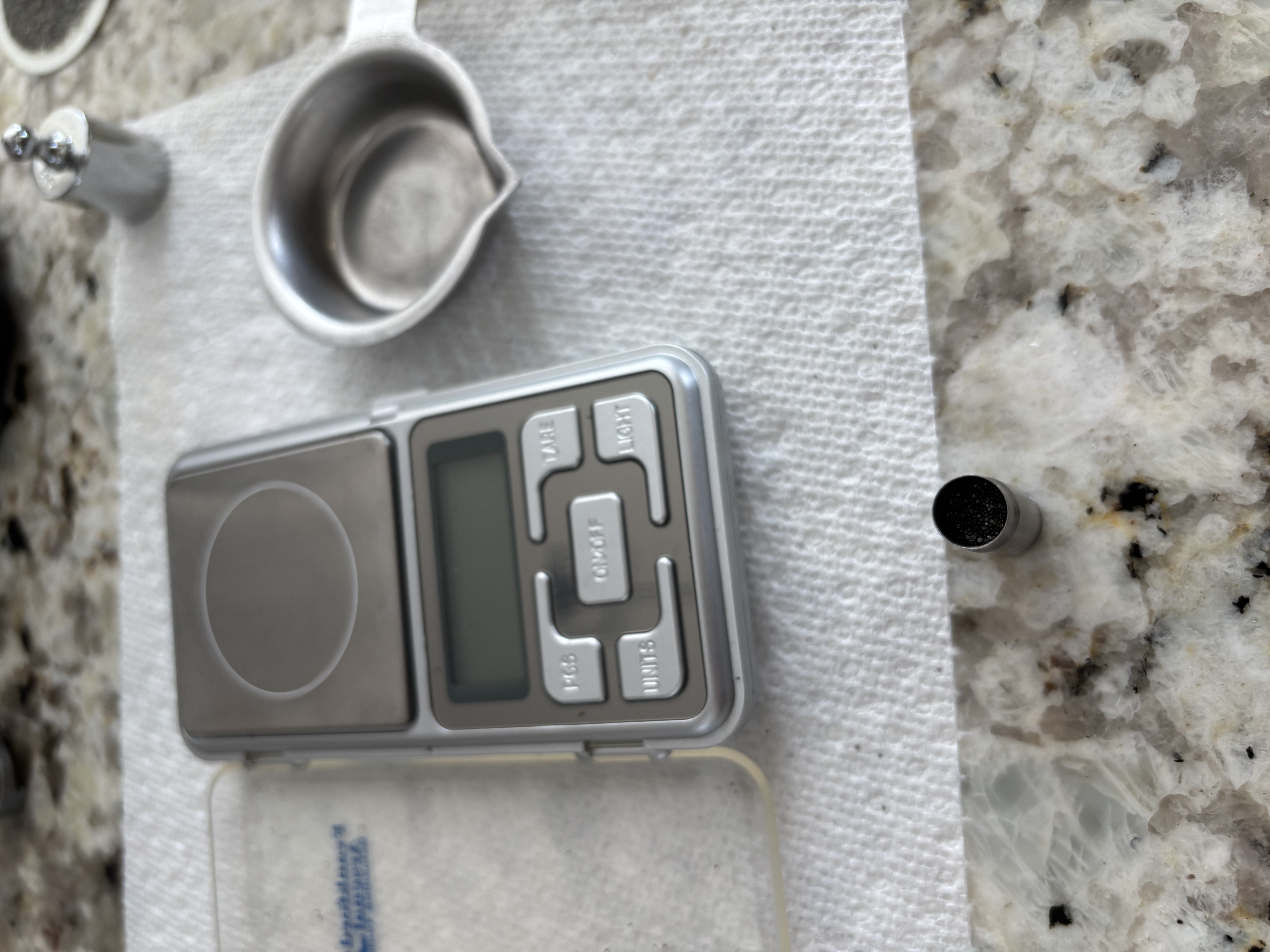

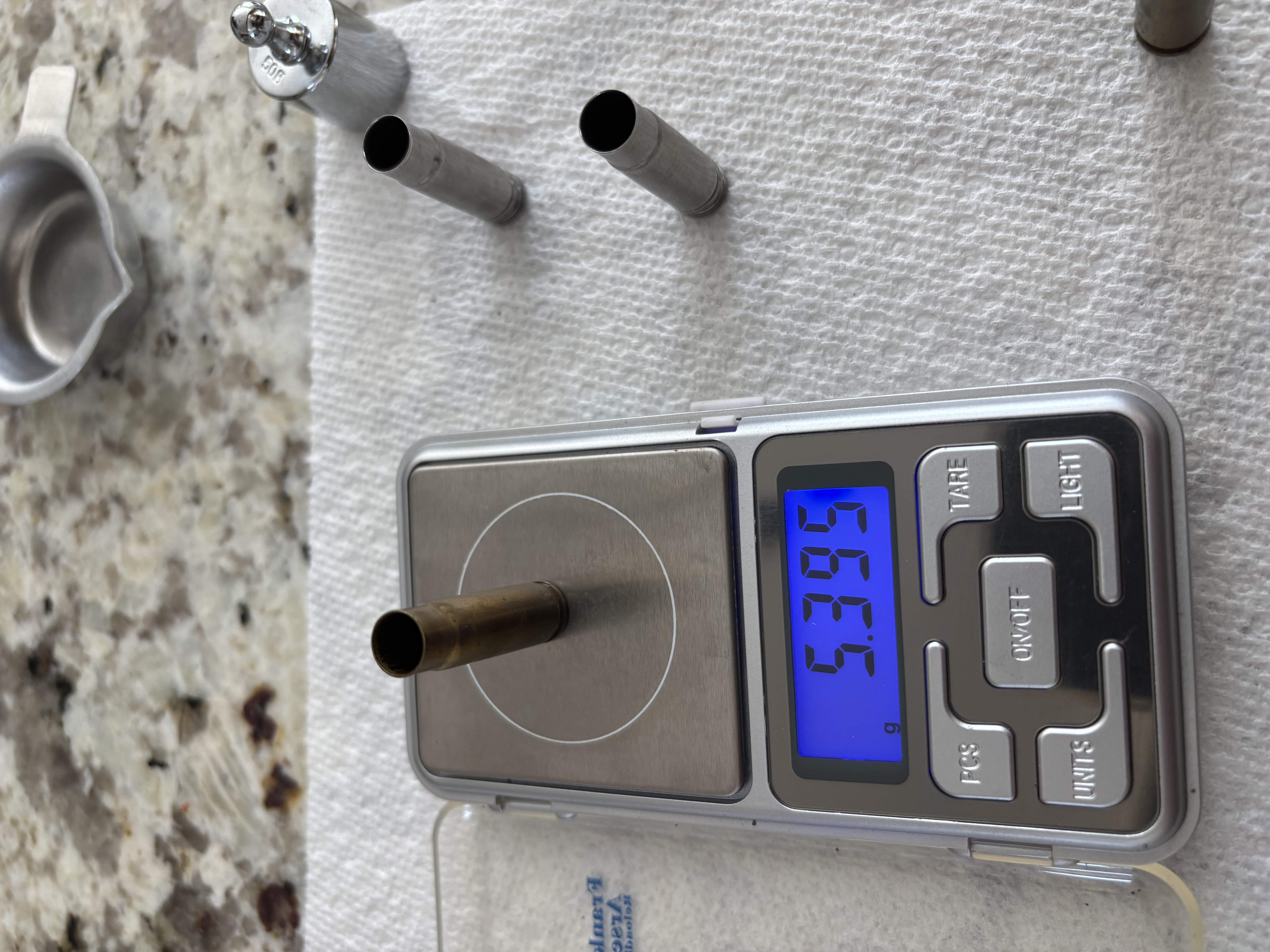

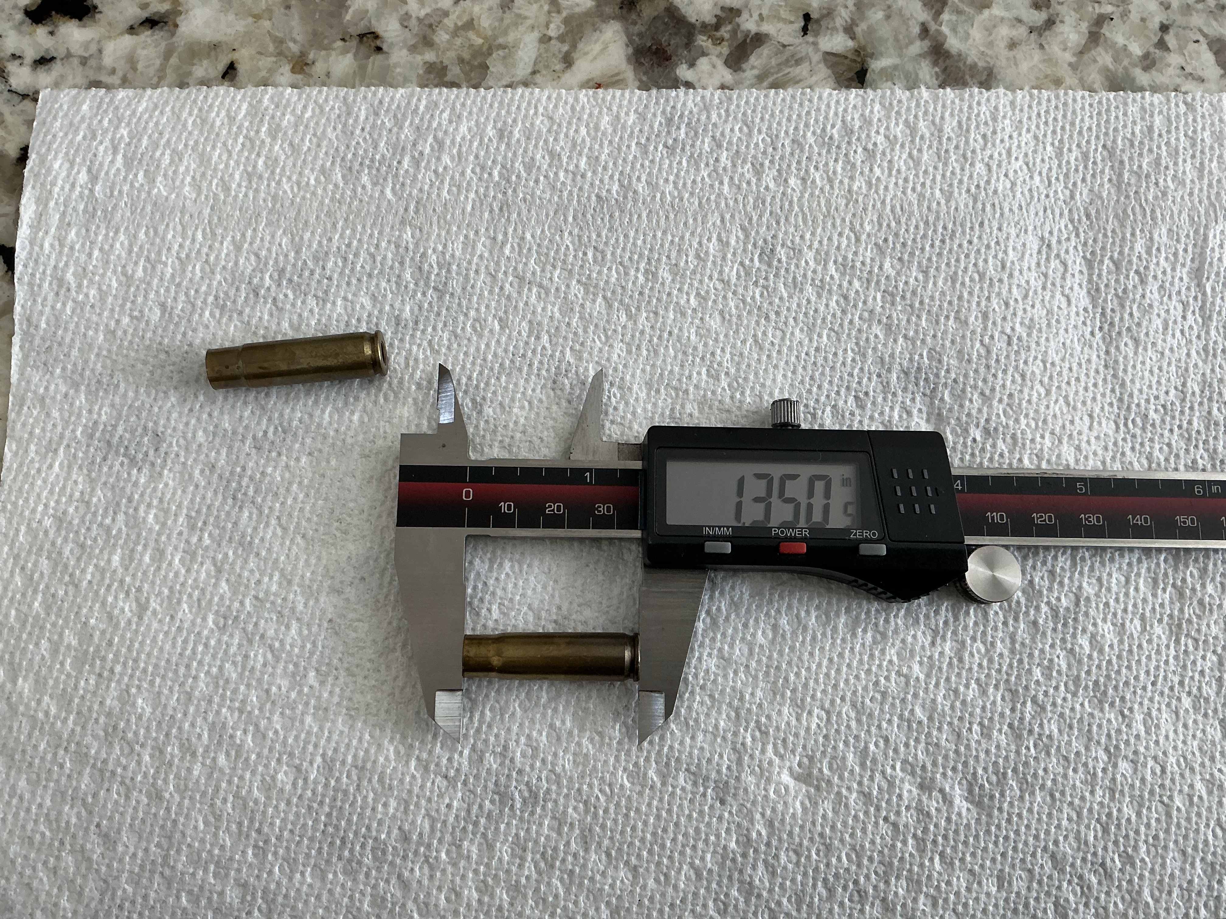

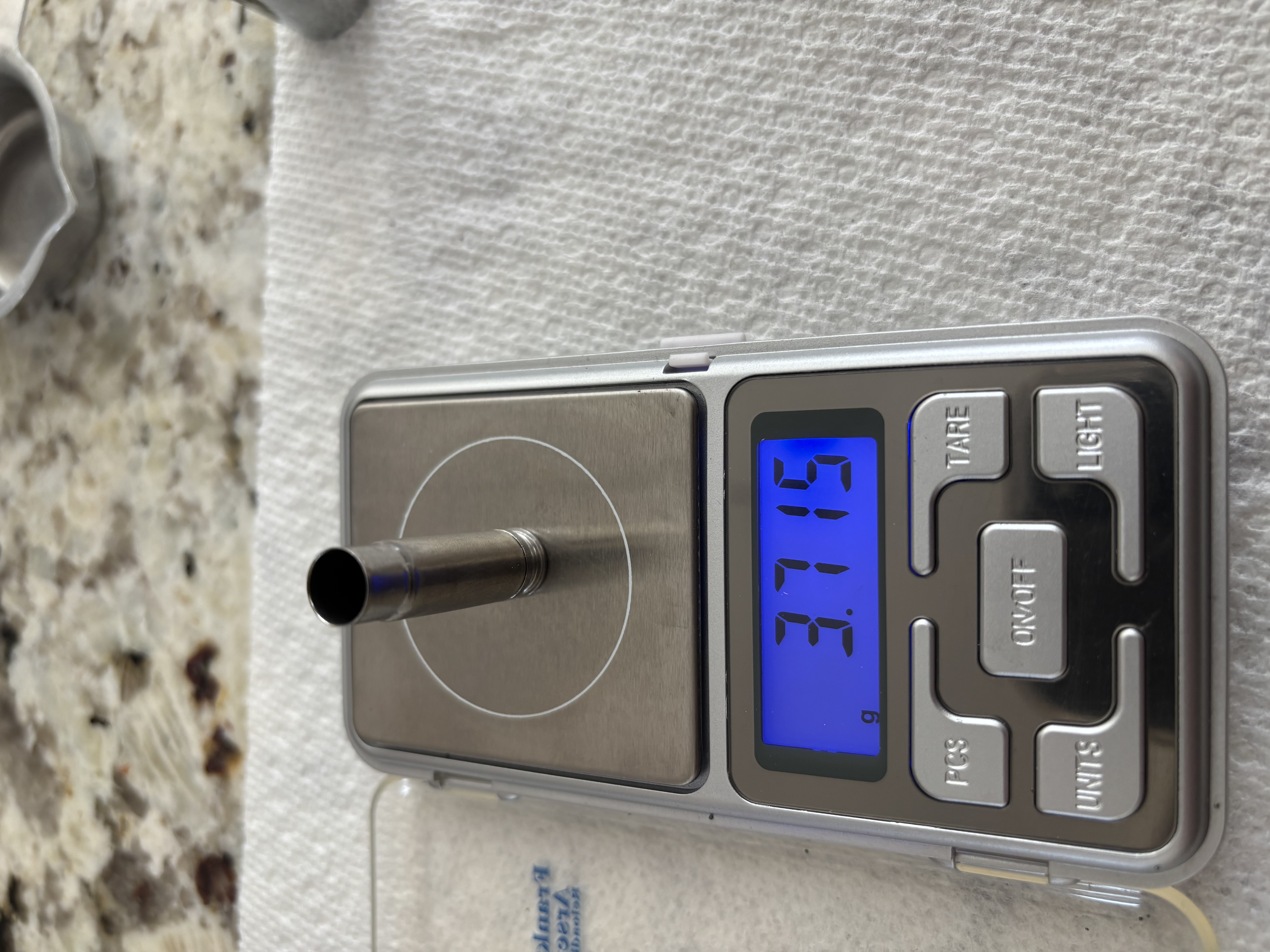

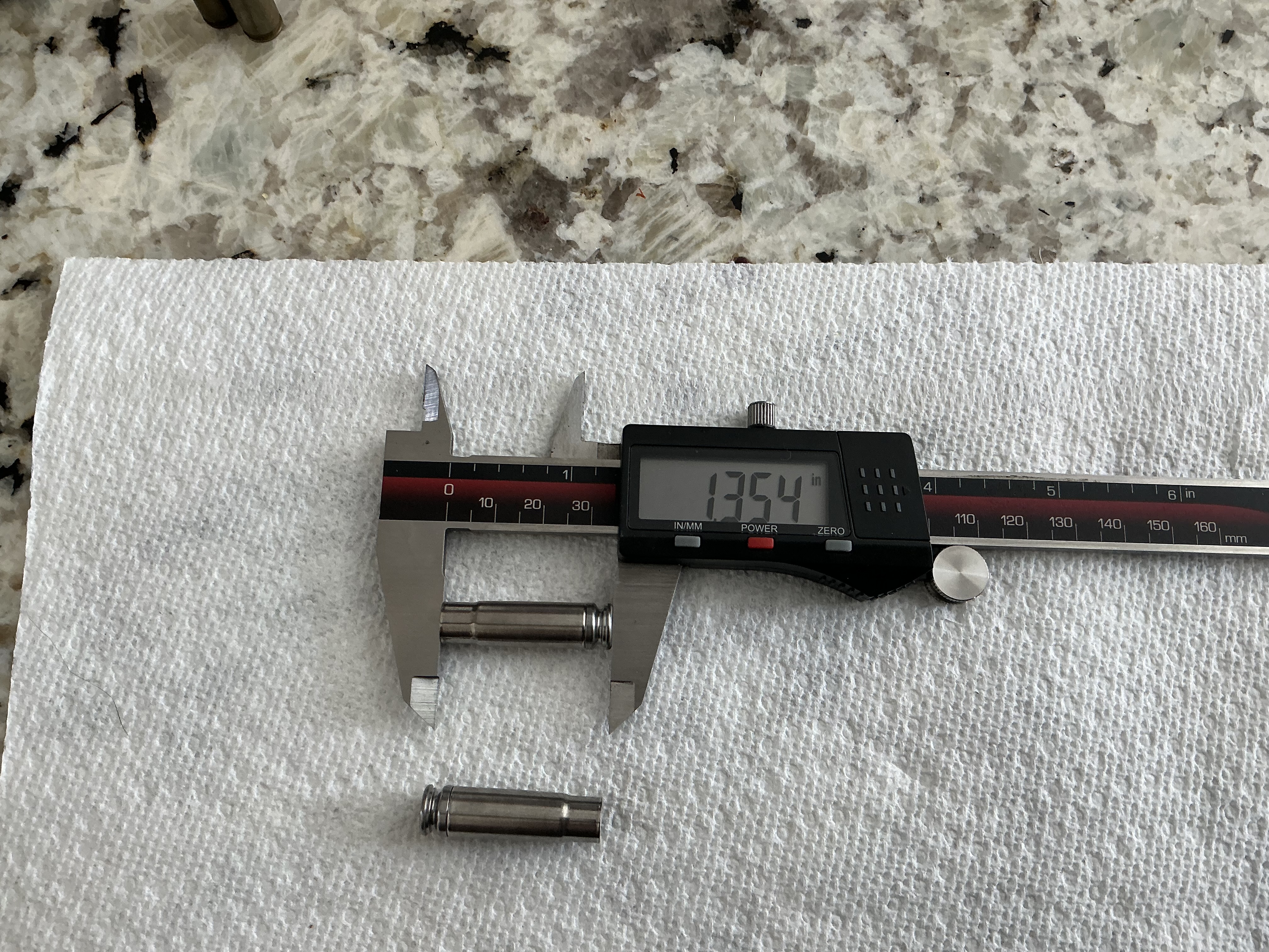

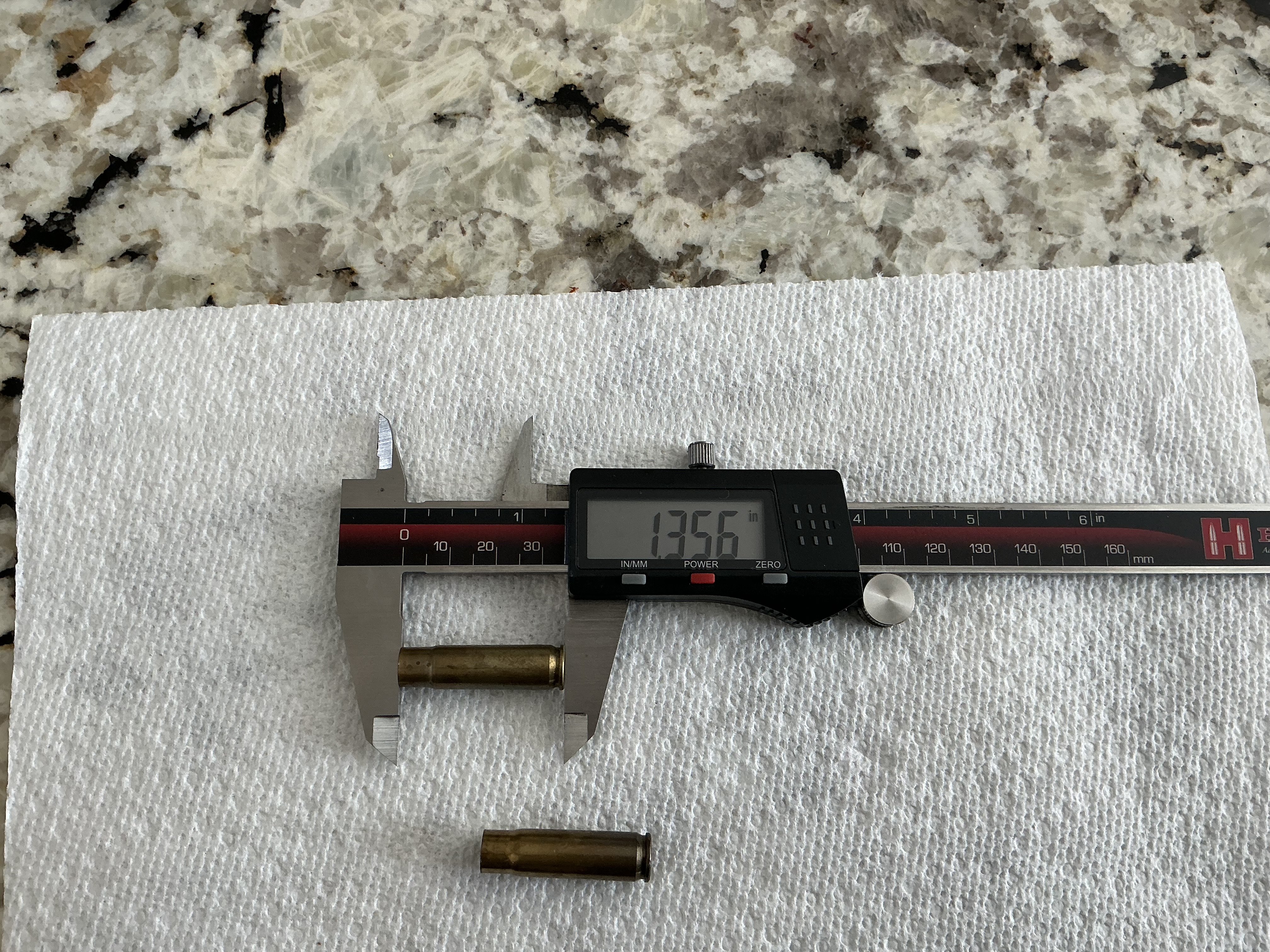

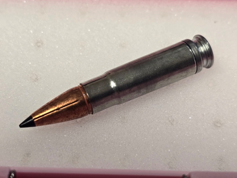

    Haven't had time to actually loaded any cases up yet, but got some measurements in today between dr appts. And apologies in advance for the pics showing as attachments…haven’t had time to upload them and then hot-link them yet, so if the pic’s over 5MB or so, the board automatically puts them in as attachments, instead of the pic.
    Regardless, the cases are very consistent on length and weight; only a couple pics here but weighed and measured at least a dozen, and they were all within 0.01 gram, and 0.01 inches in length of each other.
    Honestly thought my calipers were broken for a sec when the number was the same 3 or 4 times in a row!
    …and a couple of my 300BLK cases out of the bin that’s been cleaned, but not trimmed, so as expected we see some variation:
    So if nothing else, the QC at Shell Shock seems to be on point! And shaving ~1.5 grams or maybe slightly more off the cartridge weight is small, but that represents a weight reduction of >25%…not insignificant, and that difference adds up with larger load outs of course.

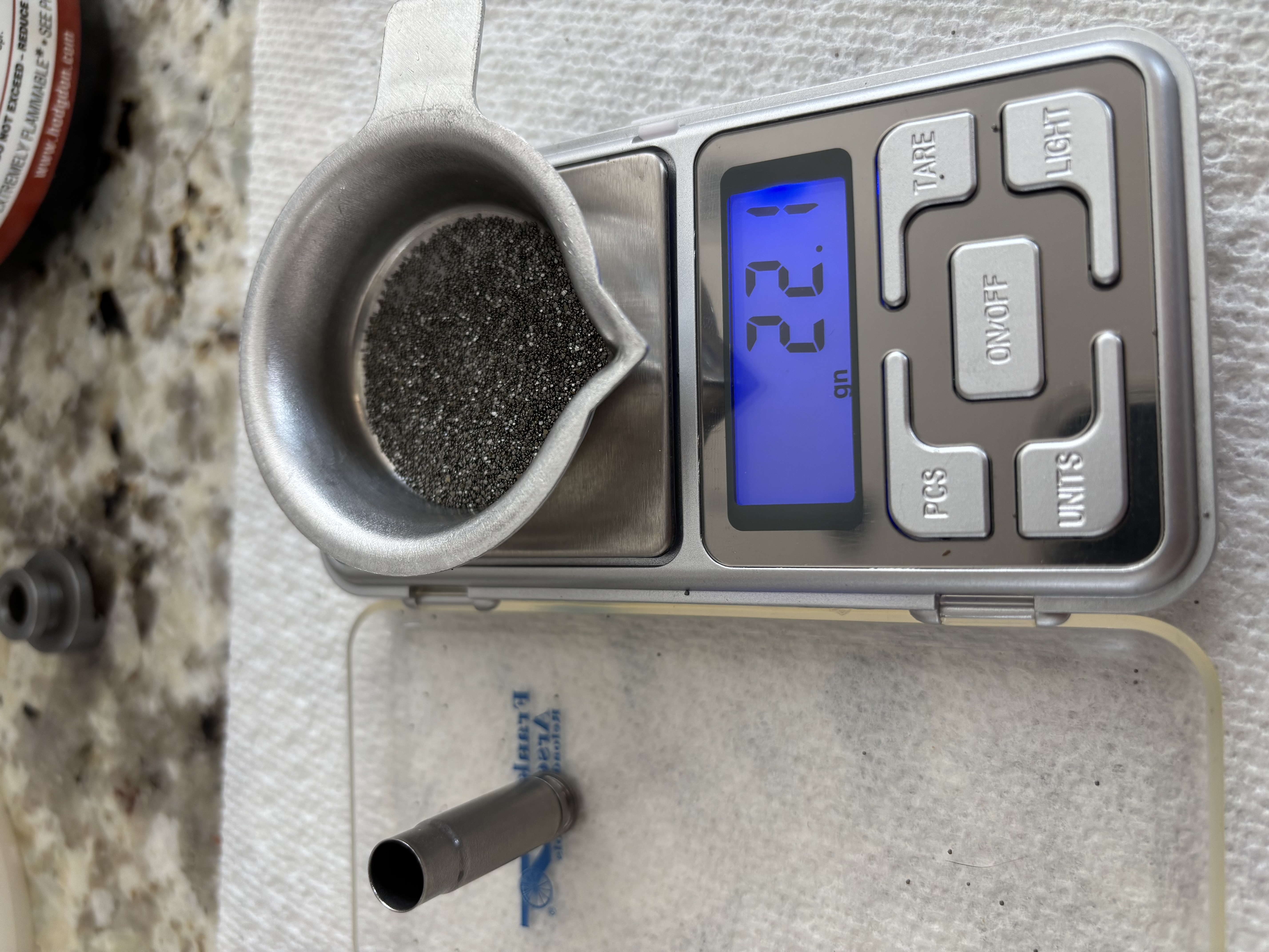

    I also dumped in a sample of my max load of 21 grains H110…it’s the powder I use the most for my 300 BLK loads by far, especially my supersonic loads. Hard to see in this crappy cell phone pic, but it’s up to the bottom of the shoulder in the case:
    It’s normally just under to top of the shoulder in my brass cases, and that has the powder very slightly compressed with those flat-base 110s that I normally load (both Hornady VMax and the Barnes black tips) loaded to 2.125” or so…usually just seat the bullet right in the middle of the cannelure on those Barnes bullets….and these no-name knockoffs I snagged from Midway a couple years ago:
    Note: I can’t load quite to 21grains using the Barnes 110s or 120s…they’re slightly longer than those Hornady VMax bullets, on the far left in this picture:
    However, taking the powder up to the middle of the shoulder in these SS cases allowed me to add just over a grain of additional powder! Holy cow…
    Even if I keep it just under 22gr, I should see a nice bump in velocity with a ~5% increase in the powder charge. Will have to ladder the load and look for bulging primers, split cases, etc. of course, but at least I now understand how they’re getting those increased velocities.
    This is gonna be interesting!
    Also, if anyone has any of that Blackarc ammo and is willing to pull one to measure the powder charge, I will grant you one internet point, and my eternal gratitude! LoL
    Would really be interested in how much, and what type powder they use in those 85gr “spicy Boi” rounds.

    Blackarc continues to impress. I should have grabbed the non thermal target as well, but I stacked 2 rounds at 100 through a 3.5X ACOG to verify before zero'ing a clip on - This is through thermal at 100, 2 shots, remove, replace, 2 shots. In less than a week, pigs will die....
    Reactions: Bakwa and 91Eunozs

    I have been loading 300blk with Nas3 casings and have gained 100-125fps across.the board on my loads. Right now only in bolt action and Henry Supreme. I need to alter the buffer set up on my semi before using them in it.
    That what I find also. I settled on the handloads @ 2520 fps Vel. using .30 110's on the boltaction, using the NAS3 casing .
