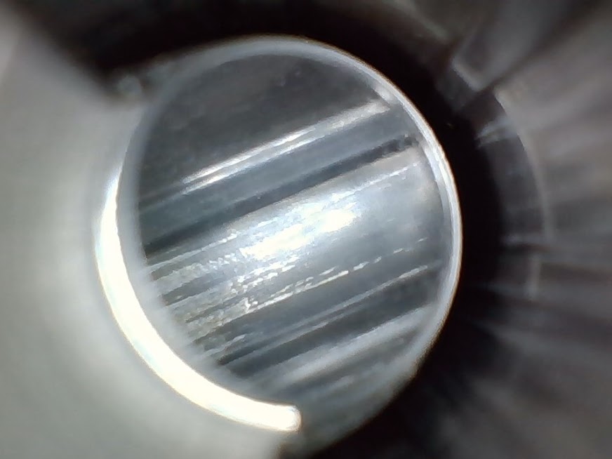

The leade, reamer cut marks visible

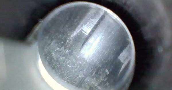

Deposits of some sort left in the barrel from the factory
ACtC-3eHXU8oEimjTjHGceX_Q-Z6yB9yp_bN1AN5UakVKxdGizQTu1IV1I6wuQZ2yo5COMn3S6GDBnNnBdW6WBh-XQMI_n2DOTZGxB70XDaJ68dLf1cWnzU1prbEdbpZ_ihnMxiAZi1uPS8imK1igYChH5Wu=w872-h654-no

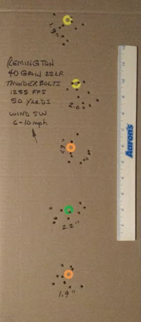

CZ 455 Varmint, Mueller 8-32X44 Target retical, heavy bags, new factory barrel, 50 yards
SK Polar Biathlon from a tested brick, first 50 shots
E7xyxl3p59MWnI0KOwUVAX2HQlnspRVd4mXXQsoy5xKby83gLOAuTz-E4jbu1DUXjl9sXRfowziEnNaNdGmy_wzdWuklHxcZDiX8nxNfVAcMP7cy-hfqSHEylZShZCzaFVXKyYW6UELj7xmgu7FzH1Jx7Ru6g9MnBbxJhtstD7PKUmxMhLlxwQ-Vwciw96kVSVT50zb_-Zrm5cI8tfKJHnW5O0N-V5esNX2ofA1JNrEx3tqC9oOMC2qD2h_tL30m4JS49QUC5l3PdtDXZLfUBLRFgm58HUG0grDFWZJtR6827h5yJs-ZRZBOgVwIx6y2WizuU9Hg4bXUAKqOi5bNQK28bHhXjPguAEgFKnQyPe_ZoWaA71gz25bdSNyli2xOCU7MJaj-zLjh8Z_UQtIZM-DLbCwO4PsfWw8qb34gidsVBy9tcITY1eX6crsWBSXv40kjfkSiUniSGPAaFUBVxjEqyEz5UE6Rt3VxpSpaKdP_DpEcVZHgGPEgFIm2eZSlpMnEhbkqn60px2mS8U114rHfMhqOABHH0mFe0xcRfRvHkEBDk0lCWRdN5KBhYzr8O4xzz_di3pawaMT3sGMKBmTM0gkI-7PihlkR7HHrFNIp-cayu7HU7EA-Ojz1RCvfau0fBEaHwIBeQE1JB4XgE22qVq9Ig8zzaOq888m2cTX78UCo8yo374iUHtez=w377-h654-no
iGcLvVfFqDSWF2ZUMIhbzRYImrGxz4OtYWUpVuOE43KiHvLW3LFv--tYk6ubpukJQiH7T5qjwtHKsVRr3qsmtPOSiyUDDMRrms5uvaYGvgBYAqt7CRnmSSzyVK3wSU3DwYmUw9S9gBVYR1L8Q9jKJUqoyhem4DYLdibDvzikCC_TdxfkVOQQx0vbzIs7diN8u0CS-IMcnzn3w7qbStuwFW8Rig6LtdIBb4rg-skt07FZgGUcf6D7RPSBdsALJMSVcmQG6jIXaW0sbohe5woBzMXdmTMk5K8gFZ-LngFU7vIq8NCUFeFHoIQgQE3WxjdbImHfLO2XP-iqeYSXfahELRx4B6wmxge4-CuW3j2dm4FYW3qW1phAHLc8Ty7C4r0EjG3PMAN4wmNJKWRZ0cqOKl6Glf_Gly8Vf-Vf9-Cm07tmjPUz6Pl8Nc7lslSzd3F9cioZNMu0hpmnOwtXwmZnOJYfg8e_dpcL_ckVXRioLS_4v2Zm__9soqPmSEIdnlpNB9-vmznQRA81V4T-Jc9NedePpIJ4Ve-p4S8orO4T9_dNLykDHg10816HB0RrIG46vegCB_BpnhgeS0Wqehgz8G2XAiwguZ5NiV9Su9LYzurEsRYqI2ghJ2PFjDat9lZrktMj-Gv0wSwWzMF4nUA4rbCmxJ2PiIJ5INLtf3ZWTez_rEdCR-hmpotCYtb0=w958-h559-no
ten 5 shot groups
EHev5AnfXpp1jjUW-QOye7EfzARfPm3cIbzab98629IOSFDkTX-2ExGf4LpB0sCfcKsAlmKqX0iPbCdUmtCzjbKfwryJuiX0fP8XoFzXSdKKct786tINQLcLtOZYVriso4tVlfns5_rnt77835T184bLONN_kfQTM3yJtjyX1Gm4r9FJHv_FOjaJfbvlp0U9E19mxvVX411-vuYYa3_FFLwOKiOs8ujfrhRx6OkfzSTOClFkHaq8LA0gK5Ij-C5yjGefikWWWoxIJSggIgxjz6fbo8dUGvIj529cyYw7HtZyIAKFto_Nmwnz2GLpgj_4T140IYjeK8Pkh7-9B2D-CiQe_9WUYy042i_L8EVyJjjw1QY3razdmMp_K14urkexoIeqLvIq1iQM6_c82fYGlQd6YFBPPt2g3xMD9S46QKlC0CIuQm3OhiflSPGypqYh3b3XxXBXhCTU4RhFIBD479g9R5o2Za8HBvjfxevyCkI6fYnv_1XNlwYZgWpKHMfkHR5WWc6Qrt14LXxPoQjZVD163QaA3JsKiuui_UFC1qMRIOwwxjil1q4wenfyAM6_p5owvi3nCHS777BOWWUoOBE6X9o2901eRWWkOnYy-L0lu5QeZf4QtD1nA1t8vaI2t7MdA_uLbuFpcrLkxZRBUk4_K01gr_qf79dga6UnrN46HAyp_F0LgwJOWhCW=w680-h394-no
Note the change in pattern at shots 35 to 40.
First 35 shots 1.5 to 2 moa, then submoa.
Something changed. Wasn't me or conditions.

Possible answer seen after running the bore following the first 100 shots.
Before image of the crown, see the cotton fibers hung up on the burr at the crown?
ACtC-3dKaMHtvSa4xwDpN-Wa7o9YDptcI0LpgsrhbDzgRhTEclilKZ30YxQXPpfMqxMsw6fXSkAQqzu_ndQ01Y3p0vPP2kWdcElhKv6cG5chj5IPWOcWu3SciILdSjWsOZ1BgXT1widM3k-g53FGy9N40zGV=w960-h720-no
Where's the burr at the same location after 100 shots?
No cotton fibers hung up at the crown after cleaning.
ACtC-3dDrG8mBRJjXJJOCUiQlUS10BkJDF7-VxcjCricsLNs6ZnnPt1ToOm1XWW9FPrm5L6faHFpLqKtY1aWdXP20JhRrykTSxiTJ8cLvxnR2uNpJP9Y-XHLZpOEsayIzdILItVvsinnkEg3mdW7y1gHPEZb=w960-h720-no
Note also the circumferential pattern has been worn away
and replaced with a linear abrasion pattern.
Looks like 400 grit sandpaper was run down the barrel.

the next 96 images of the bore after 100 shots downrange.
Bore shows a linear abrasion pattern, the deposits are gone,
tool marks still visible at the leade, still a few rough edges on the rifling.

How much and where does the burn residue end up in the bore?
Good question. Before cleaning, after this mornings session,
pulled the barrel, grabbed a camera and played with focal length and lighting.
managed to get a few images that best illustrates the answer.
ACtC-3cDe7TJJKUins1lTSEtqlusjj6NaY1IT_8DXXKP9wKAQLUT_bt3uoc5fKuWIPPc6XV6EvmgxZVSUeETYBKDeu5qsgSHDZP6x1ycbKNhQHeFcOuXrnp3nPIHLZ0RGoT_q8_Ibxk089FMavjgC9EfUd0o=w293-h274-no
ACtC-3dbQ157cxINXfAFmKRYCLUTxA74meRf3ixbi232S_qDXfRnPH98M8krbRRoAlejQIKyveESRZhhtPKjdnDs9jihQqDEo9S2LF4bOPiJFtRQUauKqNUUen5D7JA8ugCa-OIGr7vcXKa1qISp2U3Wnrx4=w185-h187-no
ACtC-3dpG1idduWGNQpgGM4hbgAcSvPu-22SGRKWVMhKB7oMAxwf94iyEUCB5hxZdDAx5Hpq7QOHh24yU98XCueLUhgCloTjIjUtRw8WYjI6alrd_ntKuBdkzka6sB1PctvRm-1UD0yllrYXEEnOH_zpjm9R=w199-h198-no
ACtC-3fEt7wW_lyoh9qYkpoTVCAxiFkxjYJxPOxa0Z_LUto8H82uE95YiuJYg4T6YVf87SqRL9GdFq2R_-V8w26IT4fAUafYX3XbGD4Zf3nCtkR3xoPTRMmYNs6rTTE8gkCV-2WPIiYlX5ruvWF0bOQsSQin=w156-h157-no
ACtC-3efDxLtQwxBVOwtG4CV1FpP5jrR2pHKqQ0EN3mUmQAhn5HzV7rXfXDuC8ih99m6fZLuie_yLYfc3zbqSllueV1BGNlTXgSk4W9yrHV9YvykcO7YUm22lgMrf0hMBMyqPKqB6Sau0Y6h2UrQko2eZfcH=w189-h179-no
ACtC-3d1r3jd9wqMDfzDuMM48GbwtjDWcX5F5tPh7x4fMbdmKgQEc3KOJRgrnECSocXLX0uY6TGrV6lxDPt59aXBTELozjTCmdtdc8Bv8YIRZK7e6JvM0hxWAkfa-OwZ7Ik_lpcEySELFZ-clVEv_T46P4sZ=w160-h165-no
And the answer is, a lot of residue and everywhere from the leade to the muzzle, top, bottom and sides.
That explains the wear patterns showing up all through the bore.
Heavier clumps in different spots, biggest on the bottom of the barrel.

ACtC-3fTTv0b682mT9UBT5a6HM954-crNoIM9WNulmd2oFK1rS2KAK_-JYB_27yZ4-5w-B4RXzX0gZi28EaPVzZn9RZbt4moRl8ljA-G2hgAgg-OklfBG7890siCEEx7fFAjjMKZ0uUzODw3SeaiE0cwB7b2=w872-h654-no
The leade as received from the factory
and after 300 rounds, the lands still appear rough
but the grooves show polishing has occured.
ACtC-3cjNsIhBznmOPzQry6o-tA0bRAPg2FCohztwCED7I8s7olb9ESPBE3n2jIrkIc2S_O8ApsTrw6nxzKx8AQplm3nGuXFha3nyN_CQRBMu9WibBCx3eXezz0qWizxA2t2SCAA_-QaTxTcyE6P6EodfhMB=w872-h654-no

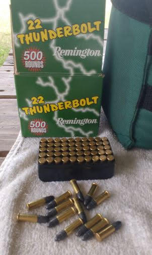

The next 50 sent were Remington Thunderbolts
ACtC-3cGdfc4aizD7bcrLk08nT0F6ouVtWukQGLcf25gRvxqahFwYNVXRL2Emp6UlNFGKg9y1kzUA48fzkCimqkcfZhxE_wT6yNiBpPxzjP7TIyJAr33D-zBSPB3jCcN3aHwlbJnDzf5mQ1gZncPM3T0iCF3=w331-h474-no
ACtC-3d8c0u-Mom4Wi9D_AtP1DAi7VF0ly-d-9yeC2V0ETufW2yWWqPiwYQdSyU1pPvviZa0aeOnJ0srGKtECSSRowDSTdSC_CyJxtfsqBcrTKpT__16sue9UVcV8hj7bNLYN28I6GnriQadhdsLD331b_y7=w302-h506-no
ACtC-3egNYNVKjUKnAw8e3YAmUHzUKaXFZXyMYpRfzAL0bH4oBvLsZq3sDHar6bC7v-8JQjwbj-jWYKE1lyloWJZLp6G5_SQz8HwQbRAajkX9x232TQgJC2PJkmKiwrsTfHio325xlcMg7g1Wrji8Syav0xb=w451-h654-no
ACtC-3cvO2kvjtHz_QR1cK9iilPJhvSzpcG5y9pWcUFjShMdv5PjC5bi2KuzFi9PFMdChP9fmul-v_RSkl_chY9OyVCRtYDvhOs_TXCr0B3hn44jUs2oRkhmVrRtx0_oqMYstg_U_Y7JA9NMyOfScJrxgWsa=w288-h654-no
And the Thunderbolts were better quality than the Federals.
Even with the ridiculous wind conditions.

Above after 400
Below as shipped
ACtC-3dRuqdv9tG5QKZZqZW5NwxZslHa2nbH5ONZZ9f65rLqvcbXs9w1i2jAry4CeUooTvPz4-oQTEBbl5v2u0Keu7ZR6yqGVCfz9BAxqrJ-VL7smwpap4lV-3Pd4HkuNx7gXZ39VkuAEqr3AF8xyJmovHKt=w872-h654-no
Now, even the tool marks in the leade are showing smoothing.
