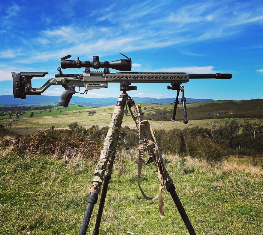

This is my unicorn fallow deer hunting rifle. Light and spicy within 600m using 143gr ELDX at 2970fps.
6.5PRC Curtis Axiom
24" 1:8" Proof Carbon
NF NX8 4-32 Tremor3
6.5PRC is excellent however not legal for some deer species down here which is a major drawback (Minimum 7mm for Sambar).

What’s the balance point on that rifle and what does it weigh?

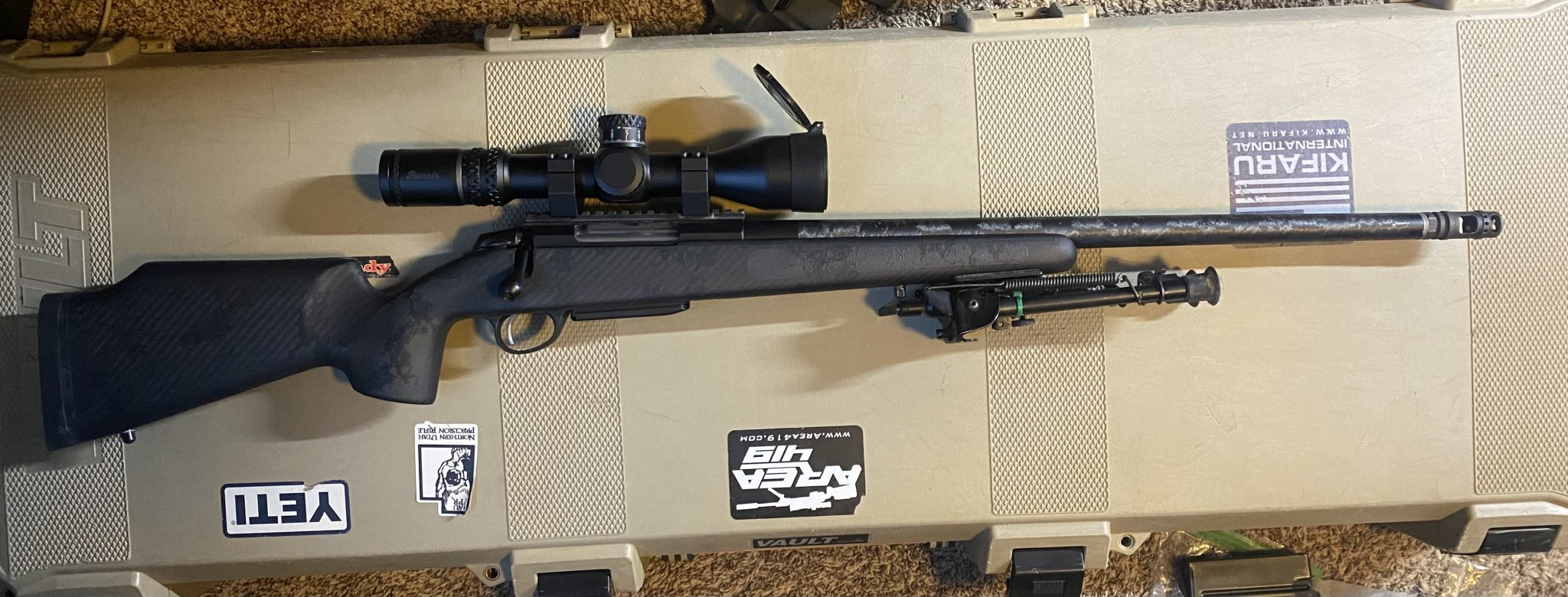

I ruminated on this issue for a few months, and ultimately purchased a Seekins Element in 300WM. It's 6.5lbs naked, and about 10.5 kitted out the way I want it. A lighter scope would easily shave off 1.25lbs if desired.
It's offered in a range of calibers, and the 22" barrel leaves room for a suppressor without trying to carry around a fishing pole. Note: the shorter barrel also leaves a lot of the caliber differences moot, so shoot what you like and can easily purchase if afield.

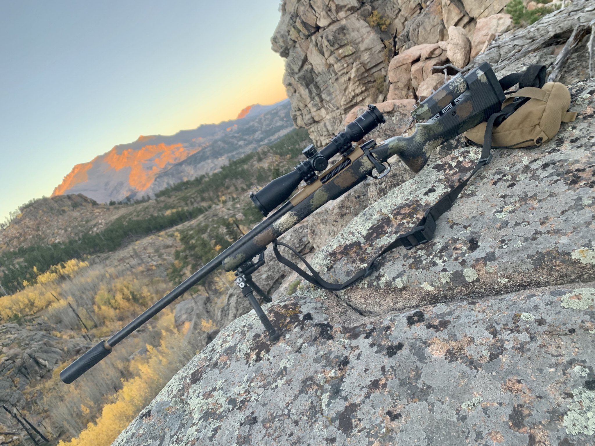

Hey man that’s a beautiful rifle what’s the specs on it please I’m wanting to build something very similar
Tikka T3x long action and trigger, tikka oem bottom metal with Mountain Tactical tikka LA magazine, 22” C6 sendero 300WSM barrel custom throated for 212 ELD-X, PVA Ultralight Jetblast brake, Pure Precision Altitude in black carbon, and Burris XTR 3i 3.3-18 for scope. I’ve also since that picture put a SRS hunter rail on it so I could run my ckye pod or tripod on it.

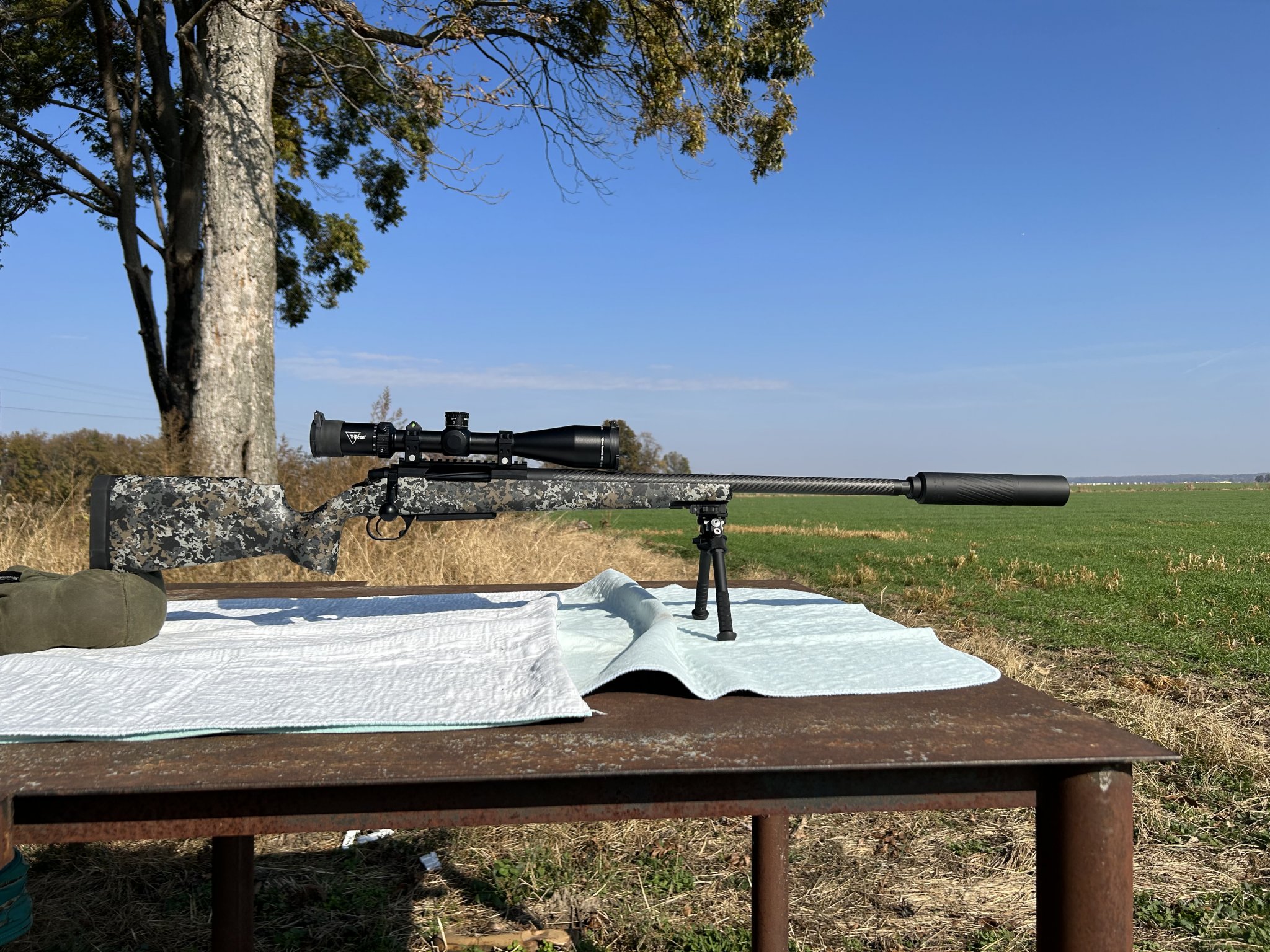

I went with a 300win mag. Basically it will work for pretty much everything in North America and if for some reason I’m traveling and forget or airline looses my ammunition. I should be able to purchase something that will work in it. I even went as far as to do my best to copy a commercially available ammunition for it.
I know you can not exactly copy but I’ve tried it at different distances and I would not even bother rezeroing my rifle.

Mine makes little groups with either the factory ammunition or my hand loads. I shot groups using factory and hand loads and ended up with one ragged hole. It’s definitely a half moa rifle.
