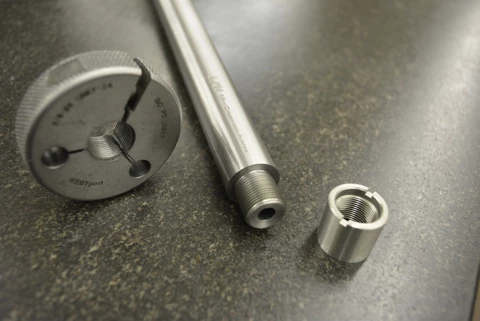

looking for some input from some of the smiths on here in regards to whether the solution to the following is just 'cleaning up' the existing threads, or would it have to be cut and rethread.
background:
i've now received two barrels from a manufacturer threaded 5/8-24. in both cases when attempting to install brakes from another manufacturer, ive run into instances of incompatibility. in the first event the brake got stuck. had to be cut back, etc.
On the 'replacement' barrel, once i started getting resistance again i stopped and called manufacturers of both parts. both have taken it in and said their respective product checks out to their specs. Barrel manuf showed me 5-6 pictures of various competitor brakes / threadcaps threaded fully on the barrel. brake manufacturers QC group identified no issue with their product, but gave me the following regarding their thoughts on the barrel threading:
" We measured the barrels thread pitch and we found that the pitch was oversized at .602, five thousandths over the acceptable range. We utilize class 2 threads for our adapters where the acceptable range is .59270 through .59670."
based upon my limited understanding of pitch (peak to peak - correct me if im wrong), is this something that can be fixed by re-chasing the threads a bit?
i tried to understand the classes. it just seems odd to me that other manufacturers stuff went on and not this one. does that mean everyone typicaly uses class 1 for threads for MDs?

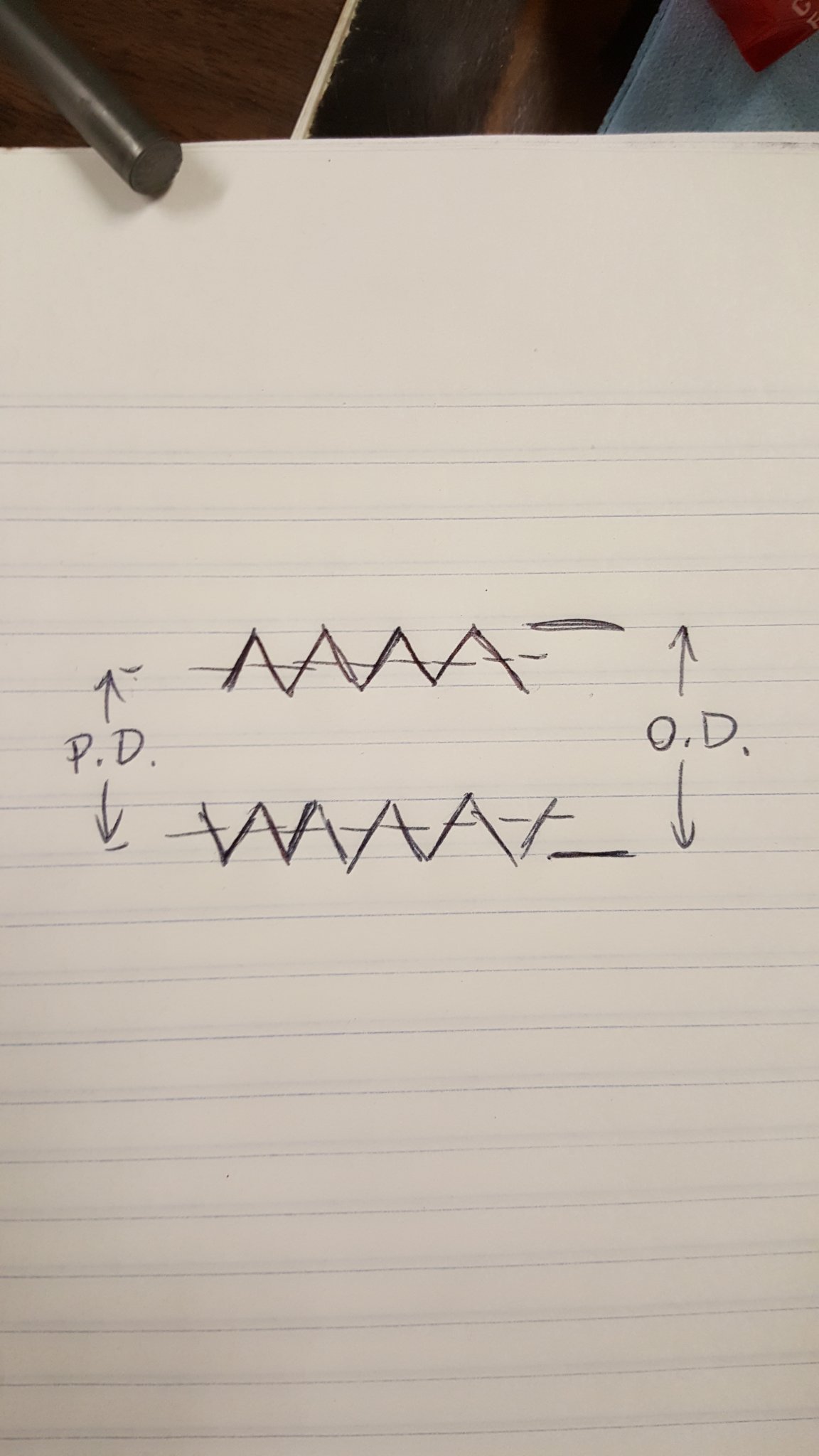

One of them is telling you the truth and the other one isn't. I'd tend to believe the brake manufacturer as they actually took measurements. Muzzle threads should be cut to a 5/8-24 3A (class 3) spec and muzzle devices can be cut to a 5/8-24 2B or 3B spec (class 2 or class 3) and be compatible.
The measurement of .602" is a pitch diameter and cannot be measured on the peak of the threads. Assuming that is an accurate measurement, that pretty much tells the story. It is indeed too large to meet class 3 spec. The gunsmith that did the barrel threads is most likely the culprit. He is doing something wrong when it comes to cutting his threads to a standard.
He probably cut the thread boss oversized and then threaded until he had peaks.
It’s a common issue with how folks are taught threading - you oversized the boss a little to ensure you get sharp peaks all the way around - but then you check it as you cut past the peak.
Some smiths forget they did it that way and just peak them.

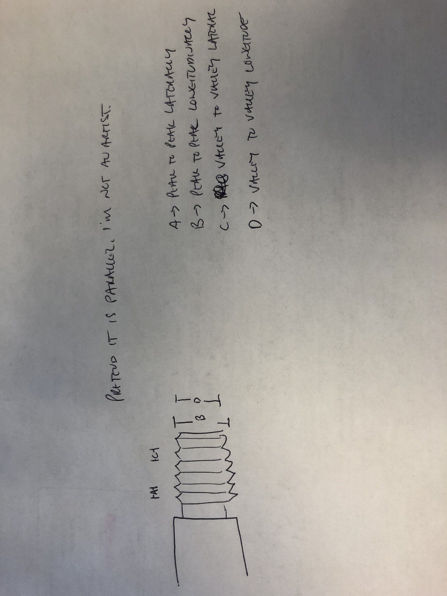

Let me give you the engineering data in English (but if you need it can go full technobabble)
I don’t know if the people who make these things even know class fitting exists, actually engineer the threads based on the load or they just grab the closest thread that fits the round stock. I see no indication that any significant thought went into any of it. I have never seen a published standard that the industry would adhere to on this issue or even stresses the joint is designed to withstand.
Here is the short text
Starting at zero (defined as fitting a 1” pin in a 1” hole)
You can’t do it because that’s the beginning of an interference fit because there is no gap. Same with a thread. There has to be a geometric gap so they don’t rub, and air/fluid can escape.
But that gap cannot be enough to cause off center axis loading because that can cause clamping force issues or induce stressors leading to failure.
This value is a GEOMETRIC RELATIONSHIP in several planes- not a raw linear dimensional number.
Looser fits are for frequent assembly/disassembly and will tolerate some dirt- as a trade off there will be the potential for “off axis” movement in all degrees of freedom and possibly some effect on tensioning requirements.
Tighter fit classes require strict lubrication and sometimes heating and cooling just to install and are often “single use” fasteners. (father of the old wives’ tale that you should always replace nuts and bolts- for high fit classes you better)
Also, the female thread (B) is almost always true to dimension, and the male thread (A) sets or assigns the fit class.
The “pitch diameter” talking about fastener threads and not gears (measured P2P for size but at any 2 like points along the helix for overall fit when in contact) determines the surface area of contact for tensioning strength.
(this is why when you select a tap make sure the fit class is the same for the female thread and why you have adjustable dies to adjust this- don’t just randomly grab 2 and believe because both are ¼-20 they are mated)
Another consideration is the thread- if the thread is forged or rolled then the threads are super dense relative to the core-ANY DRESSING of those threads removes that super strong dense material and reduces clamp strength and joint integrity by ORDERS OF MAGNITITUDE.
So you CAN chase the threads (lathe, tap/die or file) within reason and the parts will fit mechanically and probably pull tension satisfactorily but by removing metal you run the risk of affecting indexing ( timing as some call it), tension, axial and radial alignment.
Actual results will depend on the specific joint and the modification so there is no real prognostication other than you know what you are doing – just be cautious like any machinist and if need be cut a dimensioned model and experiment.
Hope that helped- this is a complex subject and I know this is the evaporated milk version.

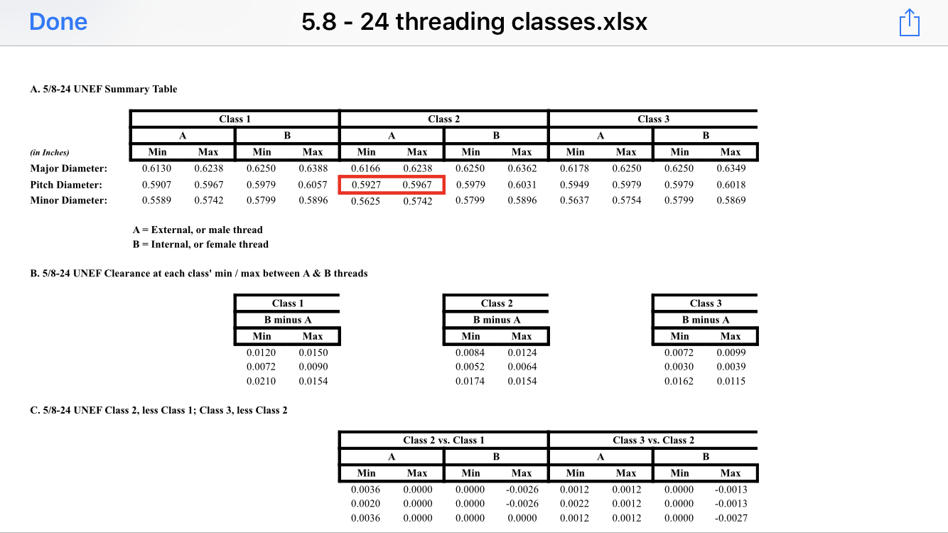

my first inference prior to the feeback here was that a class 1 would have the widest tolerances, with 2 being tighter and 3 being the tightest. (maybe tight isnt the appropriate word). but from a few remarks here do i have that backwards? type 3 would have more 'play'?
picture may help me follow. BofI - on those tolerances, how do they apply in relation to my photo. A, B,C ?
with respect to the measurement the MD manufacturer gave me (this is a QD brake associated with a suppressor) what is that referring to - A, B, C ?
would welcome direction to any particularly good diagram on the web. my quick searches werent very enlightening
Play with this calculator.
i'll play with the calculator. drifter thanks for the photo. so if i understand correct, the PD could be reduced. but a PD can't be increased because the metal is already gone.
Correct. Pitch Diameter can be reduced, not increased.
If the barrel threads are out of tolerance as the Muzzle Brake manu. says, it could possible be re-threaded/chase the threads. There isn't a large margin for error and the setup is critical to get things concentric to the bore.
Taking of .005" total doesn't leave a lot room to work with.
Unless the barrel manufacturer says the PD is different than what the other guys measured, I'd be inclined to assume it's the problem, and even though other brakes thread on it's not cut to a standard/tolerance that most would agree is acceptable.
.005" over sized on the PD is way out of tolerance when it comes to the numbers a lot machinist/gunsmiths maintain on a daily basis.
Good (and recent) video explaining thread fit/pd

spent some time at lunch playing with the calculator link provided, and set out the 3 classes side by side. running comparisons i see how the tolerance between A and B threads clearly 'tighten' as you move from class 1 to 3. snapshot of spreadsheet attached.
back to my issue at hand. so my brake manufacturer quoted the barrel thread pitch diameter at .602. From the tables that is out of spec for A threads in all classes.
Now, one of the different adapters that the barrel manuf sent me a photo of clearly threaded on my barrel is a made by a company that specs class 3A threads for their stuff. A pitch dismeter of .602 is also outside of their spec, but whatever class B thread spec they are using is compatible (based upon pictures provided). looking at charts it would imply they use class 2b or 1b, but as these manufacturers deal in suppressors, i would think they'd stay toward the tighter end of the spectrum, ruling out 1b. But then at the specs for 2b, it would only leave about 1 thousandth between my barrel pitch diameter and a class 2b max pitch diameter. Seems pretty darn tight.
im just perplexed how these other adapters fit right on in the photos.

- Did anything ever screw on to this barrel in the first place?
- I might suggest you putting dychem on the thread and screwing 2 different devices with the same thread and see if they are binding the same.
If they are that's a good indicator you may have an improper thread
- Have you used a thread gauge to verify the male thread yet?
I can get a thread protector on with just light effort, and it'll go until it bottoms out. The Surefire brake, which is the toughest to get on, spins on just fine until it runs into the damage portions of the threads. Once it hits the damaged portion, it becomes VERY stubborn and the barrel threads are actually cutting into the nitrided metal of the brake.
I haven't used a thread gauge yet. More mechanic than machinist, so the only thread gauge I have on hand is the kind that just tells you the size of the bolt and the TPI. Not too bad considering I paid about $5 for them at Harbor Freight over a decade ago. But I might pick up a set like @ScottDWallace linked above. Or some ring and plug gages like LRI linked higher up. I'm not sure how often I'll use them, but I have a problem when it comes to hoarding tools anyways.
Just so it's clear, the threads are most definitely damaged. Like, visibly so in some areas.
I ordered a split rethreading die a few days ago, so we'll see if that fares any better once it arrives. Worst case scenario is finding out that the threads are not salvageable and the barrel needs to be cut and rethreaded, in which case I'll be forced to finally track down a decent machinist in my area.
Thanks for the dychem suggestion also. Hadn't thought of that.

I guess I wasn't exactly clear as how to use these, my apologies. They are quite the opposite from high-tech, but benefit greatly if you have a third hand! You place two wires (all of the same diameter and size determined by the instructions with the wires) on one side of the threads, and with your third hand, place the single wire on the opposite side. Use a micrometer to measure the across the wires. You will take that measurement, do a little math in accordance with the instructions, or your new machinery's handbook, and you will get your pitch diameter, or PD. Look up the PD tolerance for the type of thread you have and you will instantly know where your problem lies.
I will say that this is usually for machinist's, gunsmith's, and operators to verify threads, but it is indispensable for anybody that works with threads in general. You can then use the PD measurement to adjust your split ring die or filing.
So if I understand your situation right, you have a comp that will not thread on completely. There are really only three things that could be in error that comes to mind. Though, I've only had one cup of coffee, so forgive me if I've missed one or two. Crest height (major diameter) is too high, which can sometimes be addressed with a quick and LIGHT filing. Pitch Diameter is out of tolerance on the high side. Or what @Blacksmith of Isaiah said, and which is the most likely suspect, the thread pitch is just wrong. The barrel maker/gunsmith could be threading on a metric lathe and uses a setting that is "close enough". If you don't have a TPI gage, you can set your calipers to 1.000" and just count the threads. That's assuming you have 1" of thread. Do math accordingly if you have less.
