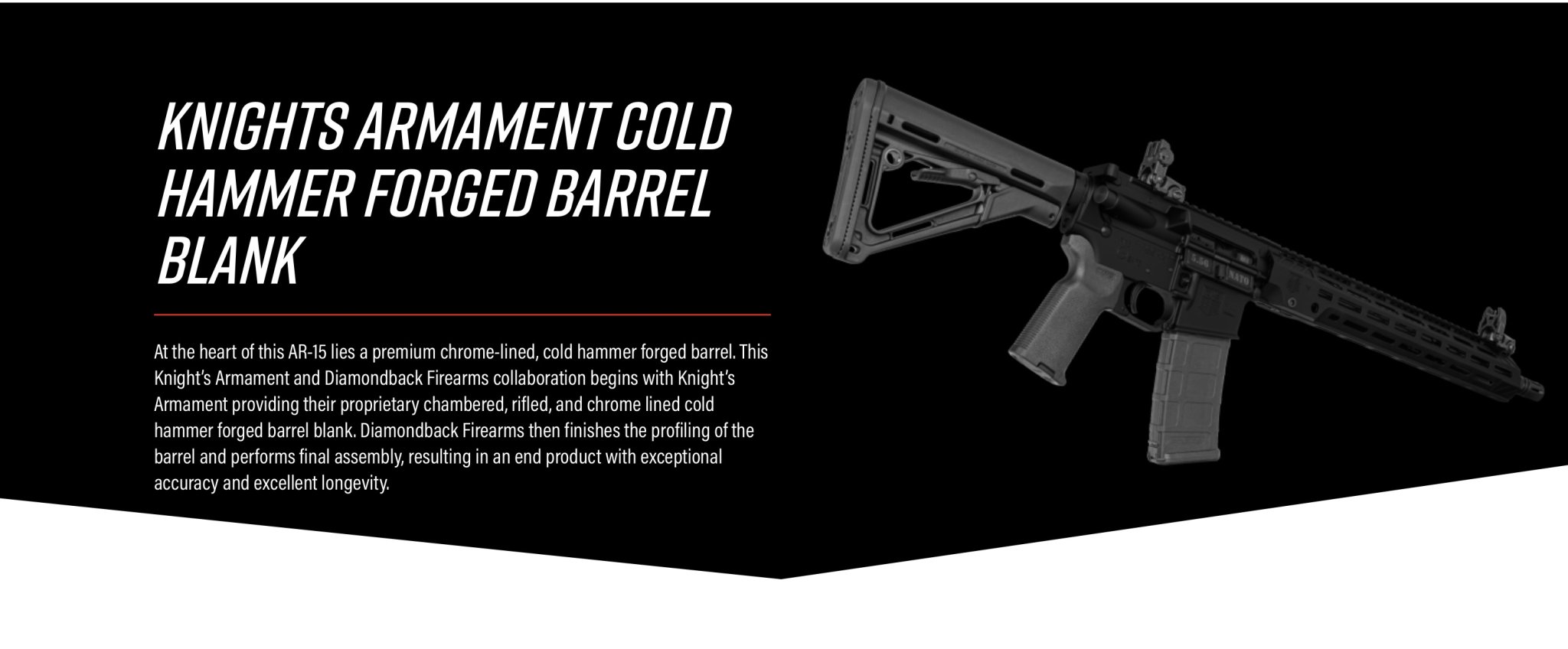

https://diamondbackfirearms.com/sho...mament-cold-hammer-forged-barrel-blank-black/
Knights for the poors? Just as good?
Maybe I don't understand barrel manufacturing, but "hammer forged barrel blank" sounds like PR-Marketing smoke and mirrors...
Isn't a barrel blank the metal tube that is put into a hammer forge for contouring, and THEN it can be called "hammer forged"?

From the article:
"A cold hammer-forged barrel starts life… as a short and fat blank with a polished hole running through the center. A hardened mandrel of proper width (caliber) and rifling pattern — again reversed/inverted — is placed into the smooth bore. The pair go into a forging machine that compresses the steel against the mandrel, hammering it into final shape."
Which is how I would have described it. In other words, it's not "hammer forged" until AFTER it is contoured/rifled. I wonder if Diamond Back is just drilling the gas port and maybe threading the muzzle... hence why they're calling it "blank"?
In this case, the rifling and chamber have been forged into the blank. Length cut, exterior profile, installation of barrel extension, etc. still need to be done. A "CHF Blank" is what the CHF poops out when it's done.
From the article:
It’s hammer forged when it’s hammer forged. The rifling is imparted during the hammer forging process.
