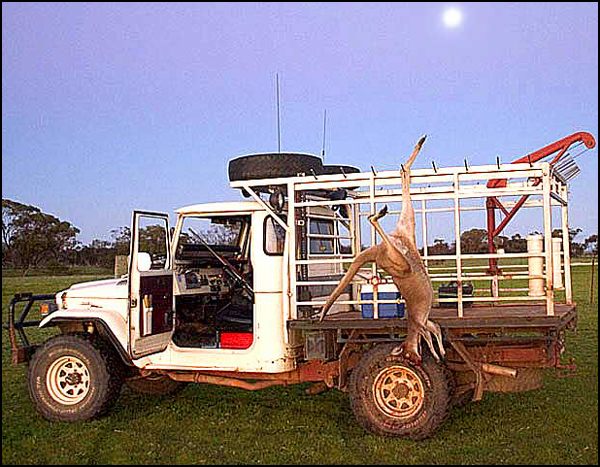

Typical "Table Top" setup for a commercial roo hunter. We did not run pegs on our Land Cruisers to hook em cause we just laid them down on the ground to stop crop destruction. Enough work killin em let alone pick em up for processing. But today, commercial roo hunting is big business for dog food industry. Some of them guys make over $1,000 per night.
This is a relatively average size Grey Kangaroo. He would not have done that to a big mature buck Red Kangaroo. A big Red would have torn his ass up.
