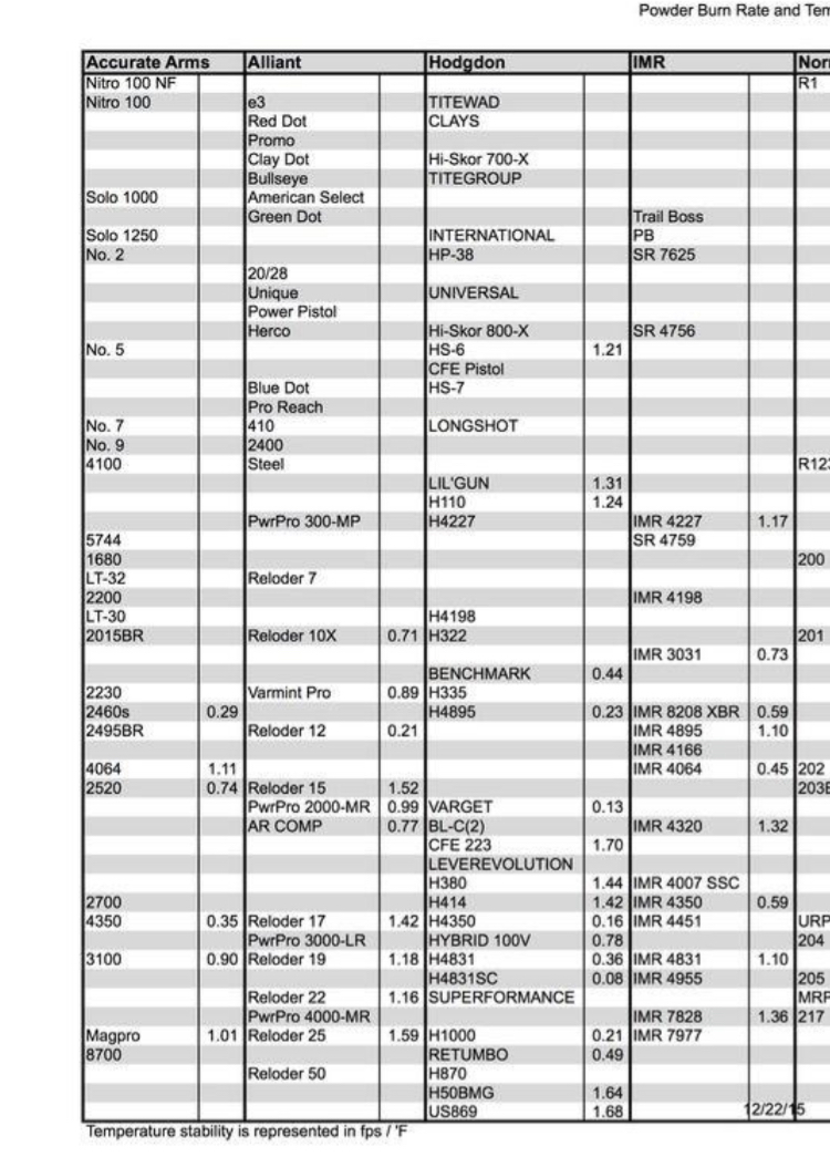

Those have been out for a while, and are very temp stable. Edit: none of them appear in the burn rate/temp sensitivity chart you linked either.
(*) (*) Look again; The chart shows 15 @ 1.52 and 17 @ 1.42 while Varget is @ .13
And , this is about their advertisement that claims their powders are so constant across the temperature range.
Their Ad. agency must also work for some politicians

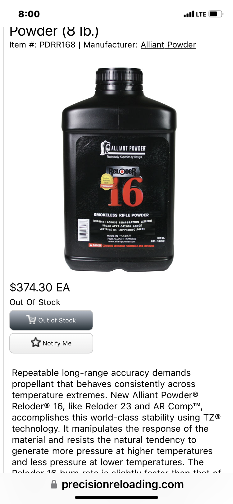

15.5, 16 and 23 are made by Bofors in Sweden. That banner above is the first time I've seen TS in front of 16 and 23. The literature for TS15.5 (the newest of the three) is a virtual cut and paste of the literature for 16 and 23, which tout “TZ technology”. Direct competitors for varget, H4350, and H4831.

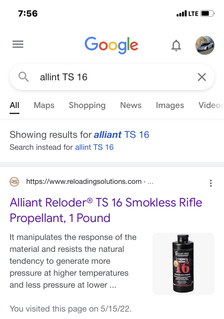

@supercorndogs if you google TS16 there is one hit that appears but the page doesnt work. The few lines of description on google read the same as RL16. Im just spitballing about a possible re-branding, as RL16 already exceeds h4350 in stability and the literature appears to be the same.
The second pic is cropped but is RL16 not TS. Just posted for the description similarity. More i look at it, the more it seems like a marketing fuckup, to include the ad posted by the op.
I see. Yeah, unsure. Sorry if I muddied the waters. Overlooked the TS component. I remember that now. Definitely don’t have anything helpful to add as far as that goes.

I see it now. Thanks. I disagree with the CFE assessment. I got .5 FPS in my 308 with 175’s.
I hope so. 1.7! Jeez. I bought a bunch to try as it’s ball for the progressive. I work everything up on my single anyway. I’ve had the best velocity and accuracy with H4895. Never actually temp tested any of it. Just noticed in my logs not much difference in VA. Just figured this would meter better.
Using QuickLoad for 175's in a .308 with a temperature spread from 64°F to 94°F, it calculates a difference in velocity of ~39 fps; divided by 30 it comes to 1.3 fps per 1°F. That's better than the burn rate charts I've seen, but no where near that .5 fps.
Of course, a lot of variables are involved with the burn rate calculation; like bullet weight being used and temperature range being used.

You done good , think I'll call them tomorrow and ask how you figure you can make such claims
chart
Crap, looks like RL 15, & 17 stay in the closet for a while
Who made that chart? How did they do it?
Why should anyone believe what is on it?
Do people just believe random internet shit they find without any critical thinking?
