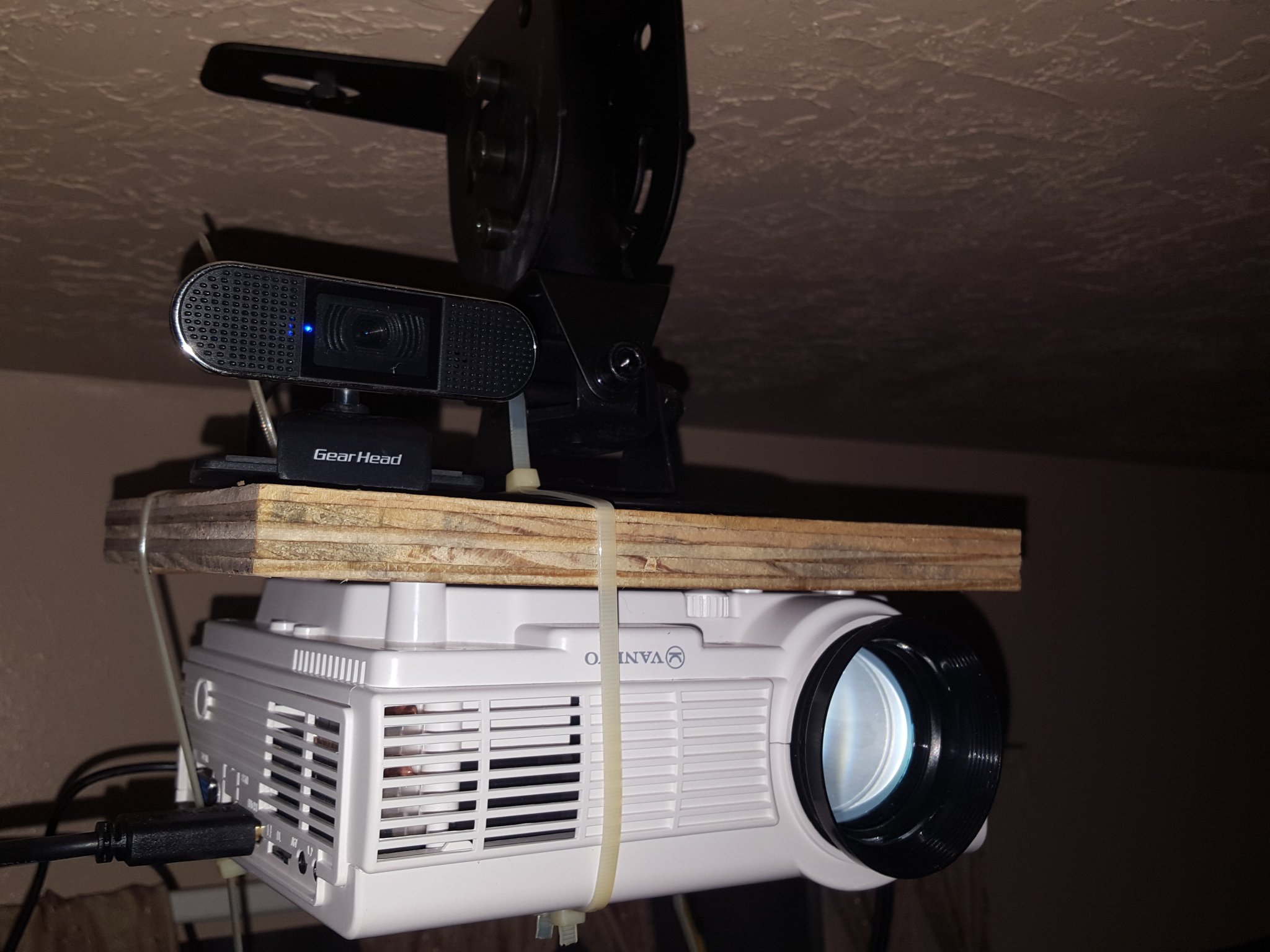

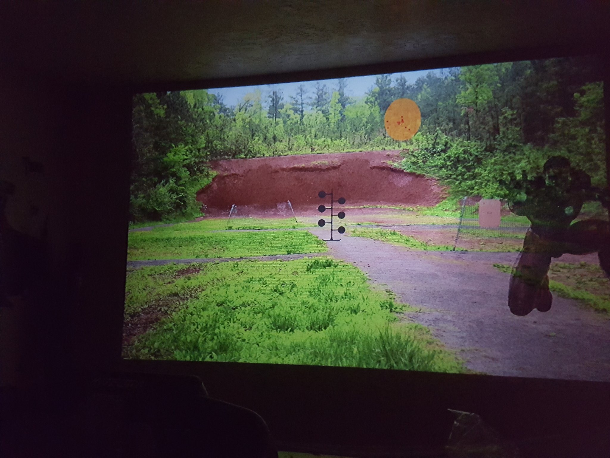

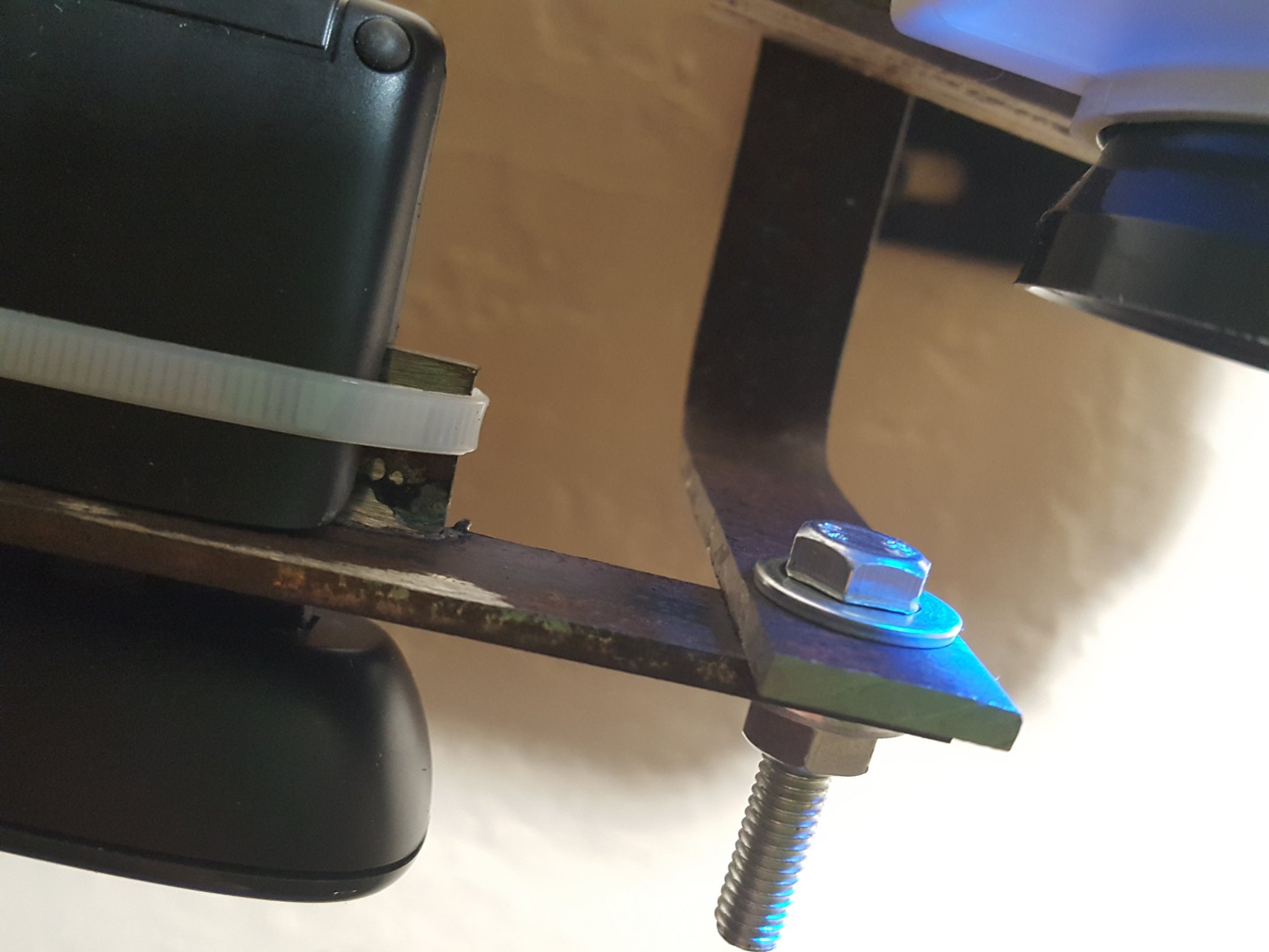

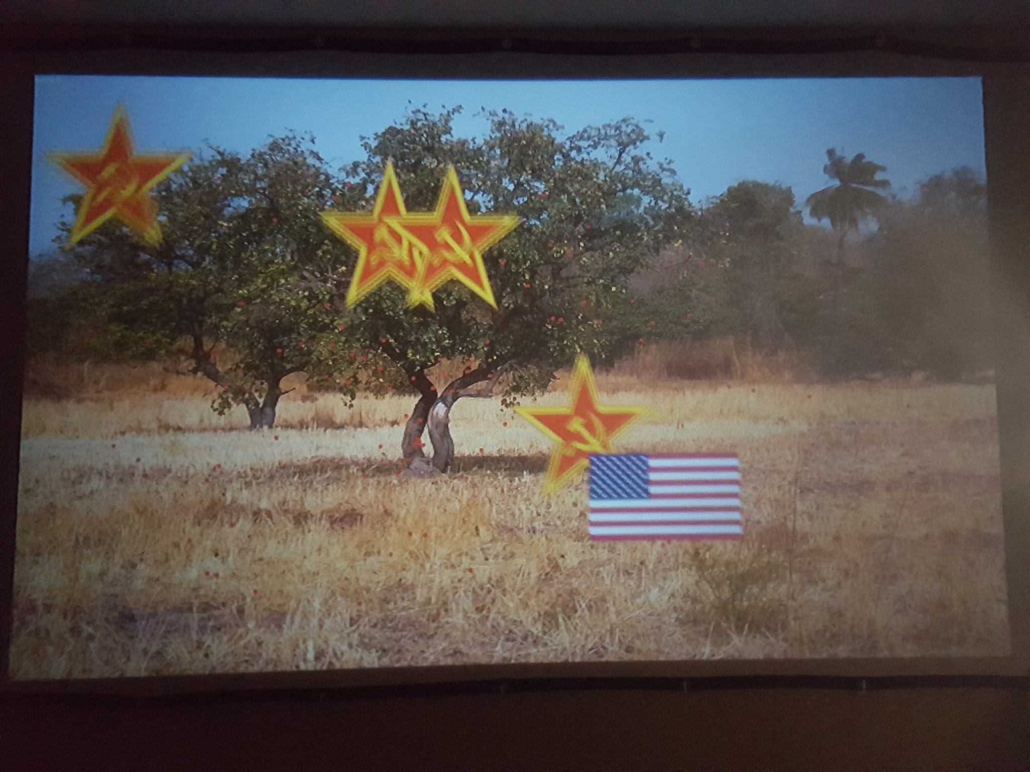

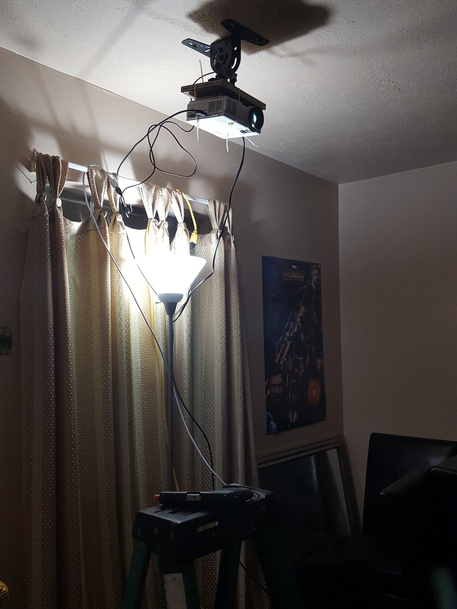

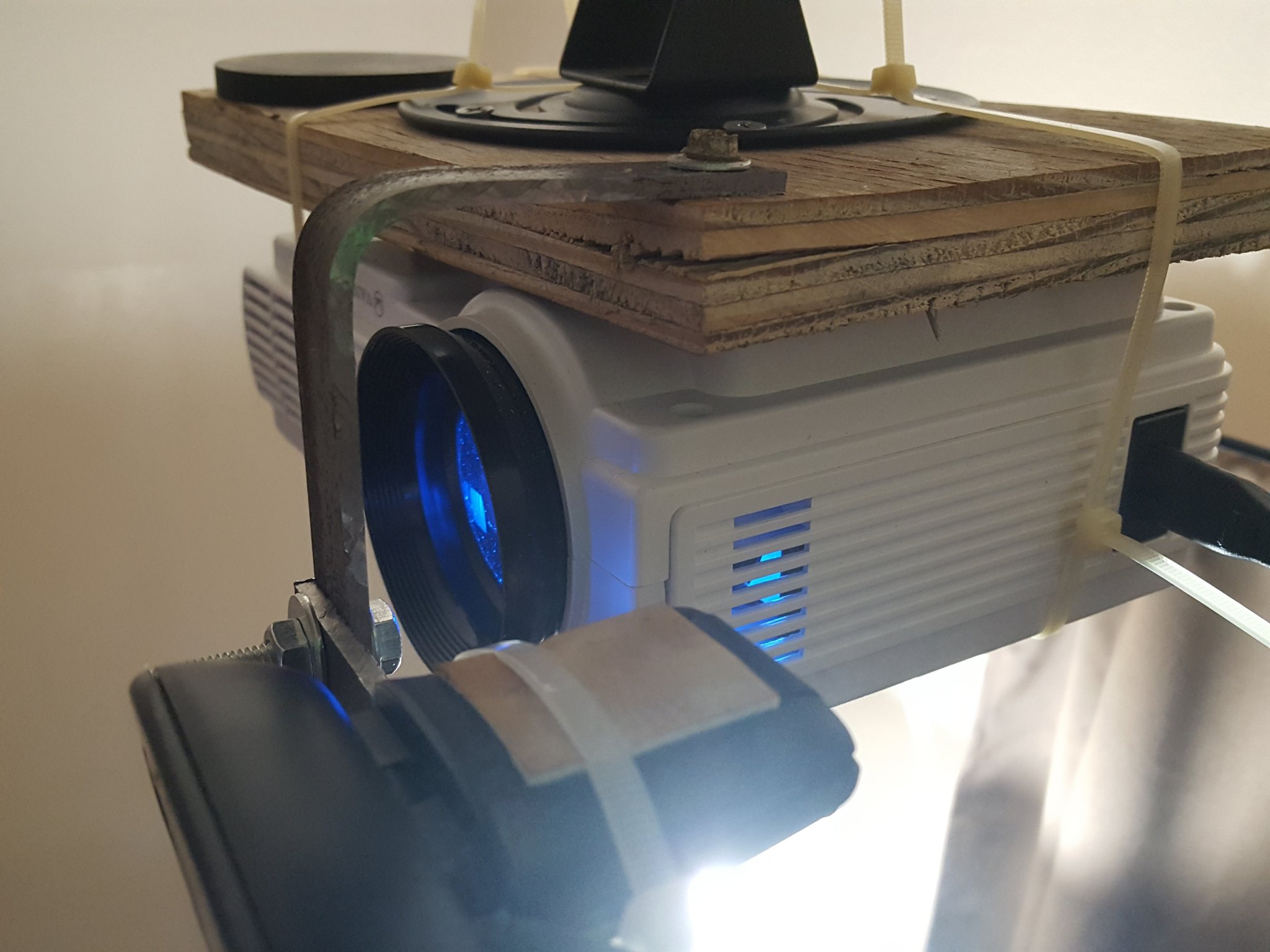

    My wife got me a Vankyon Leisure 3 for Christmas, along with a cheap screen that covers most of the wall. This thing is fucking awesome. I kicked it to the back of the room, and the image is clear enough to read e-mails and just about fills the top half of the wall. It's a little washed out with the lights on, but oh well. Works well for movies, too. Being up high like that, there's no interference between me and the camera, or me and the projector.
    The projector mount was ~$20 at Fry's. The universal mounts won't work as-is on this projector because it doesn't have the expected screw placements. In theory you could get some long screws and do it that way, but fuck it. I don't want to spend any more money and zip ties work. I put the ceiling mount into one stud with the rear screws and used anchors for the front two. I'll probably replace those bolts with some others and hit it from the attic with a piece of plywood, washers, and nuts just in case some dumbass were to fuck up and bang his head into it, I don't want my sheetrock coming down with it. I used some screws from flex-clips to screw the "projector plate" to the piece of plywood, then zip-tied the projector to that.
    Ran into some issues with the webcams, though. left and right edges are, I guess, too dark to process well and putting targets on either side results in a lot of missed shots. I either need a better camera (still have a few more to try, if I can remember where I put them) or to balance the lighting. Targets placed in the inner ~60% of the screen are good to go.
    All that's left for the setup is:
    1.) Run power from the attic
    2.) Clean up
    3.) 3D print a mount I can screw into the plywood that'll work better for the webcam than the bullshit they come with to hang from a monitor
    4.) Make a laptop stand to mount on the wall
    5.) 3D print adapters for my Henry 45 colt and 12 gauge
    6.) Make some badass 'courses'. In reviewing what's available, between this, this, and this, I've got what I need to have some ANTIFA assholes popping up and coming right for us
    7.) Improve auto-calibration
    8.) Make it easier to scale fixed-size targets to real-world distances
    a DAO gun would be ideal for this type of thing. Closest I've got to that is my Sig p220 with is DA/SA with no half-cock bullshit. My CZ is OK, but with the half-cock bullshit, it's just not the same. For the last 3 days I've been waking up, doing 20 squats, 20 pushups, running 9MPH (fastest the treadmill goes) til my pulse is > 150, then slowing it to 3MPH and picking off little targets for another 20-30 minutes. I'm improving pretty quickly. Totally fuckin' awesome. Gotta have a good trigger pull or ShootOFF will reject it.
    Ideally I'll get to a point where I can do a better job fuckin' up hogs than a pack of dogs.

    Got my development environment setup last night and made a trivial change to a training scenario. It's a lot more fun than red and grey circles.
    This game is great for building trigger muscles. Never-ending supply of moving targets.

    The website for shootoff recommends a few webcams and explains quite a bit on youtube . There is a little research involved . I would think that the program allows you to set distances but I may be wrong . You can I believe add your own targets so in theory you can experiment until you get the desired size . Oh and the suggested webcam is cheap due to that is what he used . Not that that matters to you . If you are looking more for plug and play and don't mind dropping $500.00. check out Warrior Poet Society on Youtube . He does a piece on a plug and play set up that looks pretty bangin .

    I was at white trash Mecca ( Walmart ) last night and they have an RCA 2200 lumen , 800 x 480 native resolution projector for $80 . I'm tempted to pick it up but have yet to see cool fire release a set up for my XDM 5.25 Comp. .
